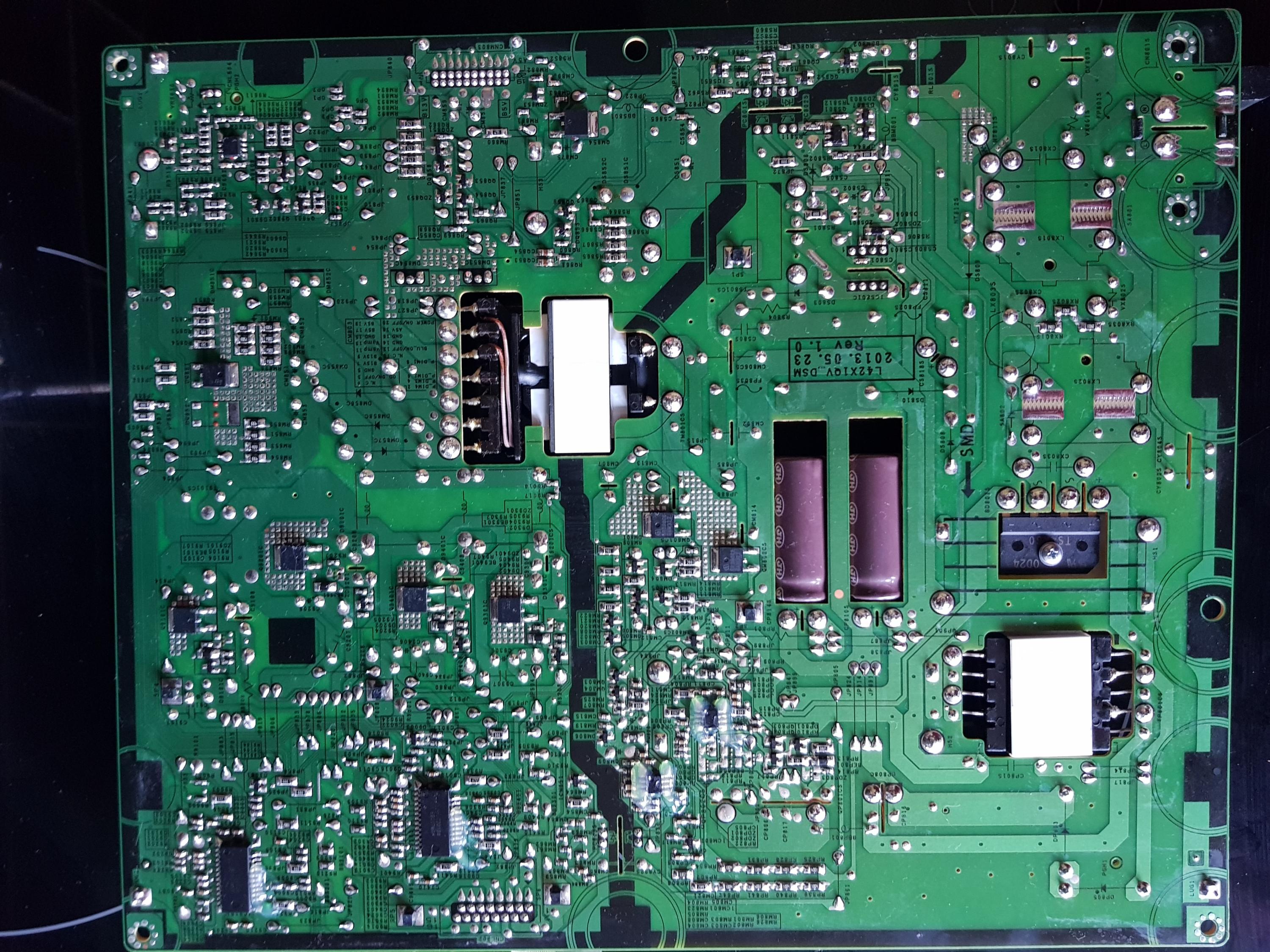

    Originally posted by budm
    Can I see good clear hi-res of the whole bottom side of your power supply board?
    Certainly, no problem

      #42
      Re: Samsung UE40F6320AK on / off boot loop problems
      Originally posted by Bloopeta
      It would appear, that heating this section is what allows it to start
      Can you narrow it down further, I know it can be hard, there's quite a few caps there, usually it's the round electrolytics that go first, the blue rectangular ones are also caps.

        #43
        Small article there, testing caps: http://www.learningaboutelectronics....st-a-capacitor

          #44
          Thanks for all the help. I have ordered a replacent PCB.

                #47
                Ok, let us know how you make out.
                Replacement PCB finally arrived today from China, fitted it, problem solved, TV now starts up and works perfectly.
                Thankyou to everyone who replied and helped, much appreciated
