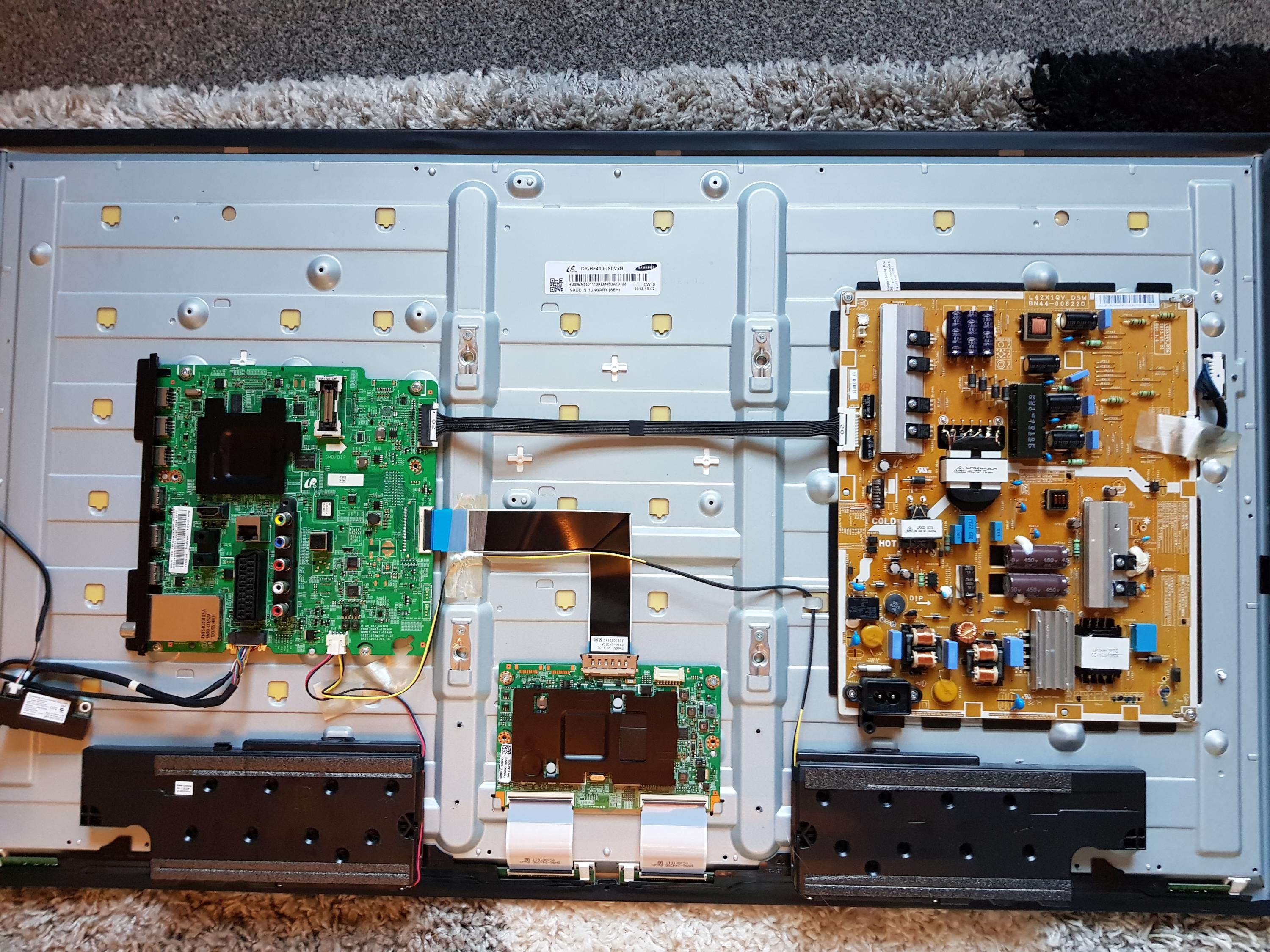

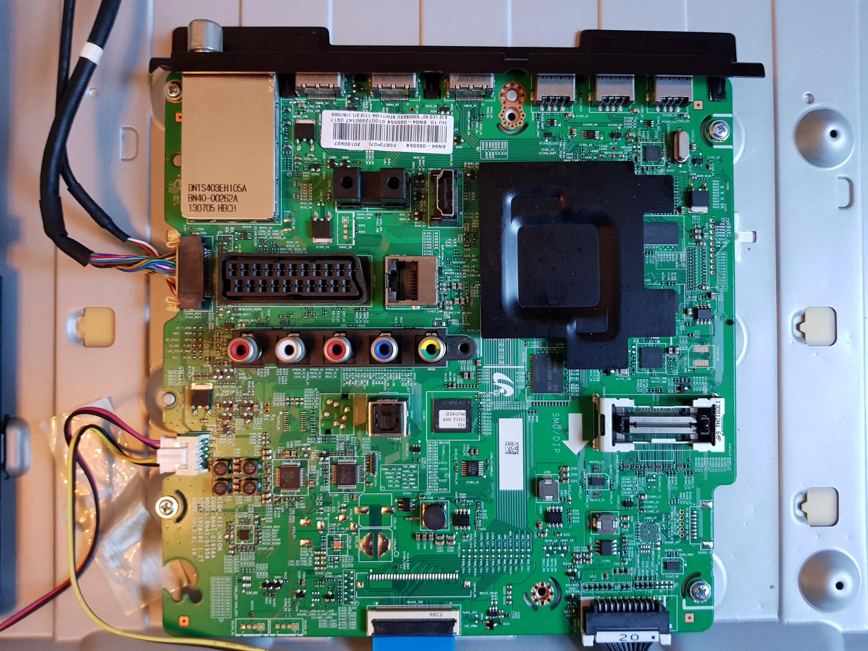

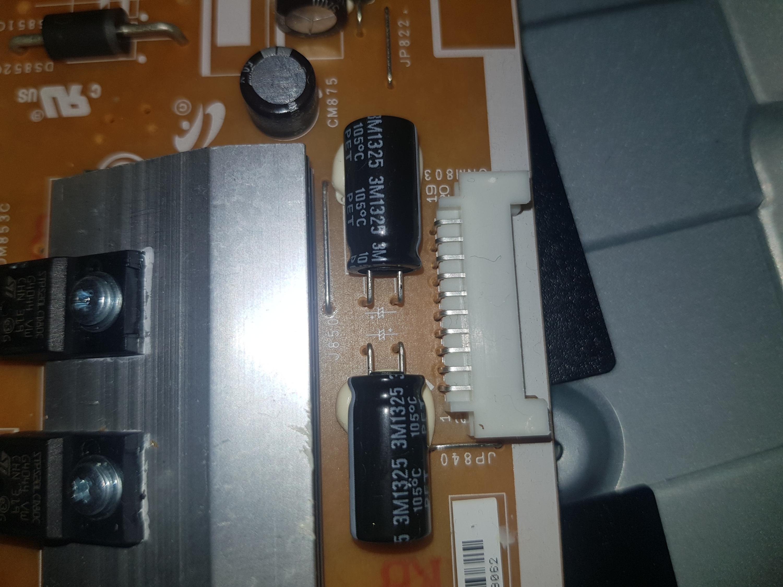

    Lets see good clear pictures of the whole backside of the TV showing all the boards so we can see what we are dealing with.
    • Bloopeta
      • Jun 2018
      • 526
      • United Kingdom
      Re: Samsung UE40F6320AK on / off boot loop problems
      Thankyou for your reply.
      Here are the pics as requested, if you require anymore please let me know.

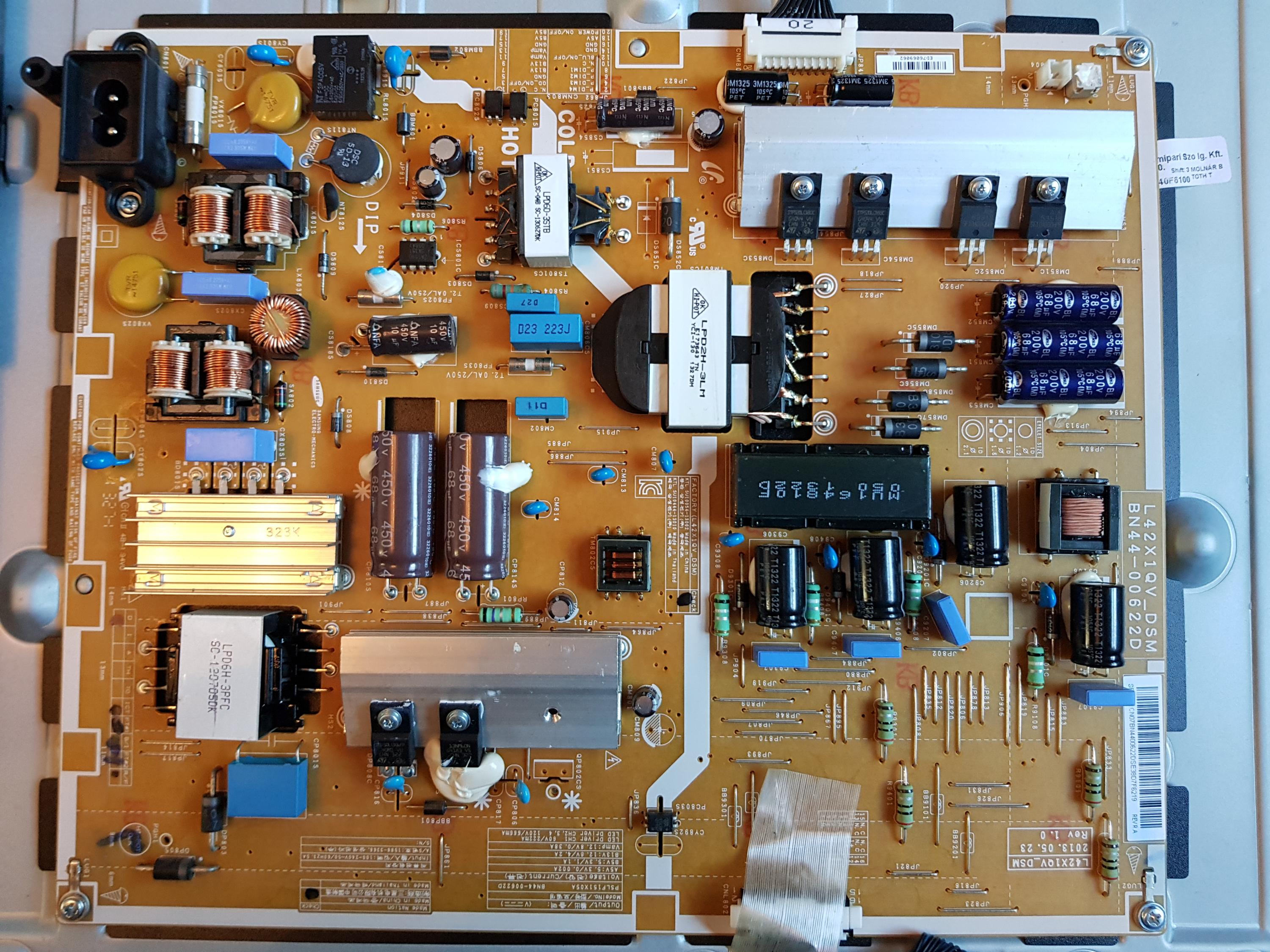

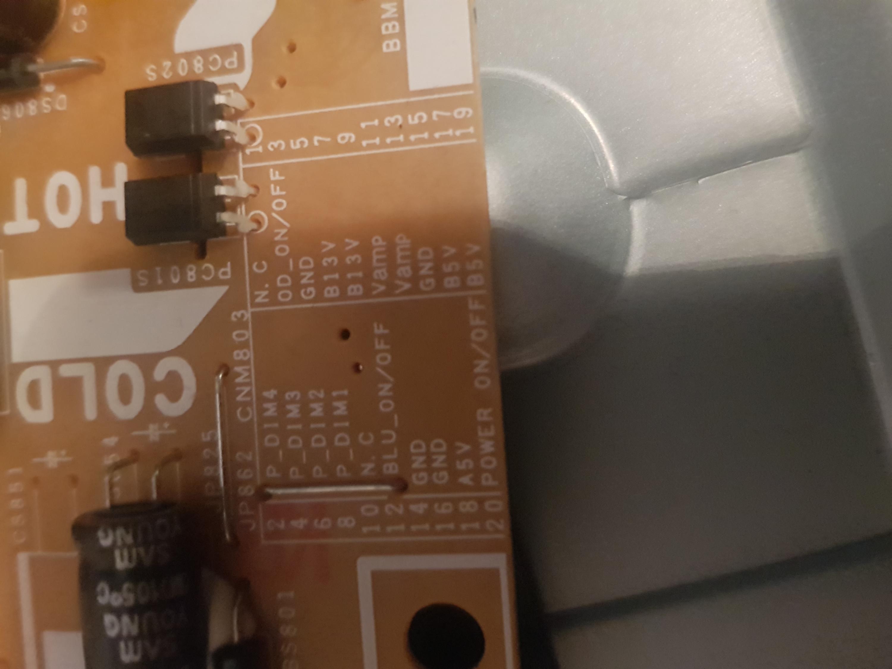

                      I have tested power board outputs without anything pluged into power board, the results when it clicks are
                      1. N/C 0
                      2. P/DIM4 Jumps
                      3. D-ON/OFF Jumps
                      4. P/DIM3 Jumps
                      5. GND
                      6. P/DIM2 Jumps
                      7. B13V Jumps
                      8. P/DIM1 Jumps
                      9. B13V Jumps
                      10. N.C. 0
                      11.VAMP Jumps
                      12. BLU ON/OFF Jumps
                      13. VAMP Jumps
                      14. GND
                      15. GND
                      16. GND
                      17. B5V Jumps
                      18. A5V Jumps between 5.27 and 5.26
                      19. B5V Jumps
                      20.PWR ON/OFF 0.87v jumps upto 2.3?v
                      All the ones I have wriiten just jumps beside, jump from 0

                        If you disconnect the power supply from the main board and jumper A5V to PWR ON/OFF using a 1K resistor and switch on, does the B5V and B13 supplies come on.
                            "20.PWR ON/OFF 0.87v jumps upto 2.3?v"
                            So the PS-ON pin is jumping up and down between 0.87 and 2.3V?
                            BTW, PS-ON pin has built-in pull up SMD resistor R5852 to pull PS-ON pin high for power supply self test.
                            Samsung BN44-00622D

                                Are you 100% sure that the A5V is not jumping between <2 V and 5V?
                                • Bloopeta
                                  • Jun 2018
                                  • 526
                                  • United Kingdom

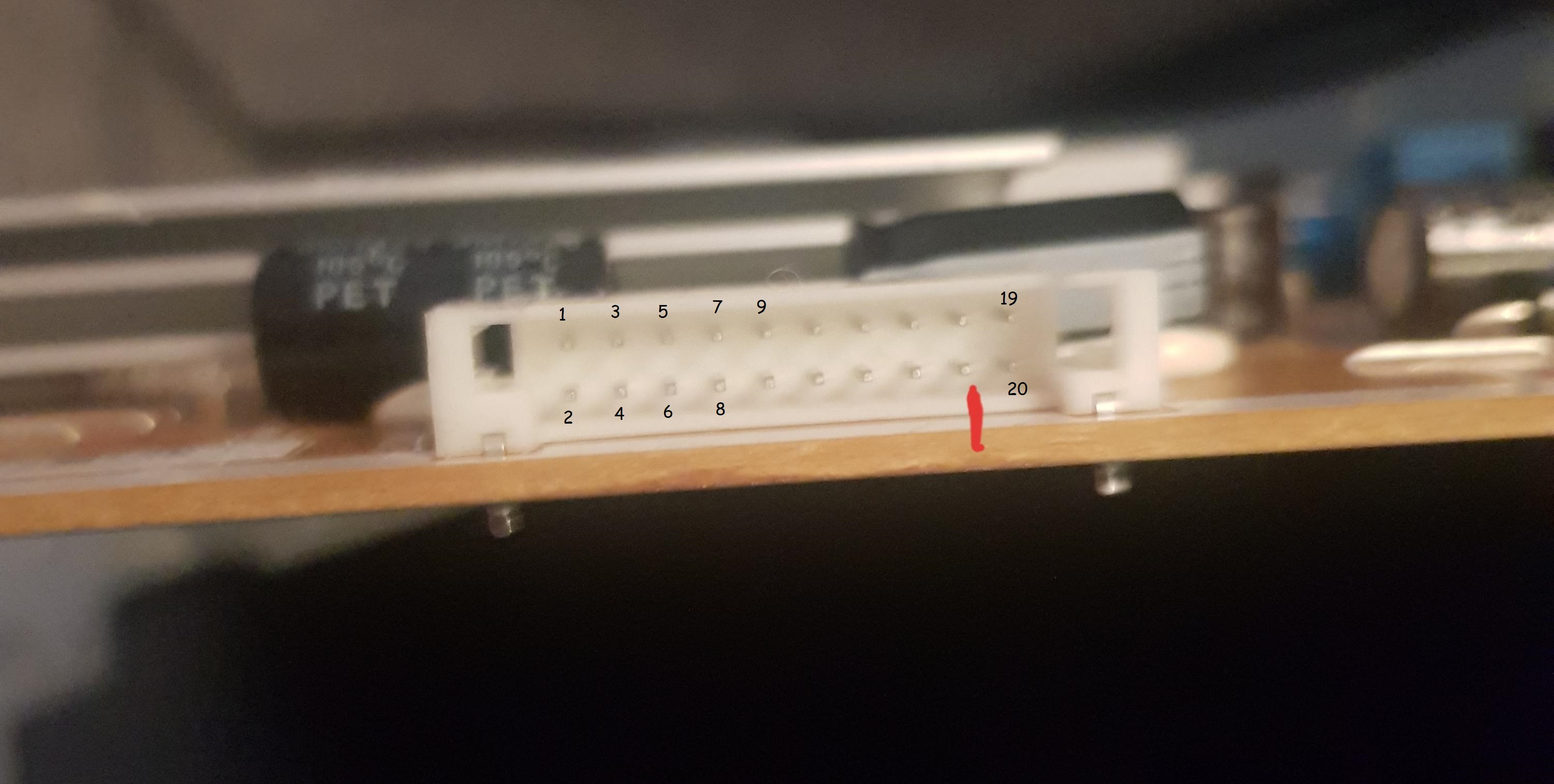

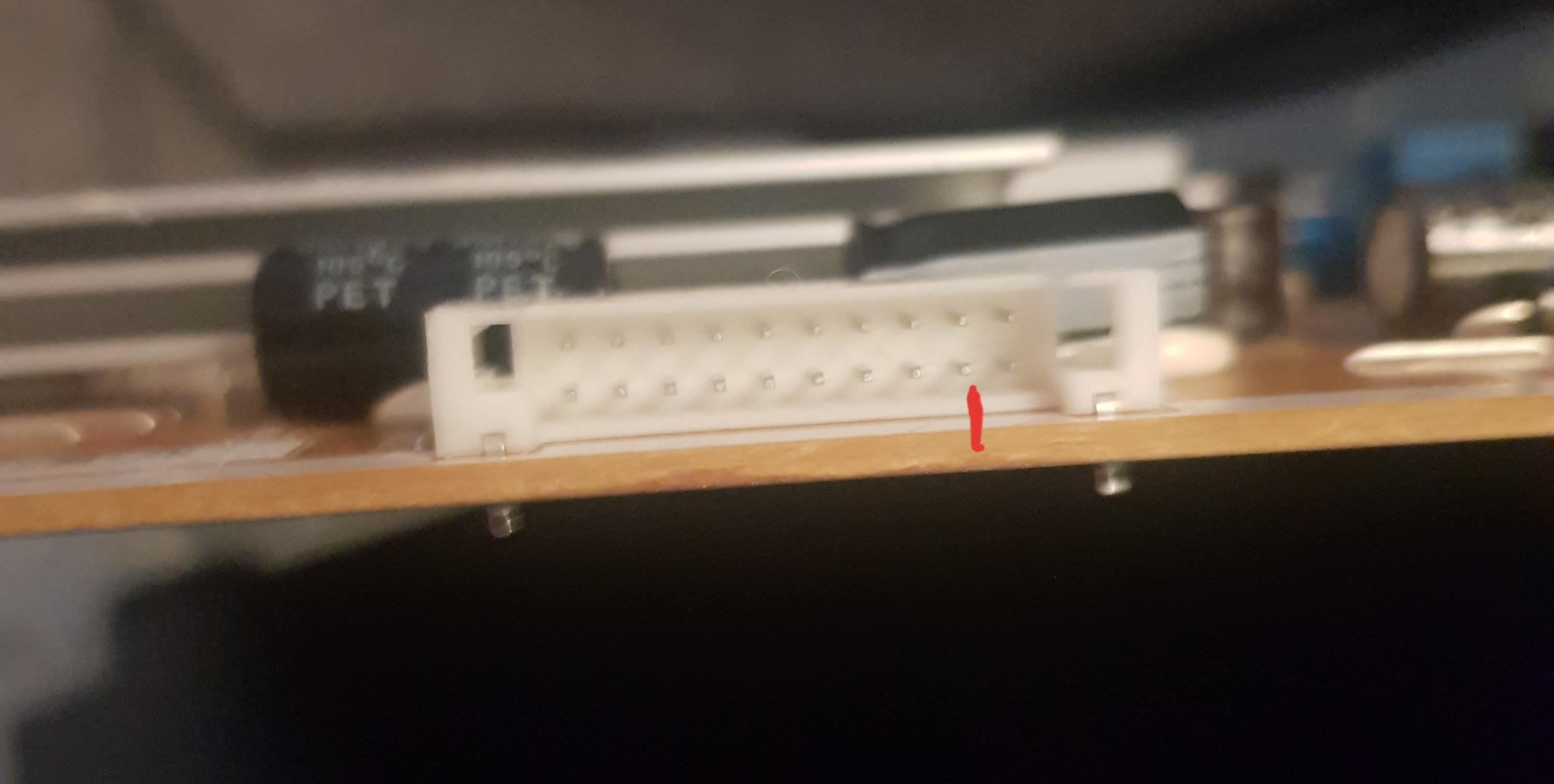

                                  Hi, yes sure, unless im testing the wrong pin, ive attached pics and marked it in red.
                                  • Bloopeta
                                    • Jun 2018
                                    • 526
                                    • United Kingdom

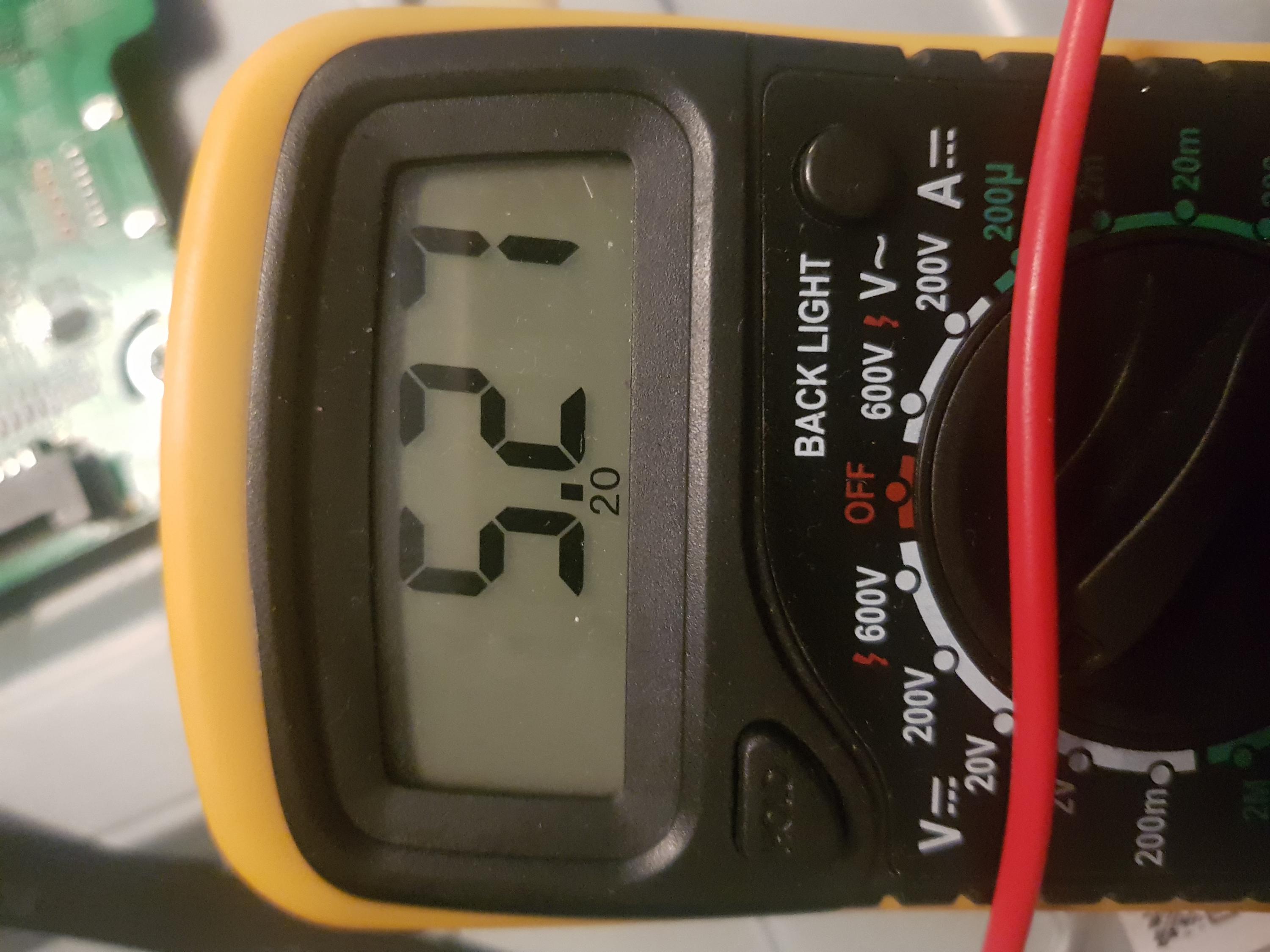

                                    If thats the correct pin, this is the reading
                                    • dick_barton
                                      • Aug 2015
                                      • 6643
                                      • Wales
                                      The pin numbers are given alongside the socket.
                                        Yeah I was just double checking incase I had the top and bottom mixed up lol, ive ordered 1k resistors to check what you suggested, ill update you with the results when they arrive.
