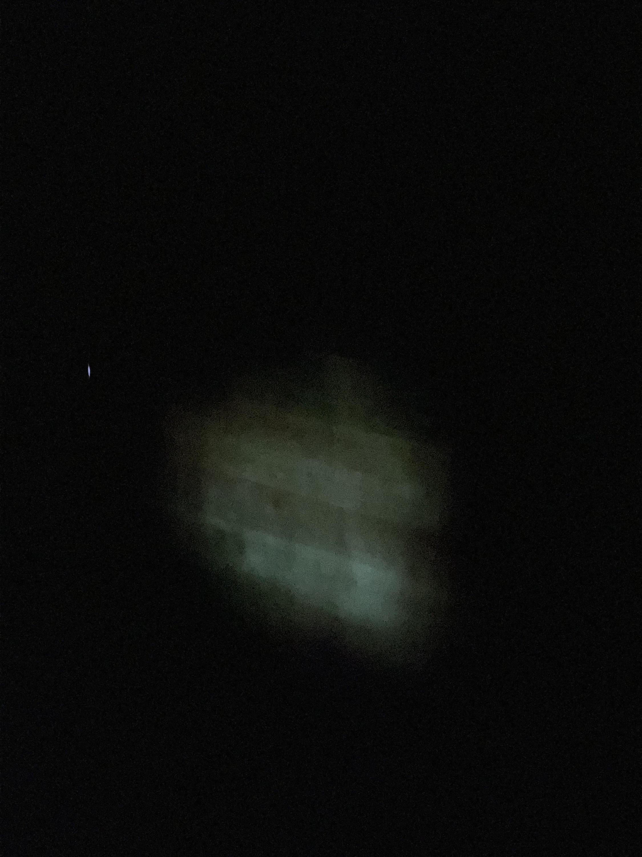

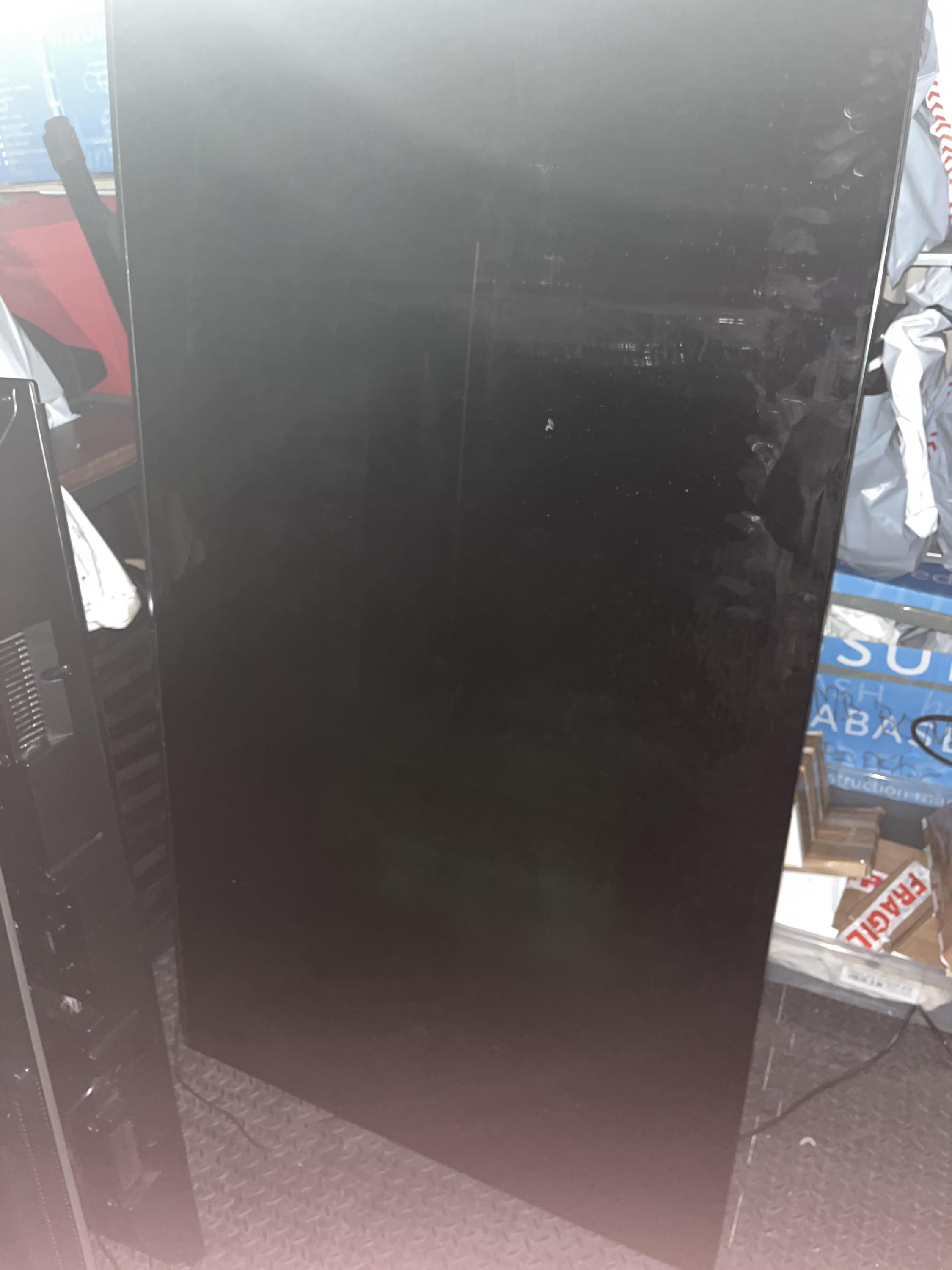

                                Sorry for jumping in i alaway tought its a panel issue. I have screpped one sony for that issue. Now i have a nice big OLED sony with simmilar issue and i wonder if its for sure panel. Any advices ?
                                Its SONY 65AF9 and it powers on with almost black screen except part of it is like cloudy gray.
                                • Diah
                                  • Feb 2013
                                  • 6363
                                  Re: Cloudy White Screen = dead TCON board?
                                  we have threat on sony OLED and its described how to test panel and t-con as stand alone.. make new threat and show us yours test result
