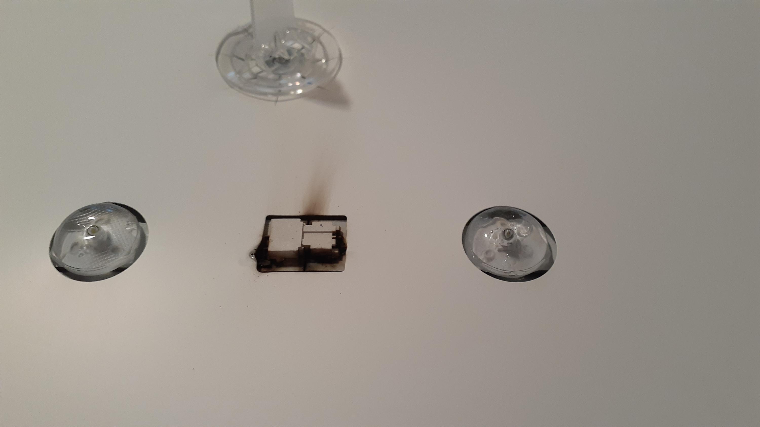

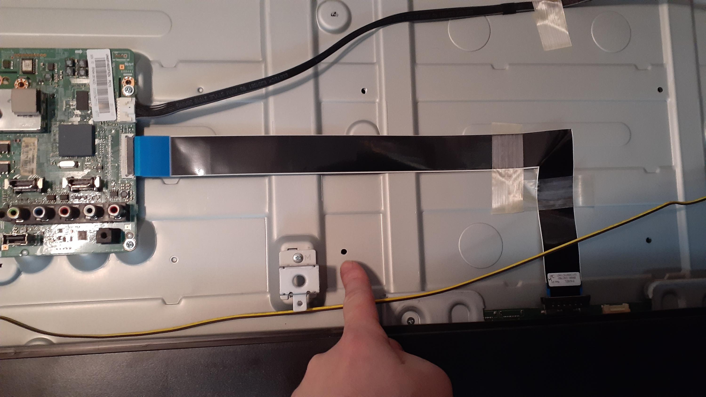

            Tried all different orientations and no change. However, I believe I found where the problem resides, and that is the backlights. While they were on and flashing, I started smelling hot electronics. I smelled around all of the boards and nothing. The smell was coming through the vent hole in the attached picture.
            Edit:
            I'm preparing myself to open up the panel for the third time.. But I have a few questions for. If an LED itself is shorted, in this particular TV, would the rest of the lights be working and that one would be off, or would it still be on? If it's shorted, can it be desoldered and replaced (I have the original set still)? And finally, if it's a short at the connector between strips, can that be repaired (ie. Electrical tape behind it)?
            I'm not up for purchasing a whole new set again as these are out of warranty now.

              Ok, looks like you need to get in there again, wonder if this is one of those models where a problem on the powerboard keeps messing up the backlights or if you have just a backlight short, bare wire, or some such.

                With that burn smell going on, I'm thinking the problem should be visible maybe.

                  That's what I'm hoping for. It seemed to be originating from near the bottom center, which it where the strips connect. Perhaps the connector it's arcing on the frame when voltage is applied?
                  So in the likelihood it's something I can easily repair, what should my expectations as far as life expectancy? I never used them at full brightness, but whatever is happening now makes me fear that their life span has been dramatically decreased.

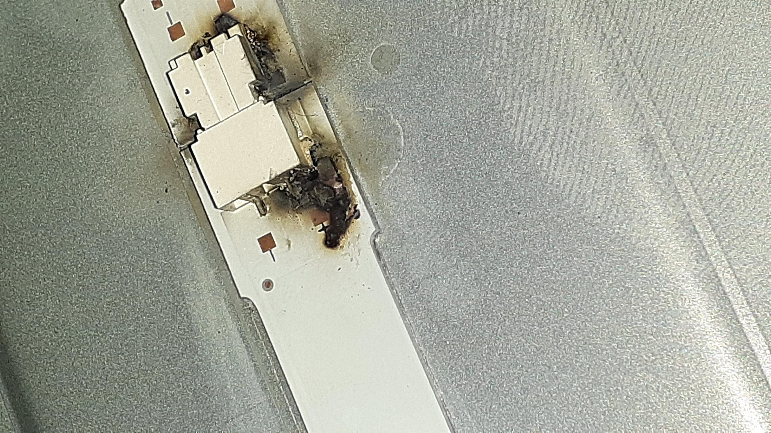

                    #89
                    Re: Samsung 60" LED blank screen and WILL NOT STAY OFF

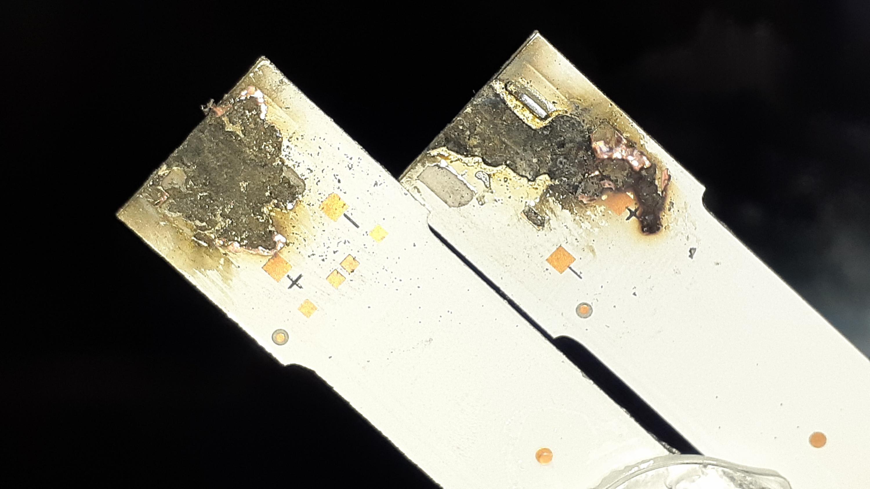

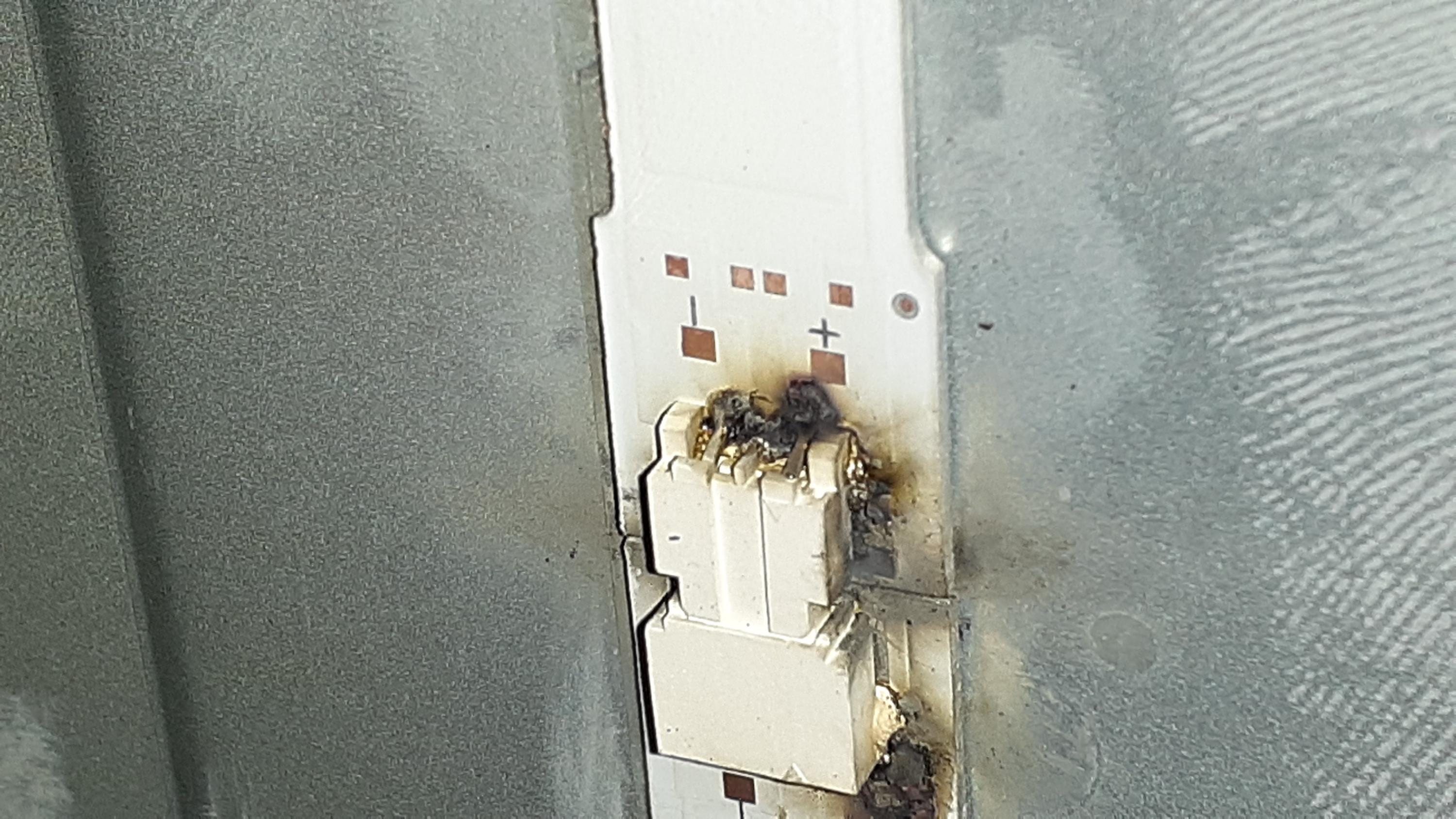

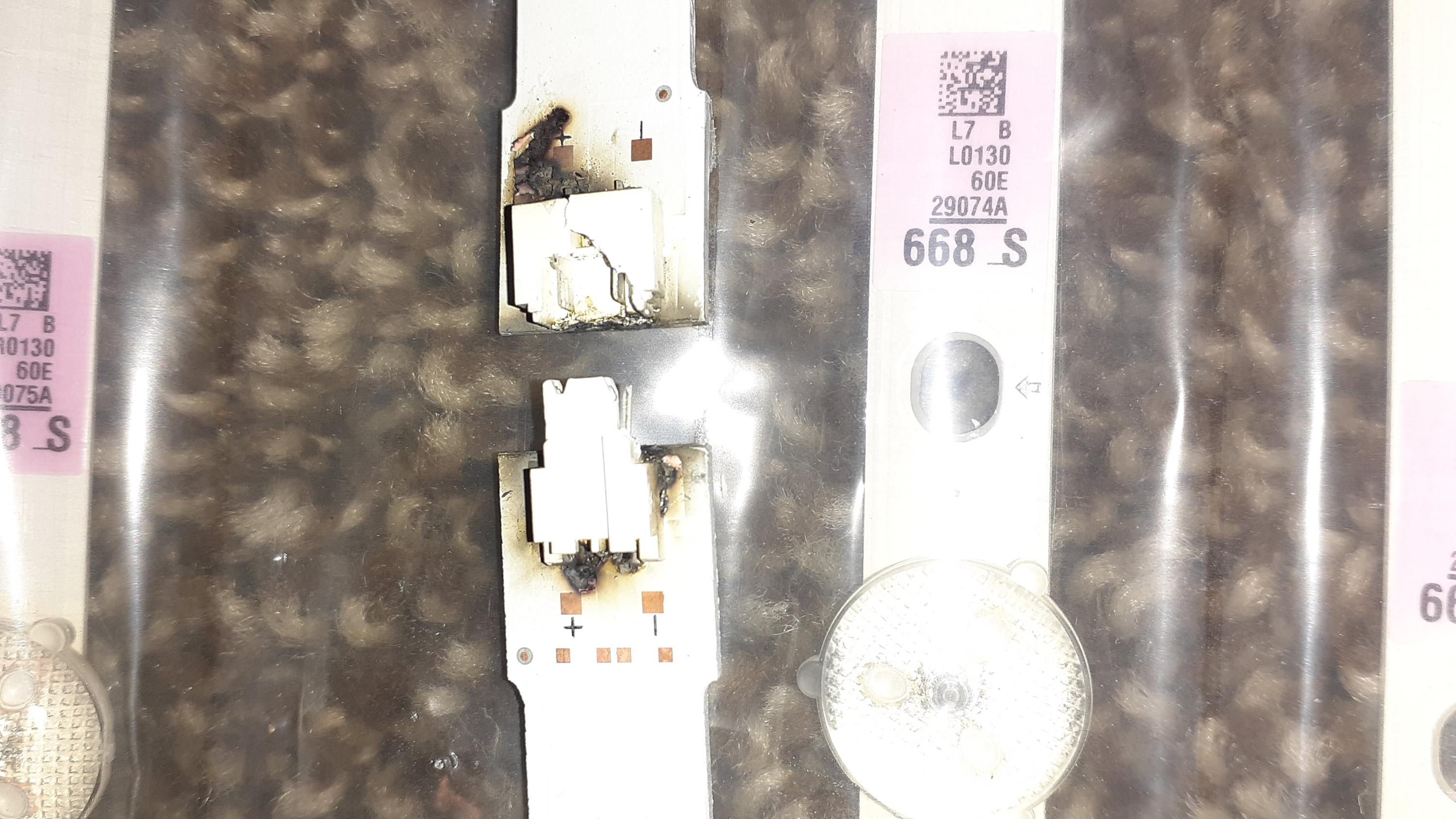

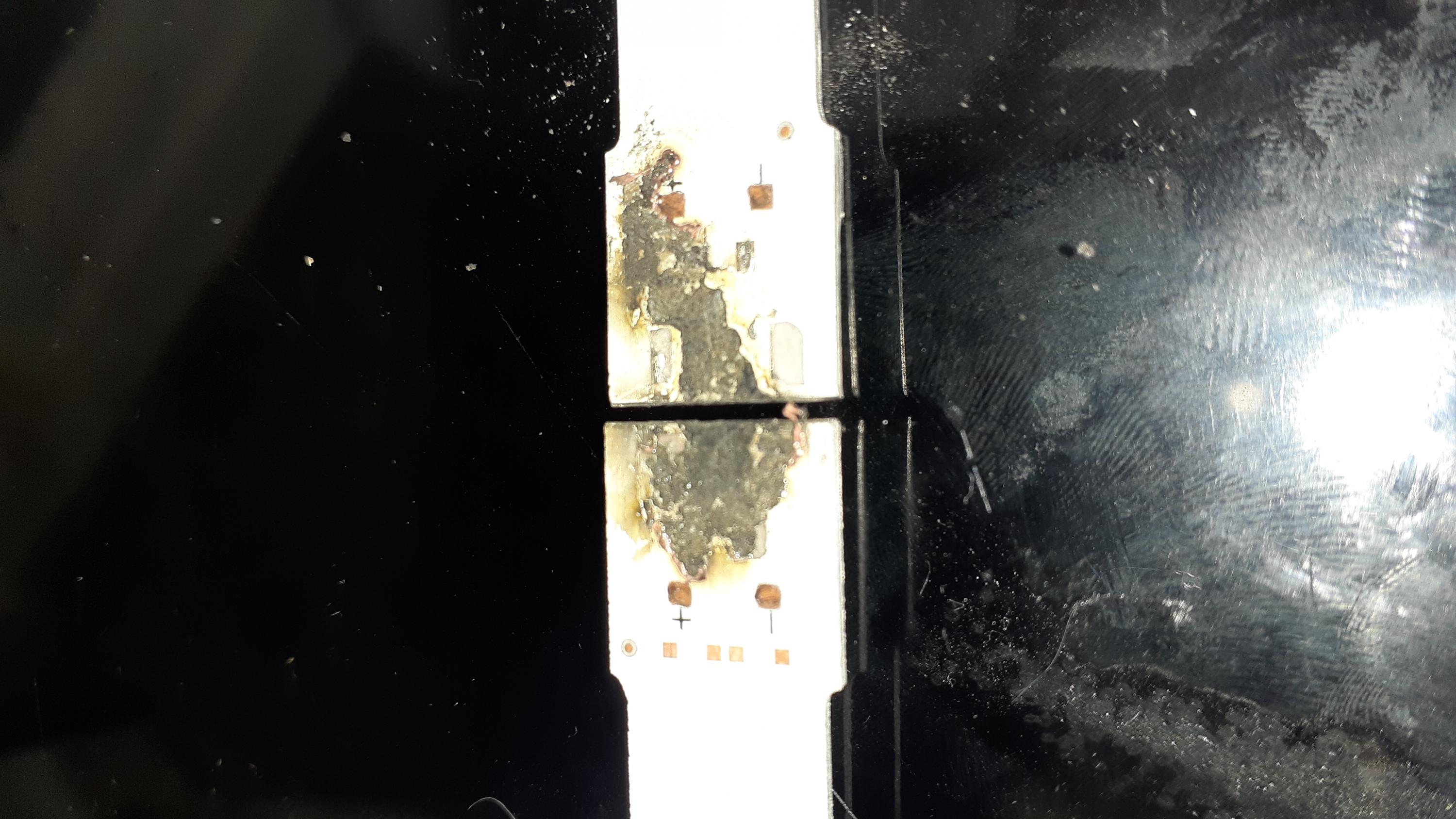

                    I think these pictures are self explanatory...
                      #90
                      You have bad contact resistance on the connector so it is heated up like that.

                        #91
                        Can I repair this or does this strip need to be replaced?
                        Edit:
                        Trying to pull the strips back to place something anti-cunductive resulted in the connector falling apart.
                        Checked eBay and someone wants nearly $20 for a single used strip. So, could I remove the connector and solder wires between the connection points?
                        • R_J
                          • Jun 2012
                          • 9628
                          #92
                          I would just remove both plugs and connect them with wires, then make sure non of the connections touch the metal panel. Then also inspect the other connectors while it is apart.
                          It looks like they had poor solder connections between the plug and the strip, Then it started arcing and burnt the trace. So you might want to resolder ALL the strip plugs

                            • nomoresonys
                              • Jan 2013
                              • 12323
                              • U.S.
                              #94
                              Funny a brand new strip is of such poor quality, time for a refund on that junk.

                                    • x_orange90_x
                                      • May 2015
                                      • 765
                                      #98
                                      After removing the connectors I can see it's burnt straight through down to the aluminum backing. I'm afraid if I solder a wire to it that it will end up arcing or electrifying the entire aluminum strip AND chassis when mounted.
                                      I'm going to try and see if two of my old strips (the originals out of this TV) are will work and probably use them instead. I hate to have to resort to it because they probably don't have that great of life expectancy left in them

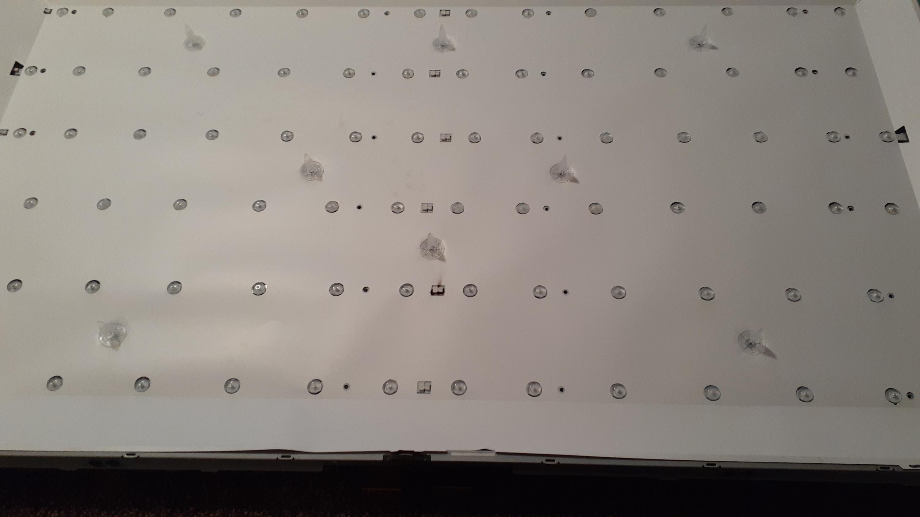

                                      • x_orange90_x
                                        • May 2015
                                        • 765
                                        #99
                                        I replaced the strip with one of the original in which i half-ass tested and seen each led blink, but upon reassembly and inspection it is bad. Good news is that upon plugging in the TV it was in standby, and turning it on resulted in a full successful powerup with everything functioning as it should... Except for backlights. So either i coherse SJ into replacing this one strip, or I purchase a used one from eBay :P

                                          #100
                                          I'm going to have to resort to using a string of the original lights, if I can find a set that works. Is it possible for me to test the Backlights outside of the TV? I seen it done inside of the TV with 9v batteries, but as I said that was inside and plugged in. I bought a bunch of 9v batteries but couldn't get the stands I was checking to light up.
                                          Also, when I have the panel apart, is there a way to trick the LEDs into being on without the panel connected to the tcon?
