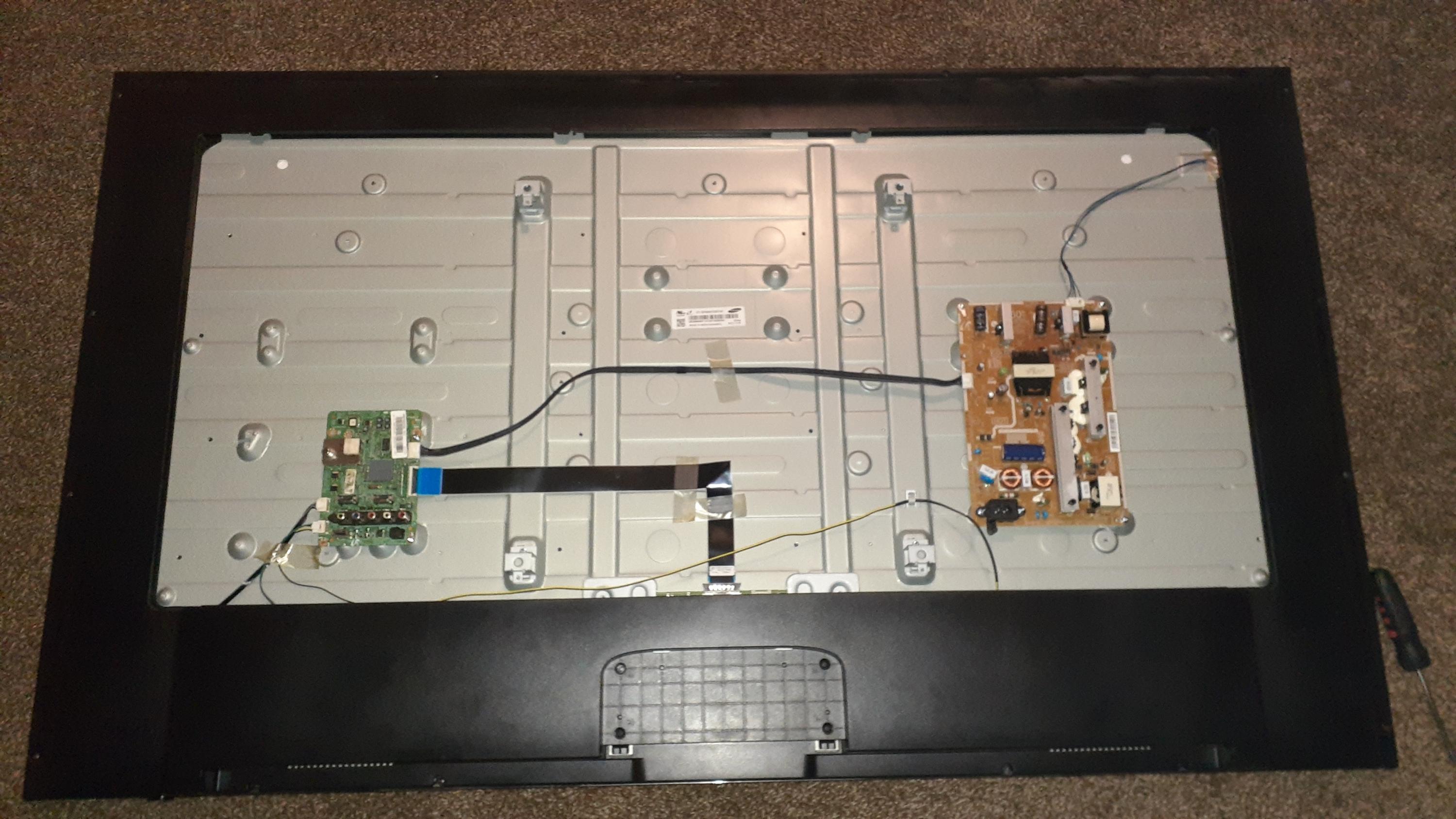

              Re: Samsung 60" LED blank screen and WILL NOT STAY OFF
              Looks like you will need to take the back cover off and look around.

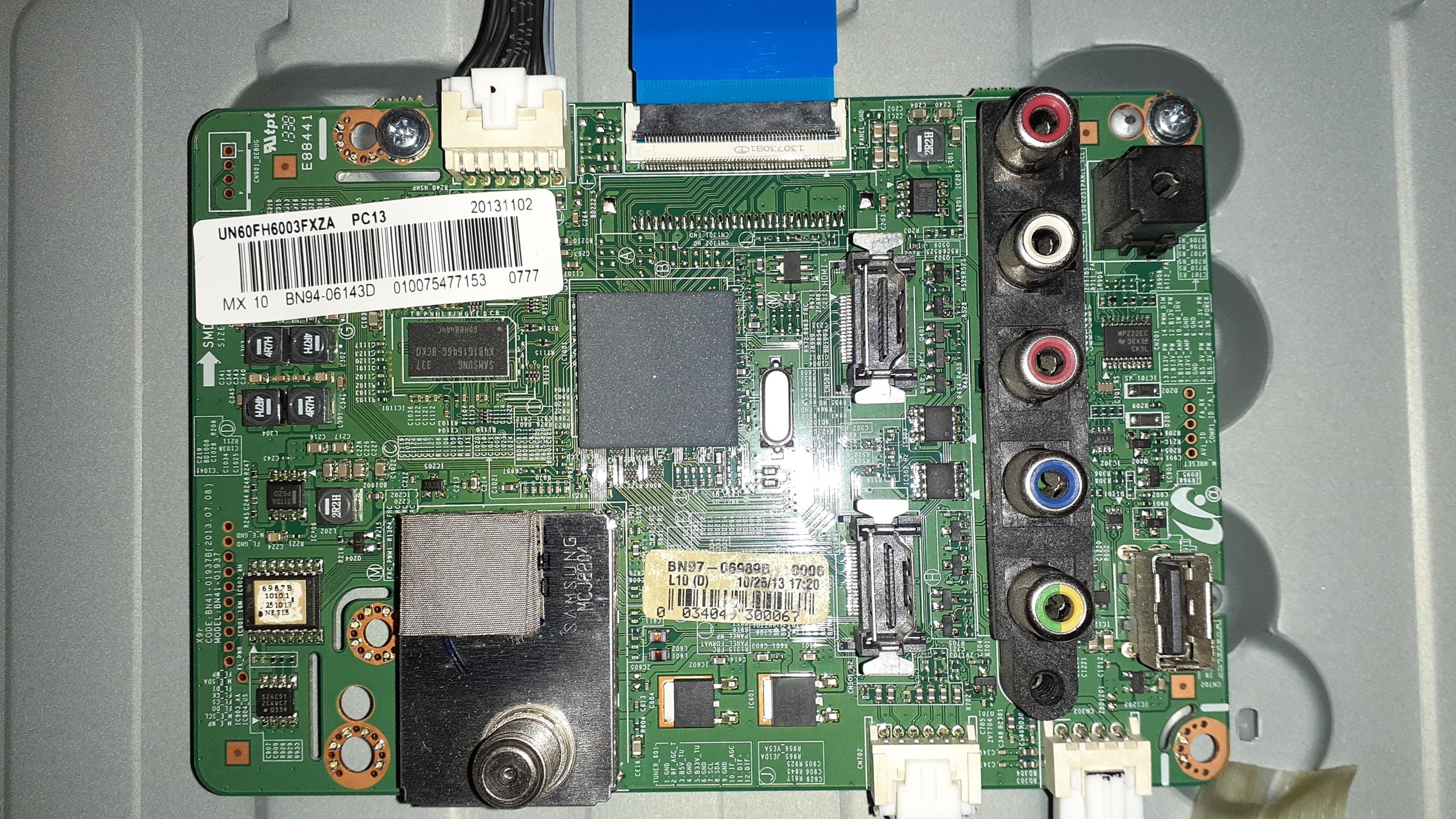

                It's a
                UN60FH6003FXZA
                If it's the main board that is bad, I found a used one on eBay for $43 and an additional $5 off coupon. Because the backlights are on and the TV powers itself on, it sounds like the main board is faulty.
                Does it sound likely?

                    I've finally gotten around to this.
                    When I plug in the power cord the TV is on and backlights are instantly lit, as I said before. If I unplug the power from the main board the backlights flash on and off repeatedly. Unplugging anything else makes zero difference... Backlights stay lit but no image.

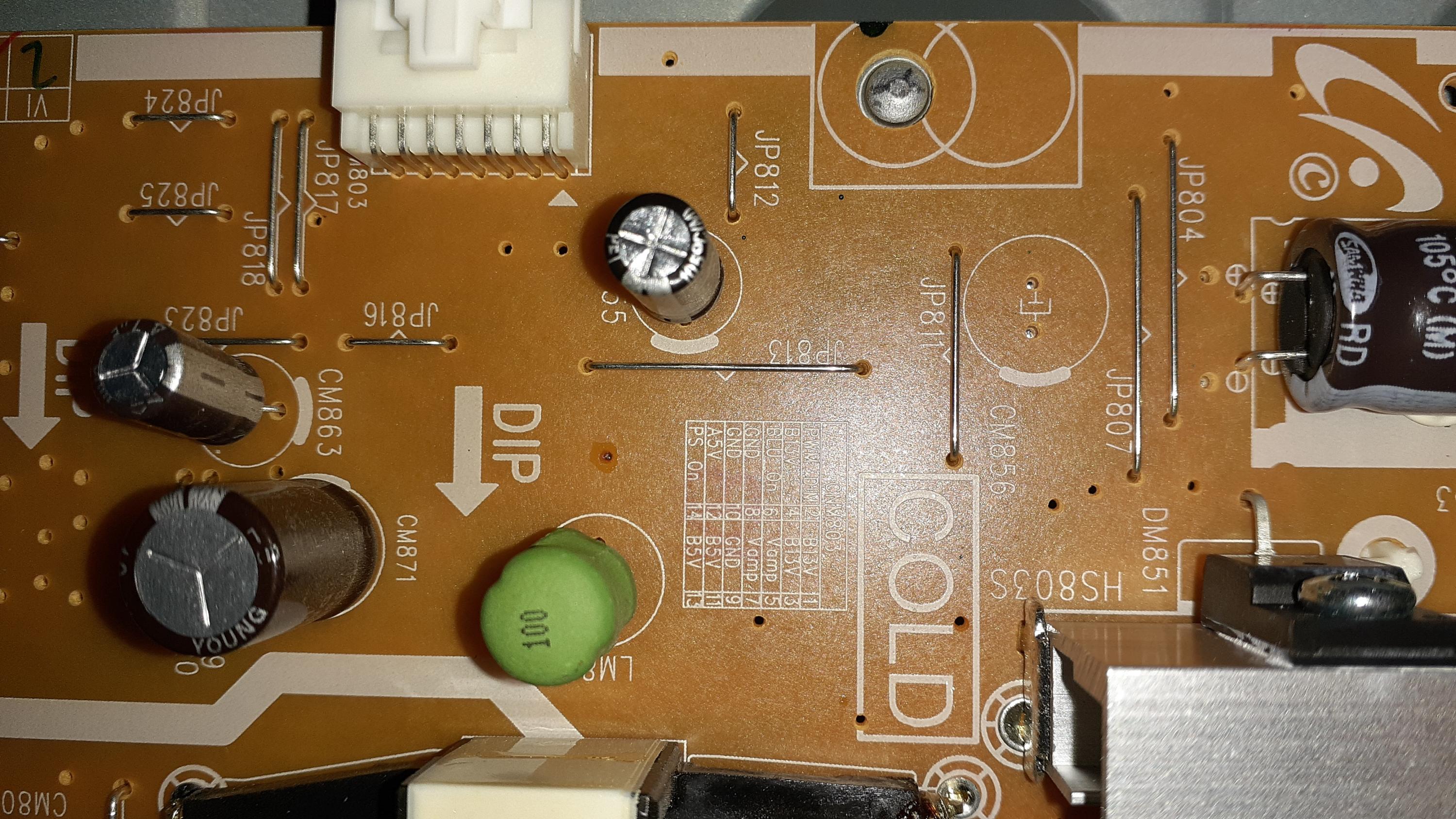

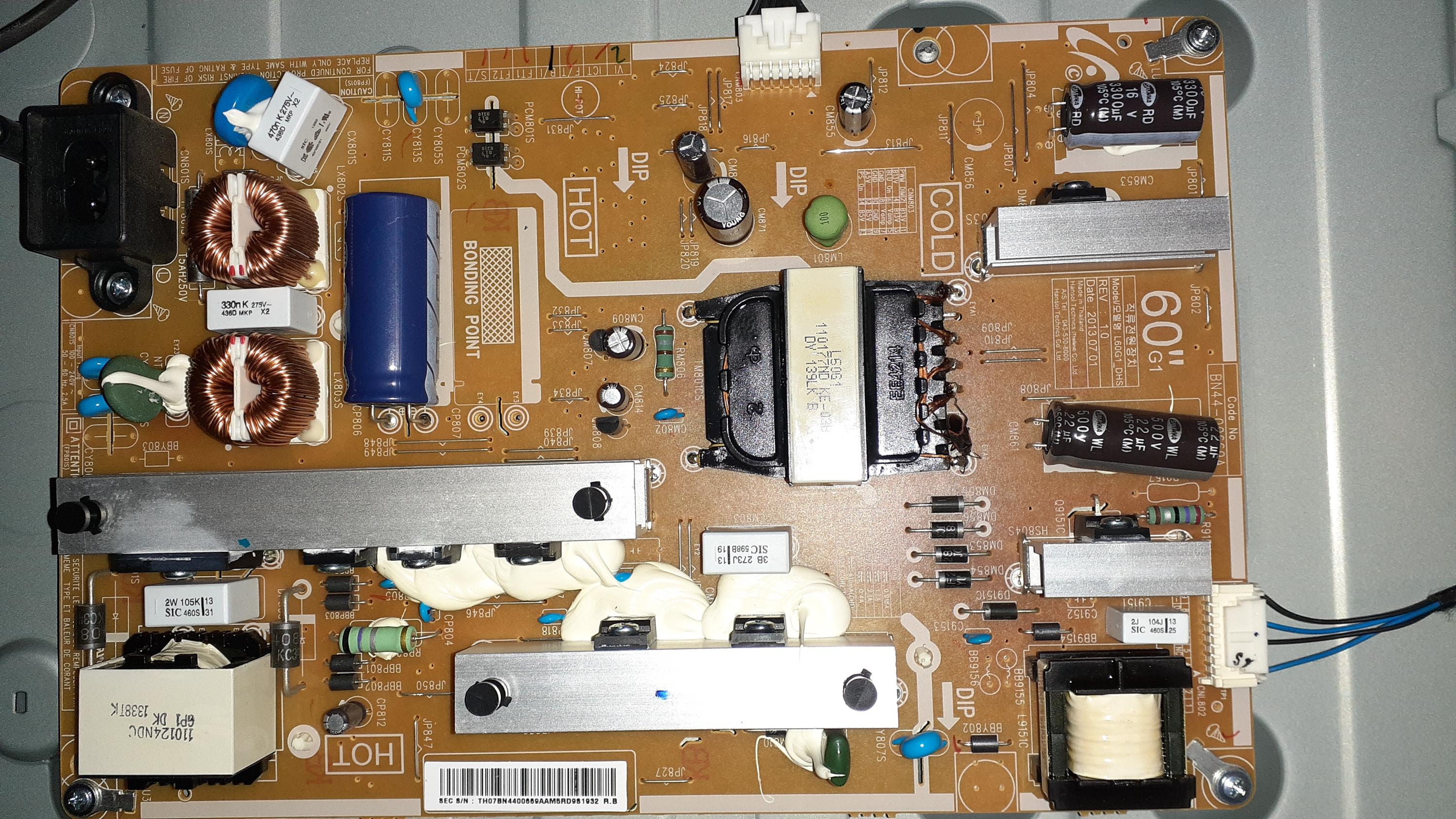

                              I tried unplugging the rocker button and nothing changes. Unplug the TV and plug it back in and it instantly lights up again. I went to check the voltages and found something very interesting. First, I found a dead bug shorting out something on the PSU (picture attached). I removed the bug hoping that was the problem, but I think instead it caused other issues. Secondly, now that I've removed the bug, the screen is off, but if I tap on the TV the backlights go on and off. There is definitely a short somewhere, and I'm really hoping it's not the backlights.
                              As for checking the voltage..I can't get any reading from any pin. I tried checking a 16v cap just to see if it had voltage, but instead of giving me a reading, my negative probe sparks against anything I ground it to, be it the negative leg of the cap or a ground screw.
                              I'm really unsure at this point.

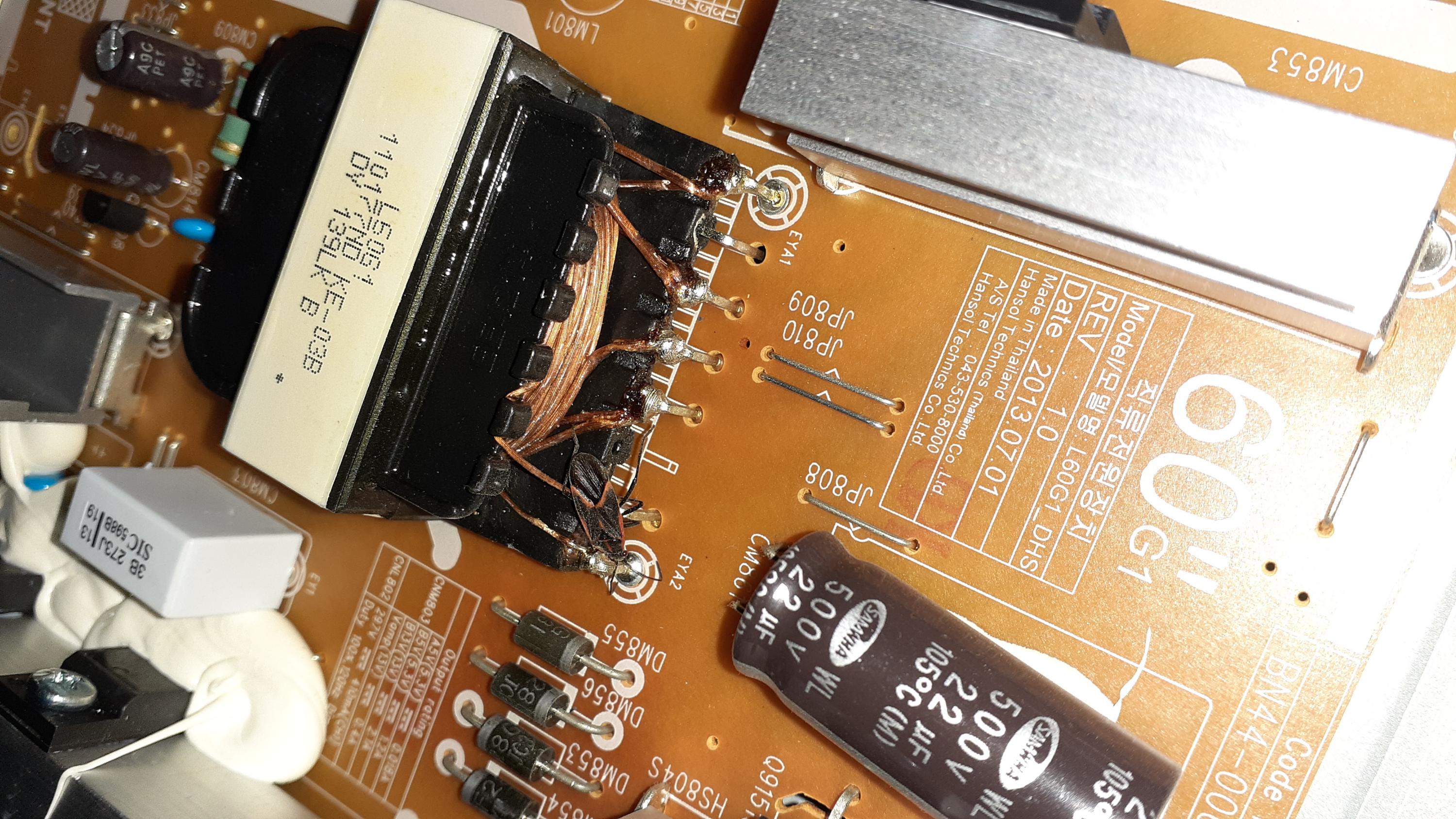

                              UPDATE 2:
                              I decided to unplug the backlights and try the old flashlight test. Sure enough I see an image. So with the image on screen I plugged the backlights back in and the following video is what happened. First the image is full but the brightness pulsates for a few seconds, then it just flashes on and off.
                              https://youtu.be/bOoy0Z9Vkc0
                              Bad cap on the power supply?
                              • x_orange90_x
                                • May 2015
                                • 765
                                With the backlights unplugged I can navigate through the menu and change settings (too dark to confidently do anything tho ��), but as soon as I plugged them in the TV locks up and I can't access menus, change channel, volume, etc.
                                Every time the backlights flash I can hear something on the PSU... I'm guessing it's a very quiet relay or transformer or something. It's acting like there's not enough power to keep the set functional AND the backlights on together.
                                  First check the voltage ACROSS the main capacitor CP807, It should be around 160vdc in standby (tv off) and around 380vdc with the tv ON. This will confirm the pfc circuit is working.
                                  Then check the voltage on CNL802 (you need to monitor this voltage when the tv is first turned on)
                                  Pins 1&2 should be around 297 volts
                                  pins 4 or 6 should be around 140 volts
                                  pins 8&9 should be around 10~20 volts
                                  You may want to remove the power supply board and check the solder connections on tms801cs (near the roch) and any of the transistors mounted on the heatsinks.
                                    Thanks for the response! I will check those, however I won't be able to get a standby voltage for CP807 because the TV is never off while plugged in.
                                    EDIT:
                                    Tried to check CP807 with the power on and got a big spark. Now the TV does NOTHING. No Standby light, no flashing screen... NOTHING.
                                      Post a picture of your meter and how the probes were connected. and post a picture of the board focusing on CP807. I suspect you had your meter probes in wrong. Or you slipped and shorted CP807 to JP848
                                      There is no other reason this would happen.
                                      You likely blew the main fuse and maybe damaged the bridge rectifier, check the four diodes in the bridge.
