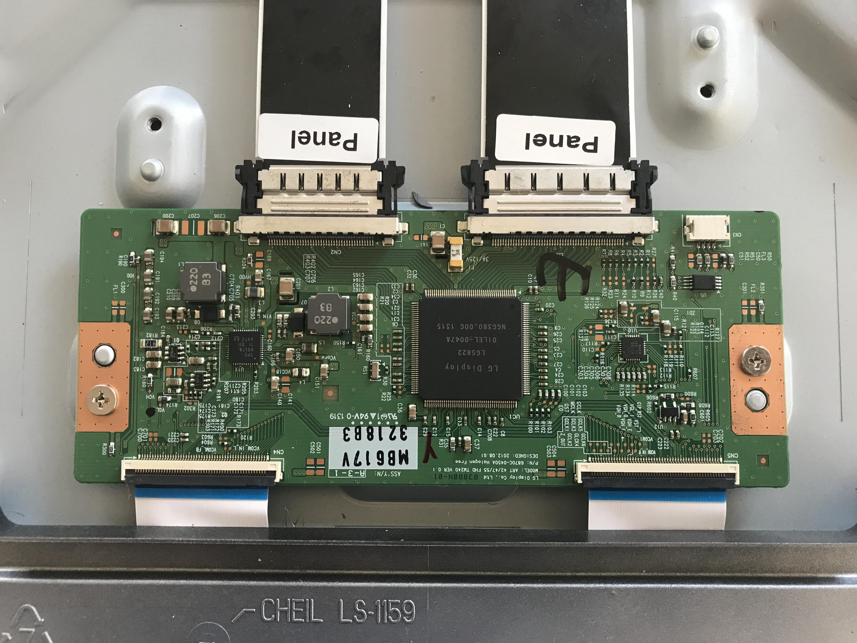

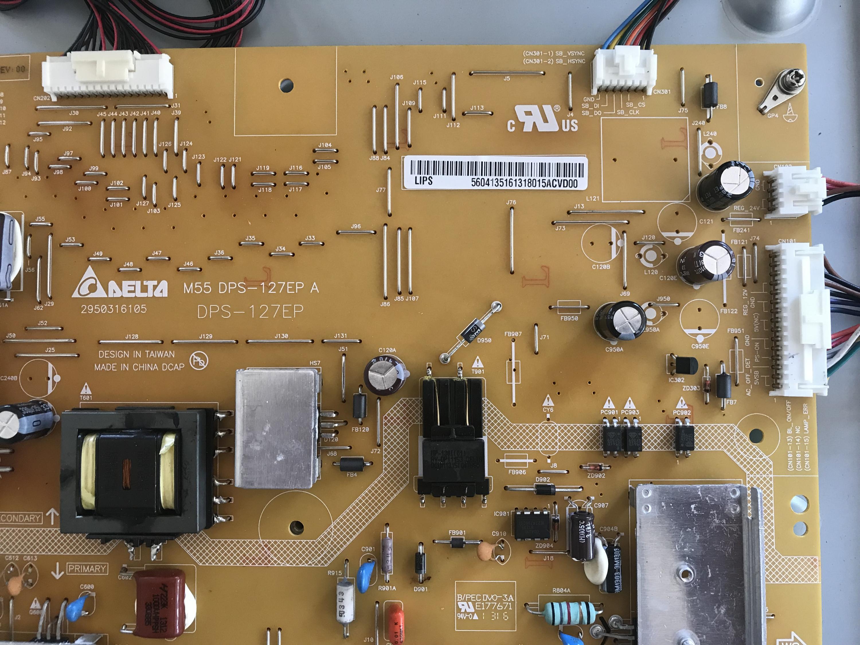

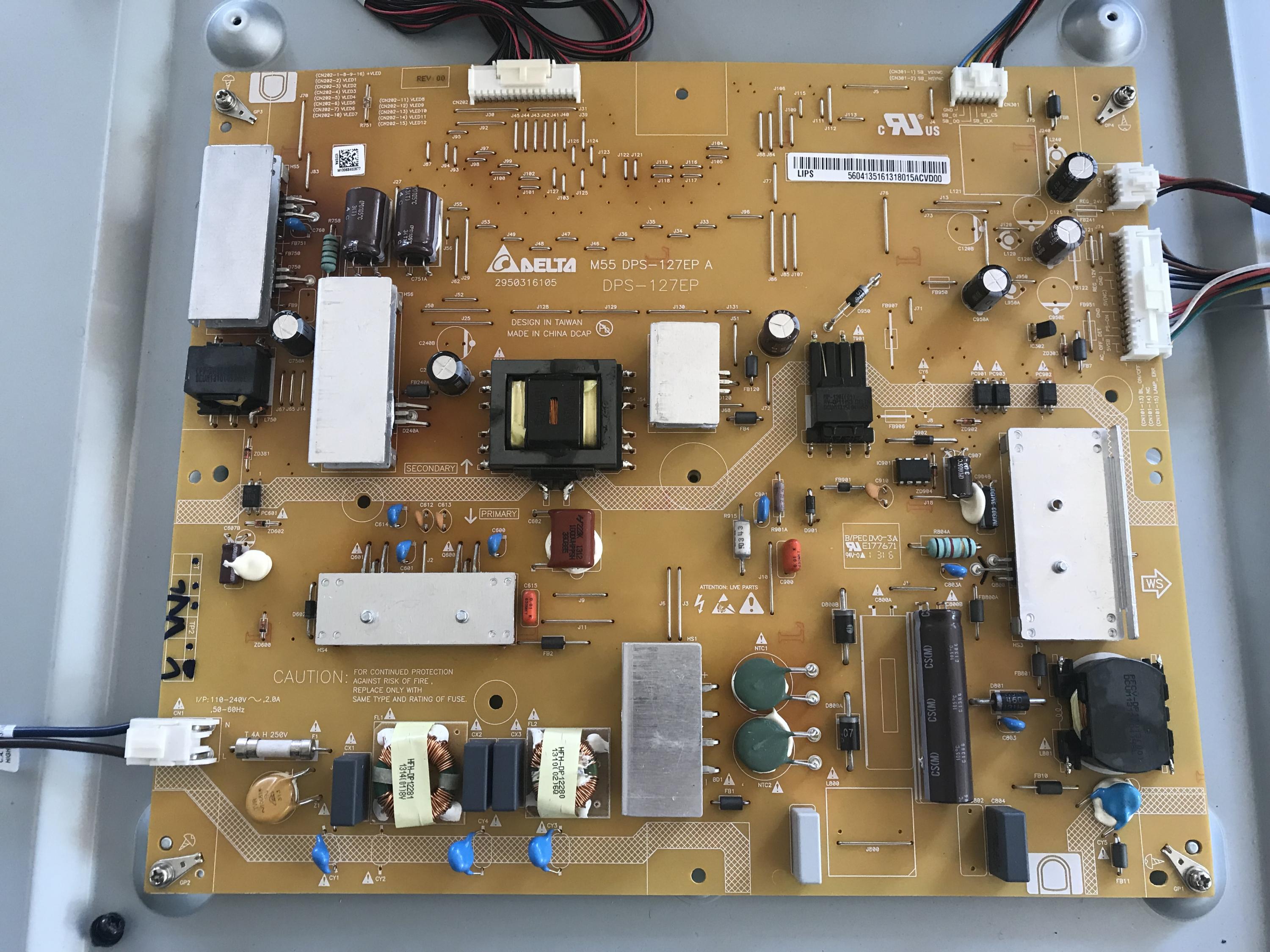

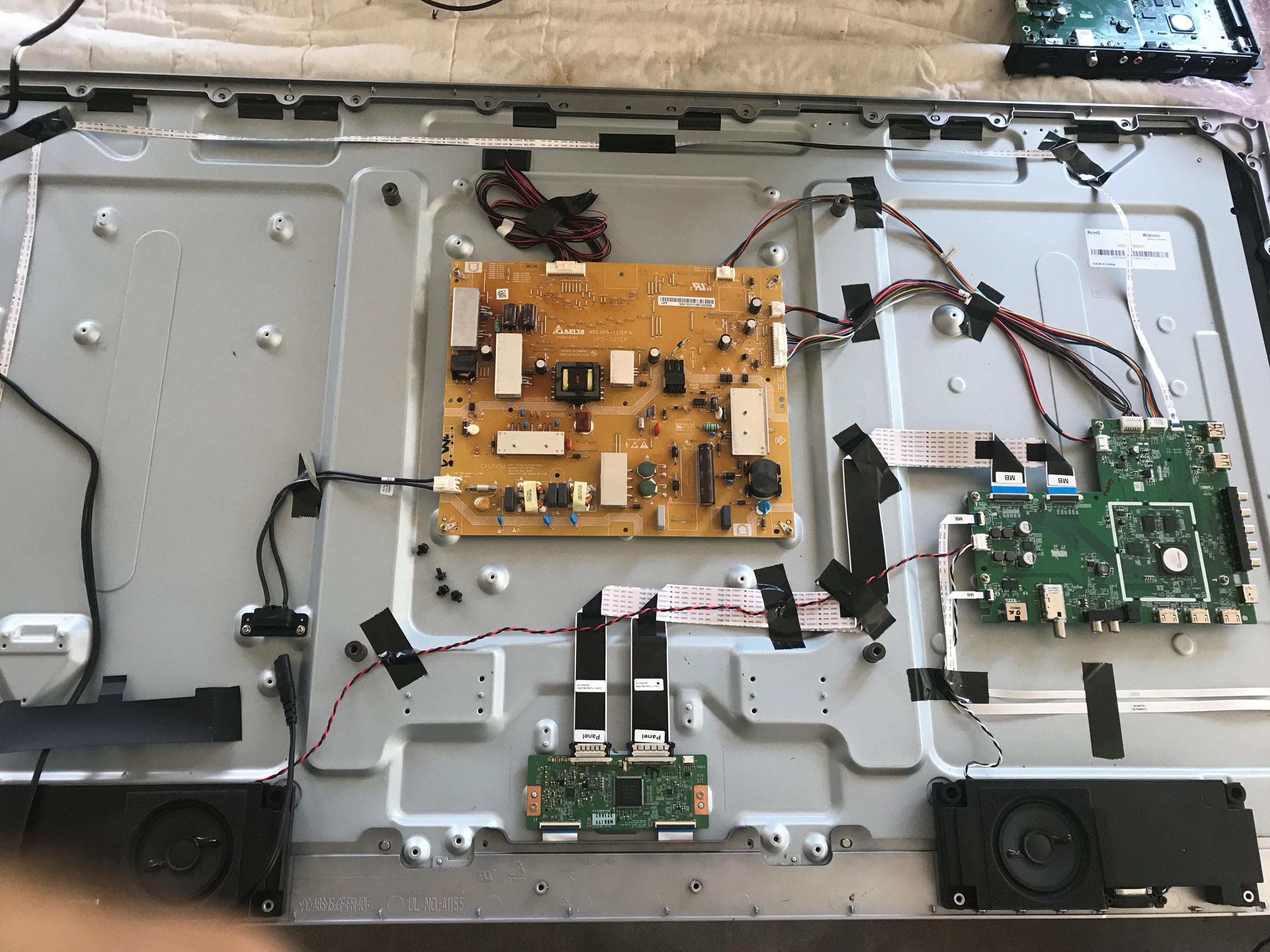

    Vizio M551d-A2 Serial Number LWJJOJDP No Picture No Sound No Backlights - Please help with me this one. On CN101 pins 1: 5v, 2: 5V, 3: 3V, 4: 3V, 5&6: GND, 7&8:NA, 9&10:GND, 11&12: 12v, 13: 0V, 14: 0V, 15: 3v. On CN102 pins 1 & 2: 24v. On CN202 pins 1,8,9,16: 39.4V. No voltage at F1 on the TCon board. I'm lost on this one, Thanks for any help.

    Is the tcon fuse good?

      You didn't label all the pins. Test connector from mainboard to powerboard on powerboard side with all boards hooked up, test with tv plugged in but off then hit power, report both conditions here, give pin number, pin description/name and condition both off and when you hit power on. So we can see all the voltages and what they are doing.

        Thanks nomoresonys, TCon fuse is good. TV power switch or remote does not change anything with these voltages.

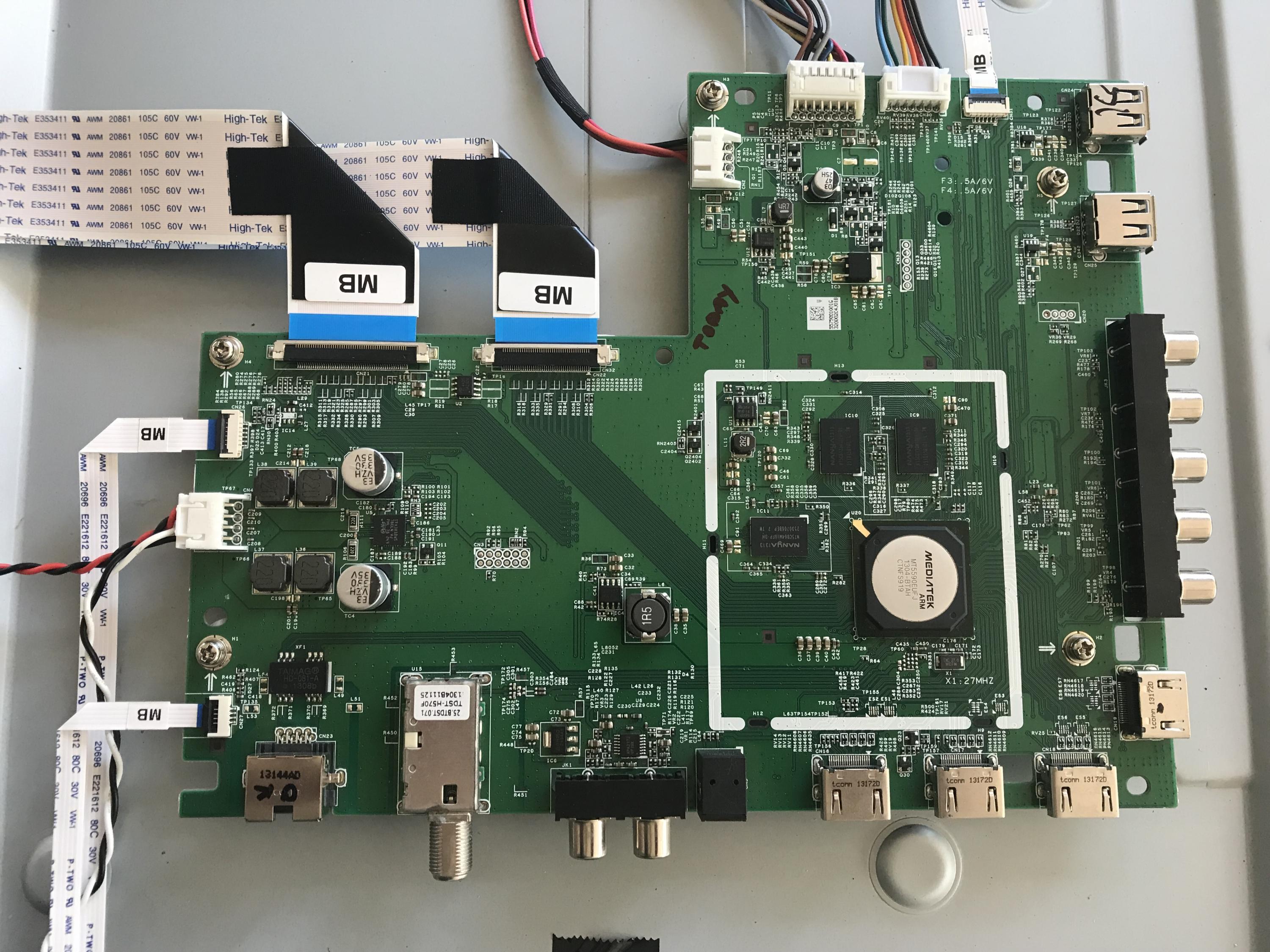

          Is Fuse F10 on main board good/

            Thanks again everyone. Main's F10 is good.
            CN101
            1&2 5VSB:5V
            3 AC OFF DET: 3V
            4 PS-ON: 3V
            5&6 GND
            7&8 5V(NC):not used
            9&10 GND
            11&12 REG 12V: 12V
            13 BL ON/OFF: 0V
            14 NC
            15 LAMP ERR: 3V
            CN102
            1&2 REG 24V: 24V
            3&4 GND
            CN202
            1,8,9,16 +VLED:39.4
            2-7,10-15 VLED

              Well never mind, customer picked up tv said I taking too long. Had it for 5 days, some people... Thanks Sorry to be a trouble

                Looks like mainboard wasnt sending bl-on signal.
                • budwich
                  • Jul 2015
                  • 3097
                  Re: Vizio M551d-A2 No Picture No Sound - I Don't Understand
                  lamp error... likely either a led or driver problem. Likely the customer tossed.

                    15 LAMP ERR: 3V, this is the clue for lamp error? would it have 0 volts if no lamp error?
