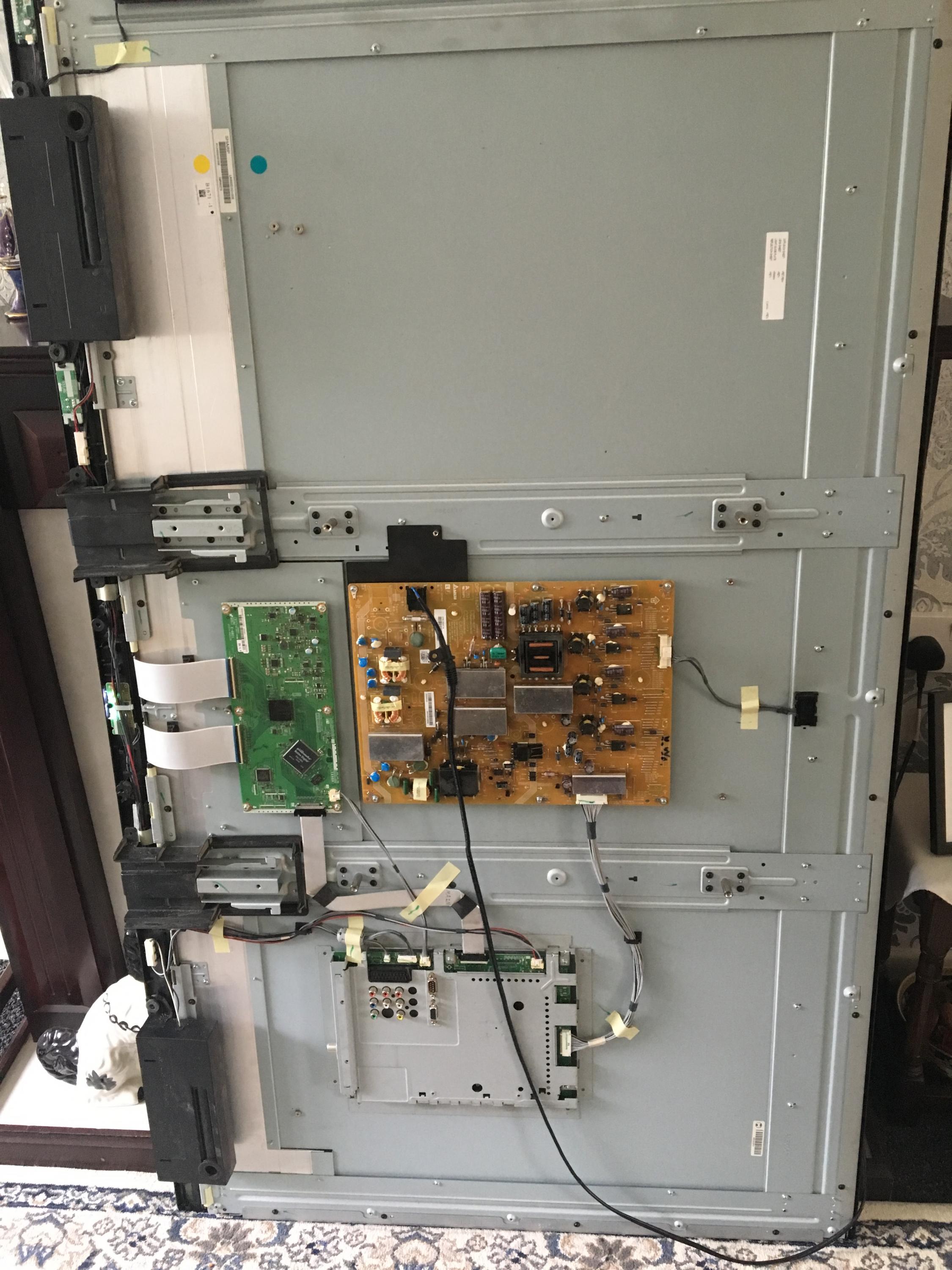

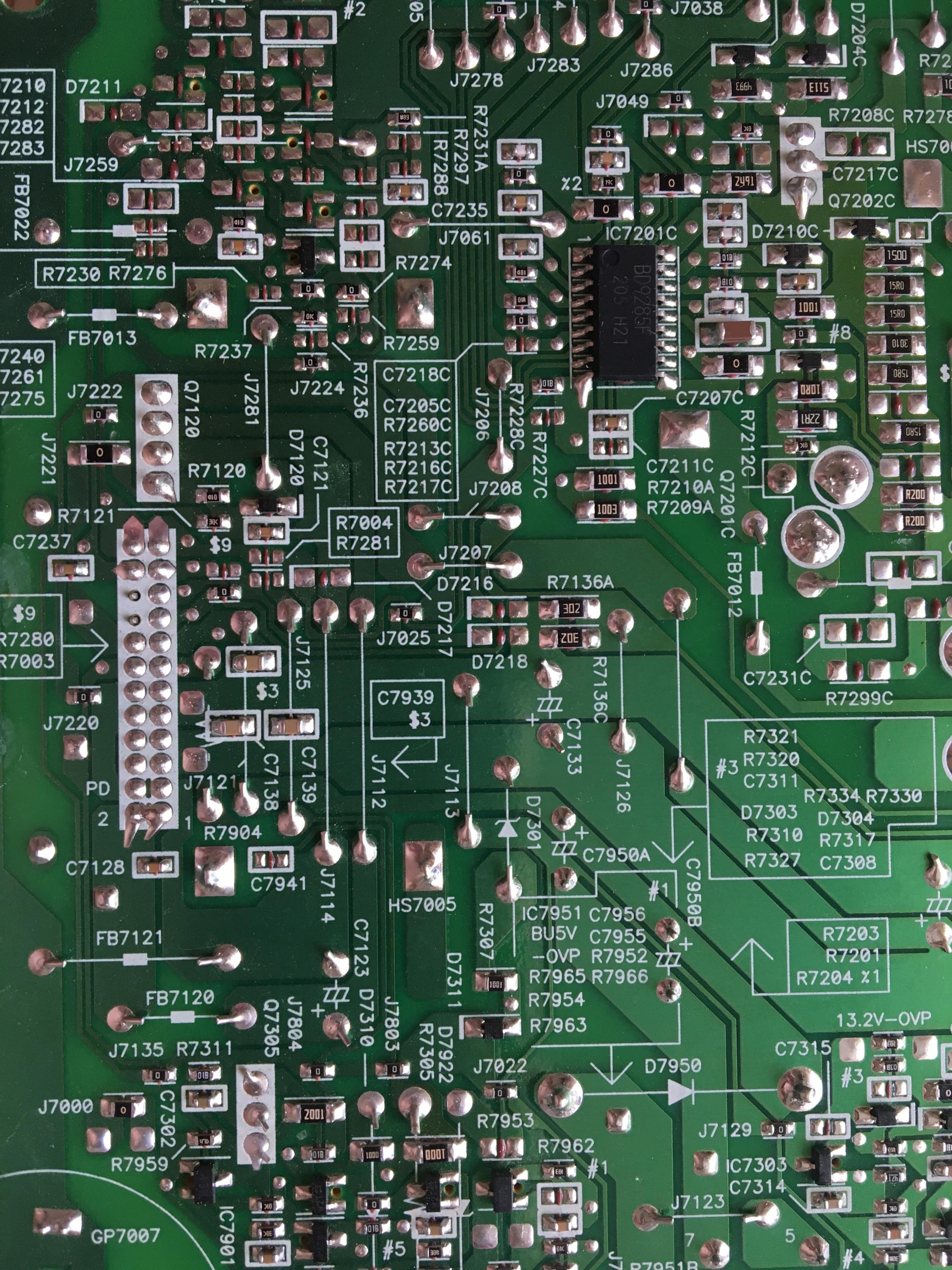

    Hi Guys
    Just bought cheap this Sharp LC-60LE741E, seller said can not get it out of standby
    Got it home plugged it in and it powered up, however after maybe 2 minutes it powered off itself and has not come back on since.
    When powering on white led at bottom centre comes on steady for about two minutes (nothing on screen) then goes off, White led then comes back on flashing three times
    I can not find what this flashing code is, all I am finding is 1 quick flash then 2 short flashes, Mine is 3 flashes all same length
    Did find a reset involving think it was volume down and input held whils plugging in but that had no effect
    Only thing I have checked up to now is for 5V standby on powerboard which is there.
    My first thought is powerboard but maybe it is the mainboard
    When tv did first power up picture seemed good for the short time it was on
    Any ideas please as to what these 3 flashes are telling me
    thanks

        I am struggling at the moment to check powerboard Vs, but looks like I have no 12v at pins 1 and 2 on PD

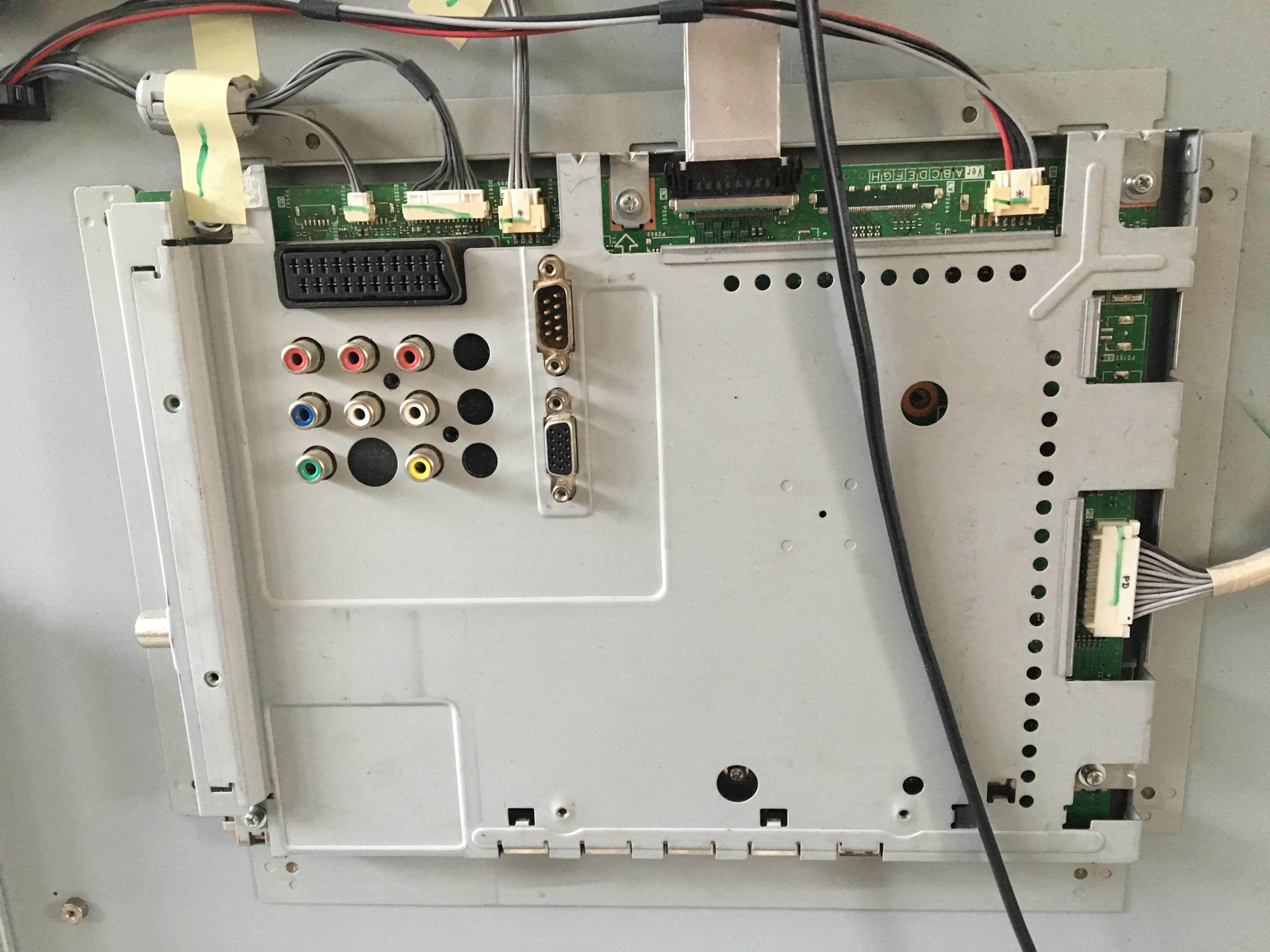

          Do you have backlights? If not (with tv unplugged) unplug cable from powerboard to mainboard, plug tv back in, see if they come on.
          • london-freddie
            • May 2015
            • 472
            Re: Sharp LC-60LE741E 3 Blinks
            No backlights come on with powerboard to mainboard cable unplugged
            Does not a BL on signal from mainboard to powerboard tell the powerboard to turn on the backlights, or am I wrong

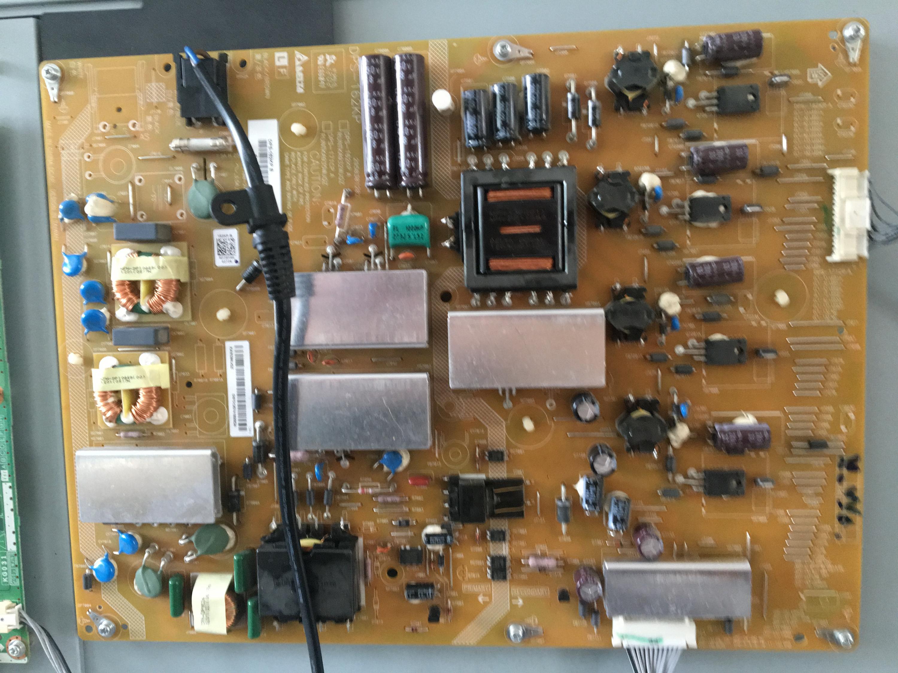

              I have been trying to follow a youtube video SHARP AQUOS TV "LC-60LE650U" flashes 3 slow, 1 fast. No back light or sound. Here's the fix. by Ray S
              On checking my regulator, mine is a slightly different board I also have no 12v coming out from the regulator, this 12v seems to go to pins 1 and 2 on the PD connector but I also have no turn on volts at the regulator.
              Am I on the wrong track here ??
                underside of powerboard Q7120 I believe is the 12v regulator

                  You need to report what Voltages you have on the power supply connector that goes to the main board so we can see what it has or does not have when TV is off and when power switch is activated, that will be the starting point.

                        https://www.badcaps.net/forum/attach...6&d=1561560221
                        BTW, what is the board P/N as printed on the board and on the bar code stickers?
                        You can probe the connector from the wire entrance side using skinny probe tip.

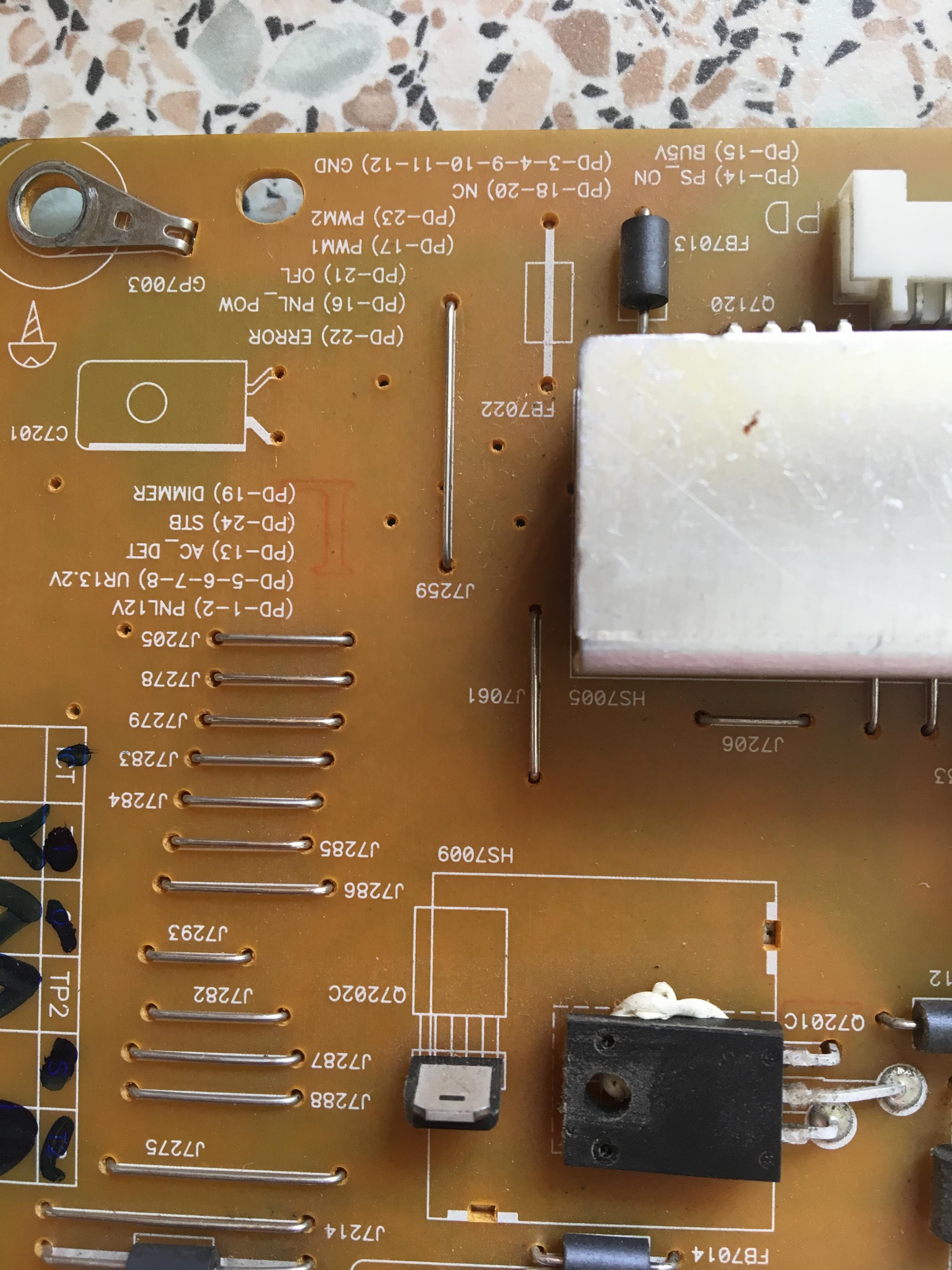

                          Ok budm got what you want
                          PIN
                          1 PNL12v 0V
                          2 PNL12V 0V
                          3 GND
                          4 GND
                          5,6,7,8 UR13.2 13.23v
                          9,10,11,12 GND
                          13 AC_DET 3.35V
                          14 PS_ON 2.87V
                          15 BU5V 5.09V
                          16 PNL_POW 0.2v
                          17 PWM1 0v
                          18 NC
                          19 DIMMER 0v
                          20 NC
                          21 OFL 0.2v
                          22 ERROR 0v
                          23PWM2 0v
                          24 STB 0v

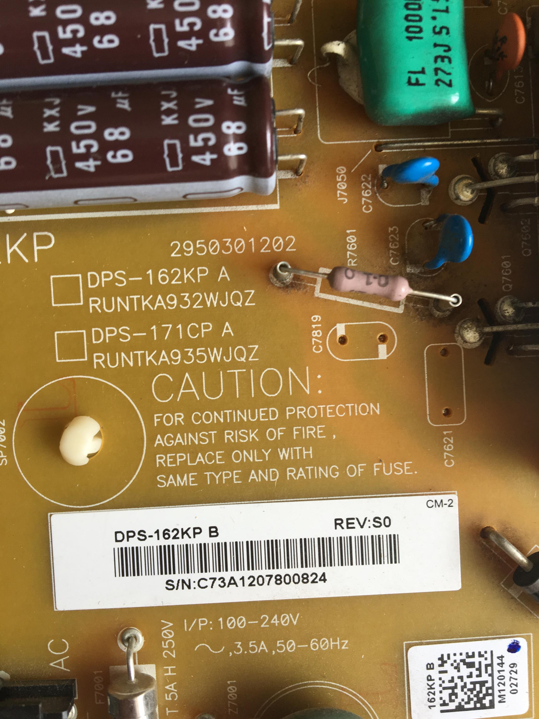

                            Board number is

                              417V on Main caps

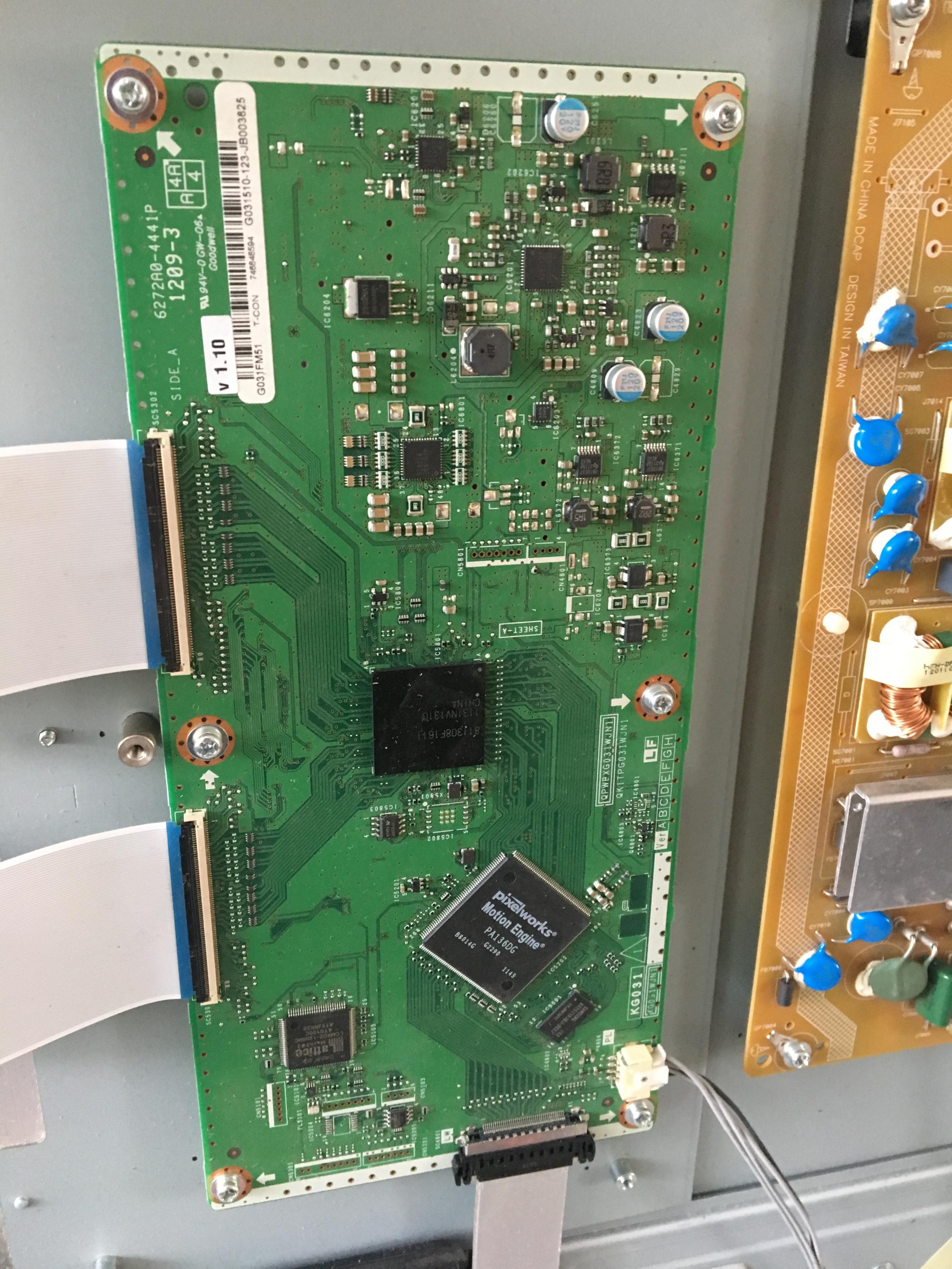

                                PIN
                                1 PNL12v 0V: No output because PIN 16 PNL_POW is not present
                                2 PNL12V 0V
                                3 GND
                                4 GND
                                9,10,11,12 GND
                                13 AC_DET 3.35V
                                14 PS_ON 2.87V
                                15 BU5V 5.09V
                                16 PNL_POW 0.2v Bad, should be 3 ~ 4 VDC from main board
                                17 PWM1 0v: Bad
                                18 NC
                                19 DIMMER 0v: Bad (this analog Dimming may not be used)
                                20 NC
                                21 OFL 0.2v
                                22 ERROR 0v
                                23PWM2 0v: Bad
                                24 STB 0v: Bad, this is the BL-ON signal, should be 3 ~ 4 Vdc.
                                So something is going on with the main board or something is locking out that causes it not to send out some of the command signals.
                                  417V on Main caps
                                  This is quite high, it should be around 380 ~ to 400V at the most.
                                  Meter is OK?

                                    Do you have standby voltage with cable from powerboard to mainboard unplugged?
                                    • london-freddie
                                      • May 2015
                                      • 472
                                      Just rechecked main caps yes 417v as far as I am aware meter is ok
                                      are we talking standby voltage at pin 24 ?
                                        As indicated in my post #16; The STB pin is BL-ON.
                                        BU5V pins are the standby power supply pins.
