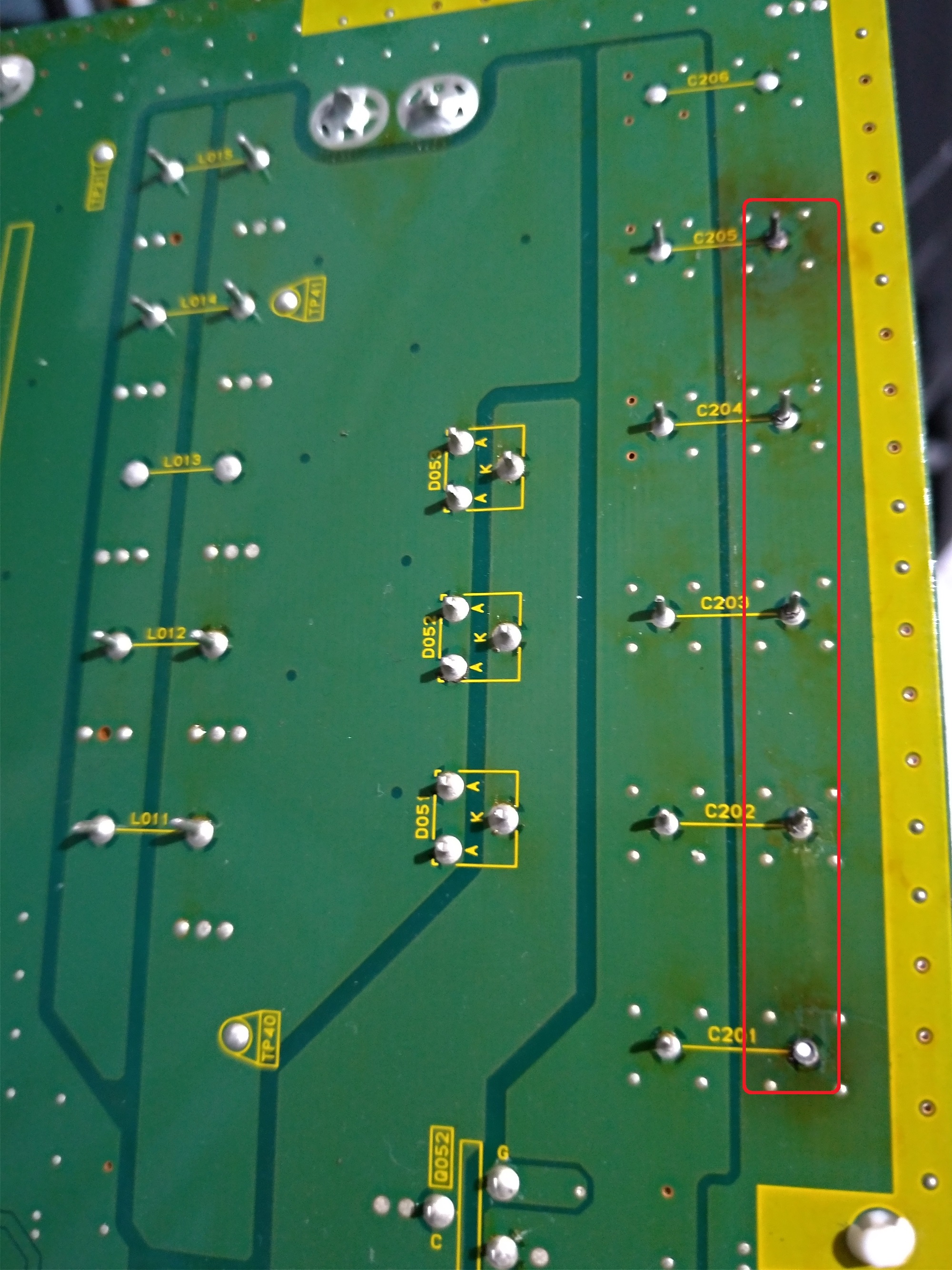

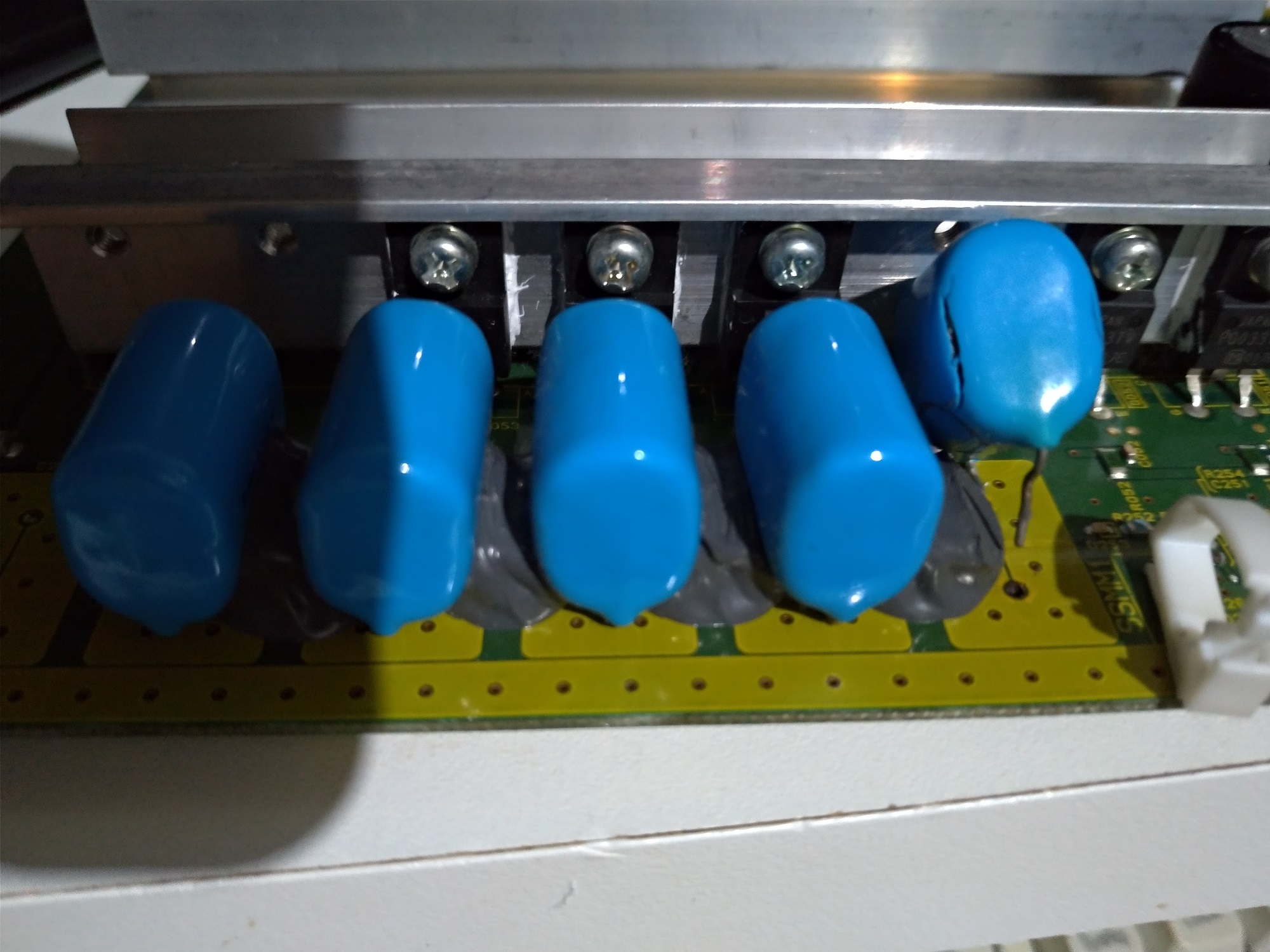

    Bought this TV used not working, panel flashed briefly on power up and it was blinking 8 times, a quick look on SS board revealed a common fault on the 3uF 250V capacitors, C201 to C205 (C1620X in the service manual), the solder joints were all cracked, C201 and C205 pins were darkened and some sparking had occurred on them, C201 was split open and clearly overheated in its last hours, replaced that one and resoldered the others, 8 blinks fixed.

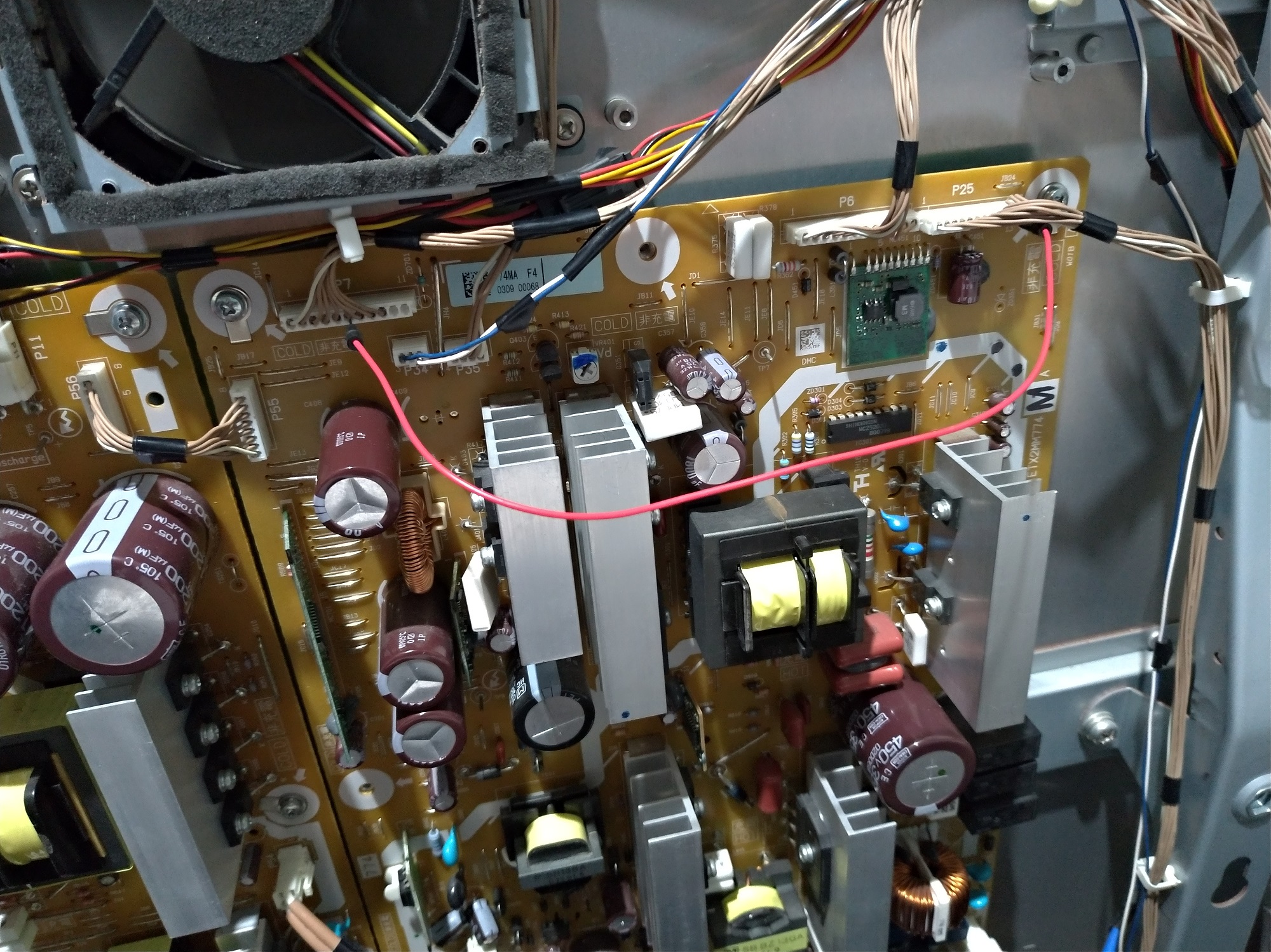

    D board is disarming PANEL_Main_ON before the TV even finishes booting, I cut Pin 11 from D25 to prevent any internal shorting and used a wire jumper from P7 Pin 6 to P25 Pin 11.
    Unplugged SC, SS, Vda, D25 and D3, effectively only powering up the main board, used the jumper from F_STBY_ON 3.3V to PANEL_Main_ON, the PFC relay switched correctly then it shut down with 1 blink error, this TV does not work with main board only, you need D board too.
    Only A and D board + fans test with jumper, it worked for about 10 seconds, before shutting down into 4 blinks POWER_SOS, so something is drawing too much current from the PSU maybe?
