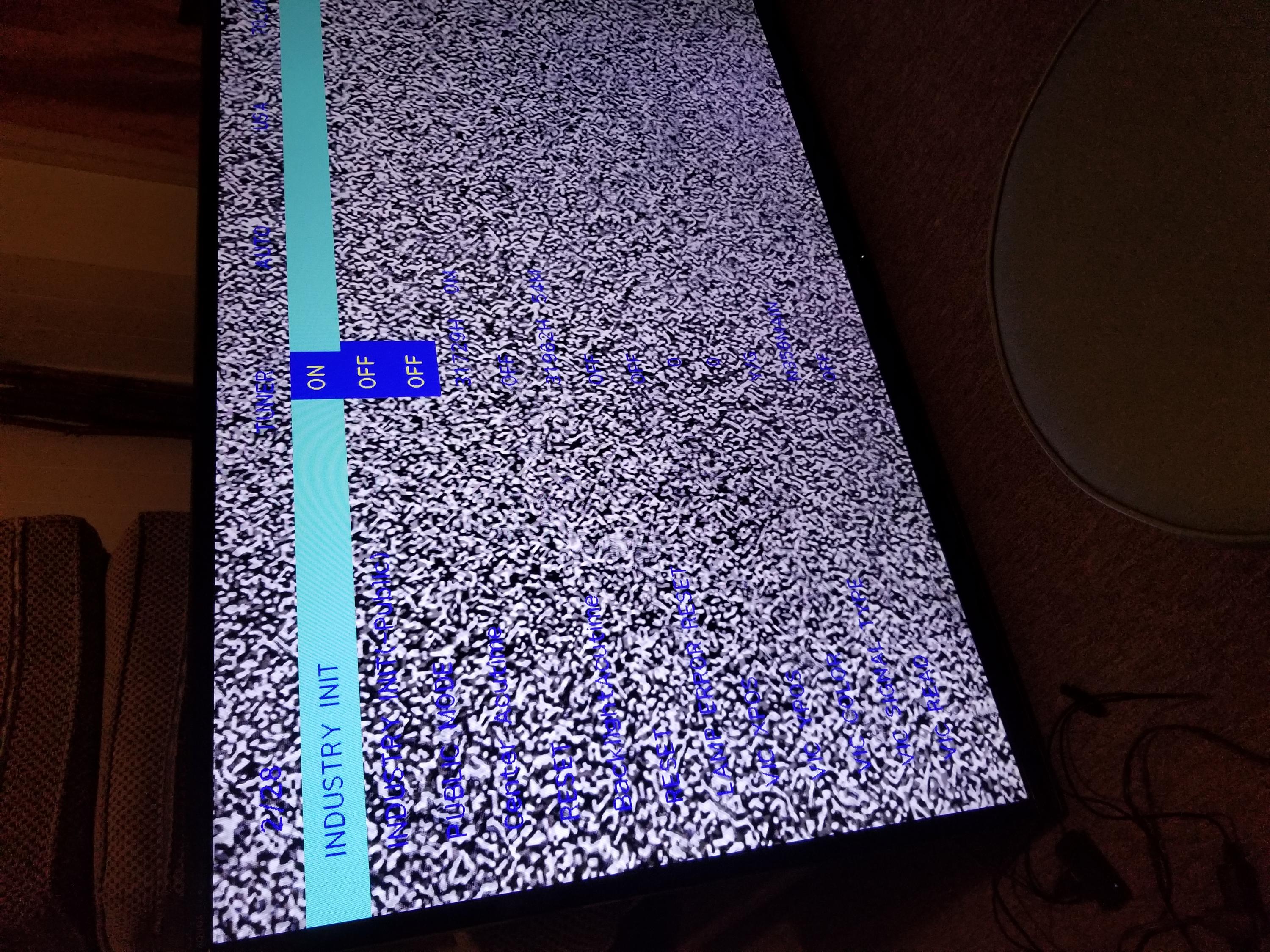

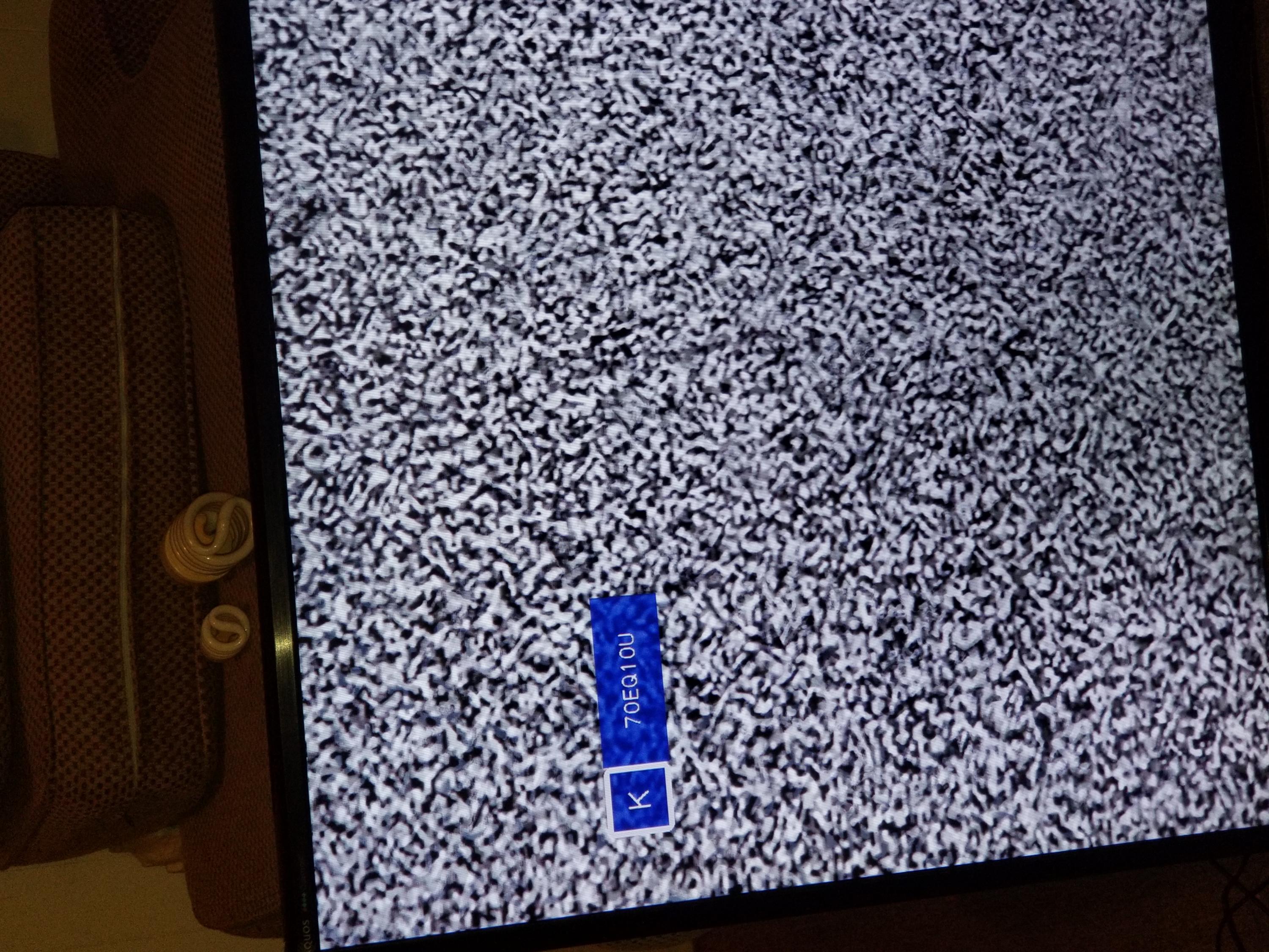

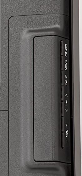

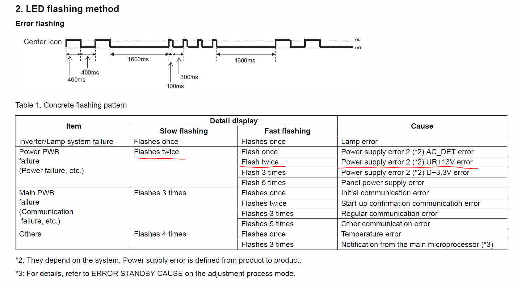

sharp LC70EQ10U 2 slow, 2 fast blinks
  • JayPoorJay
    • Jan 2022
    • 149
    sharp LC70EQ10U 2 slow, 2 fast blinks
    Good morning... I'm new here and have a LOT to learn.
    I'm a rescue-er. I live in NYC and I don't even want to get started on the amout of stuff that makes it onto the curb, to be crushed and in a land fill, simply because our repair shops have been sold out and because - well, it's a disposable society... Anywho
    I have 1 motorcycle, 3 Jaguars and a Porsche that were all headed to the crusher due to a couple handfuls of needed parts and a Lil Love,,, I'm hooked on the rescue. A member of several forums and a huge fan of DIY environments such as this one. Hats off to you all.... Anywho
    I got my hands on a 70 inch Sharp TV. When I plug it in I get two slow blinks and two fast. Nothing on the screen and no sound. Thanks to this forum and y'all sharing your hard earned wisdom and experience I went ahead and ordered a used power supply board. I will be installing that after work. I have a DMM and will happily probe for measurements and expected voltages per you all's direction at any of the components you suggest, should this not be the fix.
    As I said I have a lot to learn. Are there some key places I should be looking for specific voltages and,,,, that you can think of, should the "new" power board not be the issue?
    Is there any more or other information that I need to supply?
    Thanks in advance. Really!
  • nomoresonys
    • Jan 2013
    • 12323
    • U.S.
    Re: sharp LC70EQ10U 2 slow, 2 fast blinks
    Seems to indicate a powerboard issue, if it does the same with the new one, will have to look deeper. I certainly thank you as does the planet for doing your part to try to keep those landfills from overflowing. We need a lot more peeps with that kind of determination.
    Last edited by nomoresonys; 01-24-2022, 10:00 AM.
    • dskall
      • Oct 2016
      • 2905
      • usa
      Re: sharp LC70EQ10U 2 slow, 2 fast blinks
      You ordered a power board without checking any voltages?
      • JayPoorJay
        • Jan 2022
        • 149
        Re: sharp LC70EQ10U 2 slow, 2 fast blinks
        Originally posted by dskall
        You ordered a power board without checking any voltages?
        I did,,, it cost me just 50bucks so I'll live with the mistake... I bought it based on reading this as a solution for the same or similar problems read here and other places.
        Stull,,, I don't mind being scolded for my fool moves, lol. Jus say'n...
        • JayPoorJay
          • Jan 2022
          • 149
          Re: sharp LC70EQ10U 2 slow, 2 fast blinks
          Originally posted by dskall
          You ordered a power board without checking any voltages?
          And, to be plain honest - I didn't know which connectors or components to check. Not exactly.
          • JayPoorJay
            • Jan 2022
            • 149
            Re: sharp LC70EQ10U 2 slow, 2 fast blinks
            Seems to indicate a powerboard issue, if it does the same with the new one, will have to look deeper. I certainly thank you as does the planet for doing your part to try to keep those landfills from overflowing. We need a lot more peeps with that kind of determination.
            Thanks Man... I think it's important too!
            I hope the board is the fix but nothing is ever as simple
            • lotas
              • Jan 2016
              • 4918
              • Russia
              Re: sharp LC70EQ10U 2 slow, 2 fast blinks
              LED flashing CODE ERROR
              • vinceroger69
                • Mar 2012
                • 6714
                • uk
                Re: sharp LC70EQ10U 2 slow, 2 fast blinks
                link to the service manual
                https://elektrotanya.com/sharp_lc-60.../download.html
                • JayPoorJay
                  • Jan 2022
                  • 149
                  Re: sharp LC70EQ10U 2 slow, 2 fast blinks
                  Thanks to you all.
                  Bad news, maybe... Now I've gone and done it?
                  So, I came home found the package with the new board on the porch. Installed it. TV came right on... Great! Hooked up the Roku. Went right into my account! Perfect! But no sound. I check audio settings and saw allllll "levels" had a dark gray circle with a slash thru it, indicating that changing them was not available and the buttons wouldn't allow me to scroll thru any of the bass, treble, balance etc.
                  Here's where I blew it. I went to do a factory reset with NO REMOTE and following a YouTube video I got to the section where it instructed to "hit/hold enter"... I had NO enter button, no remote. So I was stuck in the middle of the reset without being able to complete it. I sat there for a few looking stupid and finally just hit power and turned it off.
                  Now, TV will come on and not stay on. Goes off after about 5 seconds to one slow blink, one fast blink. Will not stay on. While it is on, for a short time, I can see input options and even all of the menu options for just a few seconds,,, but then it shuts to the blinking pattern described.
                  I can get it to go to the "K" and "reset" screen by holding the input and volume down buttons, can get it to curse thru items - to "factory INIT", can scroll to "on" "off" changes but NO enter option...
                  I've ordered a remote.
                  Worse,,, I think the biggest mistake is that I didn't update any firmware before getting stuck in the middle of the reset...
                  I'll wait for the remote of course - but what now?
                  Am I screwed?
                  Last edited by JayPoorJay; 01-24-2022, 04:50 PM.
                  • Diah
                    • Feb 2013
                    • 6614
                    Re: sharp LC70EQ10U 2 slow, 2 fast blinks
                    Originally posted by JayPoorJay
                    I've ordered a remote.
                    well if you connect yours TV with LAN to yours router.. on the google play many sharp remote can work via IR if the android mobile had one or via internet connection at same router.
                    • JayPoorJay
                      • Jan 2022
                      • 149
                      Re: sharp LC70EQ10U 2 slow, 2 fast blinks
                      Ok. I'm hearing you. But I think my problem now is I can't get to settih on the tv to sign in...? If so, how do I do that in my current situation?
                      • Diah
                        • Feb 2013
                        • 6614
                        Re: sharp LC70EQ10U 2 slow, 2 fast blinks
                        Originally posted by JayPoorJay
                        Ok. I'm hearing you. But I think my problem now is I can't get to settih on the tv to sign in...? If so, how do I do that in my current situation?
                        just plug yout TV with LAN cabel to yours router.. and via yours android mobile go to google play and instal any of sharp aquos remote apk on yours mobile.
                        • JayPoorJay
                          • Jan 2022
                          • 149
                          Re: sharp LC70EQ10U 2 slow, 2 fast blinks
                          The TV is nowhere near my router and cable hookup. And it's big. Is there any other way at this point or do I just need to wait for the remote?
                          • Diah
                            • Feb 2013
                            • 6614
                            Re: sharp LC70EQ10U 2 slow, 2 fast blinks
                            Originally posted by JayPoorJay
                            The TV is nowhere near my router and cable hookup. And it's big. Is there any other way at this point or do I just need to wait for the remote?
                            ohh man.. yours tech sorry to say close to 0. now yours tv hookedup with router.. .. turn on the tv using the side panel at the back.. the tv will take ip from the router. now your phone ( mobile ) go to google play market.. there are alot programm to be remote to sharp.. and all free... install any you like so you can control the tv via yours mobile program
                            • JayPoorJay
                              • Jan 2022
                              • 149
                              Re: sharp LC70EQ10U 2 slow, 2 fast blinks
                              Even if I were to plug a LAN line into the TV the tv is not staying on long enough to get into settings to supply a password, or would I need one if directly plugged in?
                              Next worry, is even with a remote (one that is not already paired with TV) how will I use it to press "enter" on that factory reset screen?
                              I think I messed up, what WAS going pretty good, pretty bad. This sucks.
                              • Diah
                                • Feb 2013
                                • 6614
                                Re: sharp LC70EQ10U 2 slow, 2 fast blinks
                                plug it out from wall socket and plug out the lan with router...
                                go back to yours replacement boards and be sure all socket in place correct..
                                leave the set over night to drop down the electricity.. then try tomorrow again to turn it on
                                • JayPoorJay
                                  • Jan 2022
                                  • 149
                                  Re: sharp LC70EQ10U 2 slow, 2 fast blinks
                                  Ok... In the mean time,,, I can get it here (see pics). They are not easy to get a photo of.
                                  As it is now I have no way to plug it into a LAN line.
                                  I'll shut it down and unplug it. See what happens tomorrow.
                                  • Diah
                                    • Feb 2013
                                    • 6614
                                    Re: sharp LC70EQ10U 2 slow, 2 fast blinks
                                    Originally posted by JayPoorJay
                                    I'll shut it down and unplug it. See what happens tomorrow.
                                    and wait for the remote before you turn it on again
                                    • Diah
                                      • Feb 2013
                                      • 6614
                                      Re: sharp LC70EQ10U 2 slow, 2 fast blinks
                                      BTW input are the inter command with side panel menu will be as back too sound + or - & program + &- could be use to move up or down.
                                      • JayPoorJay
                                        • Jan 2022
                                        • 149
                                        Re: sharp LC70EQ10U 2 slow, 2 fast blinks
                                        Ok! I got it. Working in the factory reset screen area, holding down V down and Channel down,,, working real fast with the buttons on the side of the unit, I was able to work thru the menu to finally select "factory reset". After that, alllll functioning went back to normal. I now have sound and am able to connect to my home internet network. So far so good... Brother, thanks for you time and attention. All of y'all, actually. Thank you!
                                        • joblo37pam
                                          Sharp LC-80LE844U Blinks 2 slow, 5 fast
                                          by joblo37pam
                                          It's been a while since I've checked in here or needed input on narrowing down what to replace on a TV repair, but I've got one on my bench now that has me wondering. The lack of part (board) availability means I may need to do some component-level diagnostics, and a second opinion is always good when it comes to that.
                                          The issue - Sharp LC-80LE844U does not display. Power light comes on for a while, then you can hear a relay click off and the light blinks twice slow, then five times fast. Service manual points to 'Panel Power Supply Error' with this code, but isn't much more help...
                                          10-26-2023, 02:17 PM
                                        • Caimano
                                          hp Pavilion 14 CE-1XXX 5 fast 3 slow blinks or cmos checksum error if restarted immediately after shutdown or suspend
                                          by Caimano
                                          hp Pavilion 14 CE-1XXX
                                          MB G7AD-2G DAG7ADMB8D0 REV D
                                          Processor i5 8265U
                                          AFAIK schematics or boardview are not available for this MB, but I used a similar board as a reference (G7AL-2G)
                                          Laptop came in not booting with caps lock blinking 3 fast- 2 slow indicating RAM error. Charging works fine. Found bad soldering on the only ram socket present (2 outer left pins and 2 outer right pins).
                                          Once soldered the laptop started fine and I was able to install Windows 11, upgrade BIOS to version F30 from Windows without a problem, BUT I found a strange and annoying...
                                          02-06-2024, 10:14 AM
                                        • klassic
                                          Sharp Aquos LC-60LE635E three blinks
                                          by klassic
                                          Hi community,
                                          I will describe my problem with a TV in those short following terms to be the most precise :
                                          What i have :
                                          Sharp Aquos LC-60LE635E
                                          power board DPS-162KP-1
                                          main logic board QPWBXF733WJN2
                                          symptoms :
                                          white led light logo at startup,
                                          after 2 minutes, blinking 3 times a row, repeating
                                          no backlight (and apparently no picture, checked panel with flashlight)
                                          no startup sound
                                          powerboard investigations :
                                          1-2 PNL : 0v
                                          3-4 GND
                                          5-6-7-8 UR : 13.15v
                                          9-10-11-12...
                                          10-24-2023, 01:39 PM
                                        • Biruslapio
                                          Panasonic P58V11B 8 and 12 blinks error "fix"
                                          by Biruslapio
                                          Bought this TV used not working, panel flashed briefly on power up and it was blinking 8 times, a quick look on SS board revealed a common fault on the 3uF 250V capacitors, C201 to C205 (C1620X in the service manual), the solder joints were all cracked, C201 and C205 pins were darkened and some sparking had occurred on them, C201 was split open and clearly overheated in its last hours, replaced that one and resoldered the others, 8 blinks fixed.
                                          Also the previous owner broke the antenna connector by taking the TV out of the wall mount forgetting to unplug it, I desoldered the tuner...
                                          04-13-2021, 07:13 AM
                                        • Anzio
                                          Sharp LC60E79u 2 blinks power/3 Blinks OPC
                                          by Anzio
                                          I have a Sharp LC-60E79U with the blinking light error (Power and OPC blink 2 times together then OPC blinks 1 time. I read the previous thread on Sharp lc60e79u (https://www.badcaps.net/forum/showth...t=66913&page=3) with this same issue, but no resolution was posted.
                                          The service manual indicates this as a “DET_5V (33pin) error (L). 5V is not applied.”
                                          I cannot enter service mode by pressing input and channel down and plugging the unit in to power outlet. However, I can override and enter the diagnostic mode if press channel down and volume up and...
                                          07-03-2020, 01:12 PM
