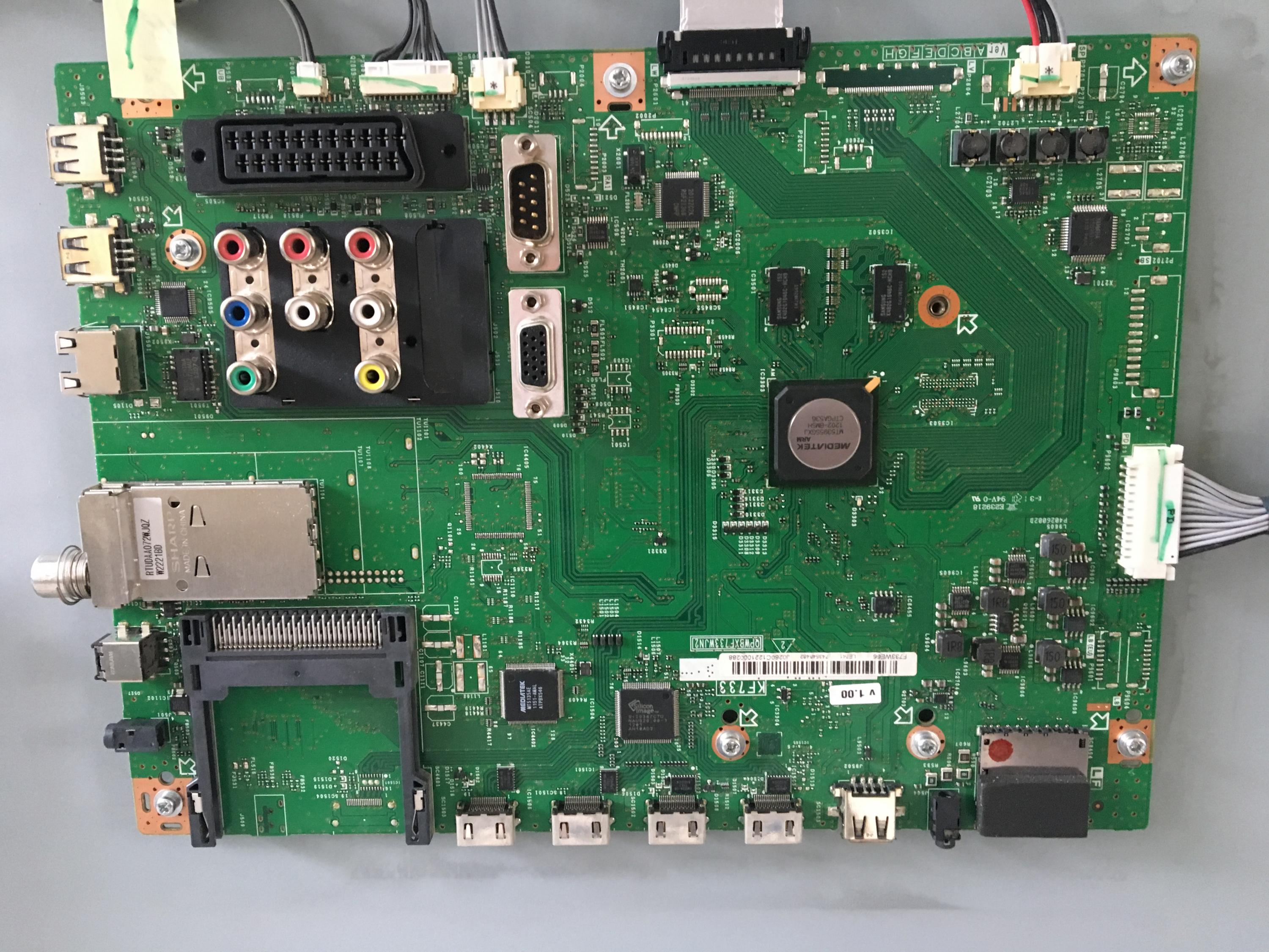

                  Re: Sharp LC-60LE741E 3 Blinks
                  Pic of my mainboard with the covers removed, looks like I need one of these, but can not find one for sale, any ideas where I may get one

                    #29
                    tried freezing eeprom tv not powering up this time

                      #30
                      just warmed mainboard using a hairdriver and tv powered up to a good picture, however before i could get remote to do a factory reset it powered off

                        #31
                        As I write this post mainboard is in the oven @ 190C going to give it 10 minutes

                          #32
                          Mainboard cooked and refitted now led 3 flashes has changed to 2 flashes ??

                            #33
                            I give up on this one

                              #34
                              I think you need around 220 C.

                                #35
                                Thanks for that nomoresonys I will try it again later at 220 C

                                    #37
                                    Baked again at 220 C the 2 flashes has now changed back to 3 flashes and no power up
                                    I need a mainboard and can not find one for sale

                                      #38
                                      May be easier to find a 60" smashed screen tv with same screen as this and swap out screens

                                        #39
                                        your issue are glitch at firmware ( eeprom ), all user over here only suggust the reset process & freezing could solve temporary to dump eeprom and reflash it on new or at same SIP. not baking cake :-) you still have chance to bring it back to life. don't give up .. write down the SIP No of it

                                          #40
                                          Tv is all back together, still not working, But I now notice led blinking has changed again to 1 quick flash then 3 slow flashes
                                          Back to google search again for this fault code
                                          I have had 3 slow flashes, then it changed to 2 slow flashes then back to 3 slow flashes and now 1 fast and 3 slow, maybe it will change to 4 flashes tomorrow
