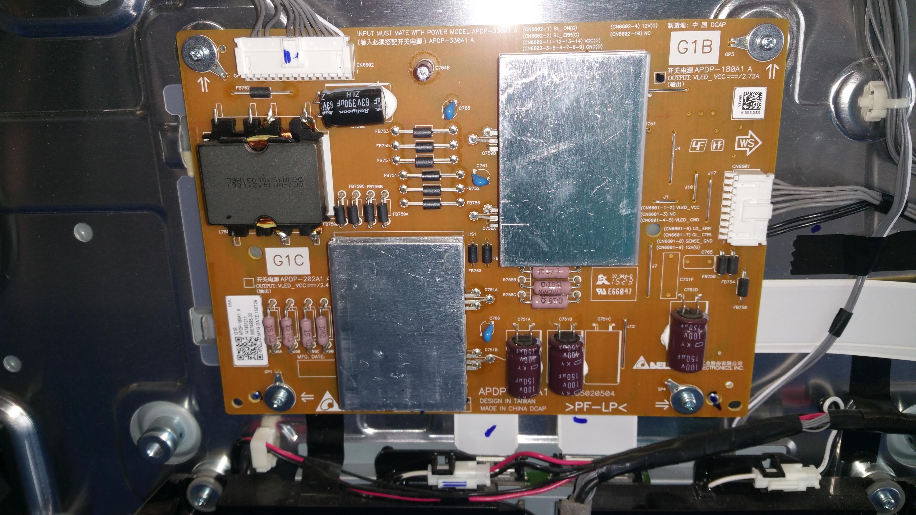

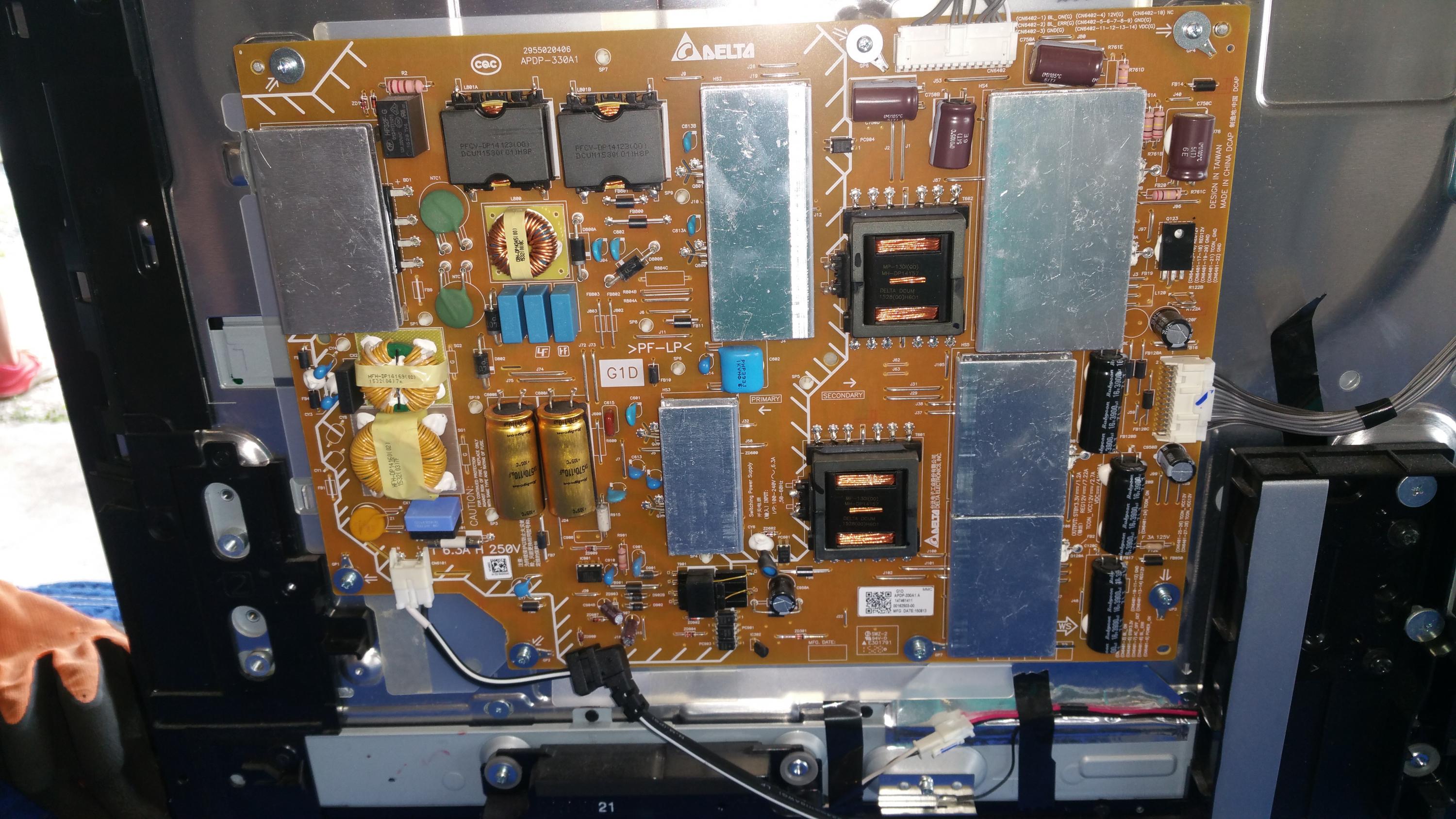

            #45
            Re: Sony XBR-65X900C Sporadic Issues
            Originally posted by budwich
            I recently have an xbox original (2003) that would boot up some times and others not so. Moved it from one area to another (obvious different plugs), it would boot up fine. Moved it to another area where there is an xbox that works fine... same cabling used on the "bad one" would not boot. I took the housing off to look inside while booting.... then I saw the fan having a hard time to start... it would go a bit and then stop. The fan gets its power from the main board.... I looked around and see that 3 of the 3300uf 6.3 v caps (hint... likely in the 5v circuit) in the main board area appear to have slight budge and measure out at 10kuf ... :-(
            I haven't replaced them yet as local parts don't carry low voltage ones.
            Anyway, your problem seems to point to issues with the 5v supply / generation.... hence my suggestion.... I would take a closer look at any place that needs or appears to need 5v plus juice... meaning the voltage might be OK but not enough current.
            If I can't do a successful reset today maybe you can run thru some voltages with me on Tuesday???
            Here are the pics for the 2 power boards...
            If the voltages check out, I think I am just going to break down and buy the Main Board..
            Kick myself to think that the LAN issue COULD have fixed the original problem had I not gone crazy with the reflow equipment..

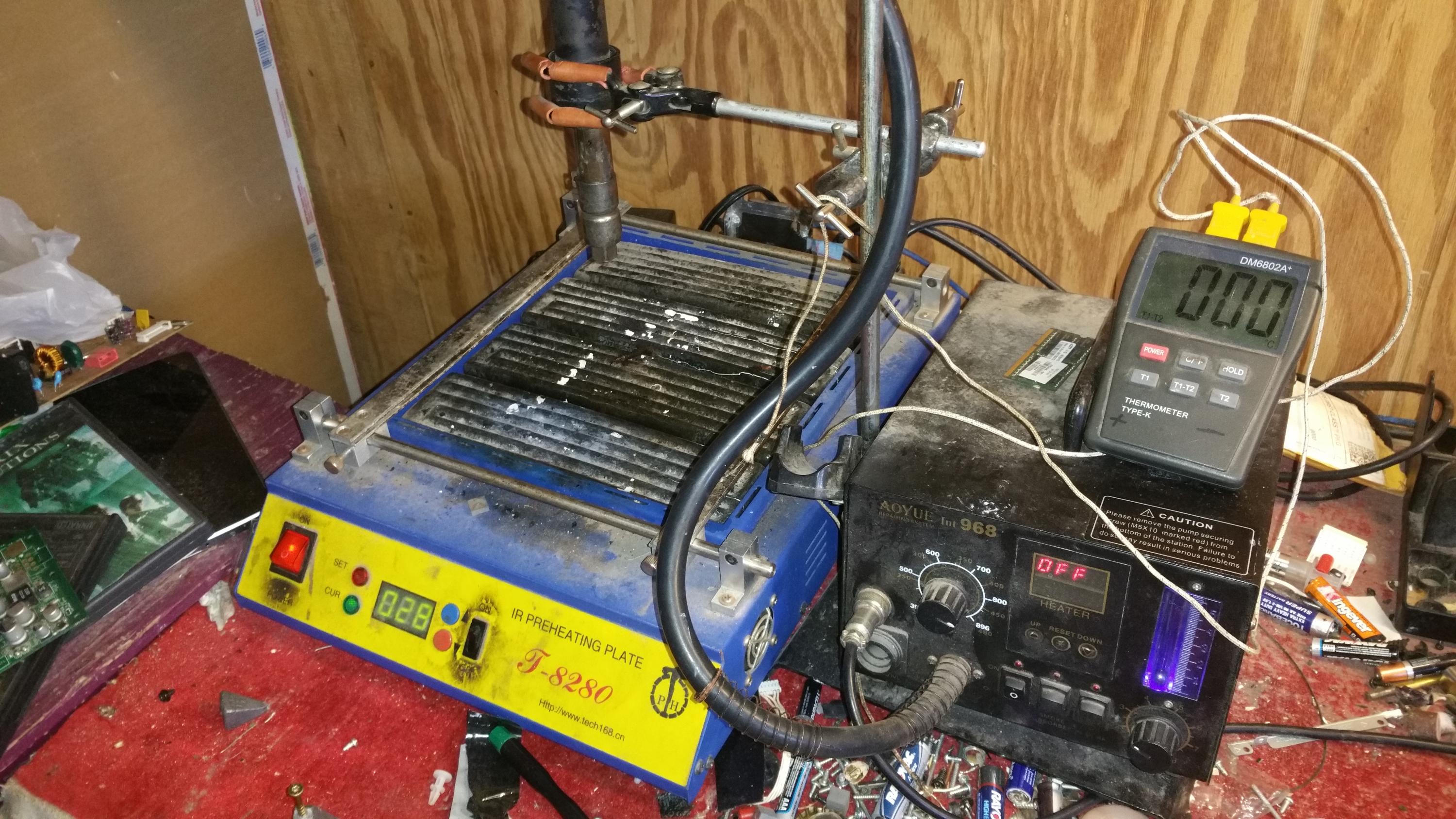

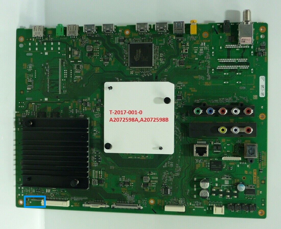

                                    Attached is a pic of the Main Board.. Not of mine specifically.. I can get a pic of that tomorrow..
                                    I pulled off the heat sinks and put the board on my reflow rig (also pic attached) I actually have a new T8280 Infrared preheat unit.. As you can see from the pic, that one has seen a lot of use..
                                    Anyways, I pulled the heat sinks off and put the AOYUE 968 nozzle on the GPUs, one at a time..
                                    Got the temp slowly up to 235c for 90 seconds...
                                    Subsequent reflows I just heated the board on the T8280 up 370f for 90 secs...
                                    Ironically enough I have another Sony XBR that has a very similar Main Board.. The only difference is that this board doesn't have the connector marked in BLUE.. The one on the XBR65X is an A2072598B. The one of the other XBR (I think it's a 55") is A2072599B
                                    With the board from the 55", I get the Power LED on for a min and then it shuts off...
                                    Like I said, I'll follow up tomorrow.. Maybe we can resurrect the dead..
                                    Thanx again for all your help..

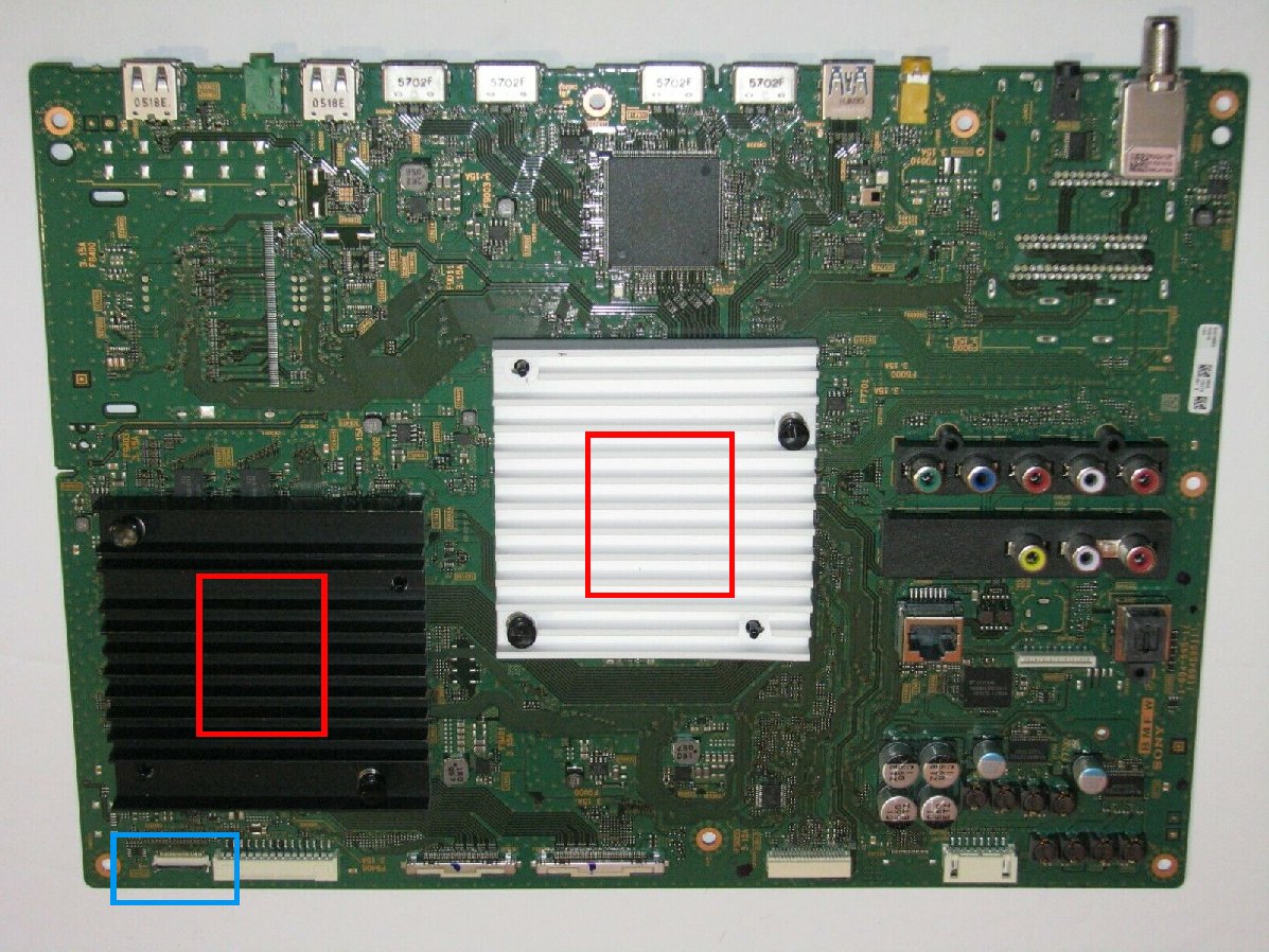

                                      Update on this...
                                      I have to clear out one of my TV Storage areas..
                                      I came across another SONY XBR with an identical Main Board as the 55".. It's from a 47" so it needs a firmware update...
                                      As I mentioned before the 55" MainBoard does not have the connector marked in blue..
                                      How important is that to the functionality of the 65"??

                                        #59
                                        Originally posted by Michale32086
                                        Update on this...
                                        yours 65 are Android. the next should android too with same CPU Type, Same Ram manifacture as well the NAND, all of there should be 100% same. other wise you will toast other parts include the 49 boards too

                                          #60
                                          Ahhhhh Good point.. OK..
                                          I think I got it working on the 55" which has similar specs (4K, etc etc) to the 65"..
                                          I think I am going to NOT look a gift horse in the mouth..
