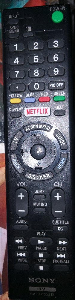

      My remote is a bit different.. No I+ or INFO button..
      • Diah
        • Feb 2013
        • 6392
        Re: Sony XBR-65X900C Sporadic Issues
        at your remote case I+ = Display it mean display the info of the channel or input.

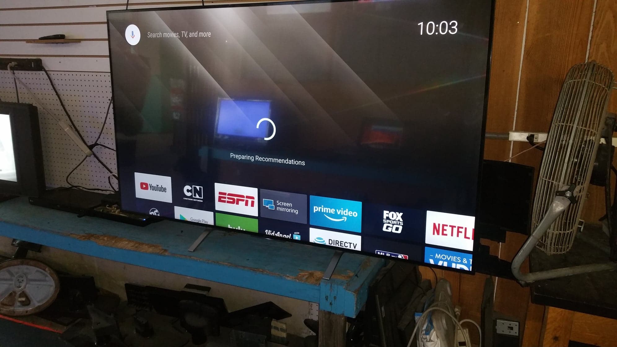

          Well, something interesting happened...
          I was fiddling with the TV and, when I put in a USB drive with the firmware, it gave me a message that the firmware is already up to date.. Prompted me to hit OK to continue. Which I did, but nothing happened. Then I took out that USB drive and put in a USB with a bunch of movies.. It then prompted me to select MUSIC, VIDEO or PICTURES and again hit OK.. I wasn't able to scroll thru anything or hit OK...
          But the REALLY weird thing is that the TV has been running flawlessly since then. About 15 hours...
          So, apparently, the Main Board has SOME functionality, as it can detect a USB drive inserted and can detect what's on it, IE firmware or media files..
          Not sure what this all means, but it's interesting..

                        OK, something is DEFINITELY happening..
                        With the LAN plugged in, I don't get that funky black/white menu at the top..
                        It does to the APP screen and actually shows the correct time..
                        So, one hurdle overcome..
                        But the remote and the buttons on the TV still don't work.. I can't do a factory reset. Same symptoms.. Green LED comes on then shuts off and the TV stays off...
                        The TV also shuts down, but sometimes it LOOKS like it shuts down (black screen) but the power LED is still white...
                        So, definitely progress!

                              I seem to have a different problem now.. I see a different boot up process when the ANDROID animation is quicker and then I see a ANDROID IS STARTING.... loading apps message and then the TV shuts off...
                              NOW the biggest problem seems to be that the TV tries to boot up, but shuts off at various stages of the boot process..
                              And I still can't get a valid Factory Reset...
