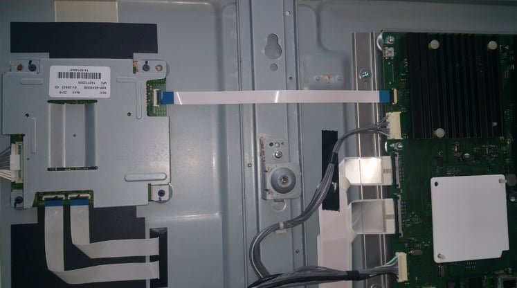

      The small "cellophane" connector in blue in the afore pic looks something like this...

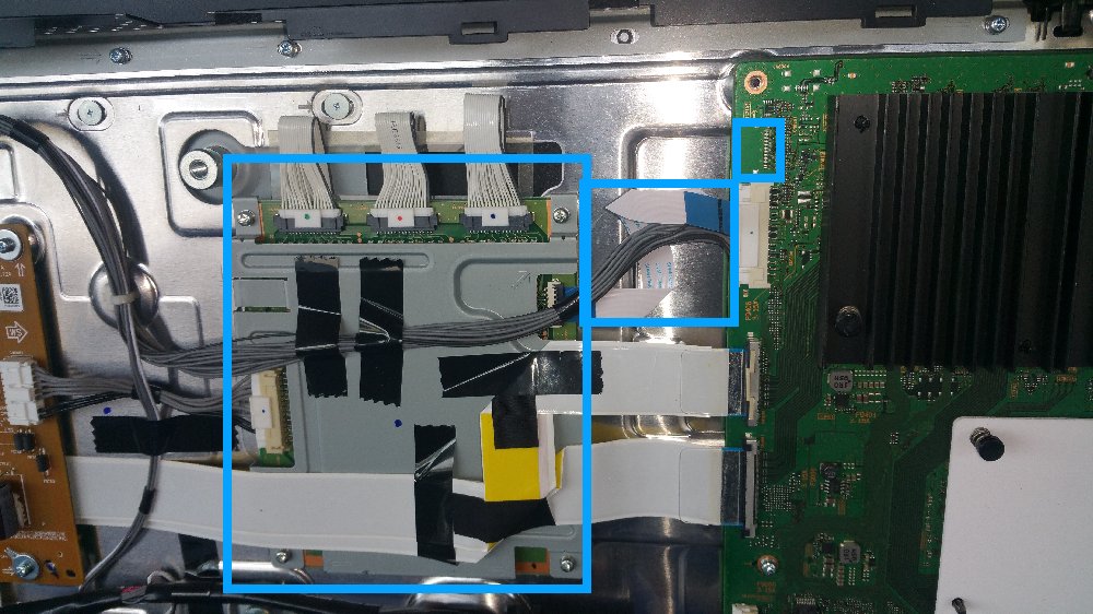

            the blue marked socket on the 65 don't have any cable connect on it at the set of 65. then its out of any risk. just focus on the LCD Panel type, are they both 55 49 and 65 same manufacture, if yes this is good

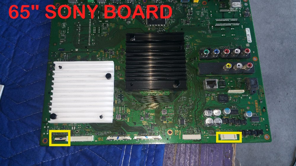

                    OK Update on this..
                    Yes, the firmware does seem to be identical between the 55 and the 65..
                    When I put the board on the 65, however, I still had to do a firmware update again.. Maybe the firmware has to be installed while in the TV it's going to be working in..
                    The GOOD news is that the 55" board DID work in the 65" after the firmware update...
                    Sorta....
                    Took about 40 mins to do the update, but after that, the TV booted up and I could see the boot up process work fine on the 65".. However, I had to see it by shining a bright light into the screen.. The backlights were not working..
                    Which makes a certain amount of sense because that cellophane connector marked in blue appears to have something to do with the backlights, as you can see by the attached picture...
                    Now, the GOOD new is, the stock 55" board still has the proper connections for the backlights AND the audio connections, marked in yellow on the other attached pic...
                    So, if I can get a good working 55" board, which is a lot cheaper than the 65" board, I can transfer the connections and, with a little bit of luck, I'll have a fully working 65" board..
                    At least, the theory is sound..
                    As things stand now, I put the 55" board back in the 55" TV.. As expected, I have to redo the firmware but, if all goes as planned, I should have a working 55" 4K Sony Android TV

                      ohhh. i see so the socket on 65 it had cable connected to LED back light driver board..
                      as you said. keep 55 working.. and try to spend 20USD only and learn to reball the 65 and the 55 one too.. i think its better than to buy MB for 65

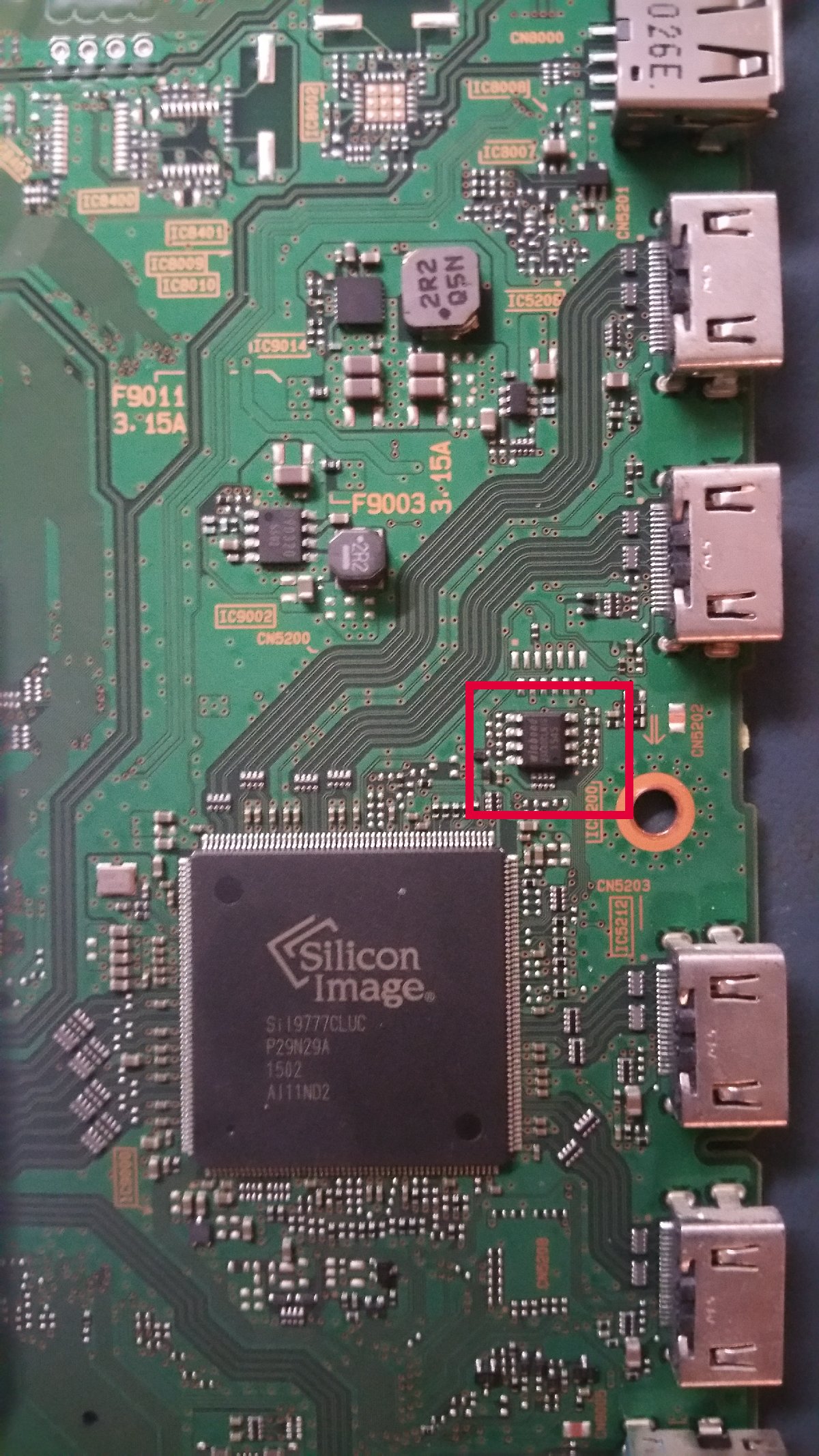

                                          I have identified the FIRMWARE chip.. A winbond..
                                          Advisability of an old fashioned chip swap???
