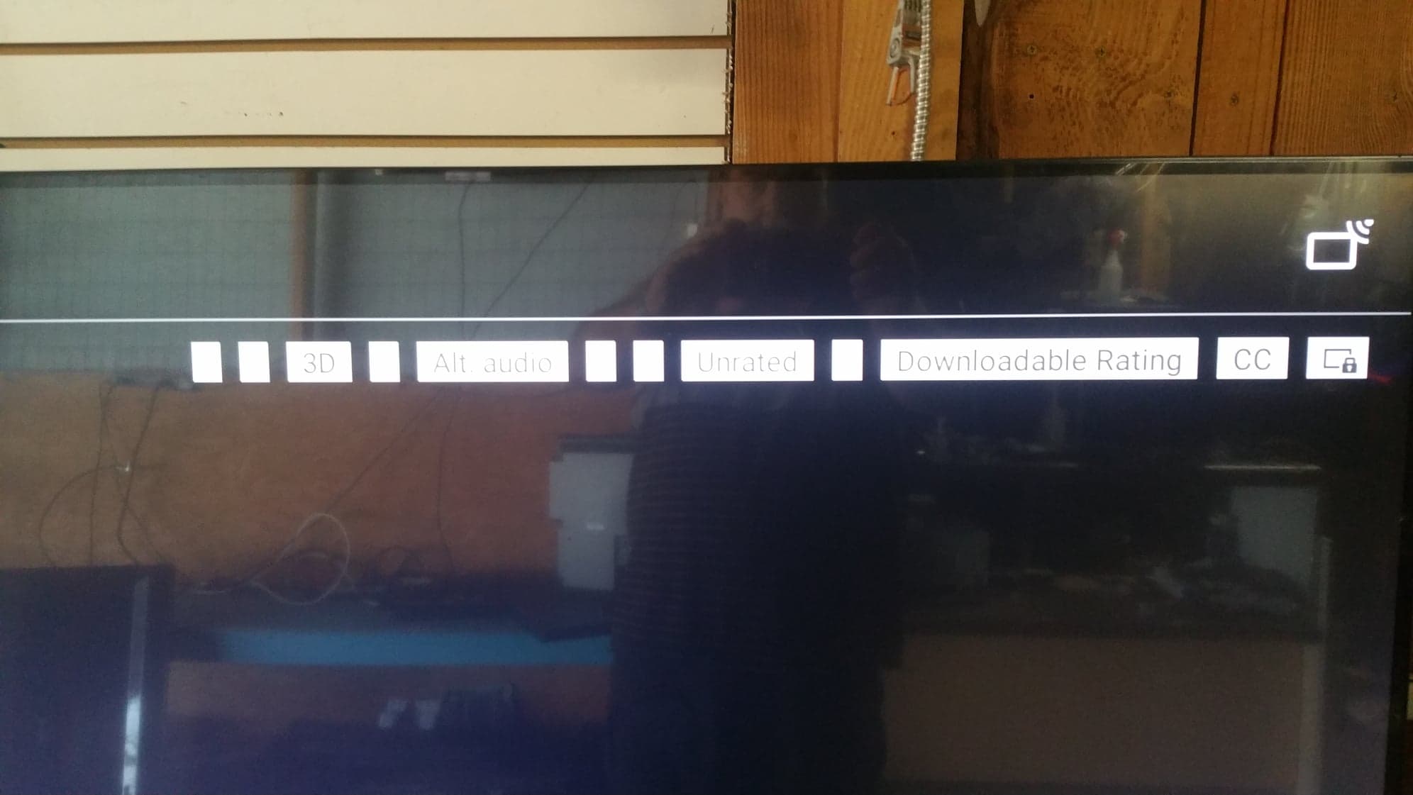

    At power up, the screen lightens and darkens, then shows a menu (of sorts) at the top.. Gray text on white rectangles 3D AUDIO stuff like that...Then it shuts off... That is what happens mostly...

          Here is the picture of the funky menu I see...

            Re: Sony XBR-65X900C Sporadic Issues
            the last symbol on right side with key its "active profile with limited access"

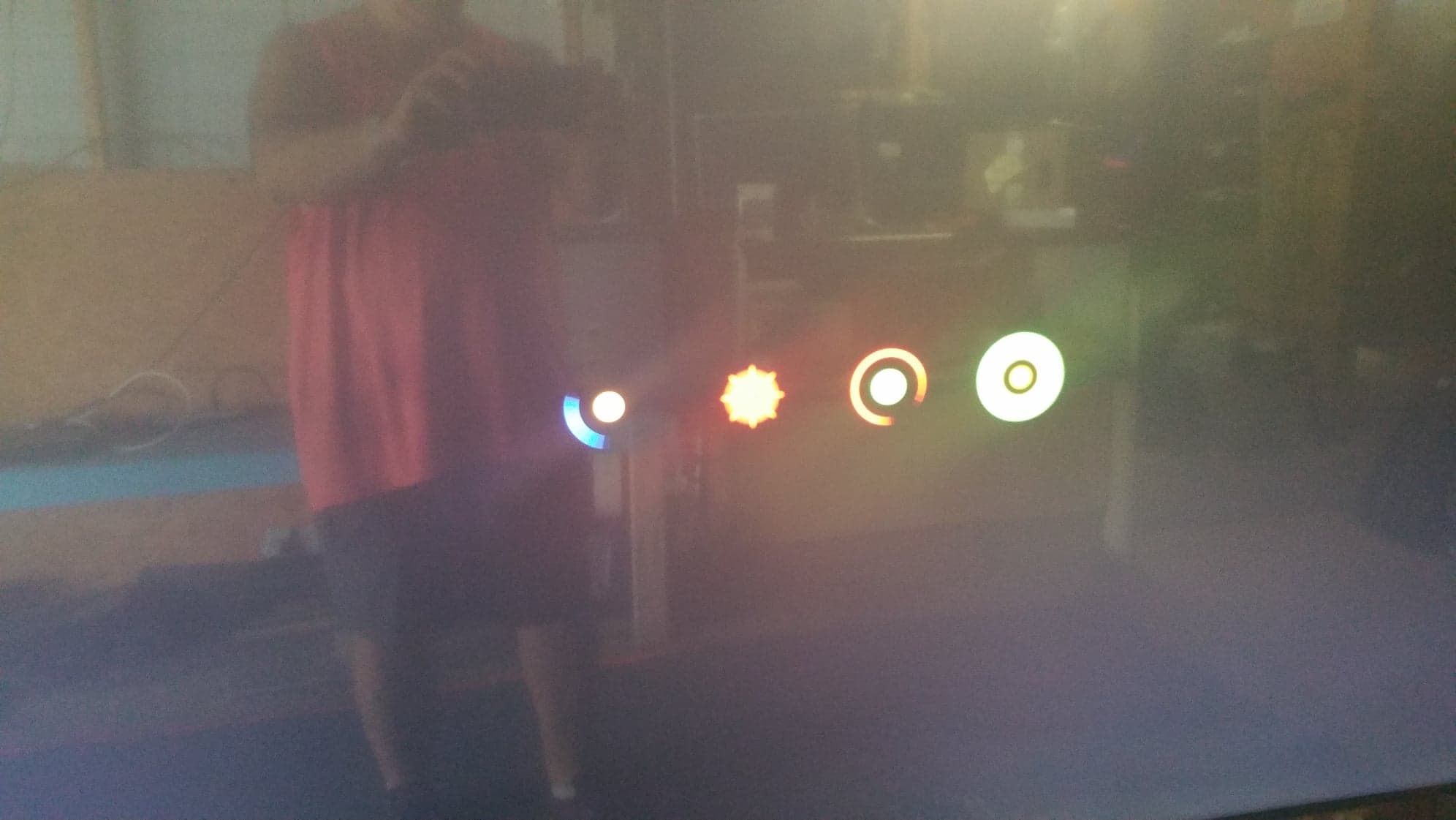

                          Normally, the TV "boots up" with a android geometric display that turns into the word "android", then I get that funky menu and then the TV usually shuts off..
                          Sometimes though, after it has shut off, I turn it one and it goes right into the display (HDMI 1) without any boot up... Almost as if it didn't really shut off but rather went into standby mode..
                          Dunno if it means anything, but it's definitely than normal...
