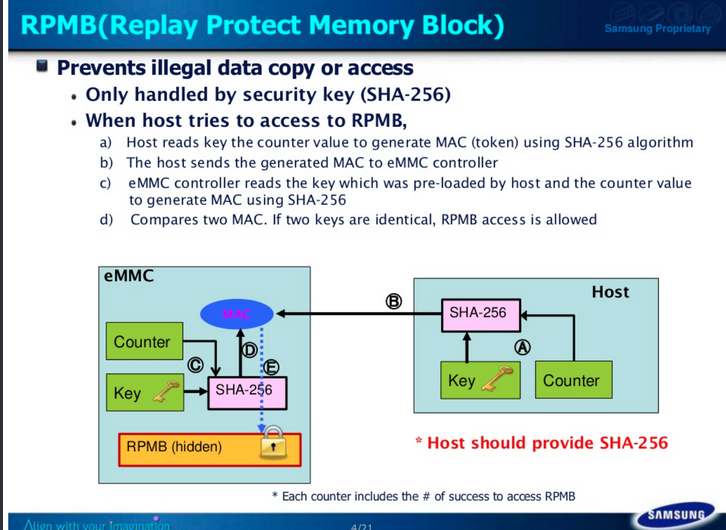

        Originally posted by Davi.p
        RPMB never heard, what is?
        RPMB
        • lotas
          • Jan 2016
          • 4708
          • Russia
          How it works in more detail:
          If the Key is missing, then the device (processor) programs the key into the chip.
          The key is generated from the processor SN and eMMC CID, and thus the key is different for different processors and different eMMCs. Further work occurs in the same mode as with a programmed key. The programmed key cannot be changed.
          If the Key already exists, then, as a rule, the counter has a value greater than 0.
          With a chip that already has a key (16 bytes), the device (processor) can only work through data encoded by the key (Key) and the recording counter (Counter).
          Read mode: the device (processor) receives the counter value from the eMMC, requests to read the data (256 byte blocks), receives the counter and key encoded data, decrypts it using the stored key and counter value, checks the validity of the data.
          Write mode: The device (processor) receives the counter value from the eMMC, encodes the data using the key and counter (256 byte blocks) and sends it to the chip. The chip decrypts them using the stored key and counter value and checks the validity of the data. If the data is valid, the block is written, and the value of the write counter (Counter) is increased by 1.
          Thus, the value of the write counter (Counter) shows how many blocks of 256 bytes (or how many times) were written to the RPMB area.
          Important:
          1) when writing Firmware to eMMC, the internal NAND memory of the eMMC is reinitialized, erasing the key, counter and RPMB data
          2) it is impossible to remove the key from RPMB or change the counter in any other way, except for increasing the counter value by writing data encoded with a valid key.​

              Such an eMMC will not last long after resetting the life cycle, it may be enough for a few days..., it is better to change it to a new one, if the RPMB partition is not damaged, try updating the software via USB.

                  t’s more likely that the programmer itself does not correctly read this encrypted section (does not understand its encoding), and what it read and wrote down, you yourself tried to see this section in the hex editor that the programmer read.

                      Standing on what Lotas says, programmer cannot read that key partition.. so what you will have is an empty rpmb partition, but Lotas also said that would make cpu write newly the key, if counter is not in the rpmb area there would not be a problem but probably it is.. what i have not understood, what is the host? An internet host? The app provider?? If yes there would be the possibility to contact that provider and ask to restart the counter due to tv restoration?
