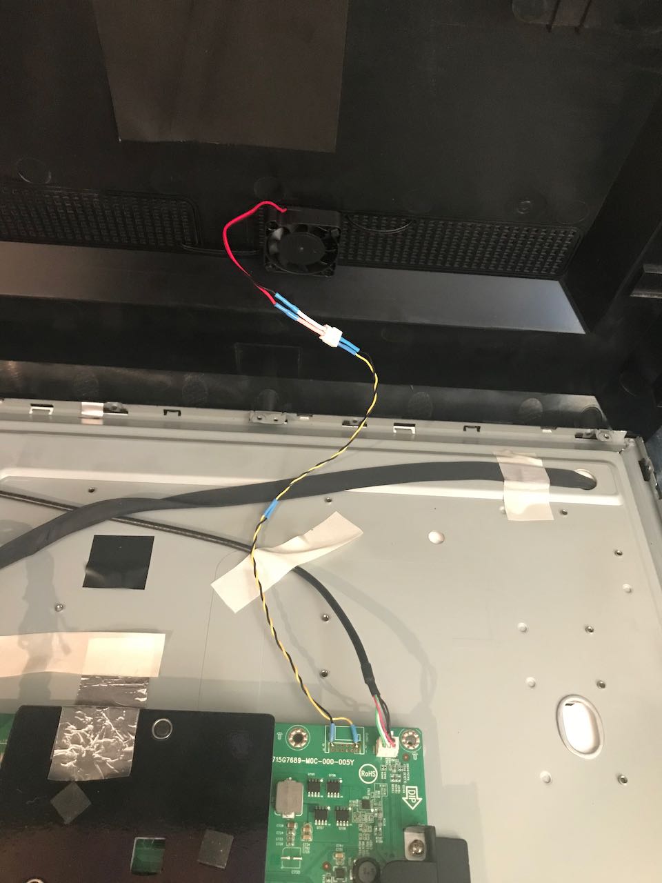

    As many heat gun BGA reflow experience have noted, it doesn't last. I've done it 2x and each time lasting a couple of months of light use. Early failure symptoms including 1/2 screen going grey+noisy (I think this is the upper BGA as its near the T-CON connection) and/or youtube app would get sluggish. Reflow done with the heat sink removed (much easier on later board designs) Ultra low viscosity (like alcohol) flux to flow under the BGAs. And applied new thermal paste. Just did a third time with a hot air station for better temp control. Anyhow, don't really expect it to last.
    As for fan mount, see attached pic for my 40x40x10mm 12V fan (this is a D50u-D1, M43-C1 should be very similar but I've not done mine yet). Fan is just zip tied to the vent holes in the back (zip head inside the chassis so its barely visible on the back) Tapped the switched 12V source at CN212. Quite loud so going to put a pot on it and dial it down (will reduce air flow of course). Previous 5V was very quite so somewhere 5-12V. Greater quiet flow rate is possible with bigger or multiple fans.

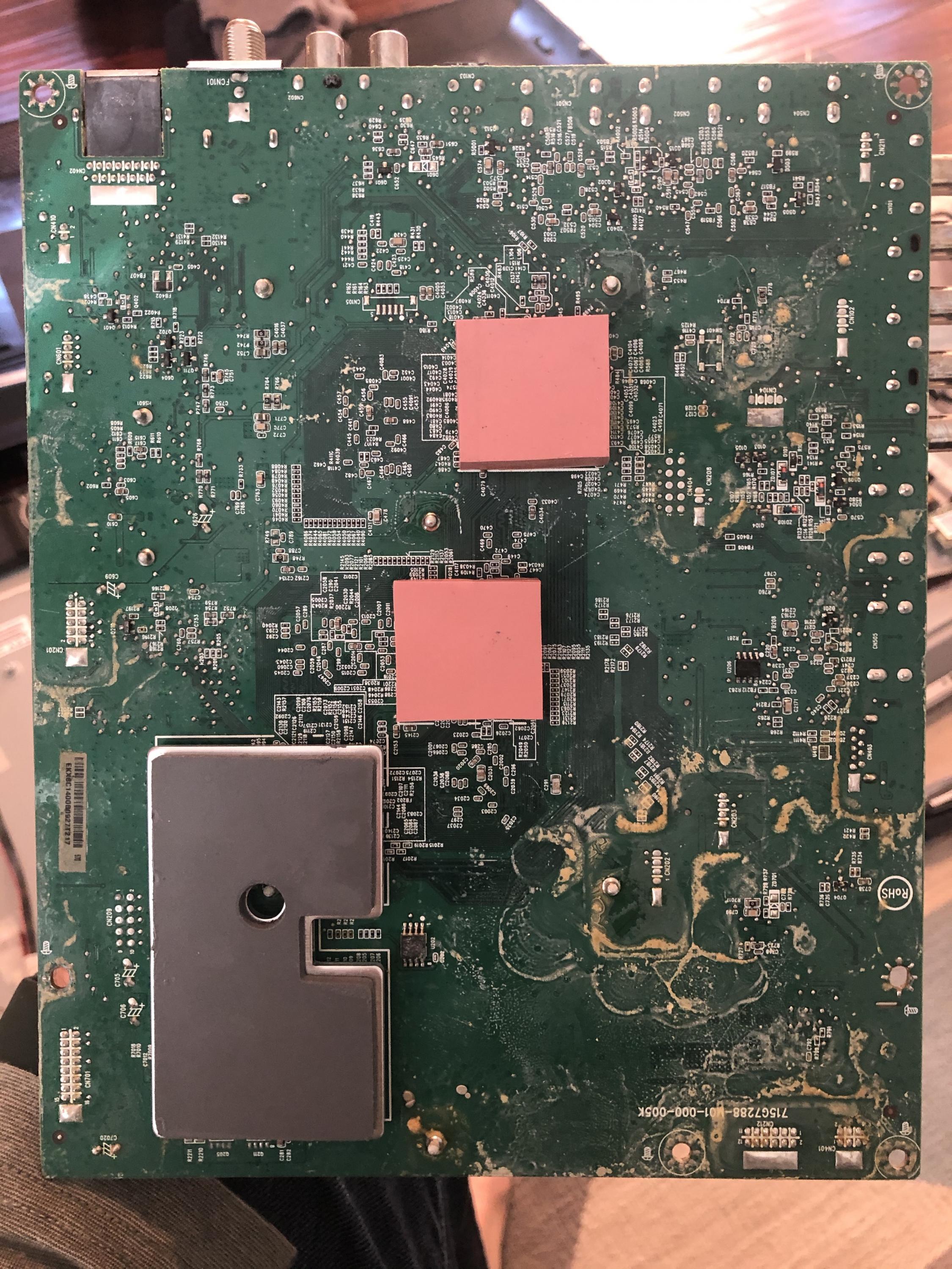

                                    As a data point, my issue first started with the right half of the screen becoming garbled (which seemed like a tcon issue). Then a day or two later the TV stopped coming on at all (no backlight). The white LED would blink 10 times a bit after coming on. Later it started blinking 15 times after coming on. I also had 19V on the 12V power supply line.
                                    • johnboiles

                                      Also, y'all's main boards this crusty on the back? I assume it's just dried flux, but seems like more than I would expect there to be. The crusty bits liquified into a kinda oily substance after toasting it. If I have to do this again, I'll probably go at it with some alcohol because why not.

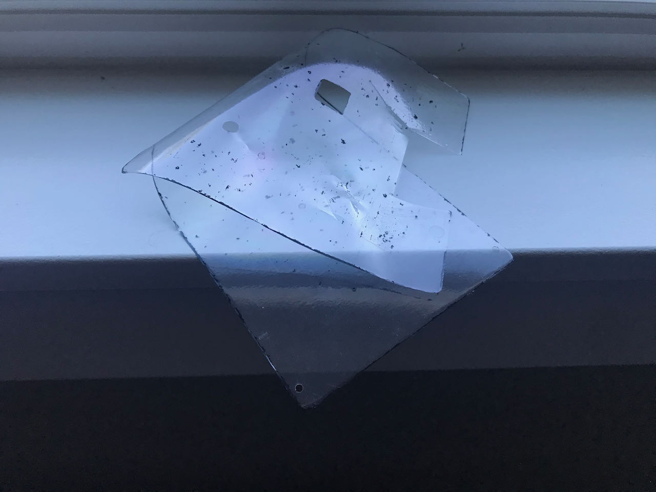

                                        BTW, my heatsink has a really thin plastic sheet (see attached) on top that lifted off when I removed that tape/aluminum foil on top. Not sure why the sheet is there, can't be good for thermal transfer? But I've given up trying to understand Vizio's design on this main board. The entire cooling solution is typical of modern TV main boards but perhaps the BGAs are on older semiconductor technology that put out too much heat for this thermal solution.
                                        The 3 Vizio TV I have all had his common problem with same basic board design.
