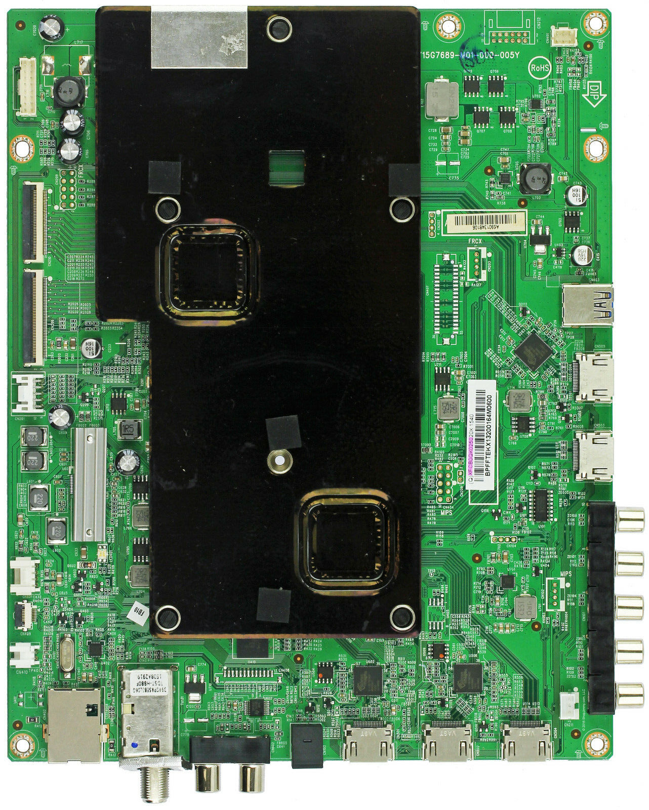

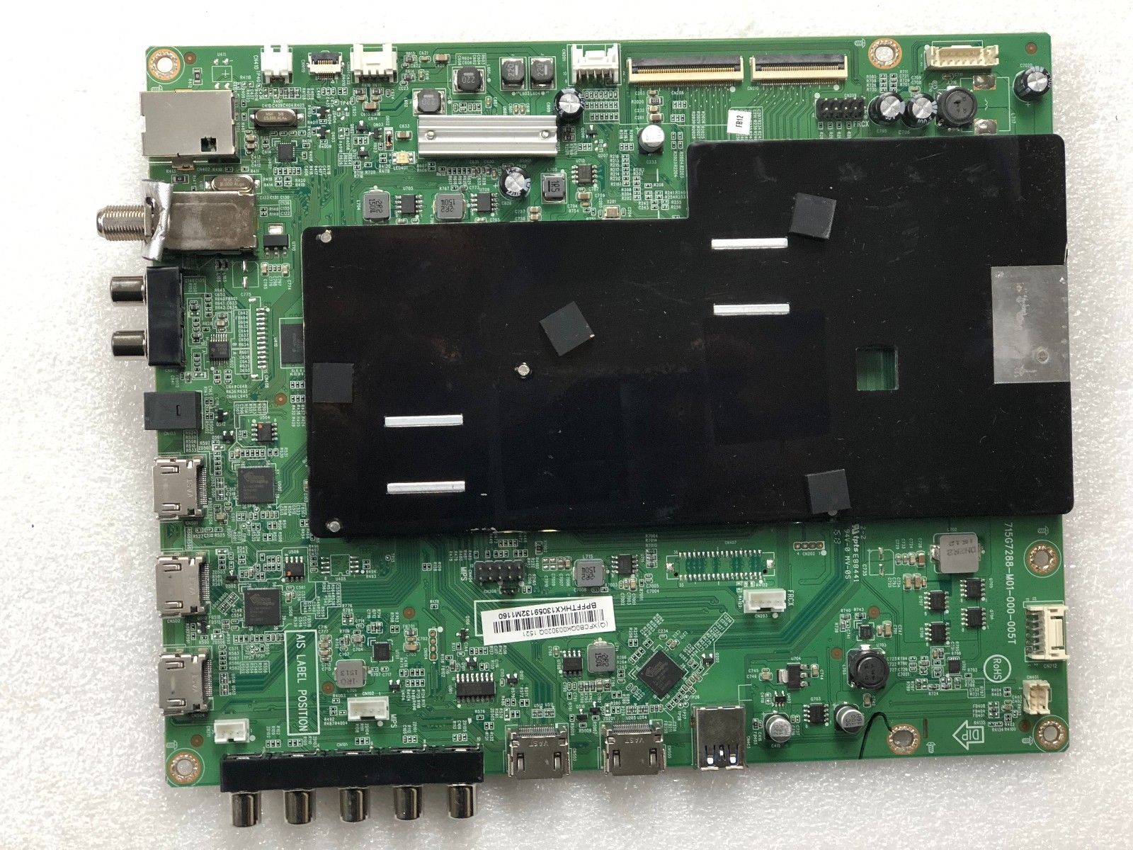

          BTW, it seems later version main boards have a different BGA thermal contact design for the heat sink. Attached is board version 0250 (newer?) compared with 0030 (older?). Hard to tell from top down pic what the new design is. 0030 design is just 2 silver metal alloys impregnated in black anodized aluminum(?) heat sink with rubber heat transfer pad between BGA and heat sink.
          Back of the TV in main board area gets really really hot on the plastic rear case where main board is even with short use. I guess Vizio didn't care about longevity here as even the dumbest testing (turn on for 10min haha) would have revealed this. Will be devising a fan solution.

            Howard, thanks very much for your documentation of the issue. My TV has the exact same issues as yours.
            On the replacement board though, my existing board part number is
            VIZIO 756TXFCB0QK003020Q MAIN BOARD for M43-C1
            It appears to be the same board as the second image in your post above. Are you saying the two boards attached to your post will work interchangeably? And the newer board has a better heat sink design?
            The newer board appears to have a slightly different part number on the UPC sticker:
            VIZIO 756TXFCB0QK025020X MAIN BOARD for M43-C1
              I don't know that they are interchangeable. Just noting the heat sink design change which probably suggest VISIO finally attempted to remedy the problem. My replacement board was also a 0030 (same as my original that failed) from ebay with minimal hours so I just went with that. Never did devise a fan solution so we'll see how long the 2nd one last.
              I tried to reflow the original failed 0030 board with a heat gun + thermal sensor without success. But the big heat sink probably just soaked up the heat applied. Tried to remove the heat sink but need a really good desoldering solution. Friend just got a Hakko desoldering station so will give that a try to remove the heat sink and reflow the 2 hot BGA chips.

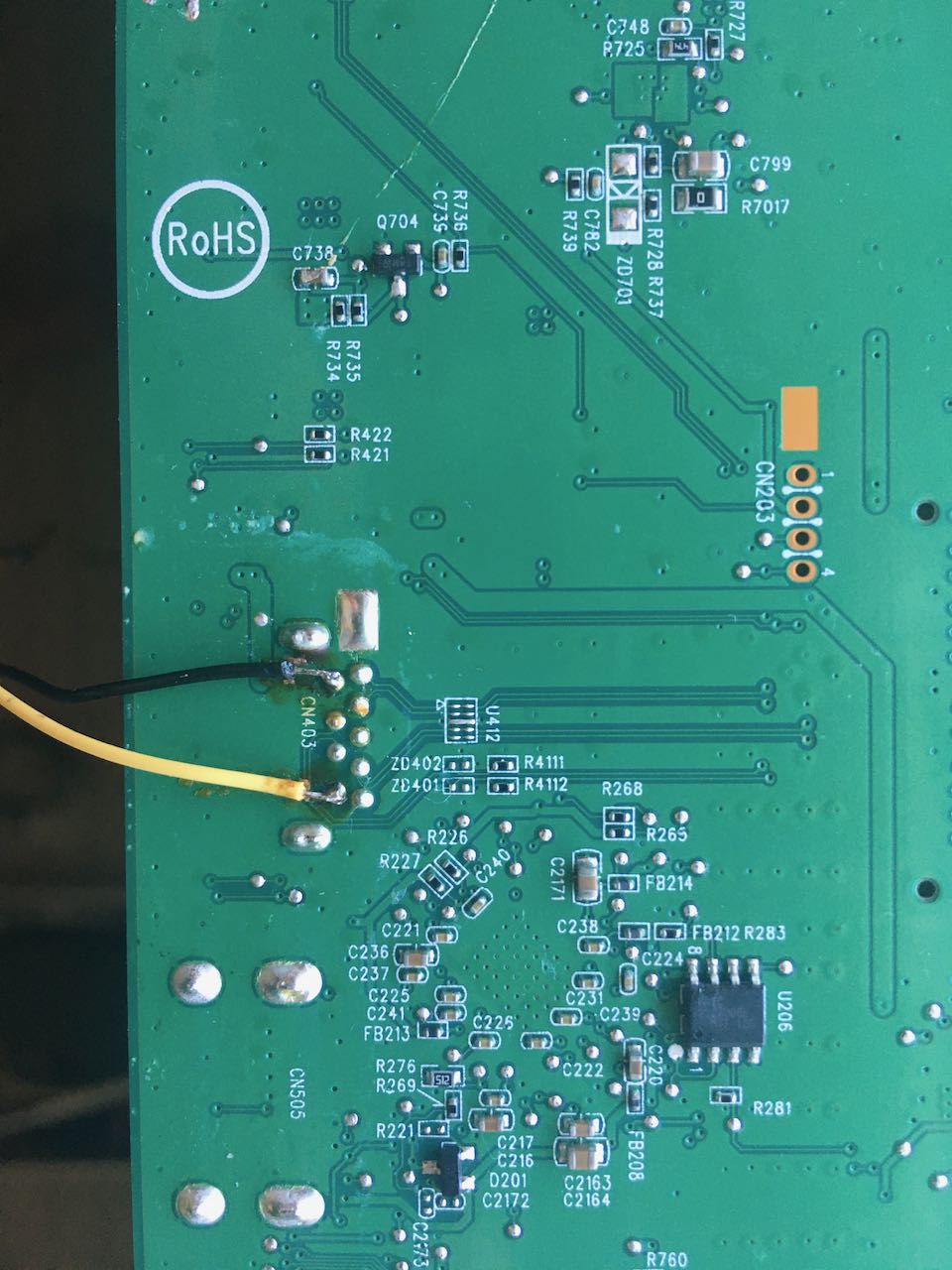

                                        Got fan install done today. Here are notes for others.
                                        - fan is a cheap $1-$2 12v fan from ebay shipped from China with 40mm x 40mm x 10mm size. Hooked directly to 5v source without resistor yielded very quiet operation. Think could have gone higher voltage and not hear it with TV volume on.
                                        - Both 5V lines (yellow wire) from PSU to main board are not switched so I tapped the USB. Attached pic shows the +- connection on the underside of the main board where USB is. USB has 4 connections with +- on the outer pair with signal on the inner pair. Yellow for 5V and black for ground. If you look closer with a magnifier you can see the - pin has 3 connection points to the ground plane. I put a little shrink tubing all the way up against the solder point for insulation (cover it all with glue gun if you like). Routed the wire upwards where the fan would be and tack down a couple of points on the back of the board with glue gun to avoid tugging on the solder point.
                                        - I just used a couple of zip ties to mount the fan on the exhaust hole ports on my D50u-D1, I'd guess similar on a M43-C1, will do that next. Make sure you point the air flow outwards of course
                                        Use about 12 inches of wires with a connector so can comfortable remove/install TV's plastic backing. 5v is actually available at the wifi connector on top but I didn't know if fan would introduce any kind of noise so decided to just tap the USB. There are a row of holes next to the wifi connector that has switched 12v for anyone wanting higher voltage for higher flow.
                                        If I do this again, I'd tap the 12v switch power near the wifi connector and put a small pot on it so can adjust the speed. 5v is dead silent with speaker off so can get more air flow easily in normal noisy TV operation.
