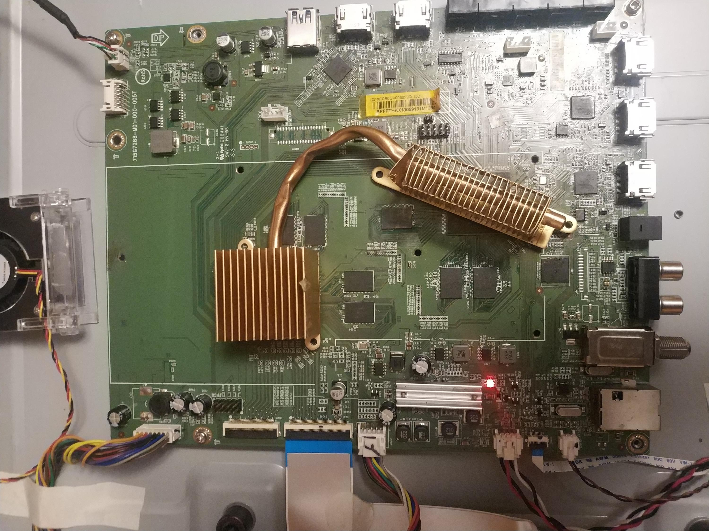

          While looking for a replacement board, I threw the old one in the oven.
          Preheated to 425'f, and then tossed it in. Cut the heat after 6 minutes, and cracked the door after 10. Waited half an hour (way too little time) and gave it a go. Guess the tv works for now...

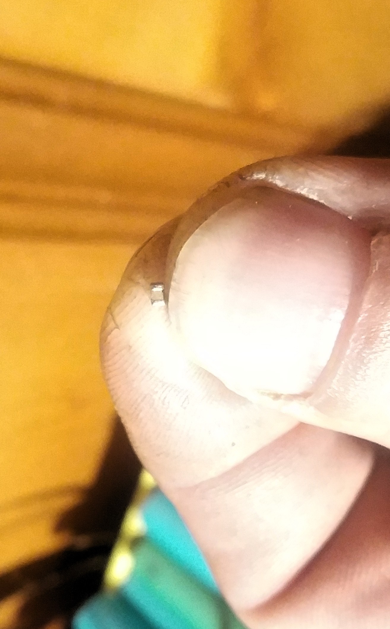

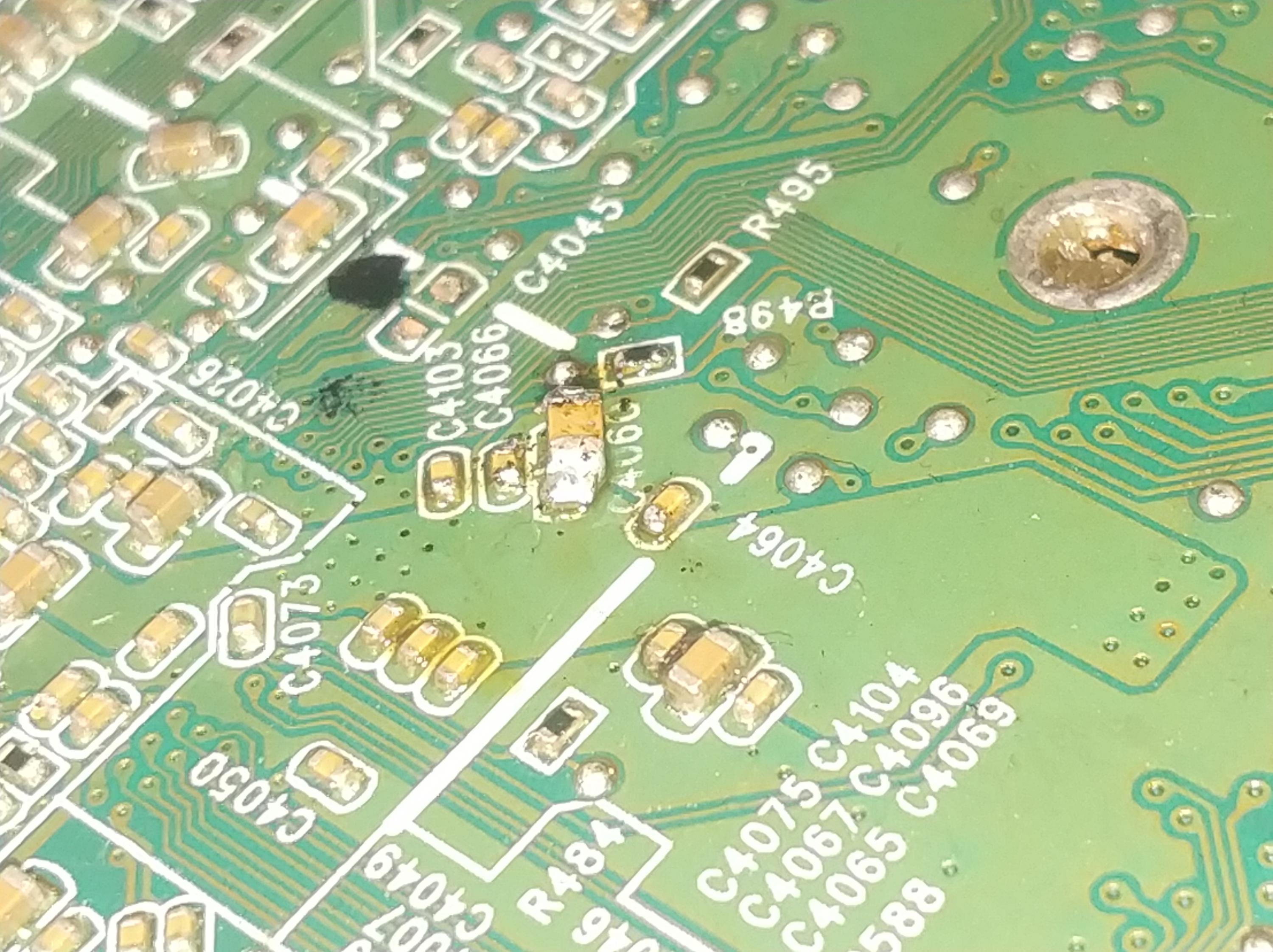

              Hoping someone can help me find the value of, or hook me up with the smd ceramic capacitor on the back of the main board at position C478 (backside/middle of board). I knocked it off and lost it after removing the heat sink on XFCB0QK003020Q.

                    Saved another one with reflow oven 375F(laser temp gun shows board slightly hotter)/8min. This time a P502UI-B1E (2nd one repair by this method). circa 2015 50" Vizio UHD.
                    Checked PSU and got 12V (standby voltage on this model) and saw PS_ON trigger with power on. Then onto Betty Crocker. Works again for the time being. Toaster oven is batting 4 for 4 so far. 3 Vizio TVs with main boards of this general design and a Nintendo Switch. TVs gets pretty light use and Switch probably gets the most use and still going after 8-9mo.
                    On these Vizio main boards, I think its really important to remove the heat sink but it is crazy hard without the right tools. What I use is
                    - Hakko FR-301 powered suction desoldering tool on fairly high temp
                    - Soldering gun (ex Weller D-650)
                    2 people, 4 hands, 2 heating devices, lower post melting temp with leaded solder (low melt solder probably even better). If we had a bigger opening diameter tip for the Hakko to go completely around the heat sink post, might have been able do the job alone. Standard tips don't wrap around this big posts.
                    I also found the thermal paste completely dried and hardened on this one. Took while to even get it off.. hardest I've ever seen. So part of the repair longevity is probably fresh thermal paste which is only possible with heat sink removal.
                    Not saying this is the proper fix but prob best most DIYer can do without access to BGA reflow station.

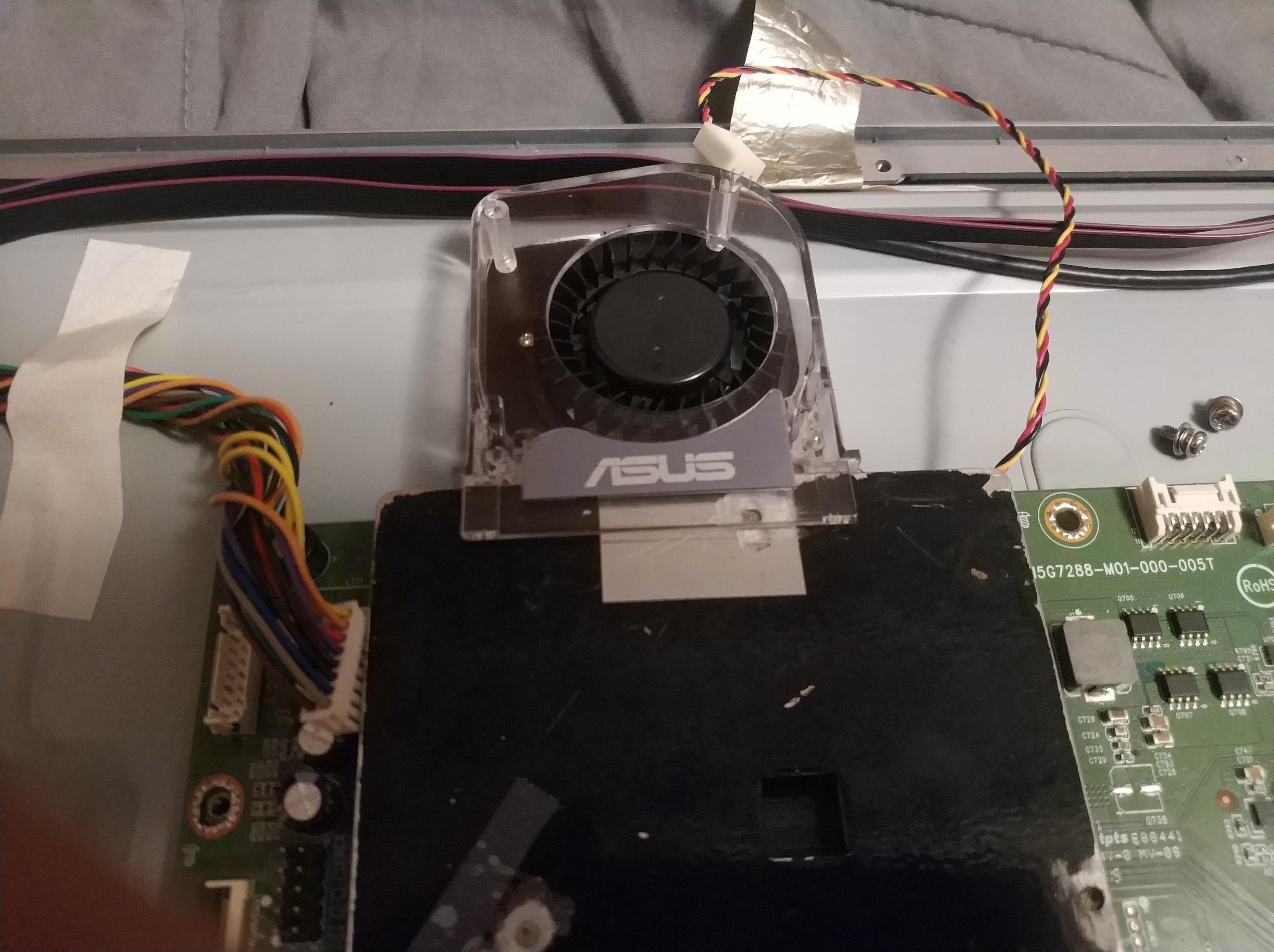

                        Not sure what is happening on your board. Loose parts etc.
                        I tried some small fans with original heat sink but it didn't move much air at reasonably low audible RPMs. Also can't mount it to provide good cooling. The original heat sink don't have much room for any good solution.
                        But custom heat sinks need to have secure contact to the chip surface and original heat sink mounting holes aren't perfect for the job. A combined custom heat sink such as you are attempting might provide a solution.
                        Sorry but I gave up on forced air cooling after a brief attempt.

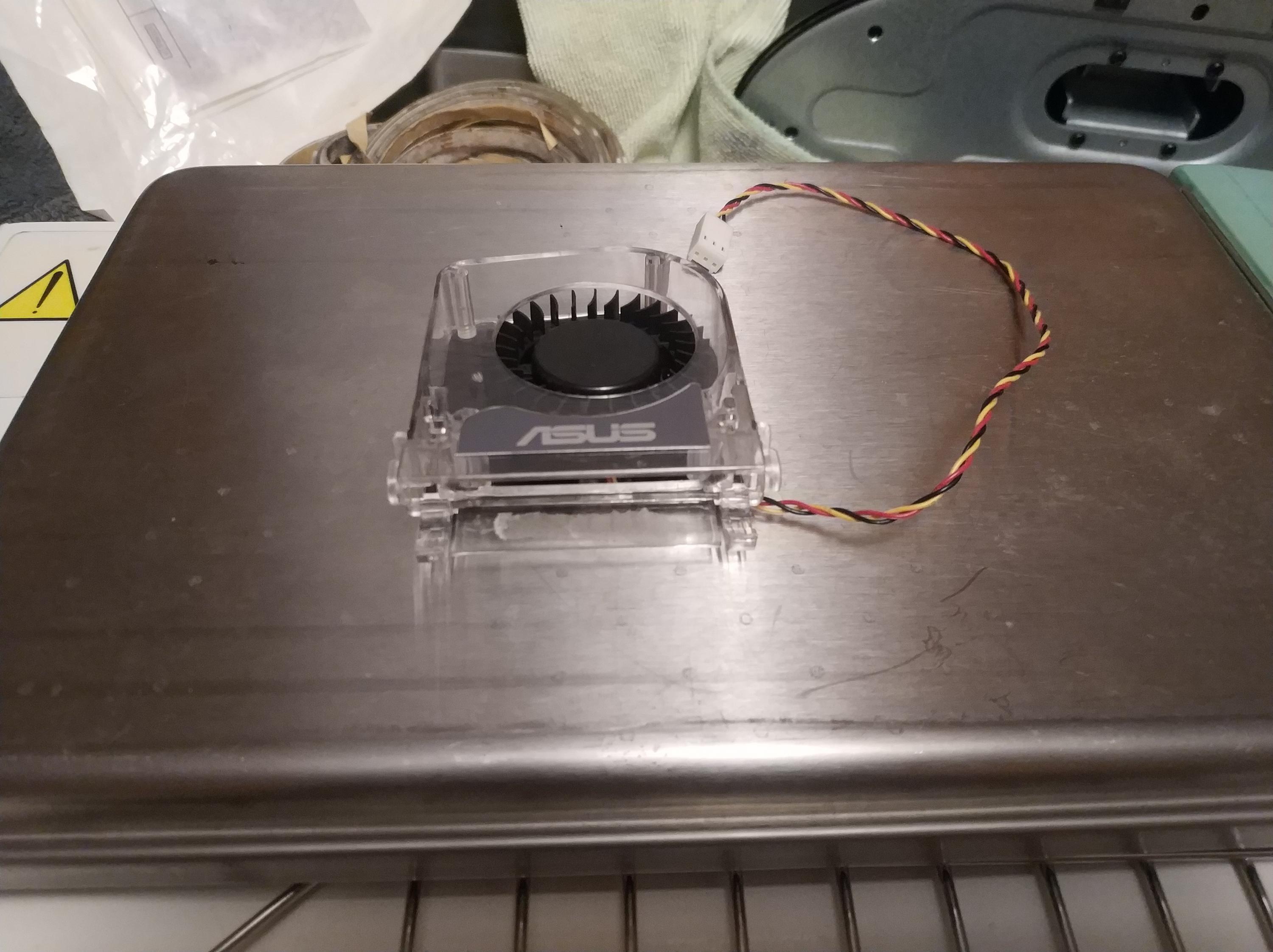

                          I'm currently looking at making adjustable threaded plastic stand-offs to avoid whatever v+ continuity I had with the metal ones preventing the tv from booting. This will allow me to use the best cooling solution I have atm, the Asus fan blowing between the HS and the board. BUT, it's a 12v fan and I'd like to use a switched 12v point on the board, if there is one. maybe howardc64 could advise of a spot on M43 board or unit that has switched 12V.
                          A waterblock would likely be the best one could hope for, I'm sure alibaba or Banggood type places would have an afordable option. Might even really add longevity after a good reflow.
                          Also, when using flux and trying to get it under the chips, only apply on 3 sides to avoid a vaper lockout thing. As advised by knowledgeable youtuber..
