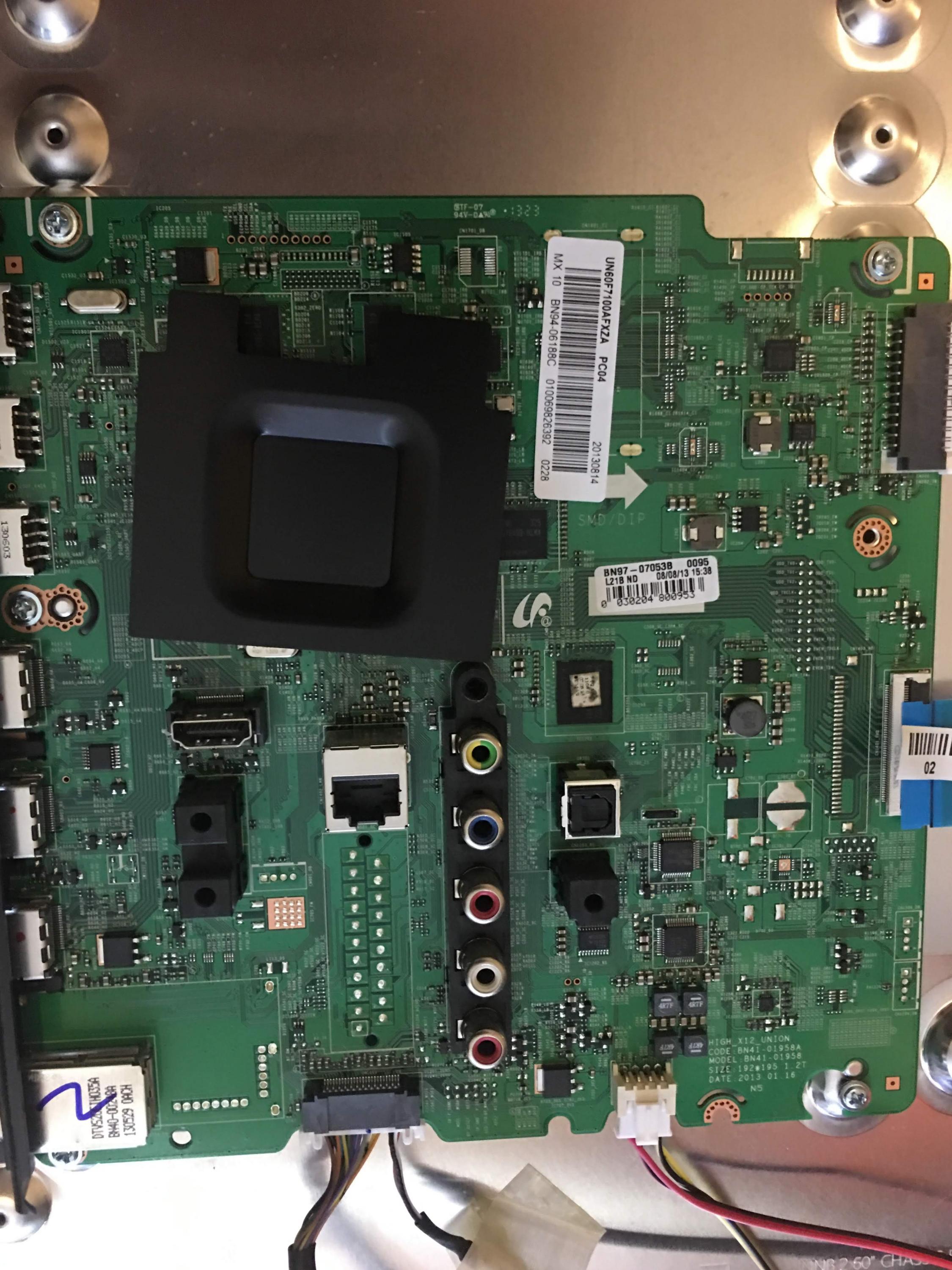

    I have a Samsung UN60F7100AFXZA it is just clicking and not turning on fully, the standby light blinks 5 times then the power relay clicks and starts the whole process over. I get steady 5VDC on pin 22(I believe to be the stby) on the cable that connects the logic board. the other pins match the board markings when I try to turn the tv on. the power relay carries 5V when closed on the small legs, the capacitors appear ok and read at or above rated capacitance except for the one circled on power board image, which will show as a short then 70microF. Not sure what the capacitor is cannot find any ratings on it.
    Would appreciate any tips for narrowing down my problem with this tv
    these are the boards in my TV
    Power Board:
    https://photos.app.goo.gl/jNsv6YnrHCD5H9cB8
    Logic Board:
    https://photos.app.goo.gl/XBhEraMx4jNfqtpz5
    Small capacitor:
    https://photos.app.goo.gl/ASCst1soSkiUWLPm8

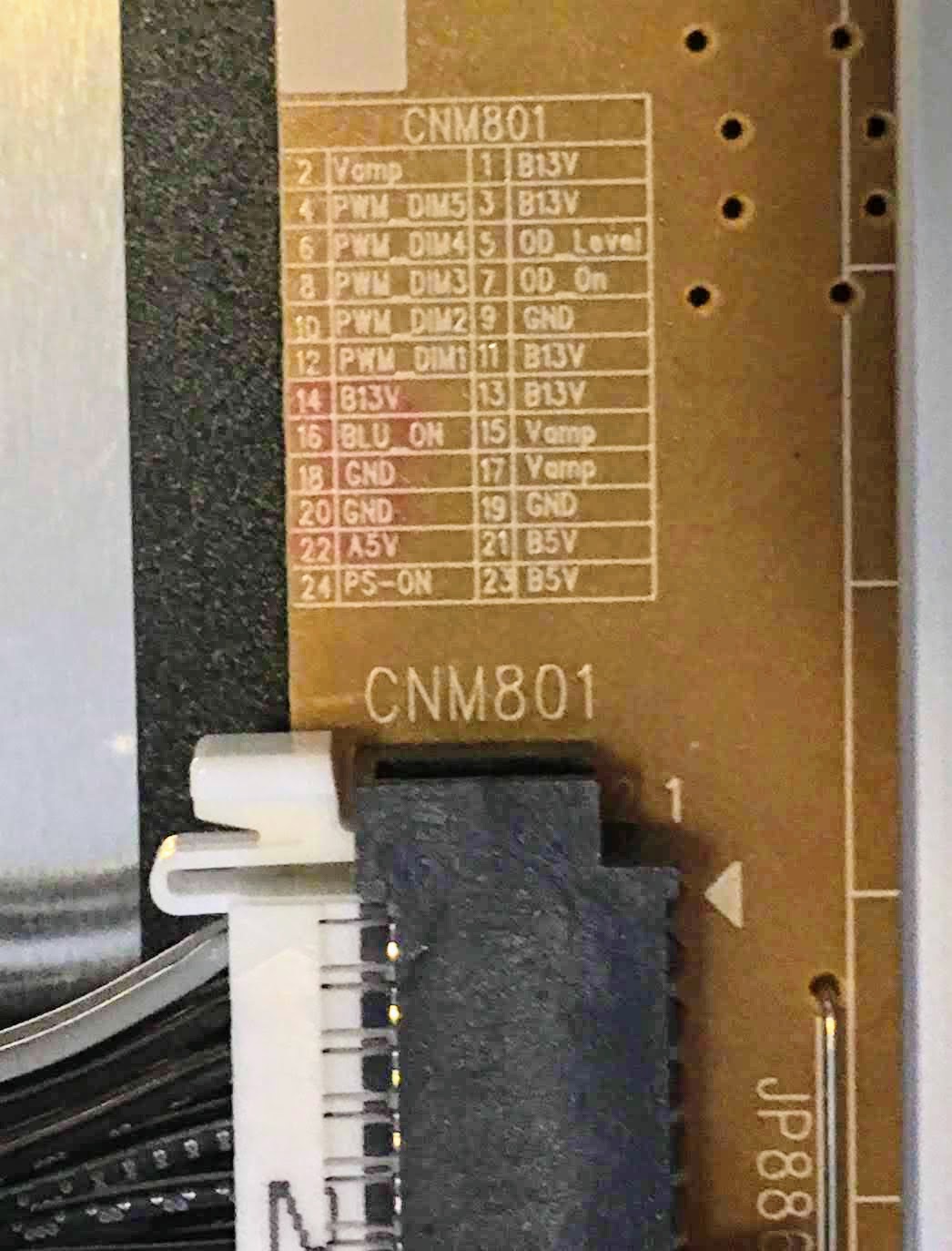

          TV model : UN60F7100AFXZA
          POWER Supply Board: BNN-00630A
          from what I can see pin 22 A5V it is the only pin that is carrying voltage before I try and turn the TV on
          https://photos.app.goo.gl/YGGSigaaSP3aKiJr8
          Standby pin 22 holds 5.34 V steady throughout
          PS-ON PIN 24 is 0.26V in standby mode
          PS-ON PIN 24 3.3V when relay closes,
          PS-ON PIN 24 0.26V when relay clicks back out
          What would you suggest to look at why the main board is not sending continous power to PS-on

            I went back over the power supply board this morning, and disconnected it from the main board and plugged the led cables back up and the lamps power up when plugged in. also when the main board is unplugged all the pin outs show the voltages they call for on the board,

            But when I connect the main board back up the only voltage I still get is pin 22 @ 5.35vdc. is there any point in troubleshooting the main board or would any of the parts be replaceable?

              Test connector from mainboard to powerboard on powerboard side with all boards hooked up, test with tv plugged in but off then hit power, report both conditions here, give pin number, pin description and condition on and off, pay attention to, looks like pin 15 BLU-ON. looks like the mainboard isn't sending that signal so your getting no backlights, do you see menu or anything on screen with a flashlight when hitting menu? 2 threads on same tv makes things confusing that's why it's frowned on.

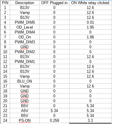

                  I have attached voltages I got from the main board side connector with all boards connected and TV plugged in then also while the power would cycle. I do not see anything on the screen when the power is cycling even with flashlight

                    From the looks of your chart it looks like the mainboard isn't sending the blu-on signal to turn on the backlights.

                      would there be any parts to check on the main board for replacement or easier to just get a replacement. and would not having that signal keep the power relay cycling?

                        I'd replace the mainboard myself, suppose it could be something simple but I usually don't have the patience or in depth knowledge to fix the mainboard. Other than simple eeprom replacement which I don't think is your problem, yours could be micro controller issue??

                          Could try heating mainboard with hairdryer, small section at a time be sure n heat the capacitors on mainboard too and see if there's any change.

                              i replaced the main board and the tv boots up perfect I still need to hook up a source to check sound but so far so good, thank you all for the help
