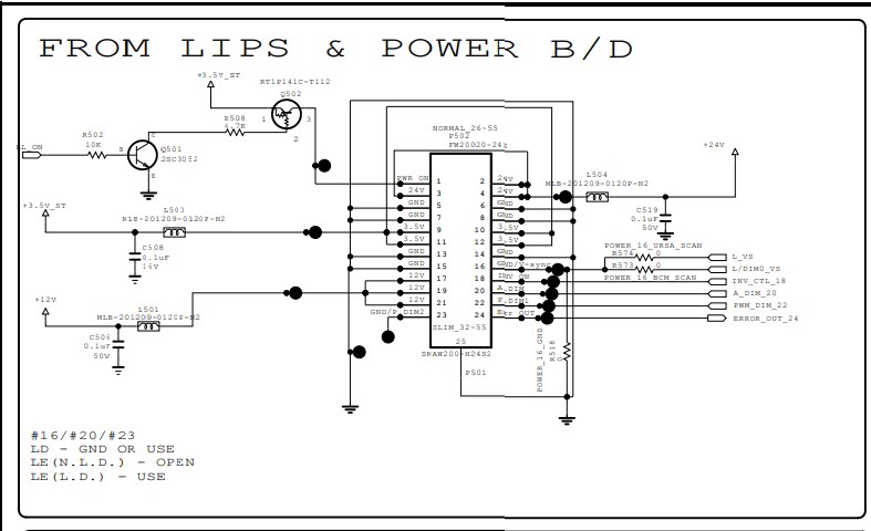

LG 37lv375s no 24V

    Re: LG 37lv375s no 24V
    I would start checking that inv_on line back to the main board
        Follow the wire back to where it comes from, then check the components, If you look at the service manual it does give some direction where to look, search the manual for inv_on or inv_ctl etc. to follow the path
          I found this manual
            think I found what I need
              Problem is on mainboard....
                I will try to reflow main processor...
                  You can try forcing on the backlights circuit by disconnecting the INV_ON (BL-ON) wire going back to the main board first then use 1K resistor between BL-ON pin and standby power supply pin to force the backlights on, if the backlights are on but you do not see any video, or sound, or other functions then it has more than just the BL-ON controlling problem.

                    #29
                    Ok guys I replaced main processor ,volltages are same...
                    I will try forcing backlight with 1k resistor

                      #30
                      Did you replace the processor or the main board. LV series has bga issues.

                        #31
                        yes I replaced with new processor

                          #32
                          Did you do this?

                            #33
                            Did you do this?
                            no, I am going to electronic store to buy 1k resistor, I have low ohm resistors at home.

                              #34
                              ok guys it turn on backlight with 1k resistor
                              but no picture or sound

                                #35
                                Looking like a mainboard fault.
