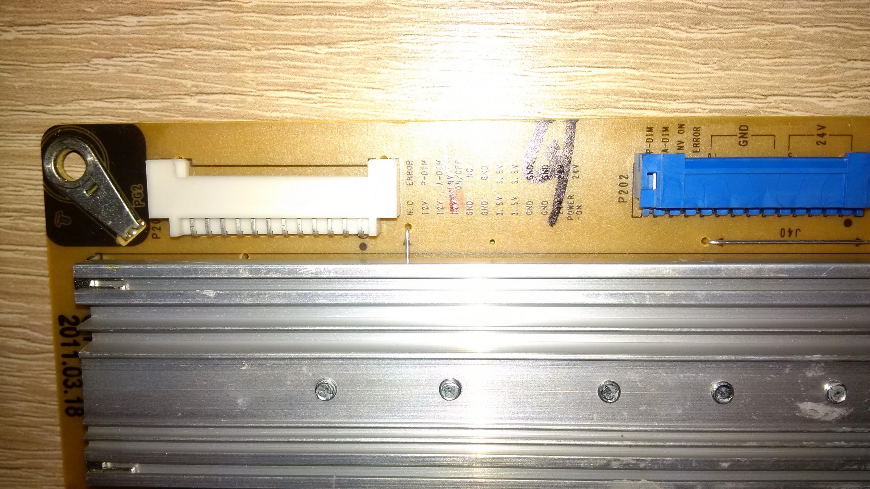

    hello guys
    I buy today LG 37lv375s Smart tv
    Problem is when I plug cord and turn on tv ,something clicks ,flash 2 times red light and off.
    backlight not turning on
    I measure voltage on power board
    I got 3.5 volt,12volt but 24volt is 0.voltmeter shows 8 volt for second and then 0 ,jumping voltage.
    Re: LG 37lv375s no 24V

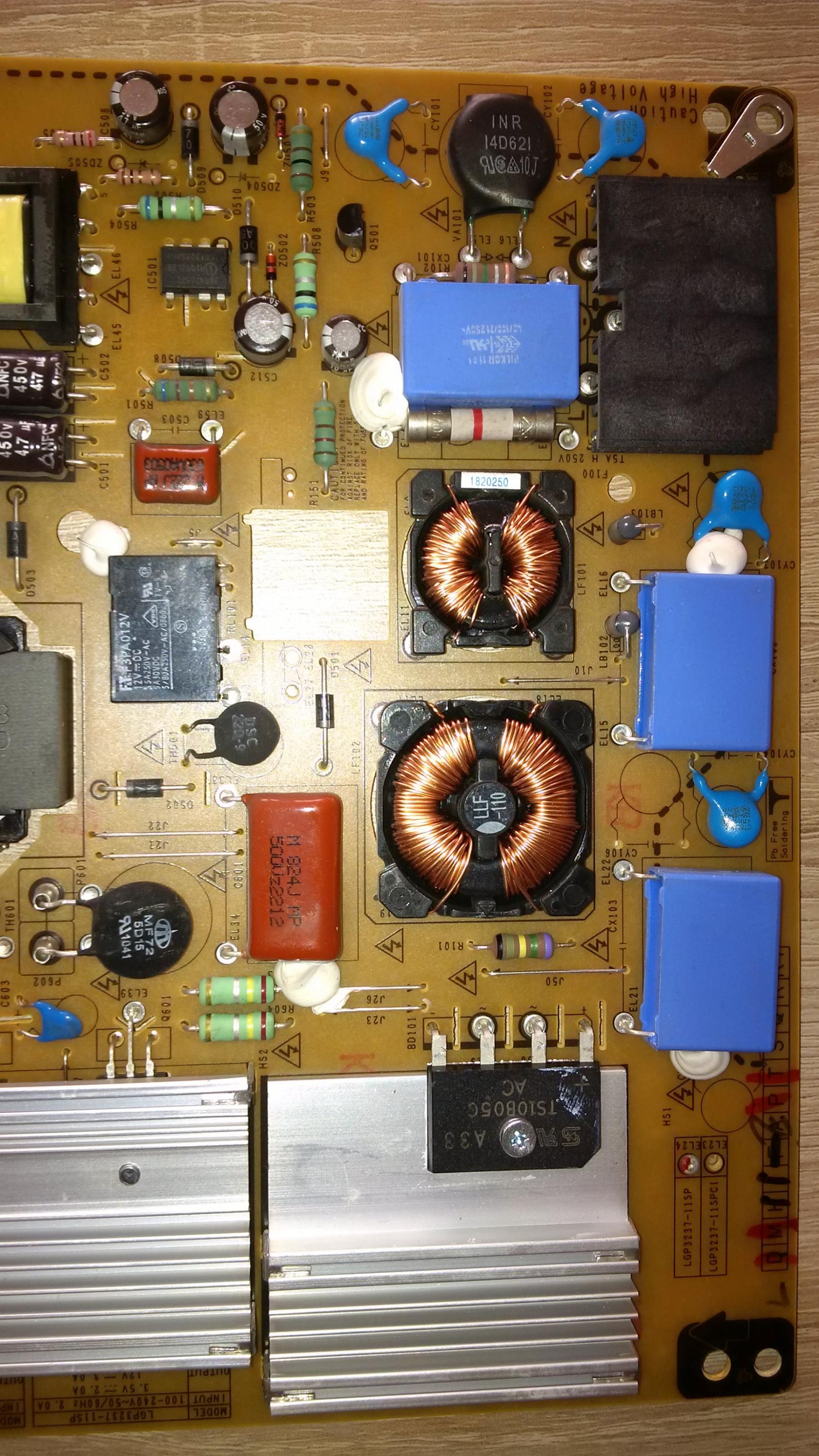

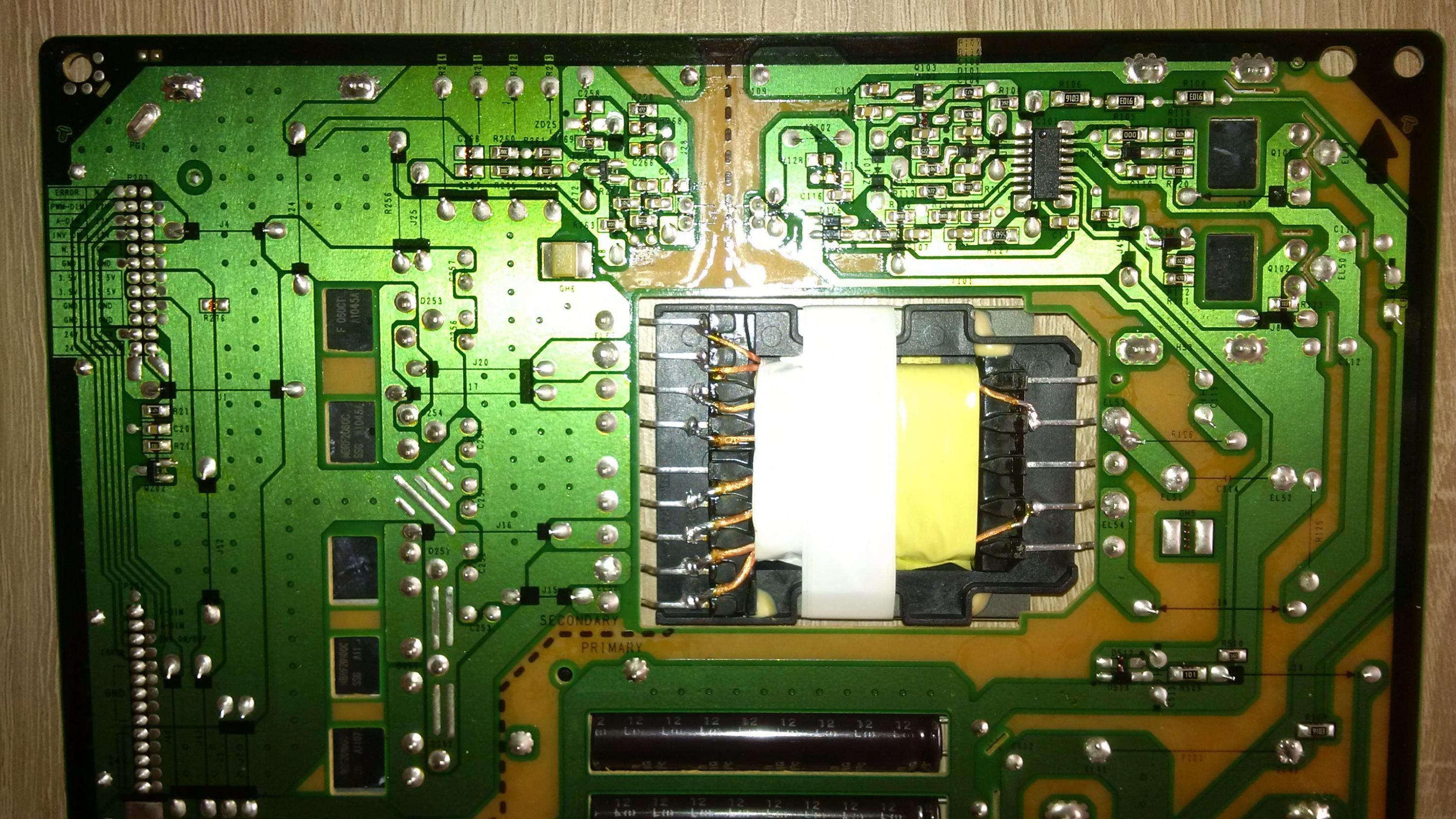

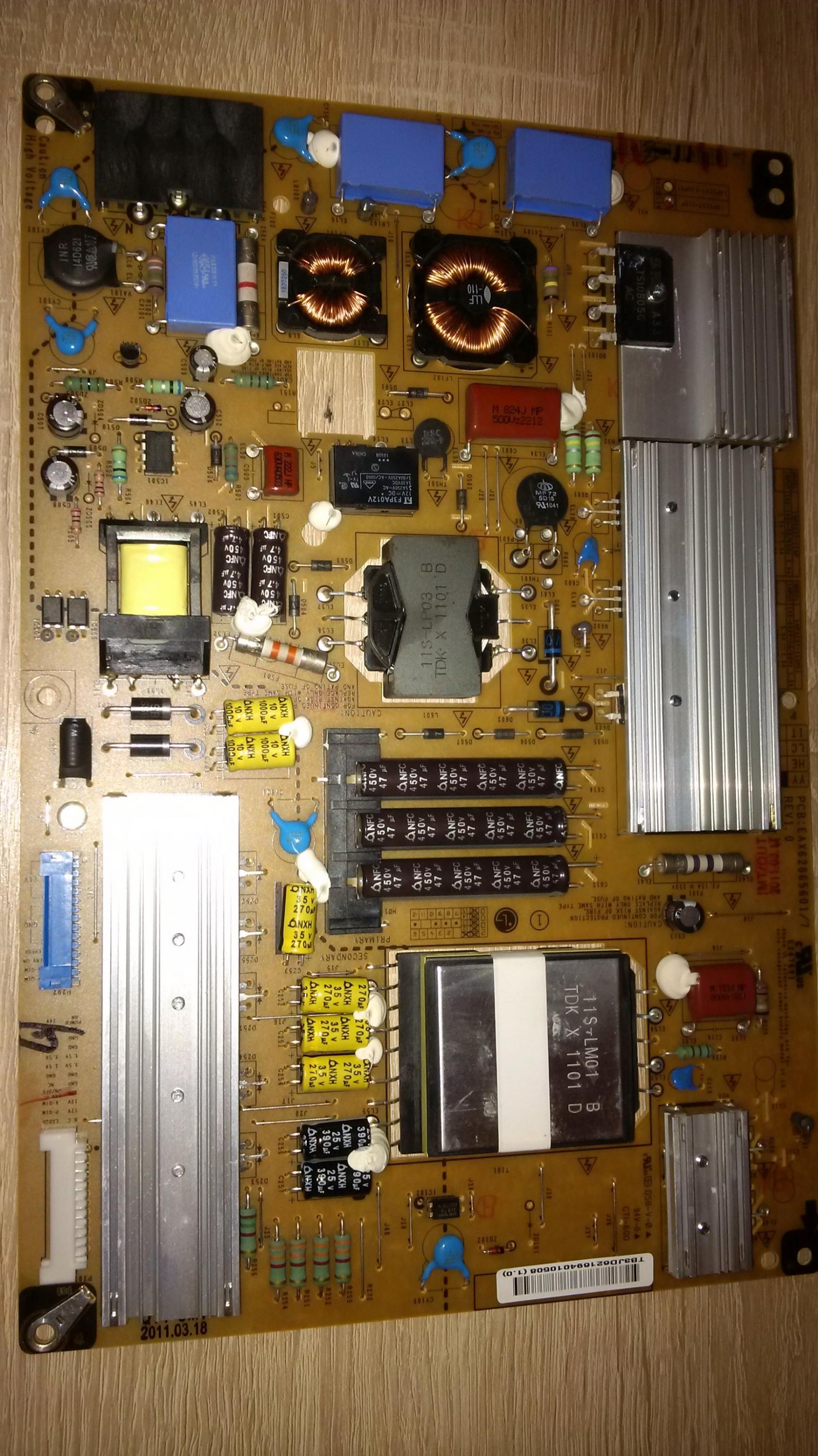

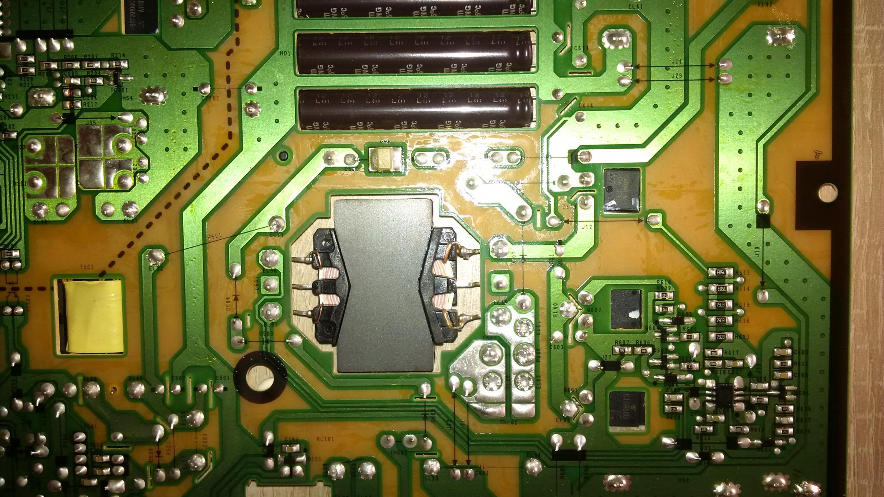

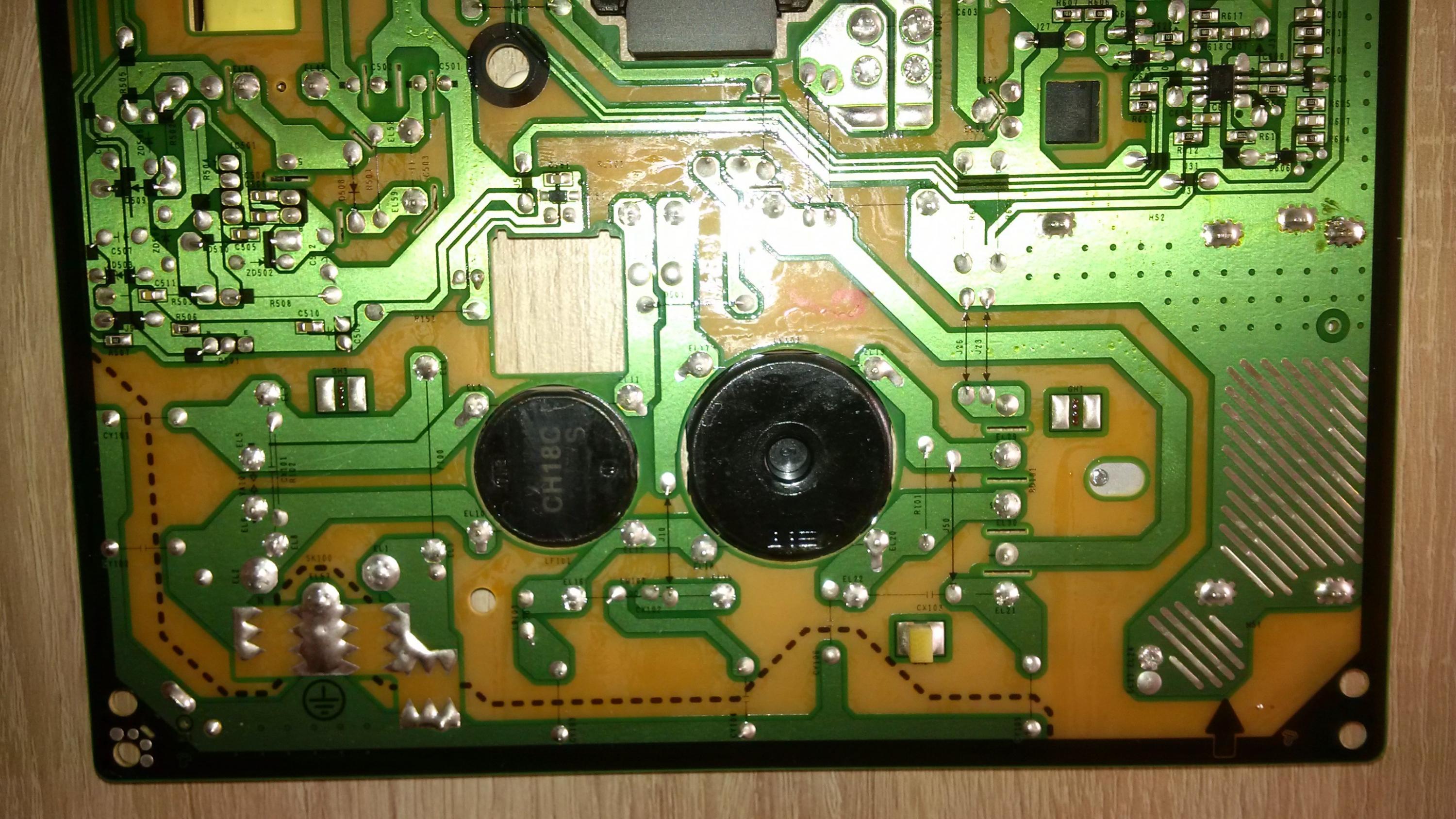

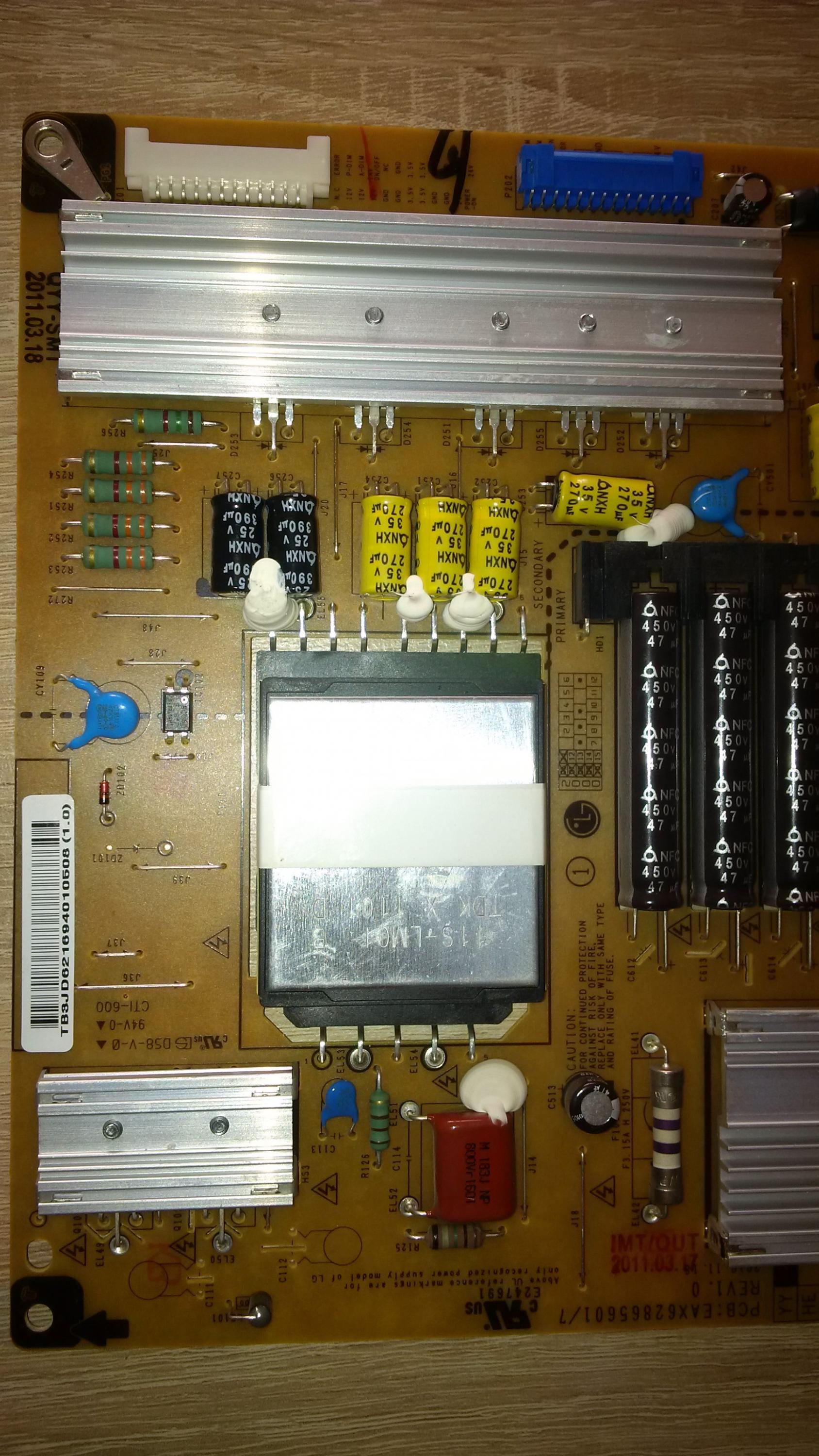

    Can we get straight shot pictures of the whole top side and bottom side of this power supply board?

      If you have +12 volts, you should also have +24 volts, they both come from the same T101 transformer, so check for poor connections on the transformer pins and diodes 251, D252, D255
        uploading pic

          ok guys I have all voltages OK on power board
          3,5 12v and 24v
          now I must to see why is not powering backlight..

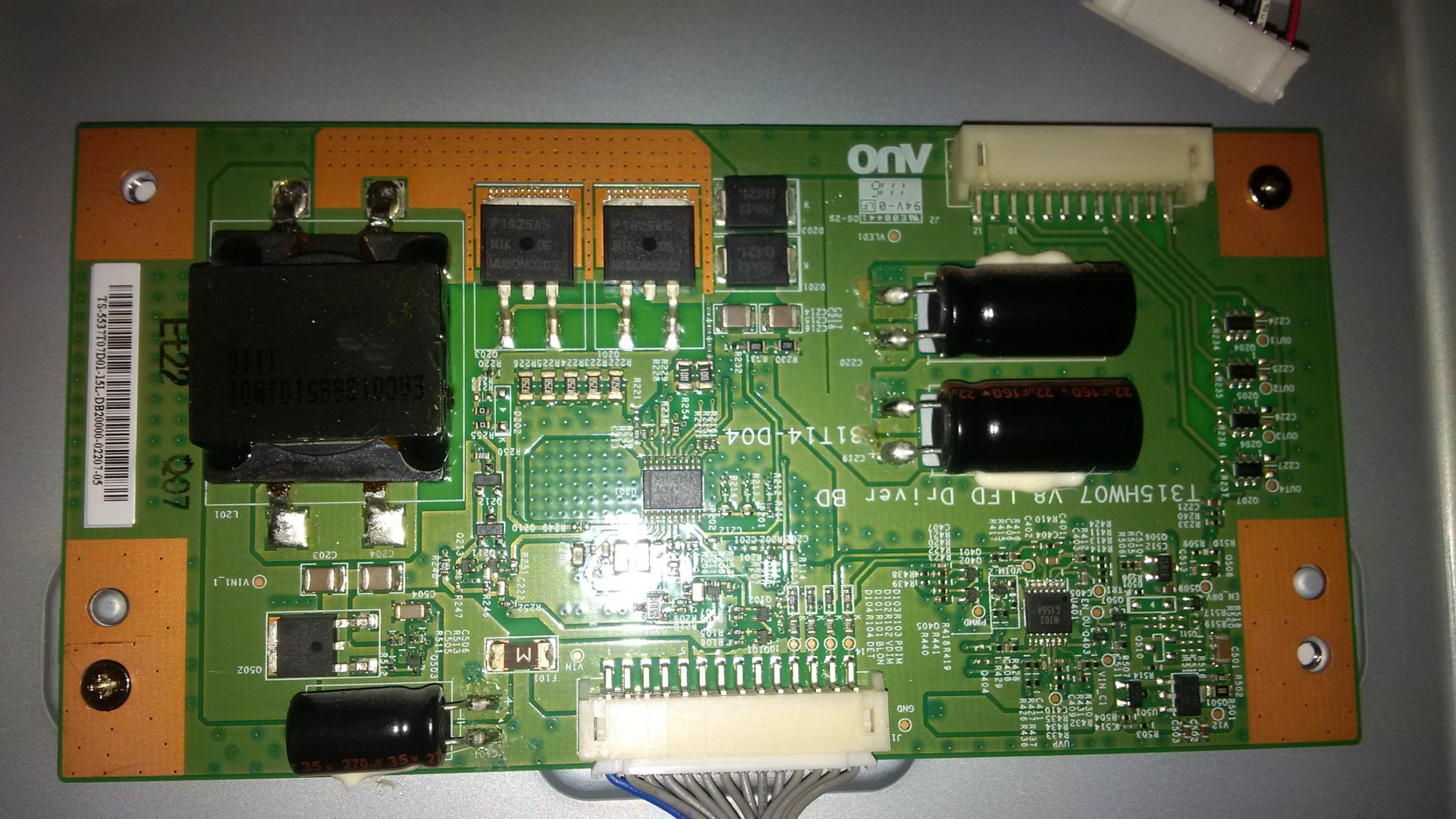

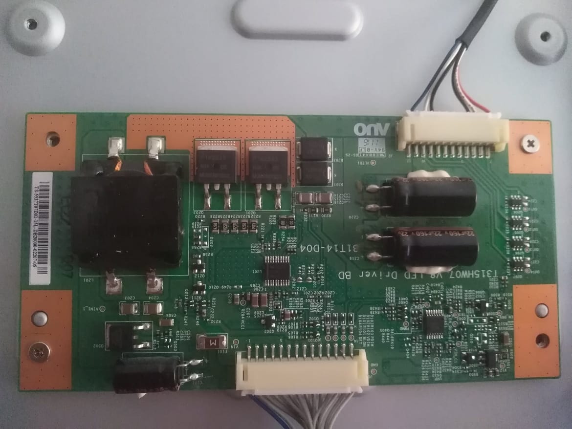

                            I think that Led driver board is faulty,24 volt is coming to board but 0V out from board, with or without cable disconnected from led strips

                              Check the fuse on the driver board, it is labeled F101 [M] (4amp), if the fuse is ok, check the voltage across c219 or c220, this voltage needs to be monitored when you first turn on the tv, If there is a fault with the backlights, the board will error and shut down.
                                fuse is ok ,no voltage on c219 and c220
                                C101 24v

                                  It could be that there is no backlight on or INV_ON signal going to that driver board, My guess is that Q502 switches the +24 volts on for the driver board, It looks like the BLON is pin 12 of J1, check the voltage on pins 11~14
                                    pin 14 3.35V
                                    pin 13 2.44v
                                    inv ON 0.03
                                    • R_J
                                      • Jun 2012
                                      • 9624
                                      There you go, you are missing inverter ON, monitor that pin when you first turn on the tv to see if it comes up to 3 volts then drops. What about pin 11 DET?
                                        from zero to 0.03V not 3V
                                        pin 11 0V
