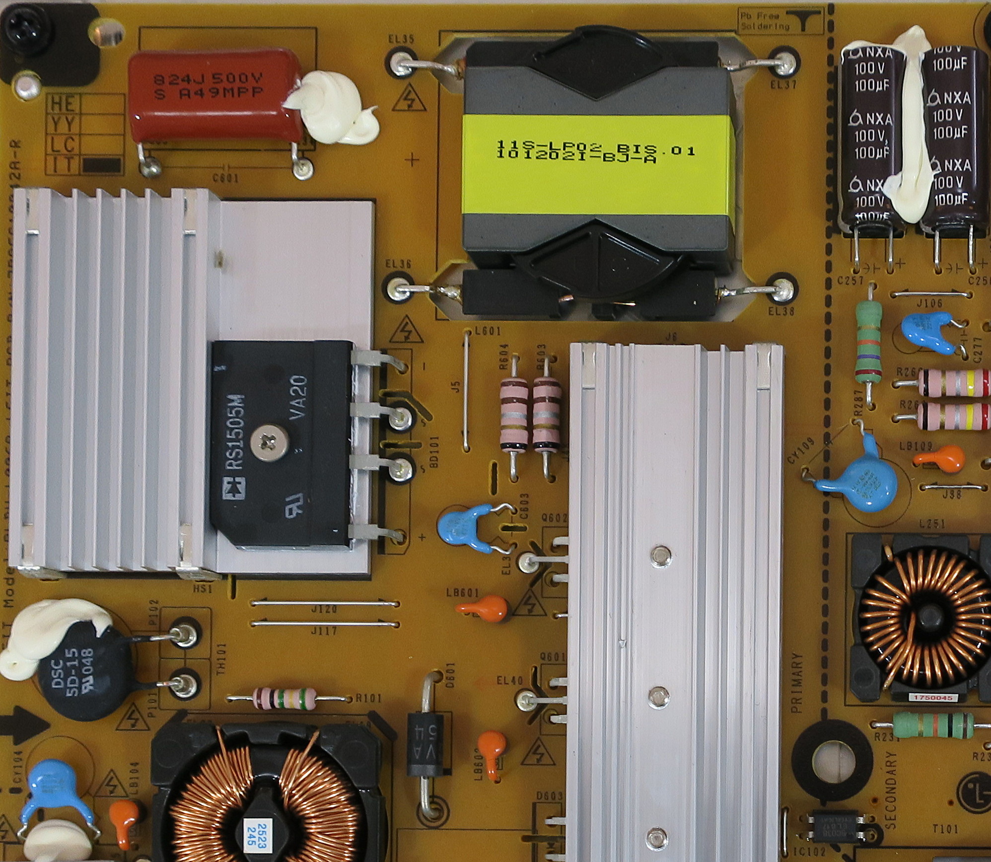

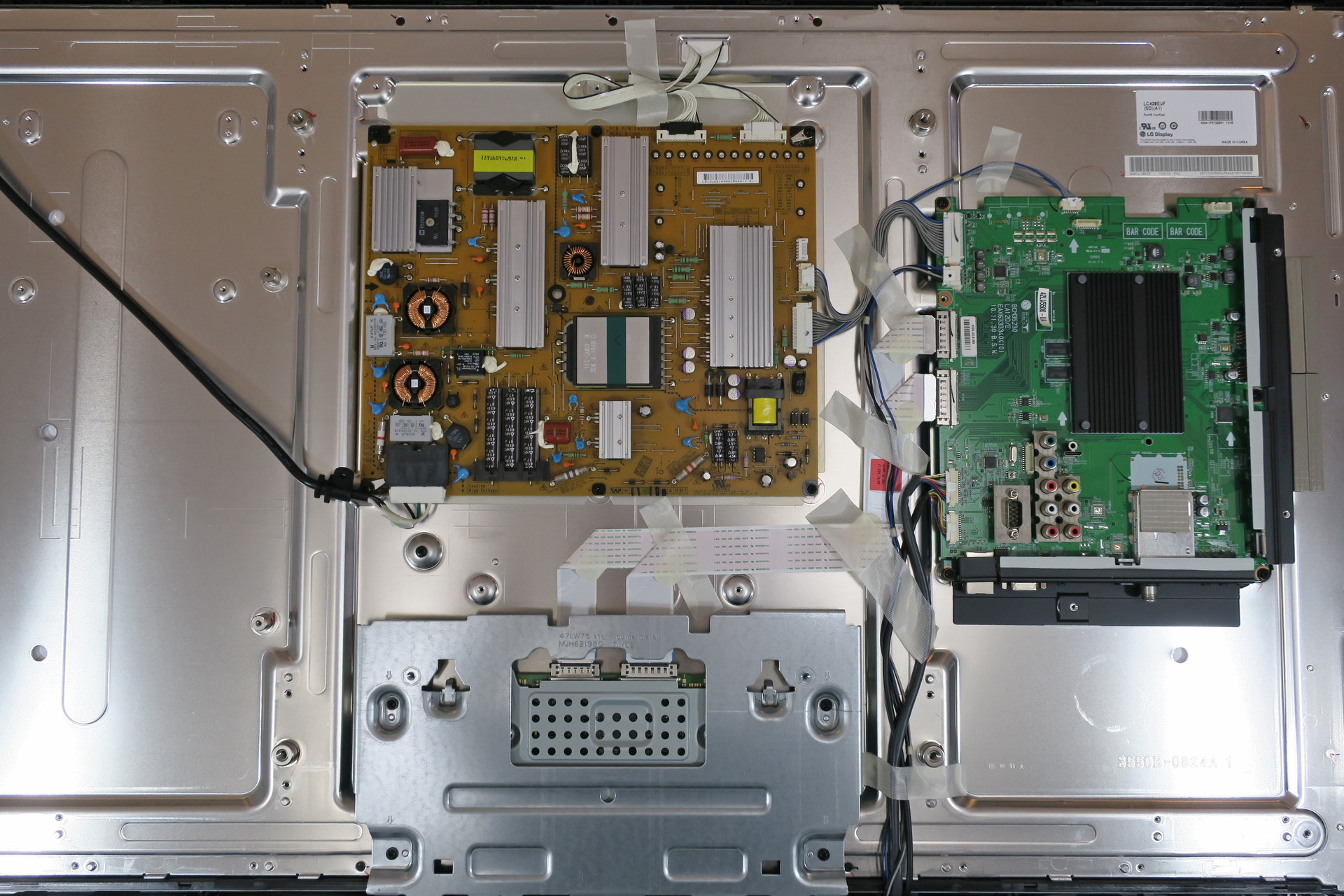

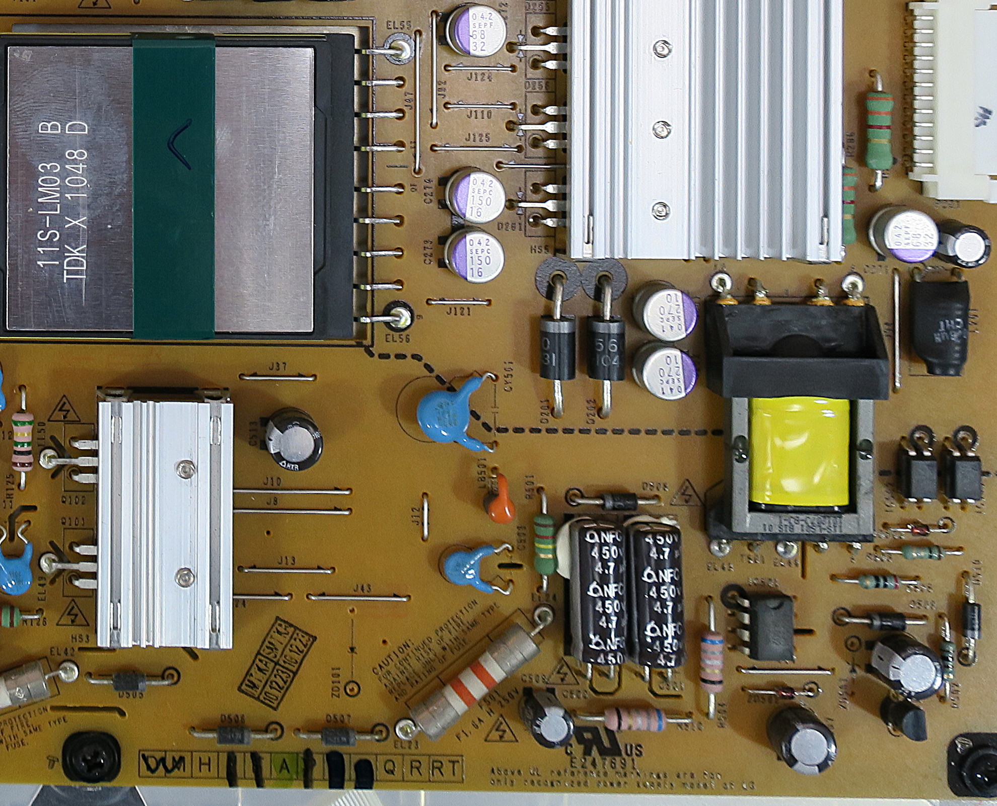

    My LG TV 42LV5500 no longer shows anything on the screen. There is no backlight, no audio from external input sources, and using a flashlight I can't see anything on the screen either. When powering on, the status LED changes color and it makes a faint click as usual, but nothing else happens.
    The problem happened unexpectedly - everything worked ok until one day it just doesn't show anything when powering on. I took the back cover off, there's a green board (I'm guessing the main board) and a brown board (probably the power board). Don't see any bulging or leaking capacitors. I checked the 3 fuses on the power board, and they're ok.
    Any ideas what can be the problem? What else can I check to diagnose the problem?

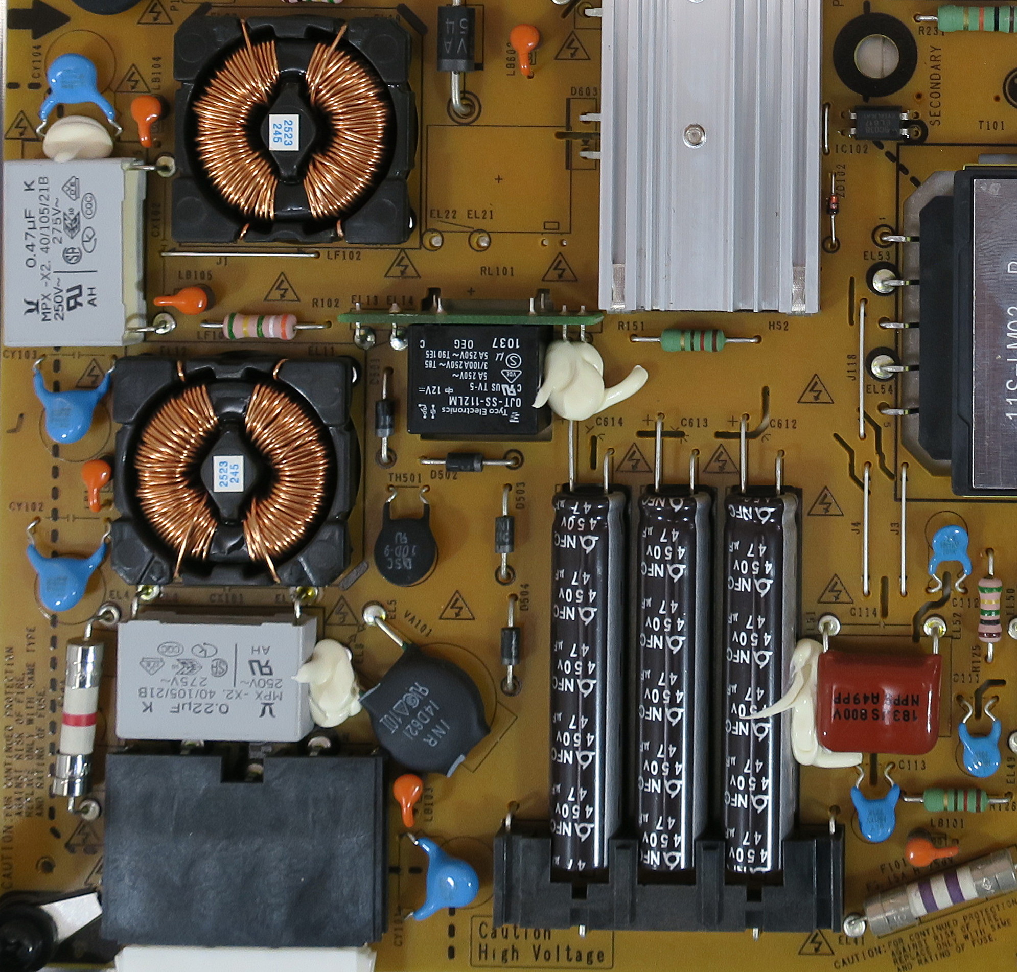

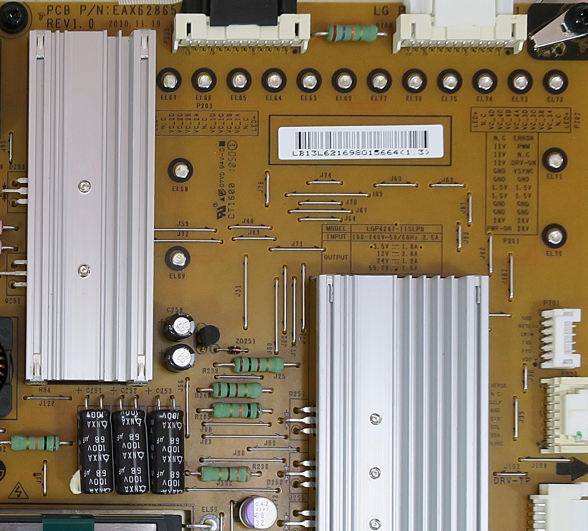

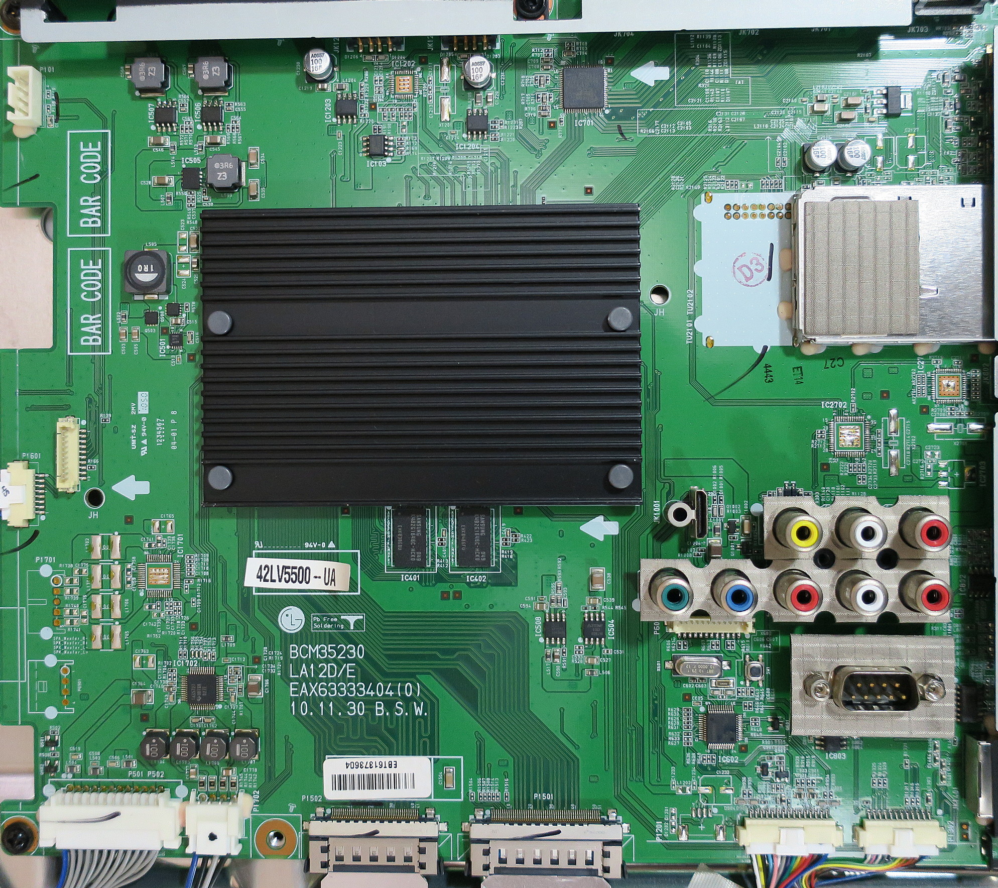

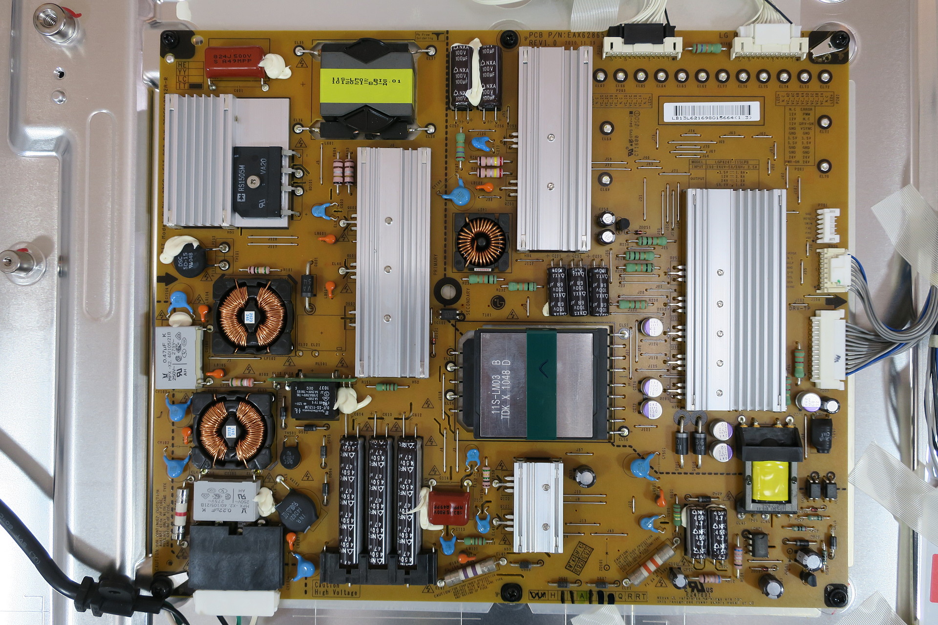

    I uploaded photos of the two boards, and closeups of the power board.

    The connector on the power supply board that goes to the Main board has pin name for each pin, you need to check the Voltage on each pin when TV is OFF and when power switch is activated.
    You MUST put down the pin name and follow by the Voltage reading for each pin so we can easily see what the Voltages are.

      Adding to budm request, turn the TV on and measure the 450V main capacitor. Be careful working there!

        LV series suffers from BGA failure.on the main processor

          I measured the voltage across the 450V capacitors, they show about 400V when the TV is powered on.
          Measured the voltages on the 24 pin connector from the power board to the main board. Here are the voltages listed below for each pin when the unit is in standby mode and when powered on. Some pins have a small AC voltage, so I listed those too.
          Pin_____OFF_____ON
          NC______0_______0____(0.6 - 1V AC 120Hz)
          12V_____0_______11.89
          GND_____0_______0
          GND_____0_______0
          3.5V____3.5_____3.5
          3.5V____3.5_____3.5
          GND_____0_______0
          GND_____0_______0
          24V_____0_______24.4
          PWN-ON__0_______3.4
          ERROR___0_______0
          PWM_____0_______3.2
          NC______0_______0____(0.6V - 1V AC 120Hz)
          DRV-ON__0_______0.04
          VSYNC___0_______0____(0.6V - 1V AC 120Hz)
          GND_____0_______0
          3.5V____3.5_____3.5
          3.5V____3.5_____3.5
          GND_____0_______0
          GND_____0_______0
          I might try reflowing the CPU on the main board with a heat gun, I heard some people fixed their TV that way.

            Looks like you're not getting proper drv-on voltage from the mainboard.

                your main board isn't sending DRV-ON signal (back lights).

                    then force the psu on. Unhook the main board from the PSU. Put a 1k resistor from STBY to PSon and another resistor from STBY to BLon.

                          Good news - I reflowed the processor on the main board, and the TV works as good as new. Thanks for everyone's help and advice.

                            Results may only be temporary and board will likely fail in weeks or months. Reballing is the proper repair.
