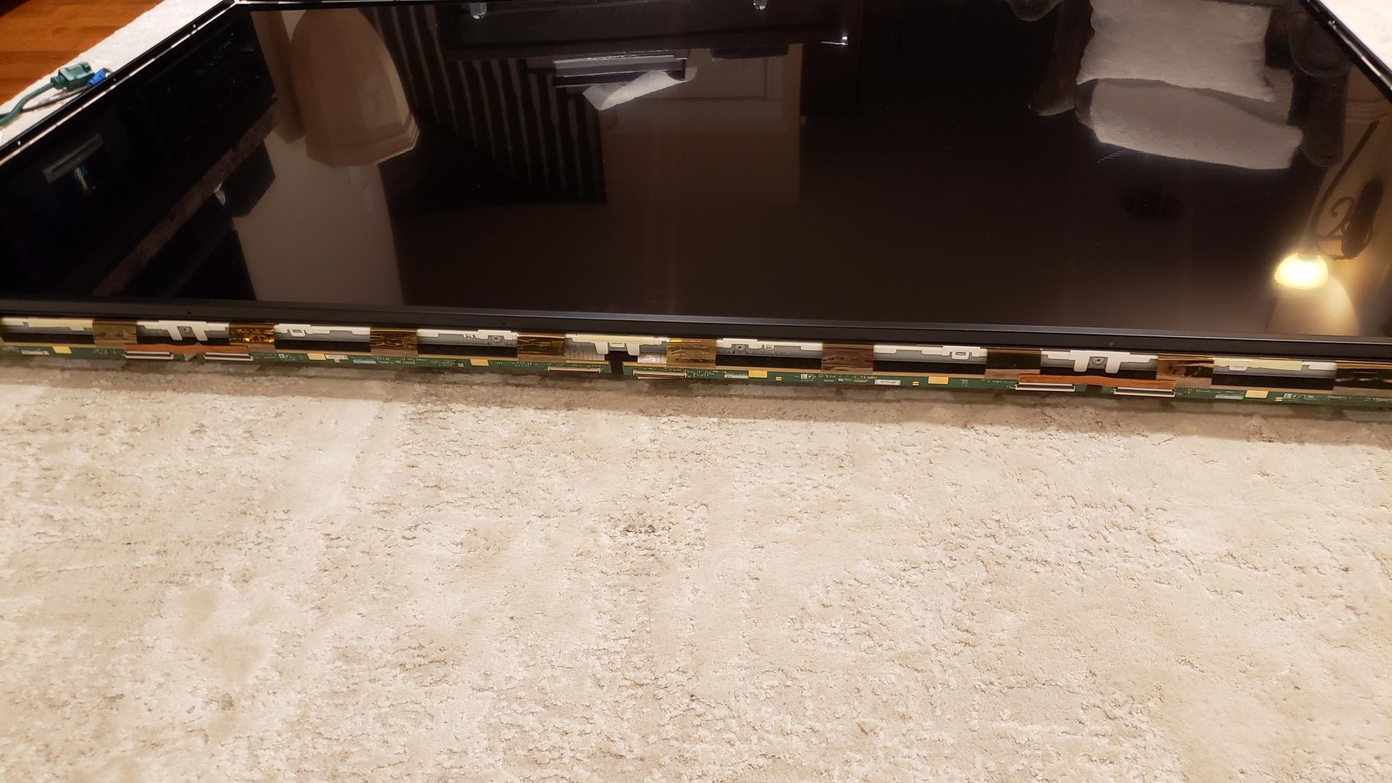

    I have a Sharp 70LE660U. The problem started a few months ago with the bottom row looking out of sync and was dark on the left side and then fading to transparent on the right side. Shortly after, a dark cloud appeared in the center of the screen. The dark cloud started small and shaded but the image was visible. It also affected the menu area. If I left the TV on for about 30 min, the dark cloud would go way only leaving an overall clear picture with the bottom row still out of whack. With time the dark cloud got larger and darker and even after 30 min would not go away.
    Then the opposite happened. If I unplugged the TV power for 24 to 48 hours, on the first power up, the TV would display a clear picture except for the bottom row still out of whack. After about 30 min of the screen displaying properly, it would flash a few times and then the dark cloud would appear again. After the first power up, every other attempt of turning the TV On/OFF (without unplugging it), it would instantly display the dark cloud, always in the center. During all of this, I never had the TV opened and or never tried to work on the internals.

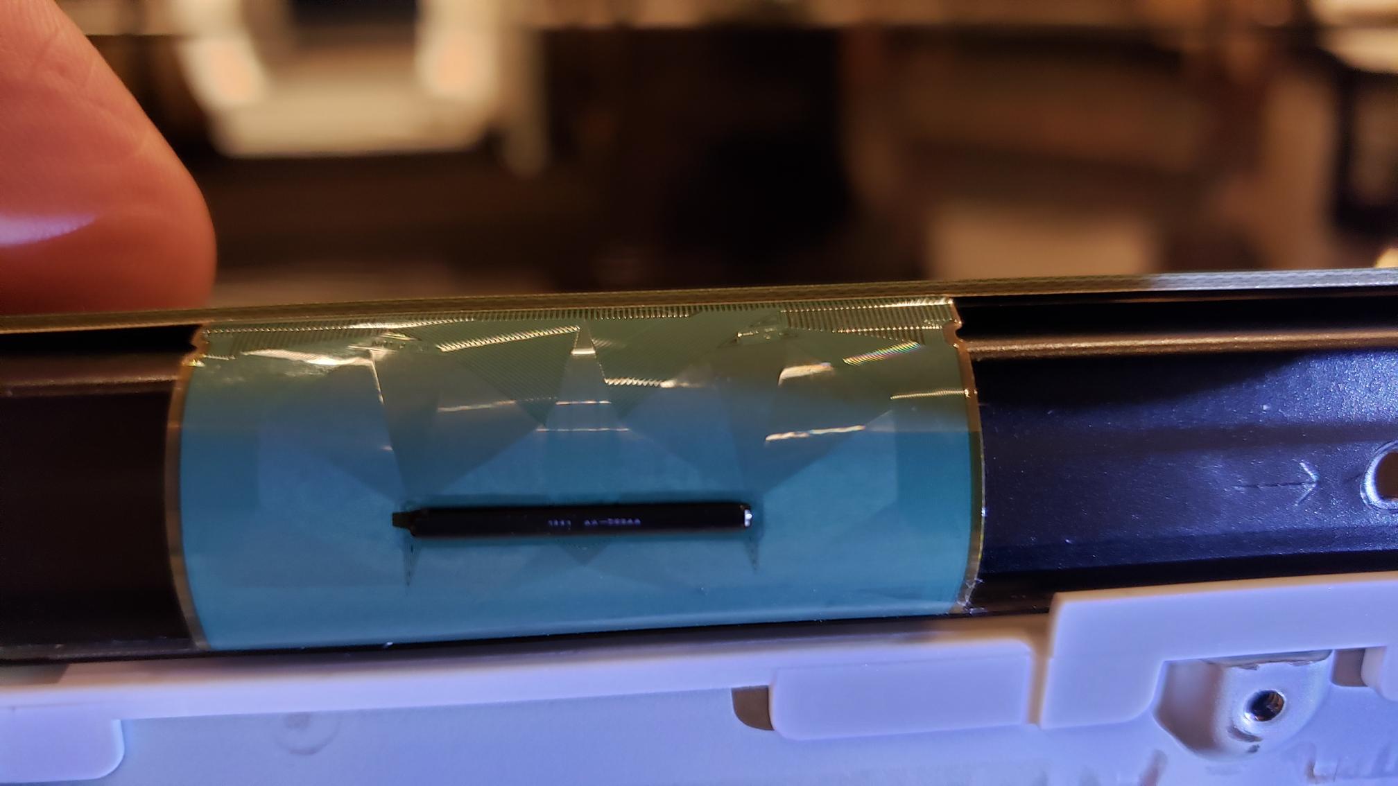

    After reading all the posts in this forum, I was convinced it was the tabs that needed pulling (i.e. tab surgery). My dilemma was that the dark cloud was in the center of the screen so I couldn't figure out if the left or right tabs were the issue. Also, as I understood it, the tabs (as described in the posts) are supposed to be located on the left and or right edge of the screen. The tabs on my TV are located on the bottom edge of the TV. I also have what looks like single tabs on the left and right edge of the TV but the do not look the same as the ones that connect to the t-con board. They are smaller.

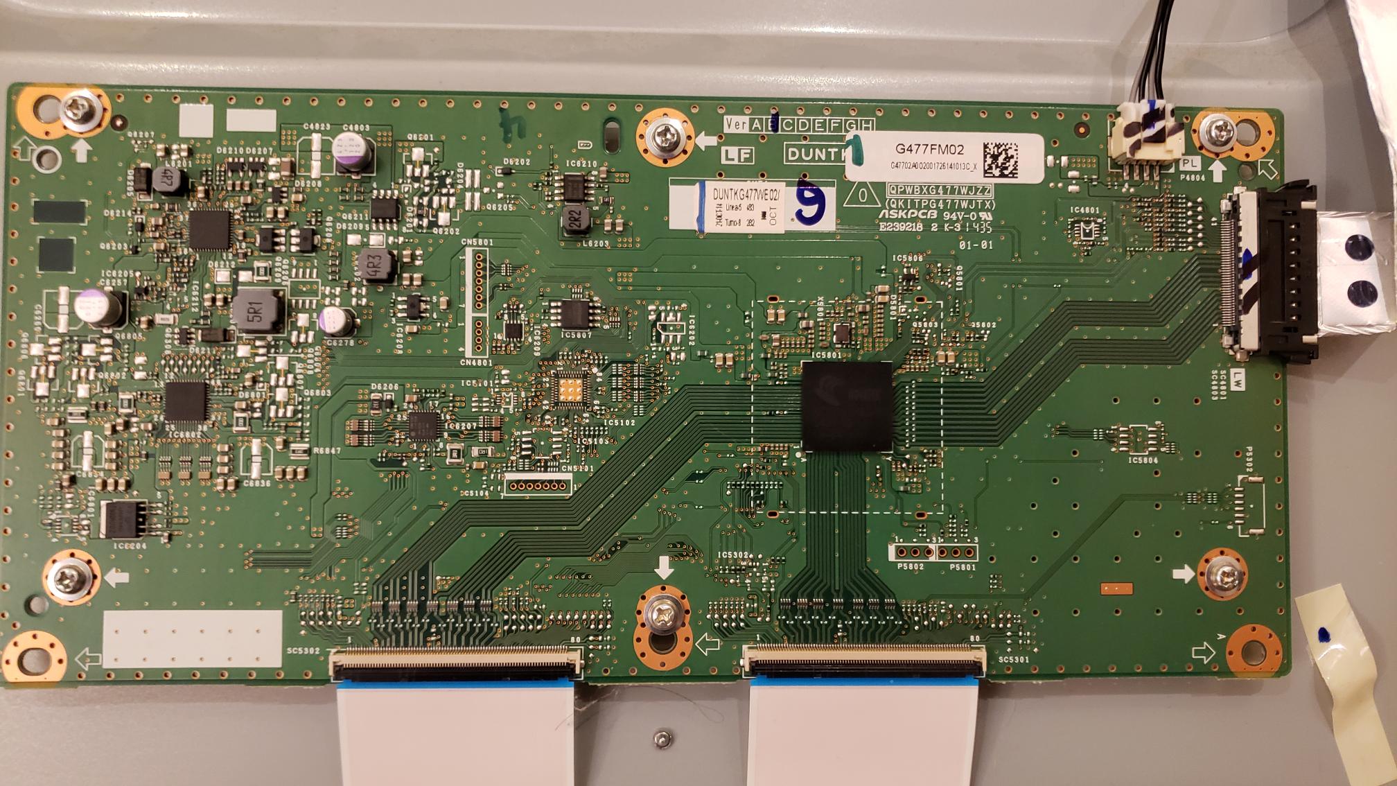

    Before pulling the tabs, I decided to purchased a new t-con board to make sure that was not the issue. I changed the board and still had the same problem. I then disconnected the ribbon cables from the t-con board, first the left then the right and in each scenario I would get the white screen on one side and a dark cloud image on the other side. So again I couldn't tell which side is problematic.

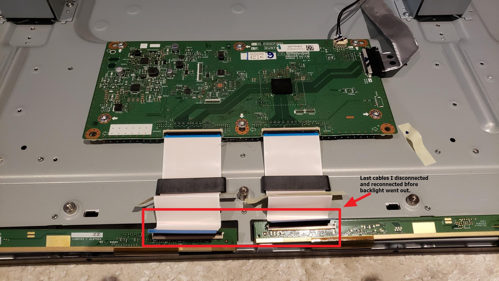

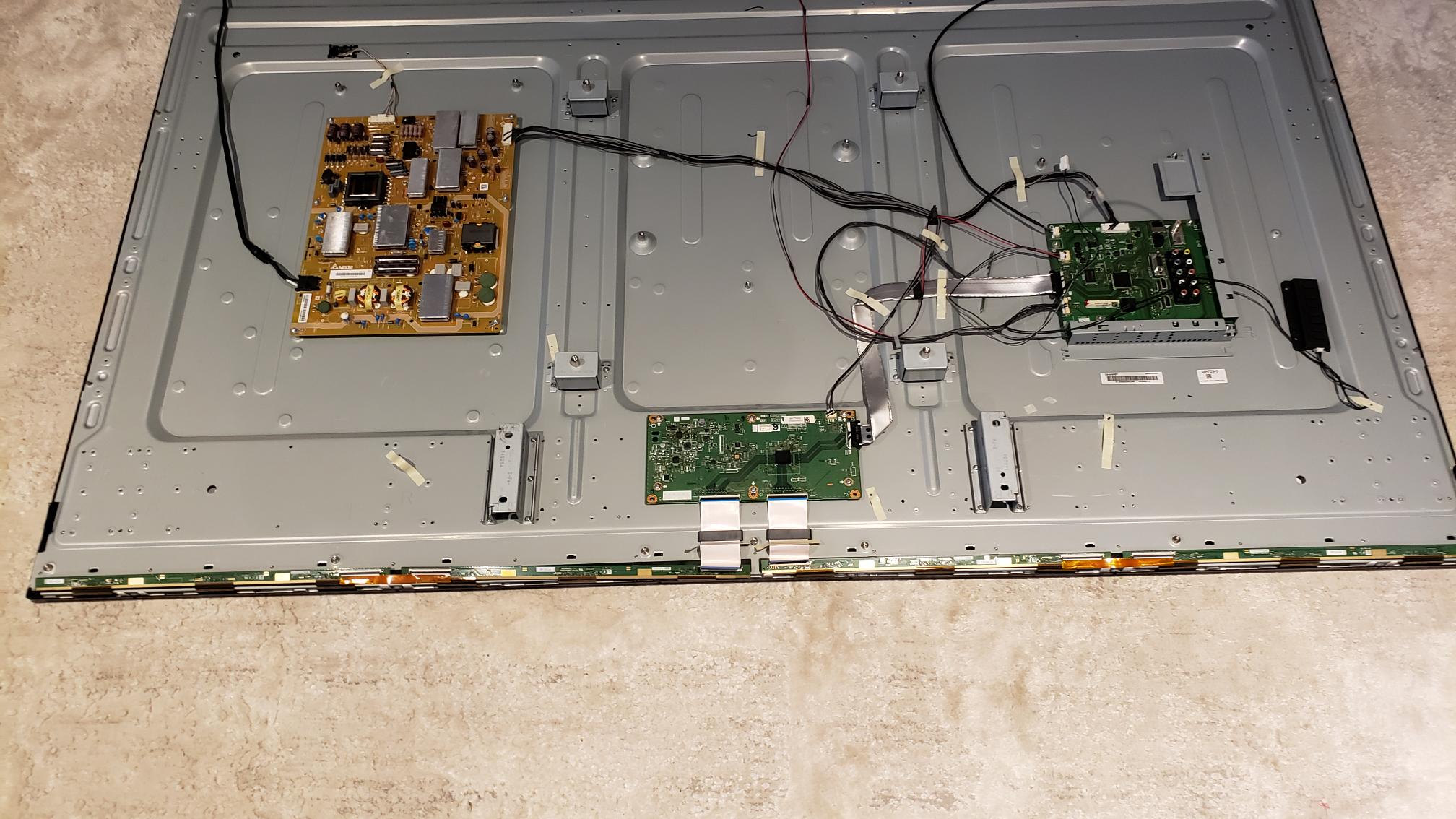

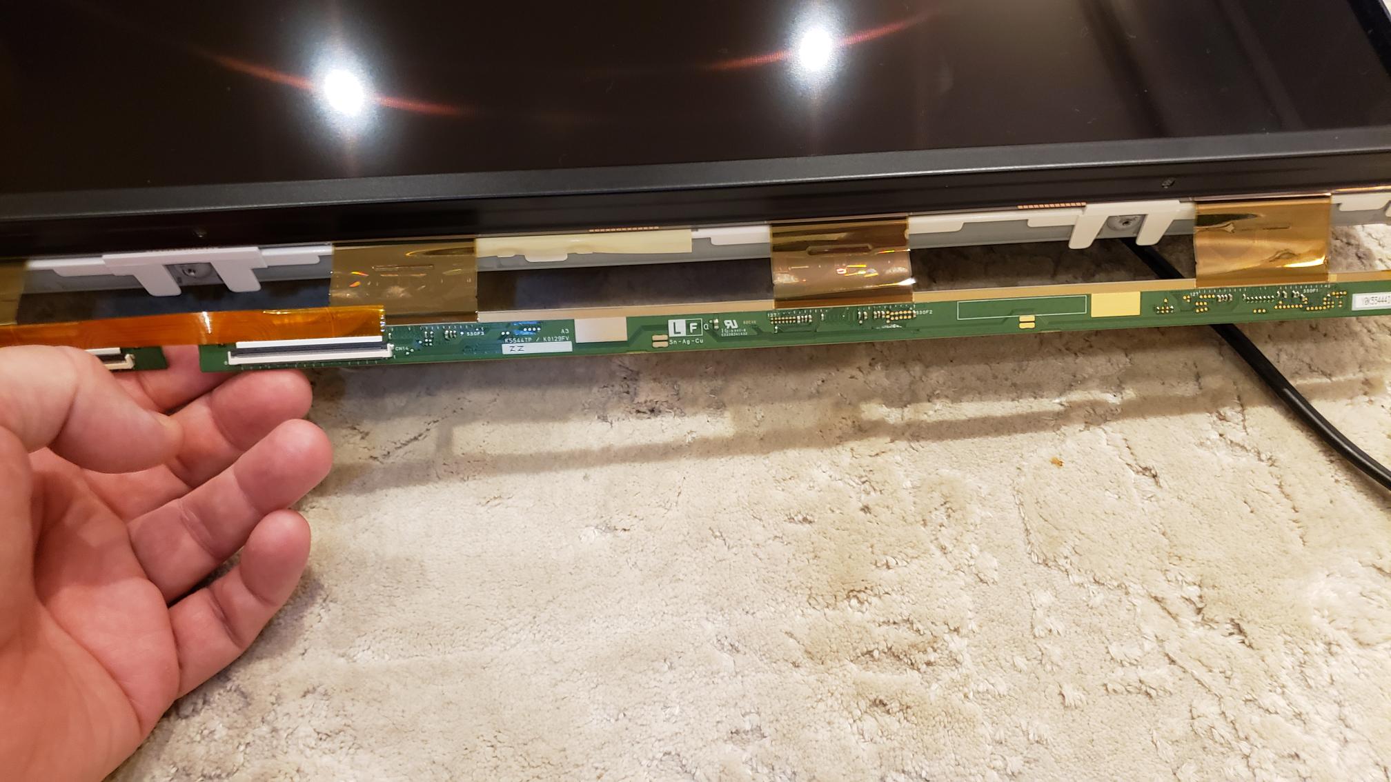

    I then disconnected the ribbon cables that connected to the tabs section (see image t-con-ribbon-cables.jpg). It didn't help, but a new symptom showed up. Not sure if it was because I reconnected the cables incorrectly or it was coincidence, but now on power up, after about 15 secs, the backlight will flash and turn off. I still have sound and there are no error codes. I tried the flashlight test and could not see any image.
    So at this point I have a TV that turns on, no image, no error codes, with sound and any input I try is the same. I opened up the frame to expose the tabs and they do not have any discoloration as if they are burnt (please see attached images).

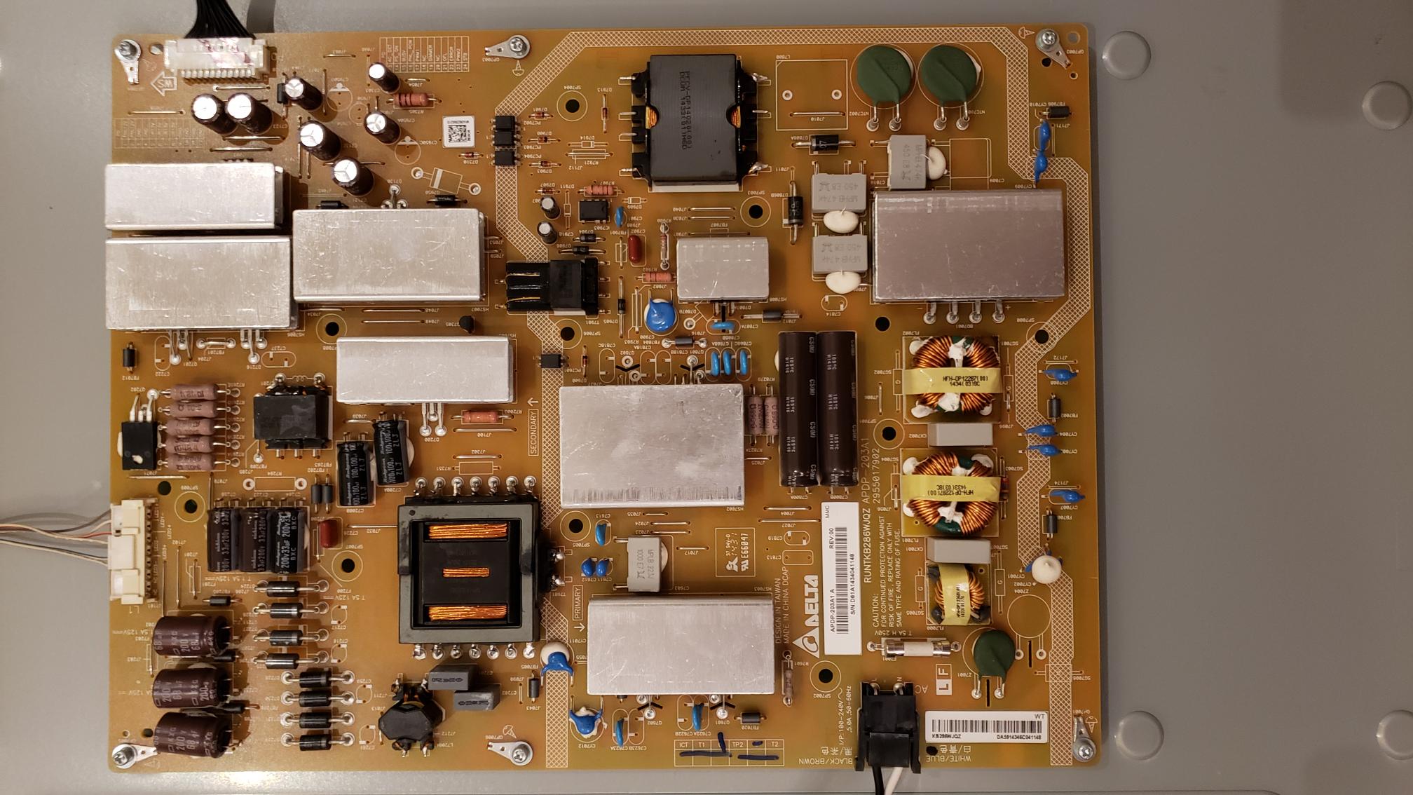

    Not sure where to go from here. I ordered a new power supply/led driver board and a new t-con board. I would have ordered a new main board, but they are not existent.

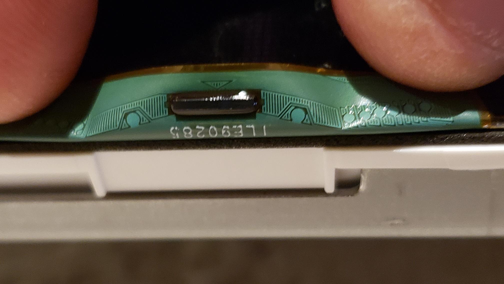

    I have included a few images. I only included one image of the tab chip (tab-chip.jpg) but they all look the same (i.e. no burnt ribbon). I also added an image of the side tabs located on the left and right edge of the tv (side-tabs.jpg) as well as a single image of the chip state on the side tabs (single-side-chip.jpg). Again they all look the same and no visible burnt marks.

    You probably already tried just putting a little pressure on the tab bonds, with your finger, one at a time wile it's on and see if there's a change in display.

      Another simple test, check the little mlc capacitors on the panel driver boards for shorts or very low ohms.

        Thanks for the reply. Yes I tried the putting pressure on the tabs as well as all the other connections, no change. Other than a visual inspection I did not test the capacitors. None of them looked liked there were bubbling.

          I'm referring to the boards you have a hold of in picture #6, the little tan colored ceramic capacitors.

            As best as I could measure, some were very tiny, using a digital multimeter, none appeared to be shorted or resulting in low ohms. Most were in the 1.4 to 3 mega ohms range others were on the 200 kilo ohms range. Does that make sense?

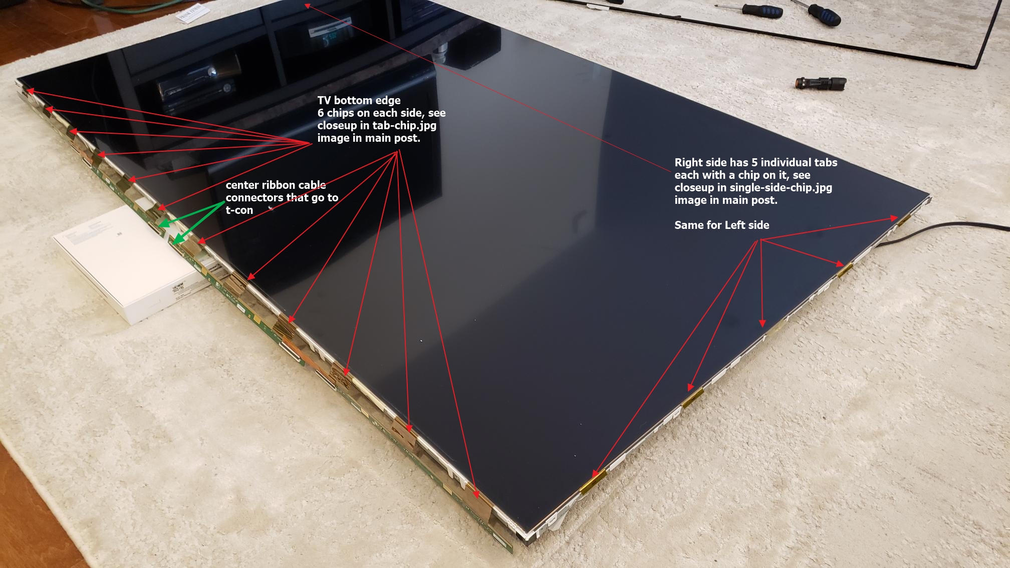

              Yes that seems ok. So there is only one chip on each side? The last sharp I dealt with had 4 or 5 chips on each side. Most of the time when I had a dark growing or rolling cloud it was a tab bond not getting good connection, maybe check all the usual voltages on the tcon, can check youtube for tcon troubleshooting, one there and many more: https://www.youtube.com/watch?v=FexX7TGRzDc

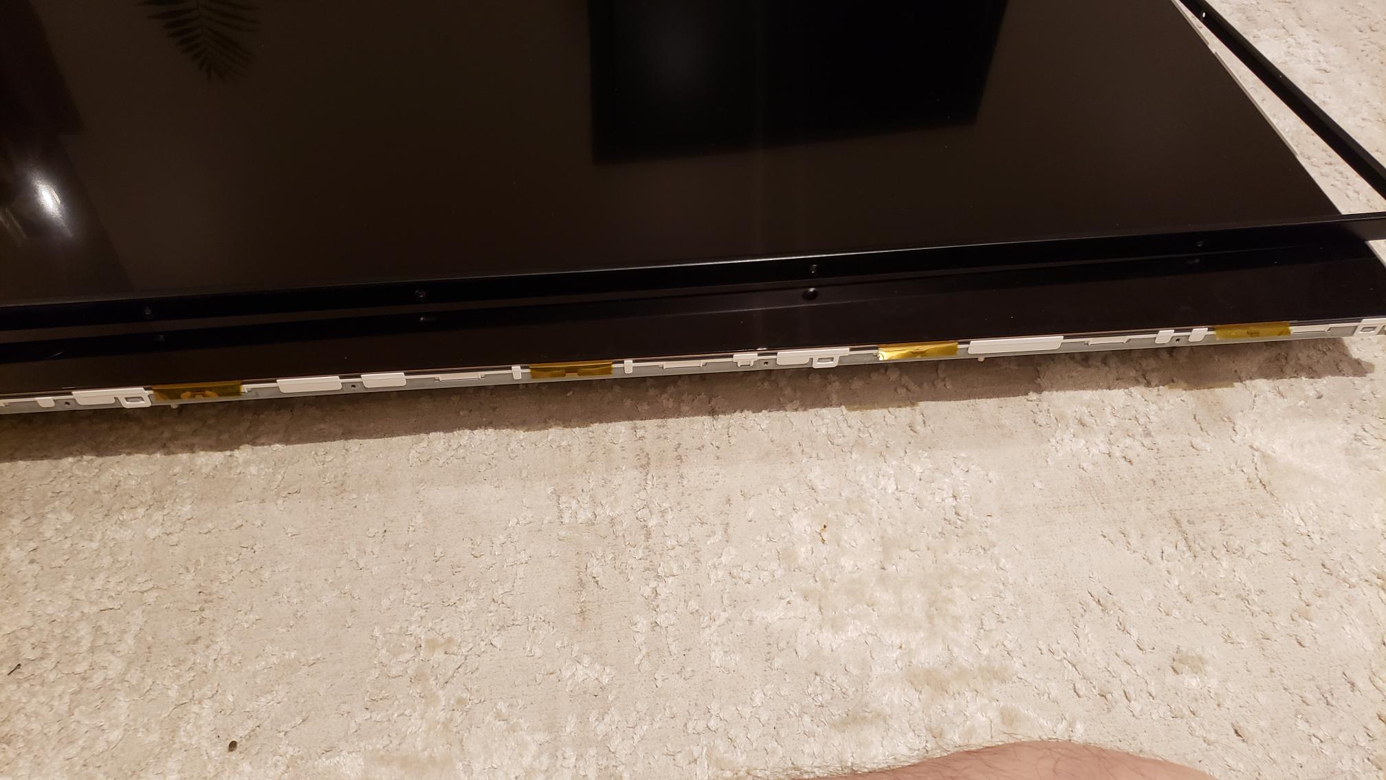

                There are what looks like 5 individual tabs with a chip on it on both the left and right sides of the TV. Then on the bottom edge of the tv, there are 6 ribbon cables, each with a chip on it, connected to the long PCB strip on either side of the t-con. That makes 12 on the bottom of the TV. Please see attached for better explanation.

                  Ok, that makes much more sense, you want to inspect the side ones closely, you should also be able to carefully look on the reverse side of those chips for damage of any kind, usually if it is a bad side cof, it shows which one in the one connected at a time tcon ribbon test, do any of them get a lot hotter than the others?
                  • nomoresonys
                    • Jan 2013
                    • 12181
                    • U.S.
                    Re: 70LE660U dark cloud or black screen with sound.
                    There's a really good thread that covers the bad side cof situation, tho not sure if that IS your issue, that was started by Freakafter8, check it out, it covers that whole gamut.

                                  I have 4 t-con boards. At the time I purchased the first 2 t-con boards, I thought I did my due diligence and tried to stay away potential scammers. I live in Canada so I purchased them all from a site in Canada. I am confident the site I used is reputable. For the last t-con board I purchased they even called me after I placed the order to confirm it would work with my TV so I don't think it is a scam but you never know.
                                  The original t-con that came with the TV and the last t-con board I purchased have the exact same symptoms as the last images I posted with the color bars above (i.e. works for about an hour but later the black bar and cloud appear on the screen.) The other 2 t-con boards I believe to be defective because they both behave the same, i.e. the TV has no video, the LED backlights do not turn on and the the power supply overheats to the point where you cannot touch the heat sinks but there is still audio available. I also tried changing the power supply and the main board but it didn't make a difference. So there must be an issue with those boards because if I disconnect it from the power supply, the power supply no longer overheats.
                                  I also changed the t-con ribbon cables. The other thing I found was when I first plugged in the 4th t-con board I only got vertical lines on the screen. By disconnecting the right side on the strip of the bottom mounted ribbon cables I got the image in the first pic attached. As I re-seated all the ribbon connections I got different results ( i.e. different combination of vertical lines on the screen over the displayed image). I was able to get it to a stable point where the TV works properly for the first hour or so until the black cloud appears, which is the original problem when it all started.

                                        yours all 4 t_CON... are useless.... just put please the original one.... the issue are Panel driver SW.... i will search i may find it but you need to search too for firmware to downgrade first..
