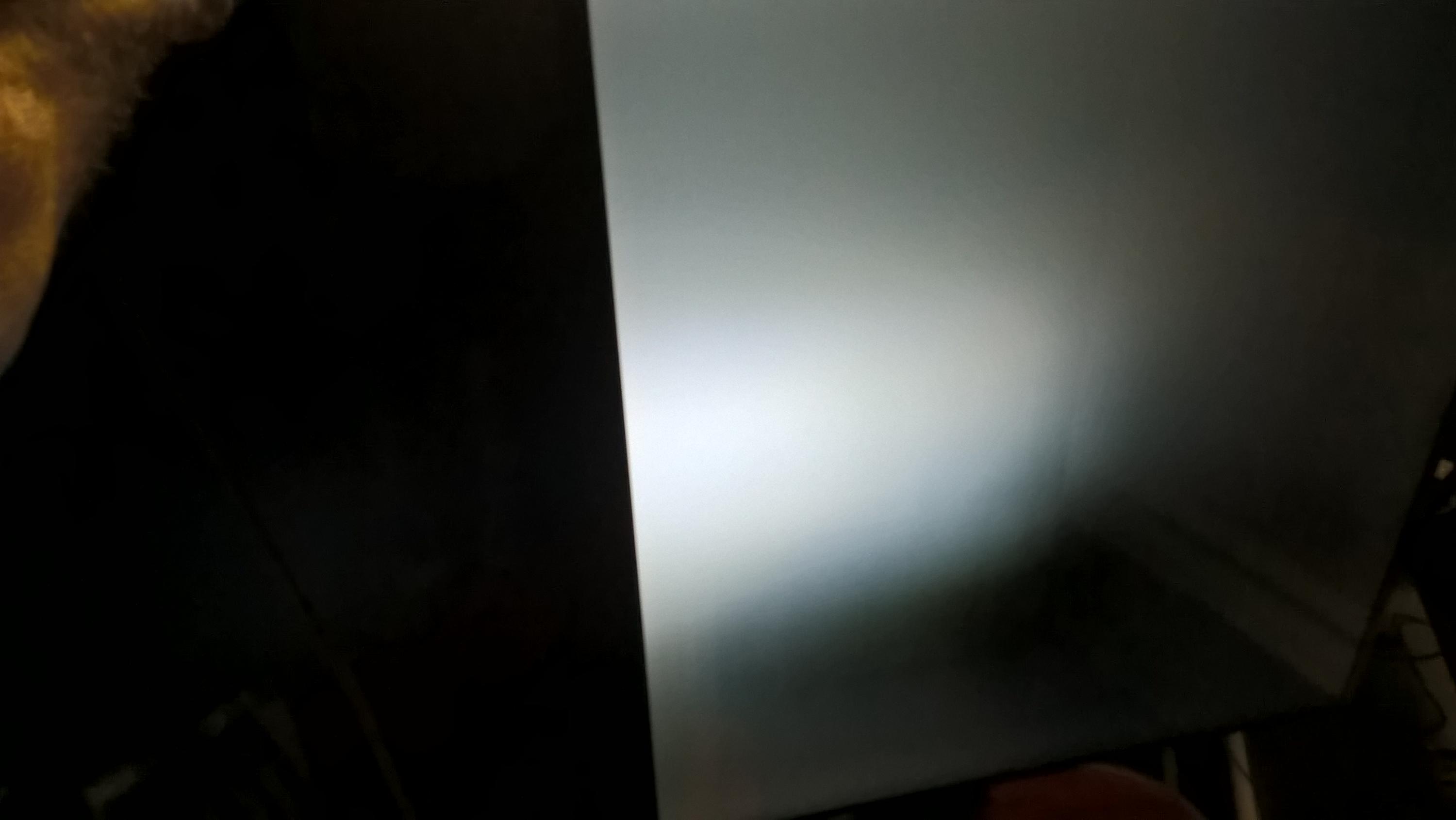

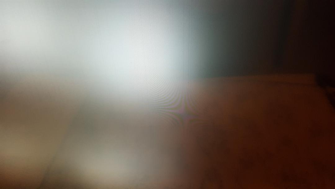

    Hay all. I picked up a vizio p602ui b3. When first plugged in the power light would come on then fade out. Pressing power button the light came on for about 10 sec. Then go out. No backlight.nothing. After reading a lot of post I read one that said try disconnecting the Wi-Fi. I did and removed the card. Plugged set back. Power light came on then faded out. Few sec later light came back on with backlight. Screen was dark with "no single" in middle. Shortly after started going weird. Bright to dim spots moving all over and fat lines from top to bottom also fading in and out and moving from top to bottom sort a like movie reel. Unplugged and reconnected Wi-Fi. Plugged back up and got same on screen. Pushing menu button will brighten up that side only. The screen is always changing. Is this a bad display.
  • nosugartonight
    • 107
    • united states
    Re: vizio p602ui b3
    Trying to post pictures.also the set can be turned on and off with power button now.
    • nosugartonight
      • 107
      • united states
      Re: vizio p602ui b3
      sometimes the words "no signal" is no there.

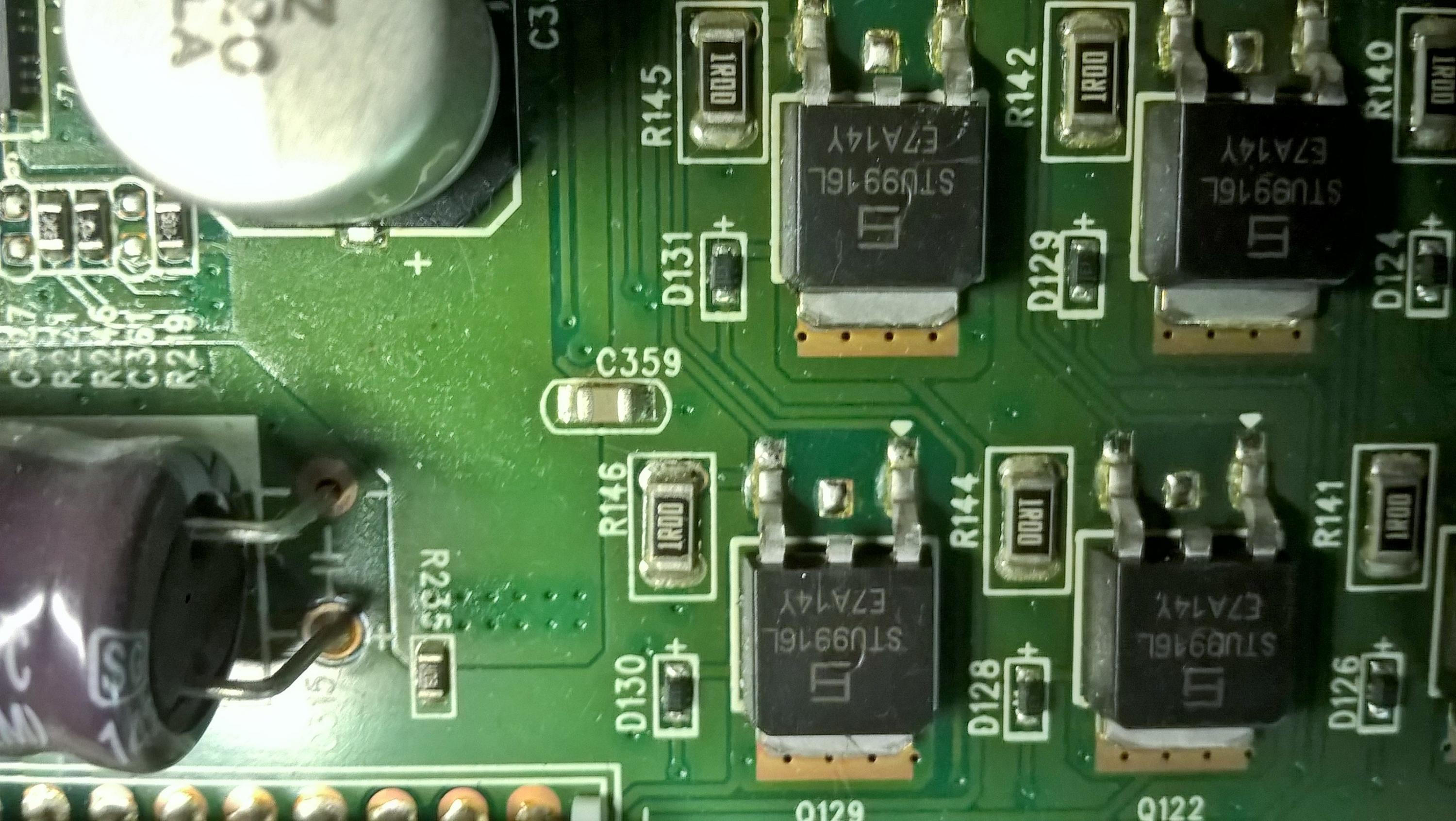

        :-( looks like someone was "washing windows" and the "wash water" got into the bottom area of the panel where the boards are. You can look at where the tab cables are connected to the panel to check for signs of "contamination" to confirm.
        • nosugartonight
          • 107
          • united states
          Re: vizio p602ui b3

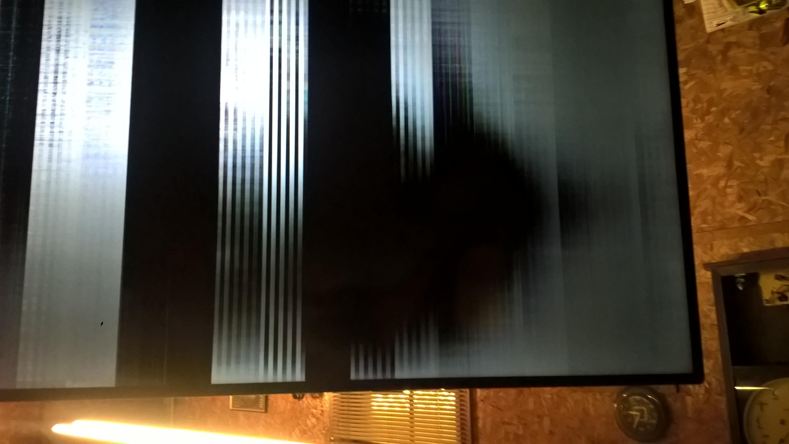

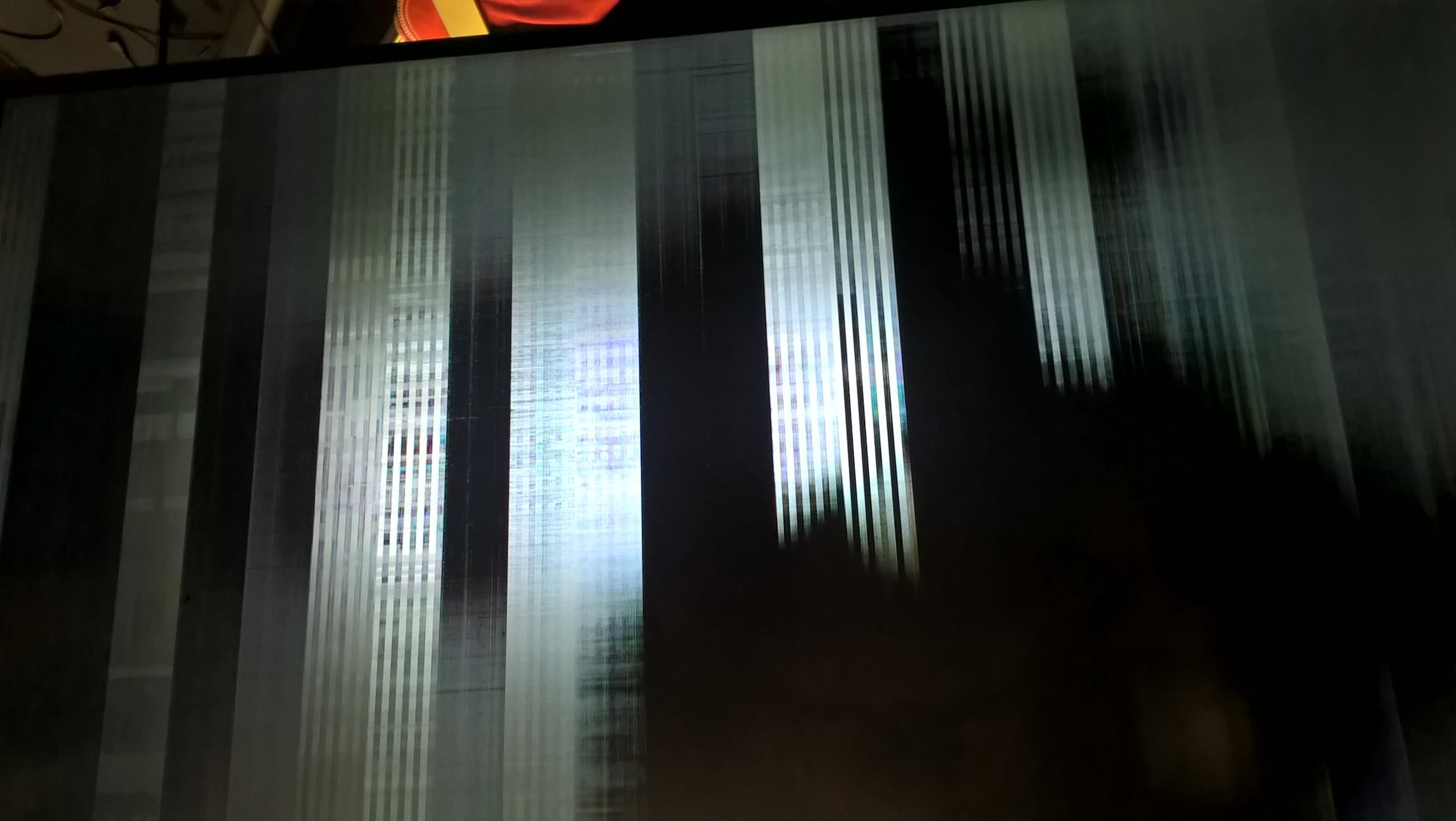

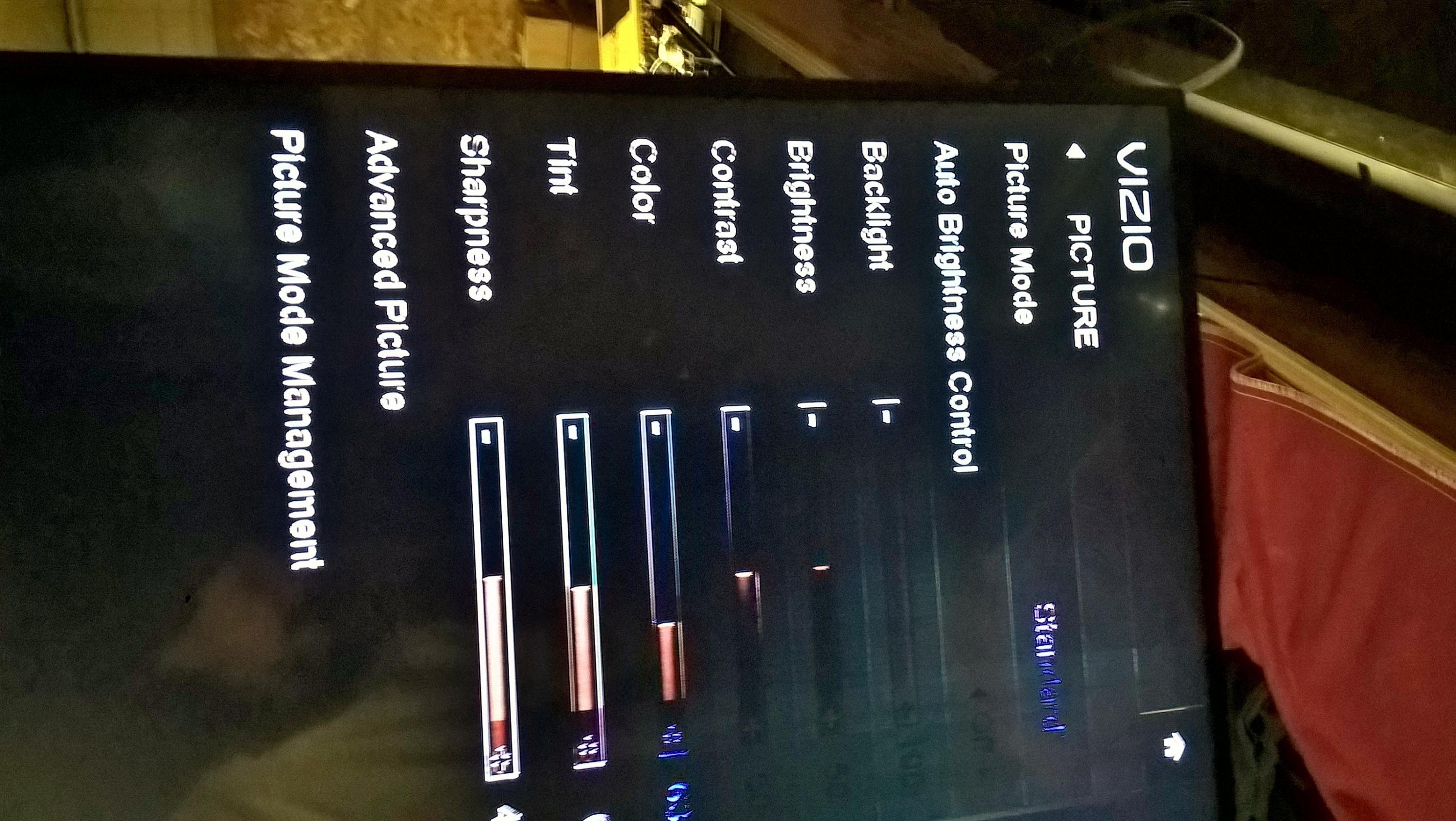

          I removed back bezel and loosened the front half of bezel to see the bottom boards "buffer" I see no water damage.no corrosion. This weird picture only starts showing after tv has been on several minutes. When first powered on. Backlight lights up then goes off.then lights up with the words "no signal" but not always. Sometimes the words fade in and out.

            Is the Vizio logo affected when the set is turned on or does it show 100% every time?
            • nosugartonight
              • 107
              • united states
              Re: vizio p602ui b3
              No logo.

                I know alot times with lines in display it's usually bad tab,but never seen the lines scroll. If it's not panel then there's something wrong with tcon or main? Would the driver board cause this problem.

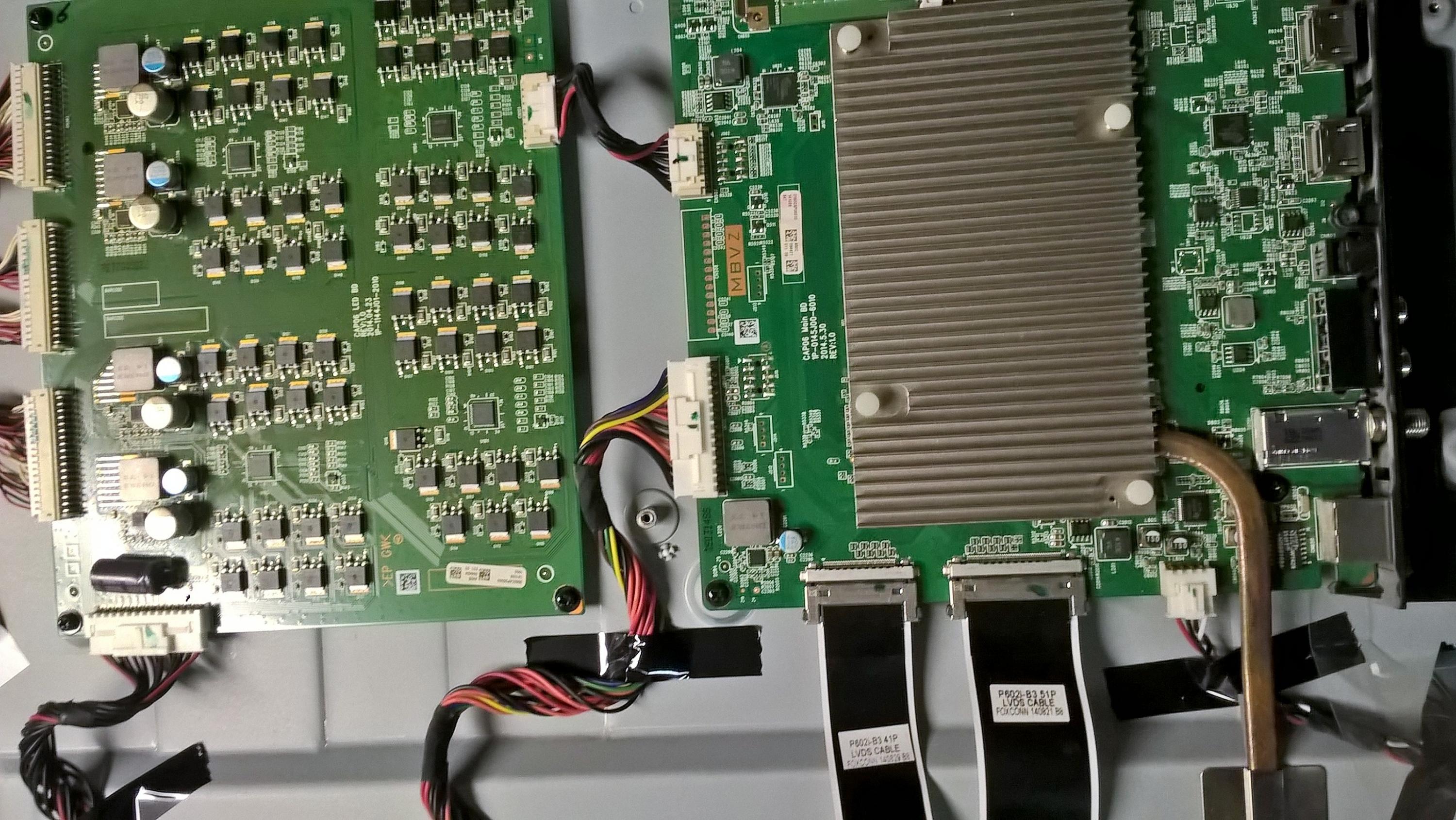

                  Re: vizio p602ui b3

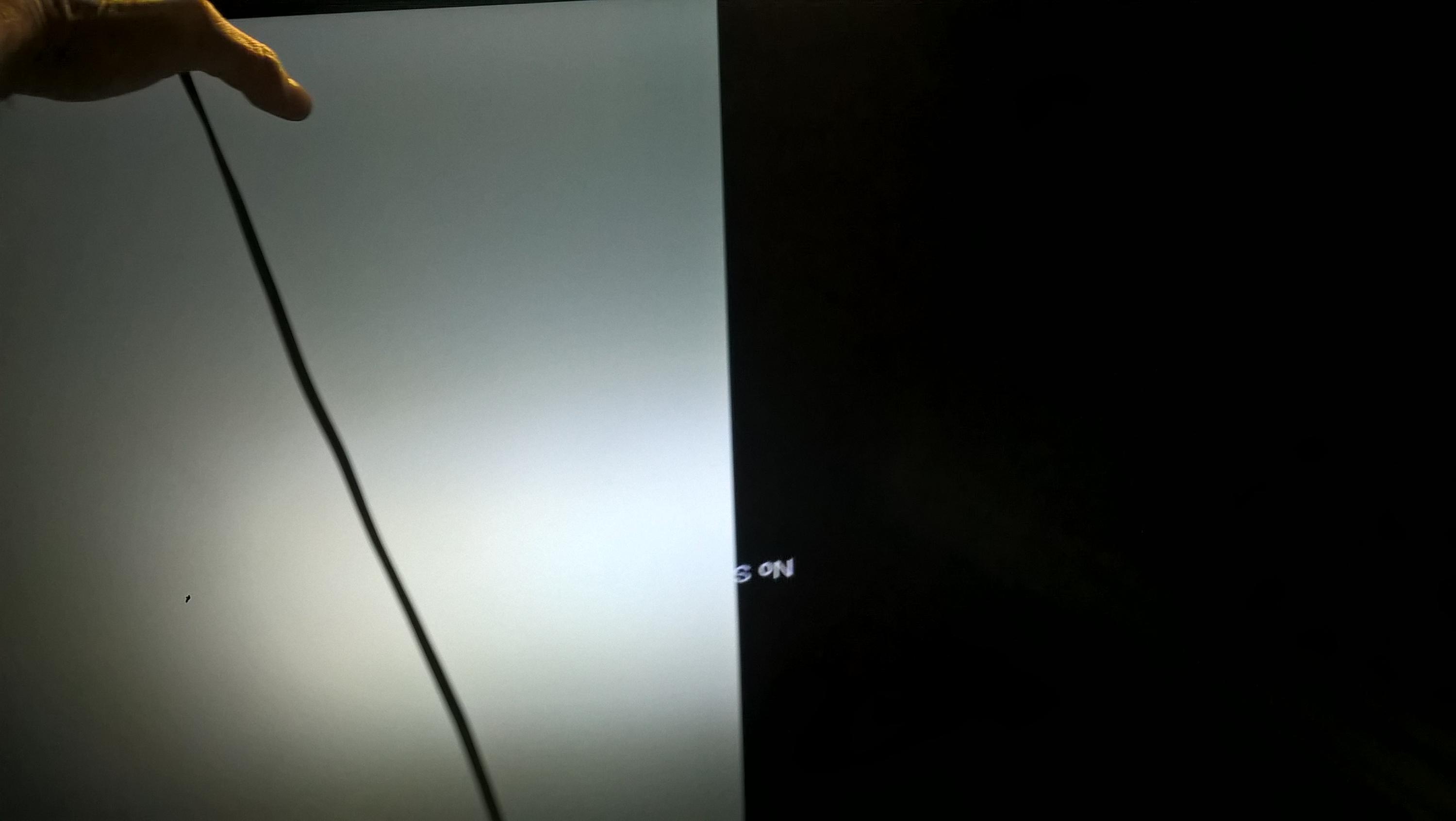

                  disconnect, one at a time, the tcon to panel cables (while power off)... there are four. What is the resulting picture (post a picture). This may tell you more. Still... with the "black blotches", it is very likely there is significant "driving" issues.
                  • nosugartonight
                    • 107
                    • united states
                    Re: vizio p602ui b3

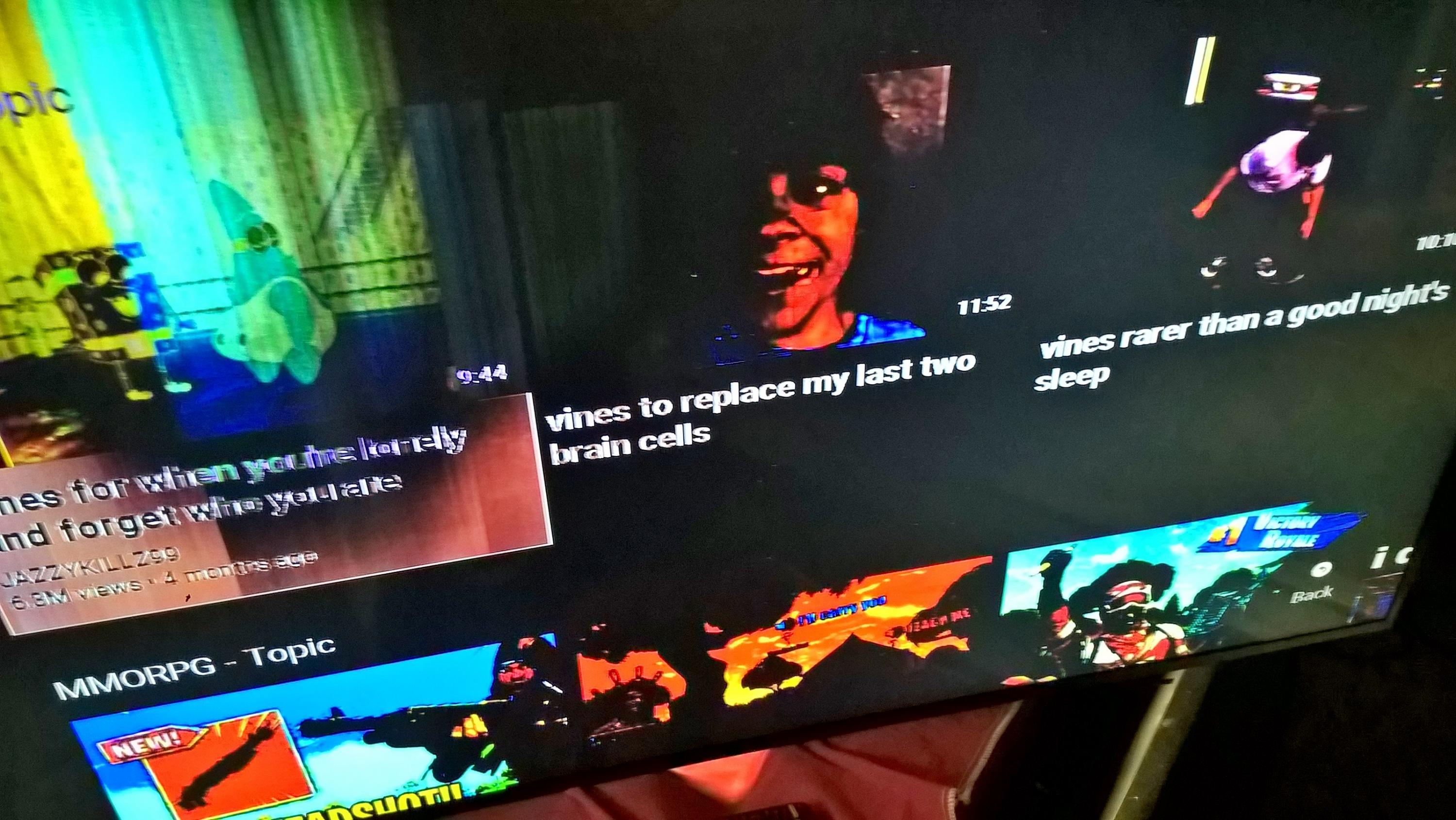

                    I will do that. I was actually thinking about that and decided to hook up video source. As of now I have to use RCA jacks. When I plugged in video jack I noticed the screen got a little brighter. When I plugged in audio I had sound. The picture was there but very bad. So I turned tv off to put back on base. Now it's black screen with no signal in middle.but fades in and out. Does this tell you anything.

                      Re: vizio p602ui b3
                      I suspect the main board.

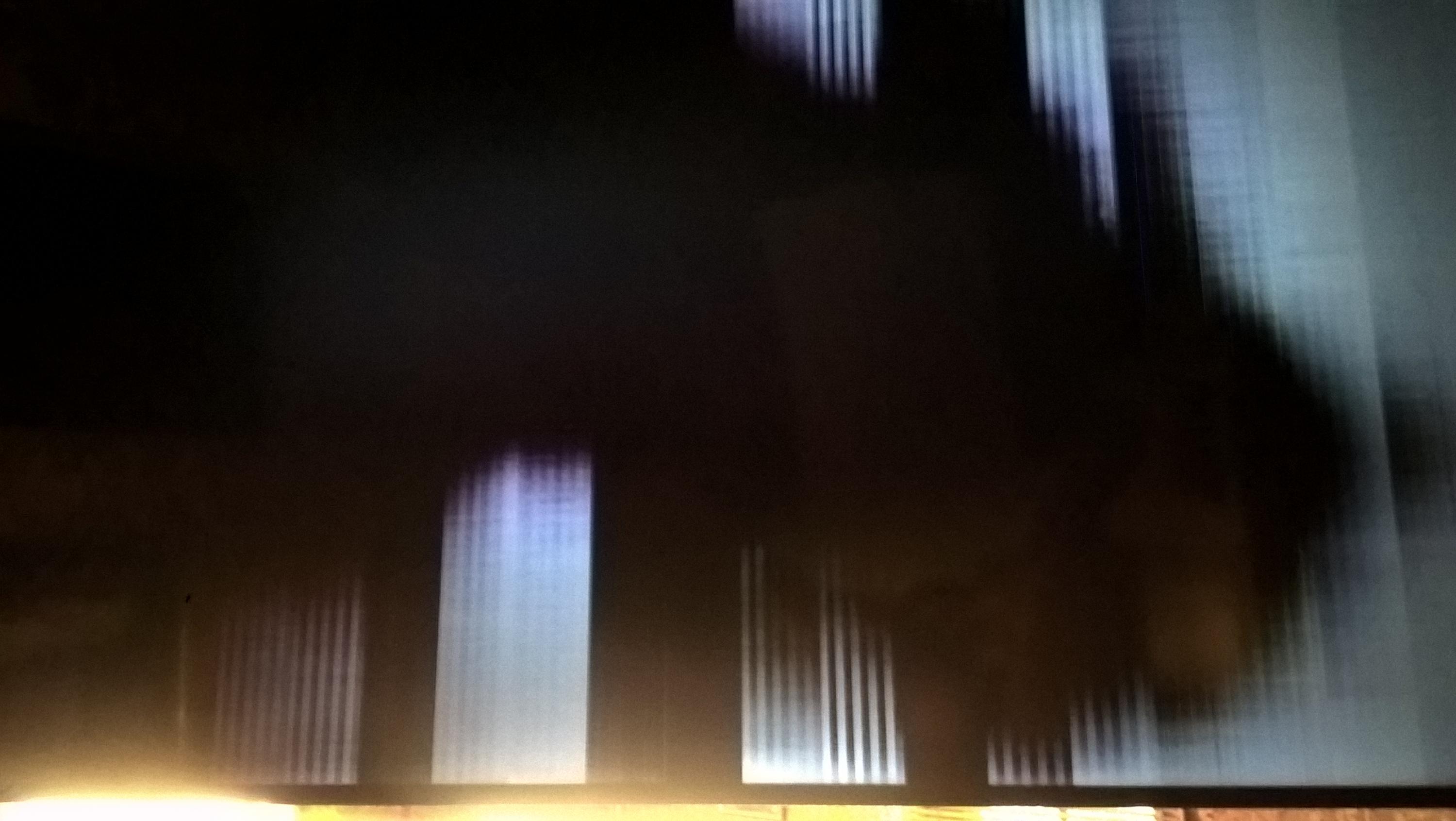

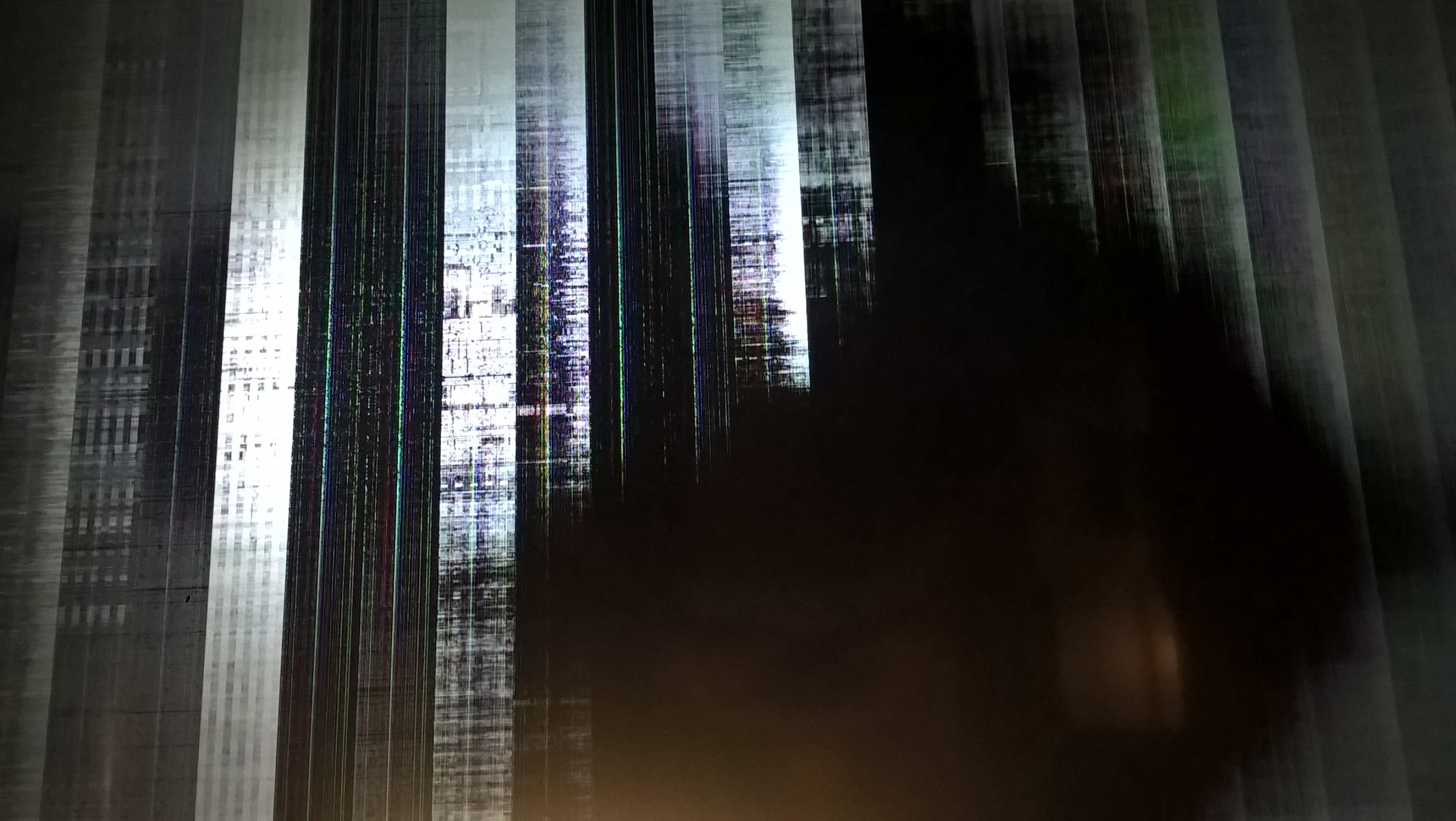

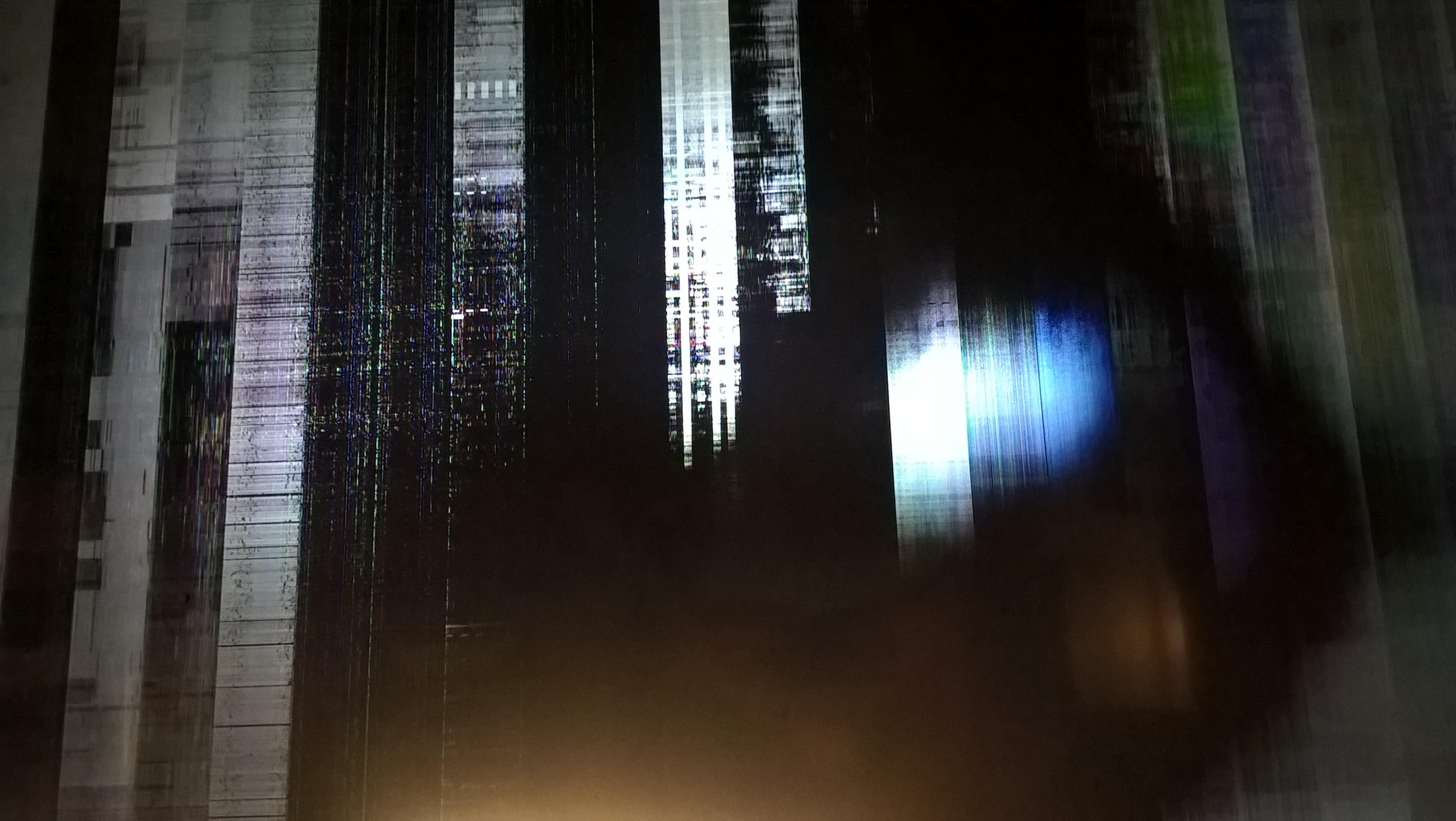

                        Here are the pics of removing ribbon cables one at a time. The pics were the same for each side so I just posted two. One for each side. SY about the bad pics.

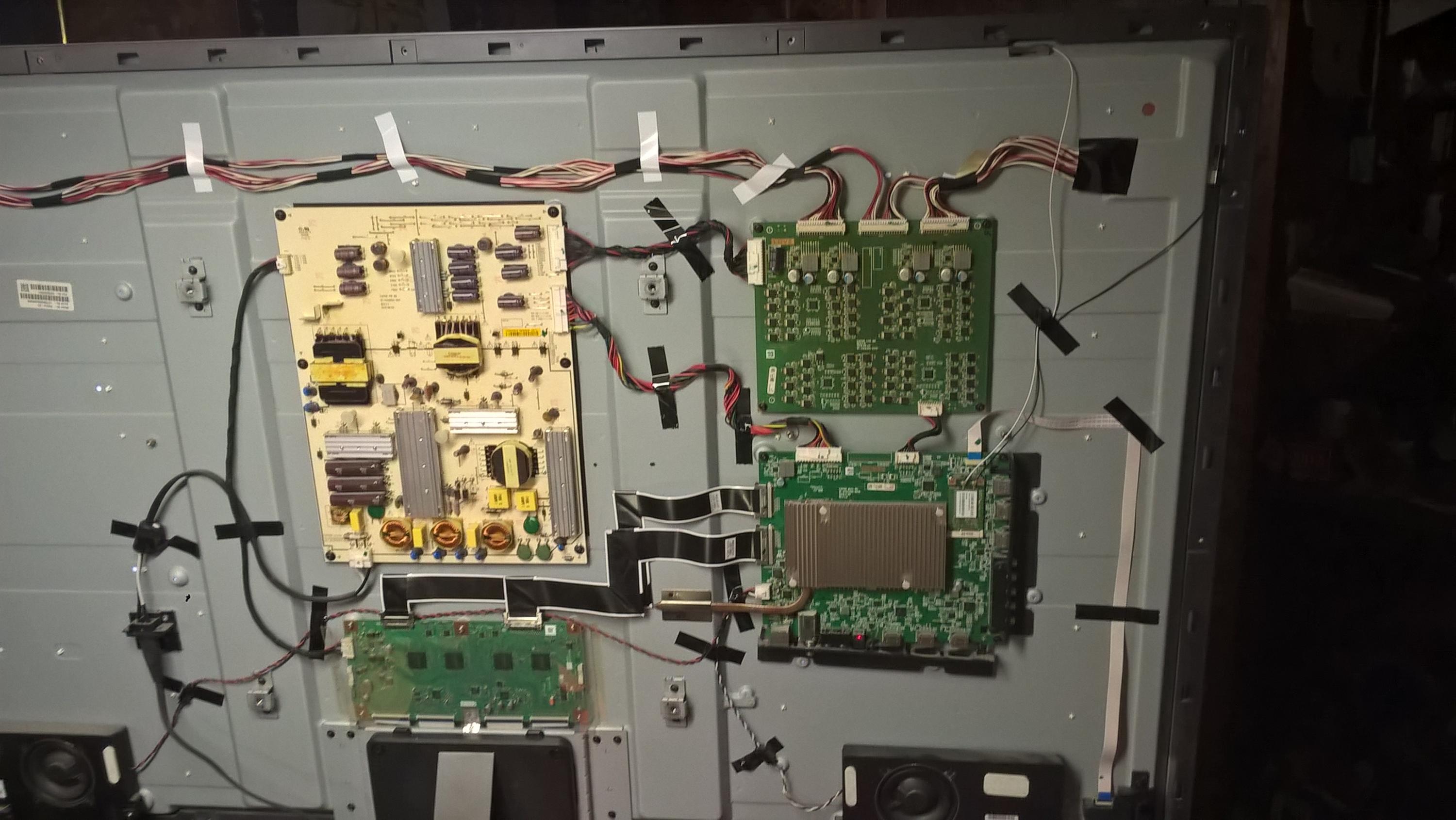

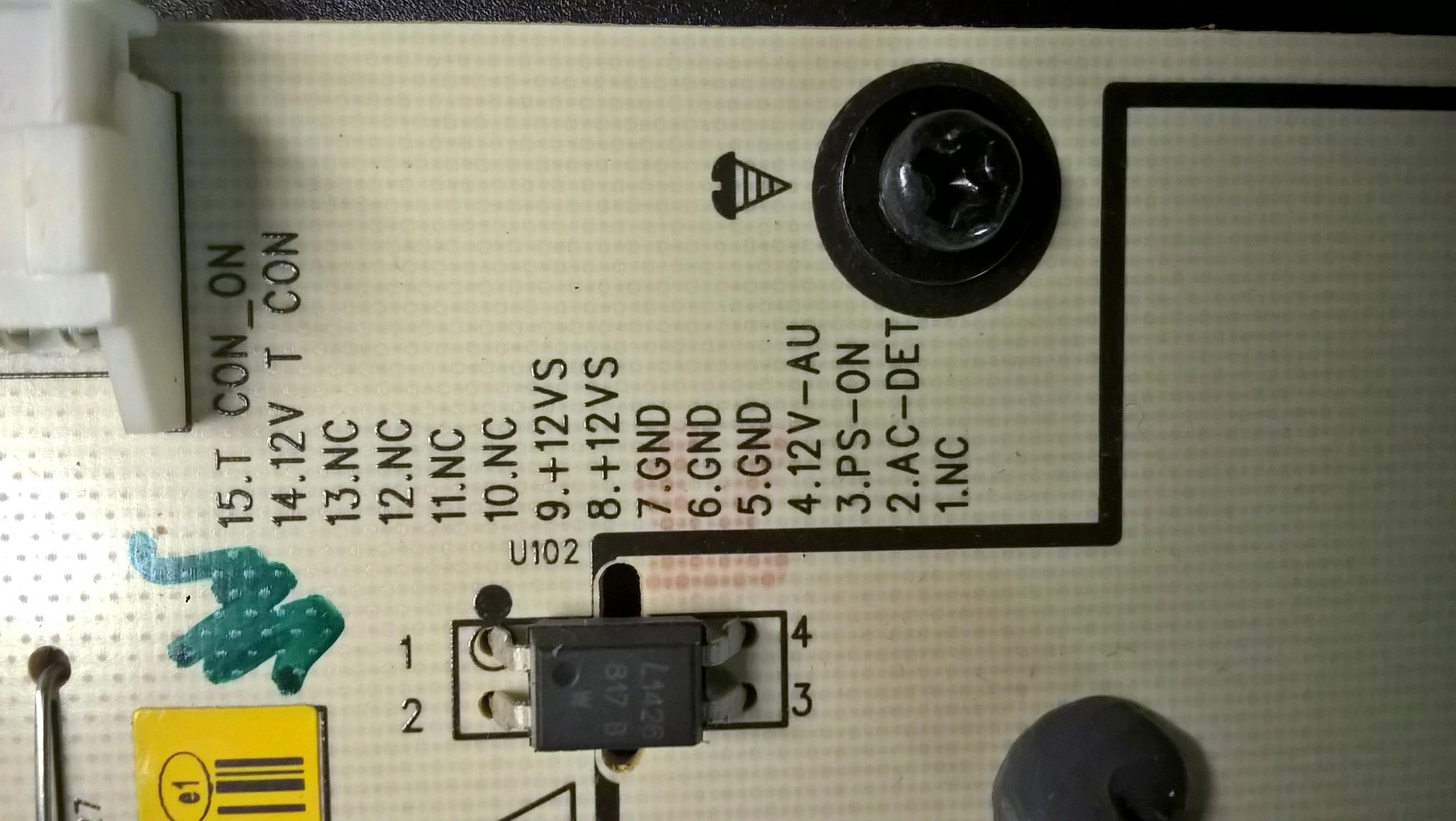

                          First pic. On pin 15 The plug from power board to main board. "T_CON_ON" I'm reading little over 3v. Do you know if that is right. In the next two pics of driver board. Is C359 a fuse or cap? Reads 12v on one side and 0 on the other. The last two pic is after I cleaned all the ribbon cables from T_CON to panel. I was able get wi-fi connected and loaded youtube. best picture so far. As you can see in menu pic. some is faded out also you cant tell which item is lit up to select. I think its the main board not sure.Thanks for any help

                            Re: vizio p602ui b3
                            I don't think the pictures are the "same". One shows the "no sig" text while the other shows nothing when it should be the "other half" of the text. My guess would be something with the panel on that side and NOT a main board problem.

                              Re: vizio p602ui b3
                              All right , thanks Don't guess ill look for main.

                                After reading several posts about tearing off the side driver tabs, I have to ask do you remove the tabs on both sides? With nothing to lose I thought I would try. If my panel is bad where is the best place to try and sell the boards.
                                • nomoresonys
                                  • Jan 2013
                                  • 12269
                                  • U.S.
                                  Re: vizio p602ui b3
                                  As advised in other threads, take it SLOWLY, the operation is not reversible, ONLY one side is removed, make sure of your problem, will not fix a mainboard or tcon or powerboard problem.
