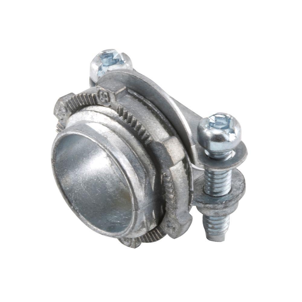

    I'm not sure if this is the correct sub-forum, but it is tv related, so I thought I should post here. If this is the wrong place, could a moderator please move this post to a more appropriate place?
    We need to run a new line from the pole to the house. Our cable provider is coming out Sunday to discuss how we're going to do this and what they will do, what I'll do.
    I have no issues getting up on their pole to hook up the cable, but I think they might.
    Anyway, this was the idea. I run 1/2 PVC schedule 40 (Cantex) conduit from where I want the entrance point at the house, underground, buried, 18", to the pole.
    This is where I'm struggling. I want the conduit to go up the pole. Regardless of whether they allow that or not, the conduit is going to have to come out of the ground sooner or later and the coax is gonna have to make it to the top of the pole. I need that end, where the coax comes out, water tight, so water cannot drip down into the conduit.
    Are there special ends that someone can point me to that are made for this? I couldn't find anything on google. I thought worse case, I could use something like the RACO Non-Metallic 1/2 in. Sheathed Cable Connector that Home Depot sells and just use some sort of water proofing caulk, but if there's an actual end that's threaded that I can just screw into the conduit, like I use when I run romex, but made for outdoor use and made for coax, that would prevent water from coming into the conduit, I'd rather go that route.
    Here's a picture of the ends I use for the romex:

          So, assuming Spectrum / Time Warner are still okay with the underground, I still need to find a way to seal the PVC that will be by the pole or on the pole.
          Rain is a more easier fix. I could go straight up, use a 90 degree elbow, go out a little, and then another 90 degree elbow, so where the cable comes out is facing towards the ground.
          But insects is something I'd like to avoid. I don't really want to use some sort of sealant because these cables seem to expand and contract because of the weather, hence the little loops they have on the house, and where it taps into the cable line on the pole.
          I had two ideas that I thought might work. One was trying to find a top that had something like a rubber seal covering almost the entire top (except the outer perimeter, which would be PVC), and then there'd be just a small hole to push the coax through. I'm not sure a product like this exists though. I've been looking and not finding anything.
          The other idea I had was to just take a cap that completely caps off the PVC, and drill a small hole through it, where I could push the coax through, but not too easy like. It could still expand and contract, and if I use the 90 degree elbow ideas, rain wouldn't be an issue.
          Do any of you people have any other ideas or know if there's such a product like the first one I suggested?
          Thanks!

            you need to bend the conduit (either with heat or otherwise) in a "U" so that it is pointing down (assuming its running up the pole base some distance). Then, the "incoming cable" will go down past the "U" and up again. This forms a "drip loop" so to speak to prevent water that is coming down the incoming cable from following it into the conduit and further protects the conduit from water directly going down into the conduit.

              a: I'd run conduit too
              b: I'd be doing that what budwich said

                I was just going to use elbows to make that U shape. I'm thinking the same for the water, but I still want to keep insects out. If I seal it completely, I think that will be bad, because it needs to contract and expand (the coax).
