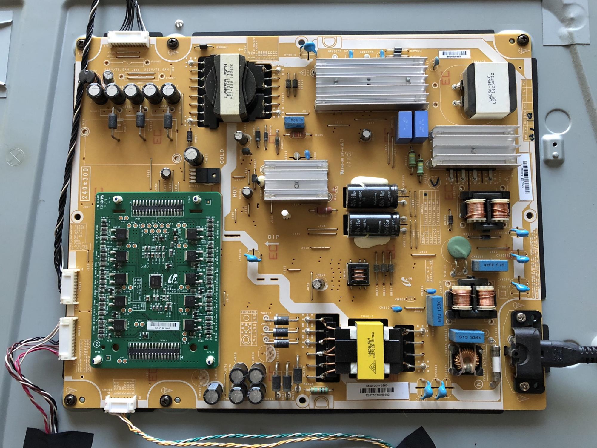

              I have this same issue. On the led driver board there are test points for each led strip.
              LED 10 measures 0v
              LED 6 - 9.2v
              LED 5 - 9.2v
              All other strings have 12.5v sometimes measured 14v
              45v at the Vout test pins
              So I’m guessing the LED 10 strip has failed completely? But I’m wondering why 5 and 6 have lower voltages compared to the others. Separate issues on their way out?

                You have ten LED strings so it has 10 MOSFET'S on the LED driver board for the Cathode return for each LED string, the Cathode of each LED string is connected to the Drain pin of each MOSFET so if the string has open circuit then you will not have Voltage on the drain pin.
                Looking at your cutoff picture I cannot read or tell what the pin names are, too small for my eyes to see.

                  Re: Vizio E55-D0 Picture Flashes
                  So each string is being independently driven as oppose to having one huge voltage put through all strings tied in series like other TVs?
                  What's the 45v out then? There's 4 pins total labeled Vout, 2 pins on 2 connectors where the led strings are split up
                    The 45V is for feeding the Anode of each LED string , the Cathode return of each string is connected to the PWM controlled MOSFET DARIN for maintaining the constant current through each LED string, the source is connected to the current sensing resistor, the other end of the resistor is connected to circuit GND.
                      Your TV has local dimming backlights that adjust itself based on video content.
                      Ah ok. Didn't know it had local dimming. Looking at it for a friend. Is that why the backlights flash when powered on because one string is open?
                      Are the other two strings measuring lower voltage due to dimming or an imminent failure of the strings? Btw no source connected to the tv so just a “no signal” when on
                        The string that has open circuit will show 0V on the Drain pin of he MOSFET on that LED driver board, so how may of them show 0 V on the Drain pin?
                        The protection circuit probably kicks in die to no current flow detected.

                          Only the LED 10 shows 0v. Led 5 and 6 show 9v and the rest are 12v. The led driver board has two test points for each led string labeled.
                            If that is the case then it looks like it has open circuit.

                              Would that one open circuit cause low voltage on the other two led strings?
                                You have 10 separate control circuits for 10 LED string.
                                The lower the Voltage on the return pin the more current through the LED string that is because the on time of the MOSFET will on longer so the Vdrops between Source and Drain will be less.
                                You can find out if LED 10 string has open circuit or not by swapping LED 10 return wire with other LED return wire and see if the 0V reading will follow or not, or you can have just one LED string connected one a t time and see if each one of them will come on or not, or you can use power supply (set current limit to about 50mA ~ 100mA) that ha high enough Voltage to drive the LED string and test each string.
