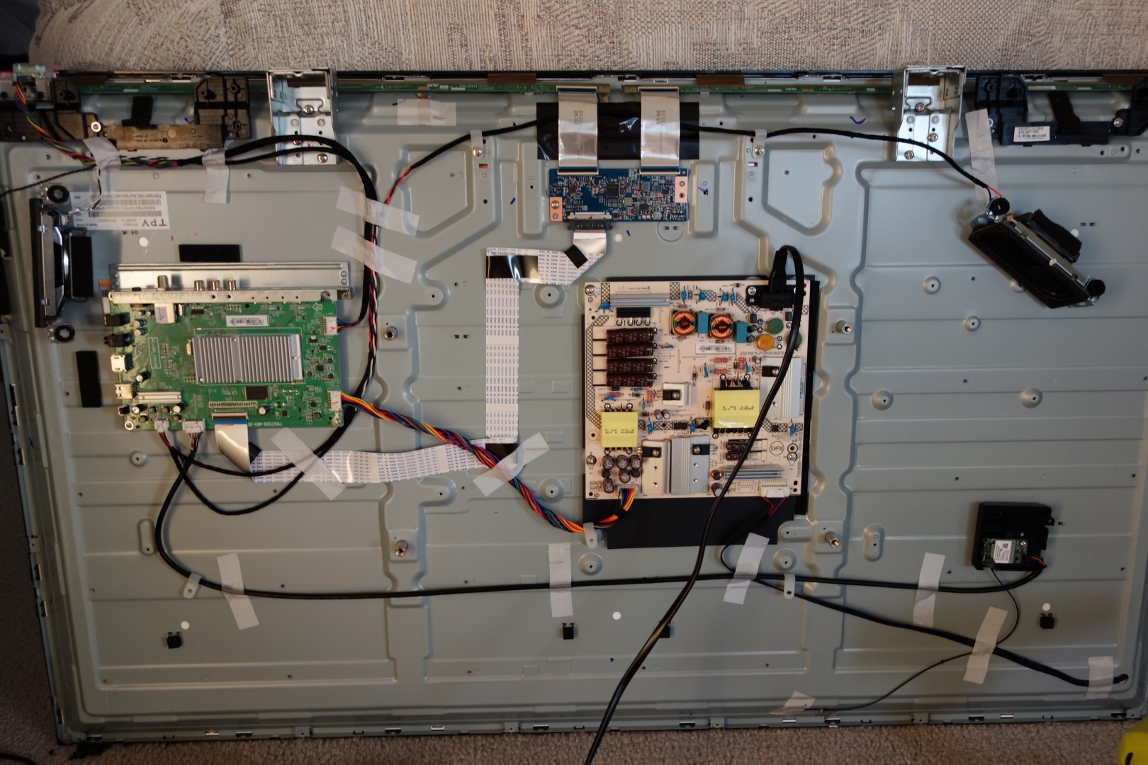

    Sharp LC-50LB481 Two fast blinks Backlight Turns Off No Picture
    This TV is model LC-50LB481C. Think C suffix is for Canadian version. U suffix for US so LC-50LB481U.
    It is branded Best Buy Recycles (Best Buy repaired and resold??). It is missing 2 ground screws on the PS board, 1 ground screw on the main board and both the tcon shield and screws. I borrowed some screws from the cable clips to ensure it was grounded.
    When first plugged in, backlights come on for a few seconds, a quick bright backlight flash and then goes out. No picture.
    When power button is pressed, TV attempts to boot, front led slow blinks, millisecond quick backlight flash and front led goes out.
    When power button pressed second time, hear a click and front led has fast 2 blink code.
    PS connector
    ON/OFF 3.9V
    +12-A 0V
    +12V 12.1V
    +5V 0V (problem? or unused)
    DIM 3.0V when backlights are on, 3.6V/3.9V when not on
    PS_ON 3.4V
    main filter caps = 159V
    LED strips test good with tester - voltage 62V, 63V
    3 red/black pairs going to LED strips, 2 of the pairs are wired in parallel
    Backlights off 48.7V, 48.8V
    Backlights on 56V, 56V
    Anyone have service manual for 2 blink code? Power supply??

          Re: Sharp LC-50LB481 Two fast blinks Backlight Turns Off No Picture
          There is no picture when the backlights are on. TV attempts to turn on but fails, backlight is on for a few seconds before turning off. Measure 12V on both sides of tcon main fuse.
          ON/OFF - 3.5V after plug in, drops to 2.9V after power is pressed and settles to 3.9V
          +12V - always at 12.1V
          +5V - always 0
          +12-A - always 0
          DIM - 3.4V after plug in, 2.4V when backlight is on, 3.7V after
          PSON - 0V after plugin, 3.3V after power pressed
          Front LED is on after plugging in. Slow blinks after power is pressed. Backlights come on for a few seconds. A few more seconds and backlight has short bright flash. Slow blink stops after a few more seconds.
          You would think +5V would supply main board but I am getting PS_ON signal and standby LED.

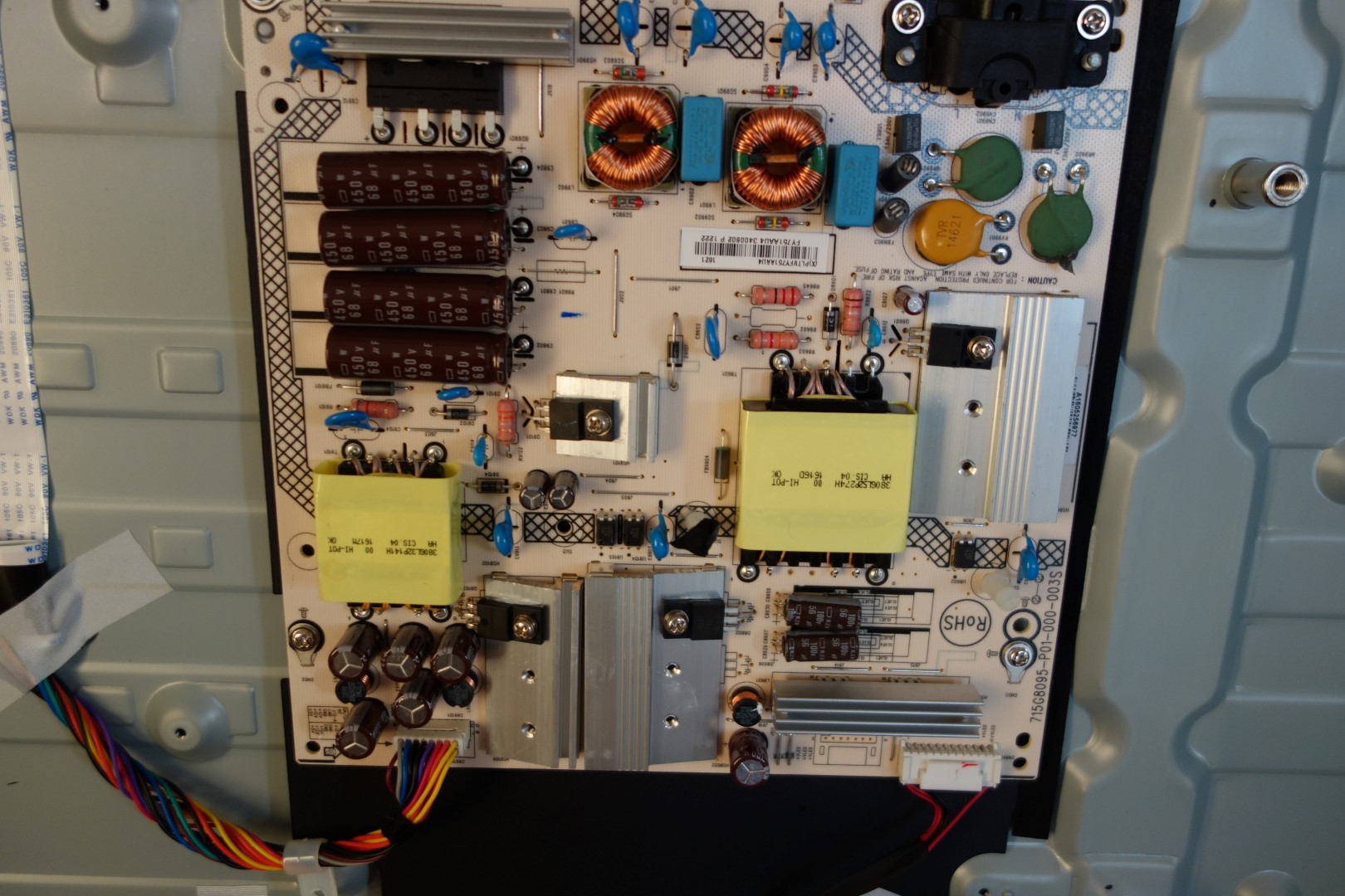

                      Little more focused pic. of ps here: seems strange there's no 5v, maybe test powerboard by itself, see if your voltages are there. http://www.shopjimmy.com/sharp-pltvf...c-50lb481u.htm
                          +12V and +12VA are fed by the same 12V synchronous rectification supply, if you look at the bottom side of the board you will see that L9101 and L9102 are tied together on on end, so it is probaly measurement error.

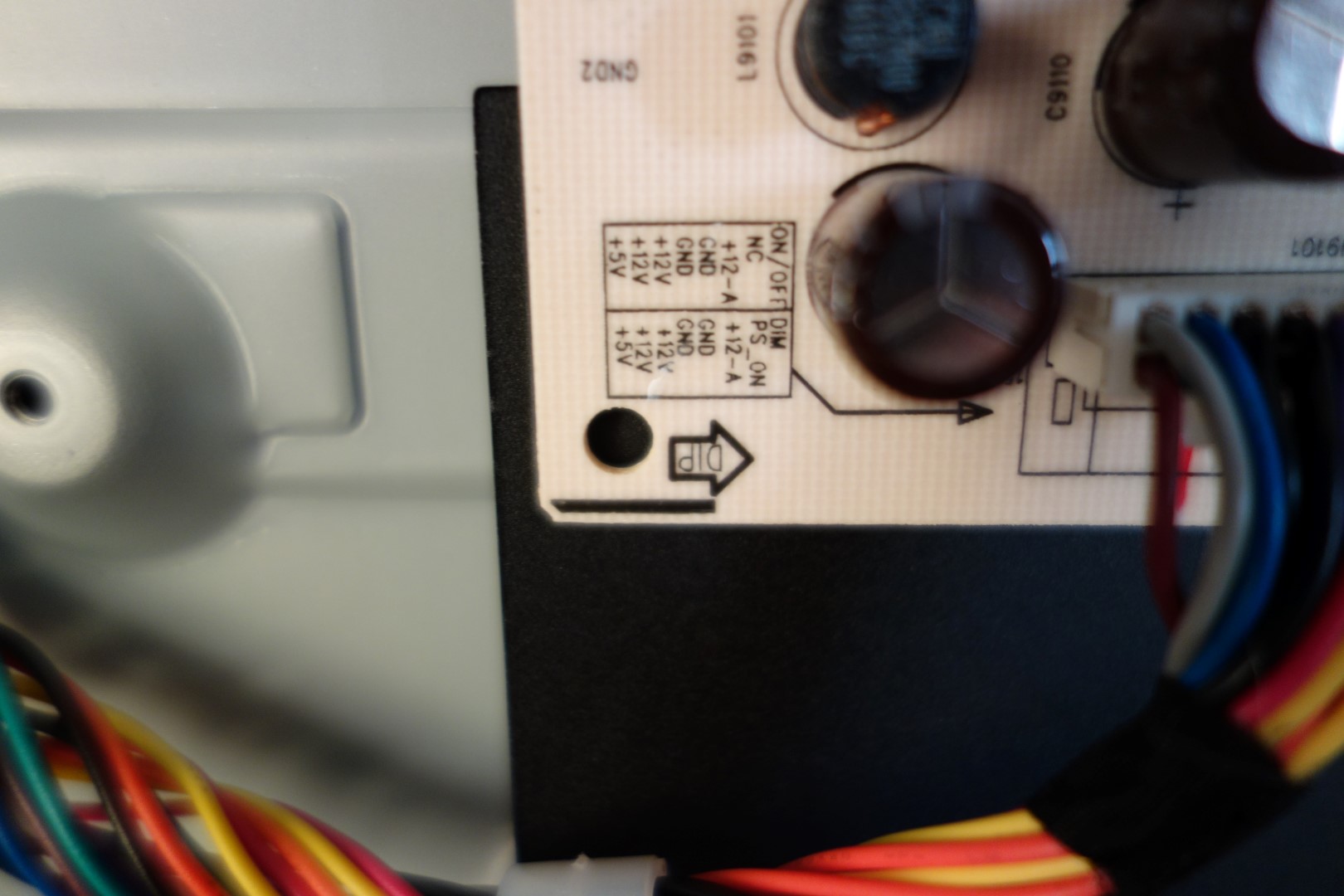

                          The +5V pins are connected to the empty pad that is why there is no 5V. This TV uses 12V STBY.
                          http://assets.shopjimmy.com/media/ca...au4-bottom.jpg
                          • neilc6
                            • Nov 2015
                            • 1550
                            The top silkscreen doesn't match the bottom silkscreen. The bottom one is correct since I measure 12V on 12-A.
                            http://assets.shopjimmy.com/media/ca...51aau4-top.jpg
                            Top silkscreen
                            On/Off DIM
                            NC PS_ON
                            +12-A +12-A
                            GND GND
                            GND GND
                            +12V +12V
                            +12V +12V
                            +5V +5V
                            Bottom Silkscreen
                            On/Off DIM
                            NC PS_ON
                            GND GND
                            GND GND
                            +12-A +12-A
                            +12V +12V
                            +12V +12V
                            +5V +5V

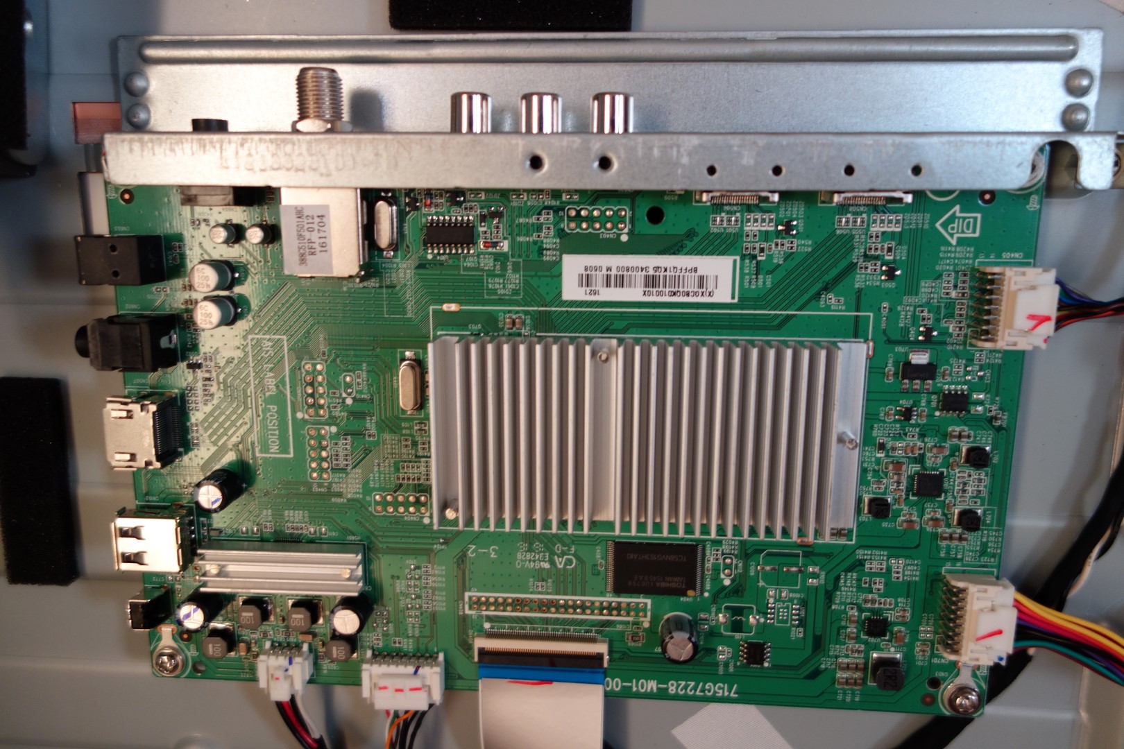

                            Main board and tcon are now suspect as well. Disconnected LVDS and still same behaviour.
