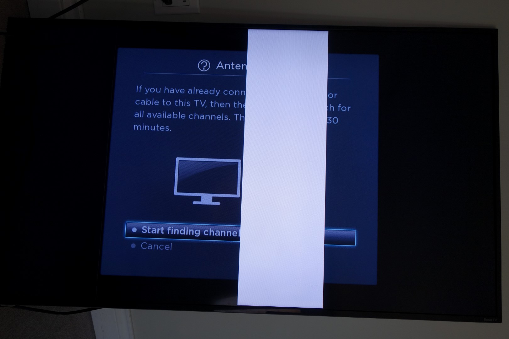

    Thinking this TV is a lemon. Found another cracked screen one on CL (Best Buy Recycles also) and it had backlights but no picture. These TVs were repaired and resold with incorrect and missing parts. The side plate for the connectors and front nameplate are also missing on mine. More concerned about the missing tcon shield which acts as a heatsink.
    The 12-A signal is present so not sure the new PS will fix it. TV has multiple problems.

        Got the replacement power supply board in and it's better. No quick backlight flash and backlights stay on during power on sequence. Still no picture though. Guess the tcon is next but think I may be replacing the main board as well.
        TV turns on with backlight and will turn off and give me shutdown chime. Just no picture. Fuse on tcon is good and I measure 12V on both sides of it.

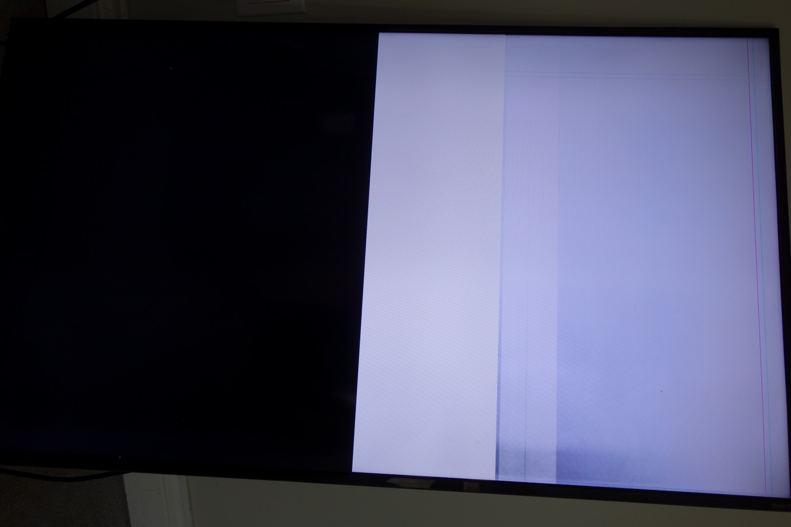

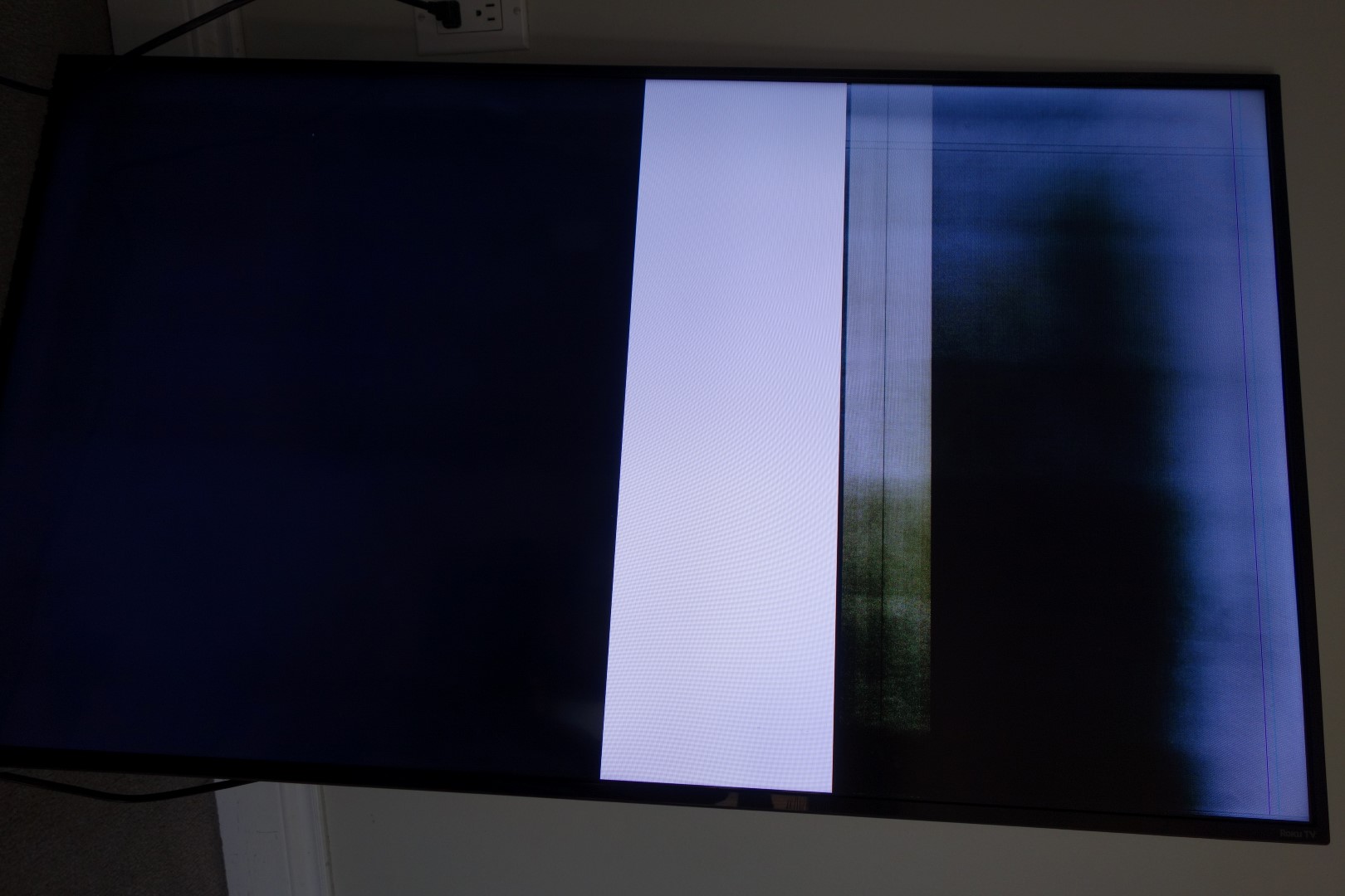

          Got a replacement TCON in and finally have a picture but there is a vertical line on the left side and wide white vertical band on the right. Disconnecting the left tcon cable results in a good left side but disconnecting right side cable gets nothing. Confirm this is a bad panel?
            Re: Sharp LC-50LB481 Two fast blinks Backlight Turns Off No Picture
            Panel problem.

              I am so sorry. After all that to get a 'bad Panel'. I would have never guessed, but we did learn a few things along the way.
