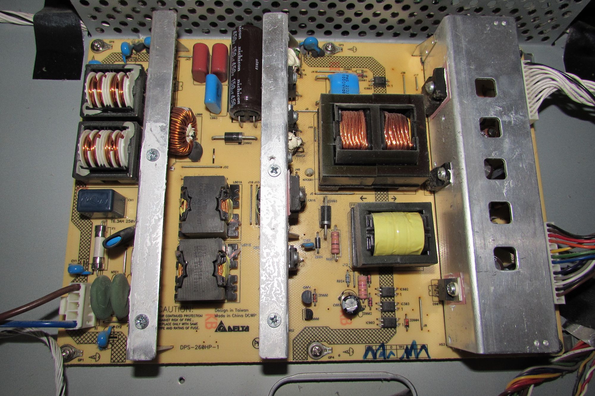

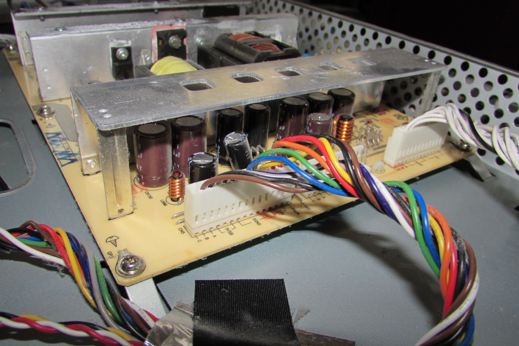

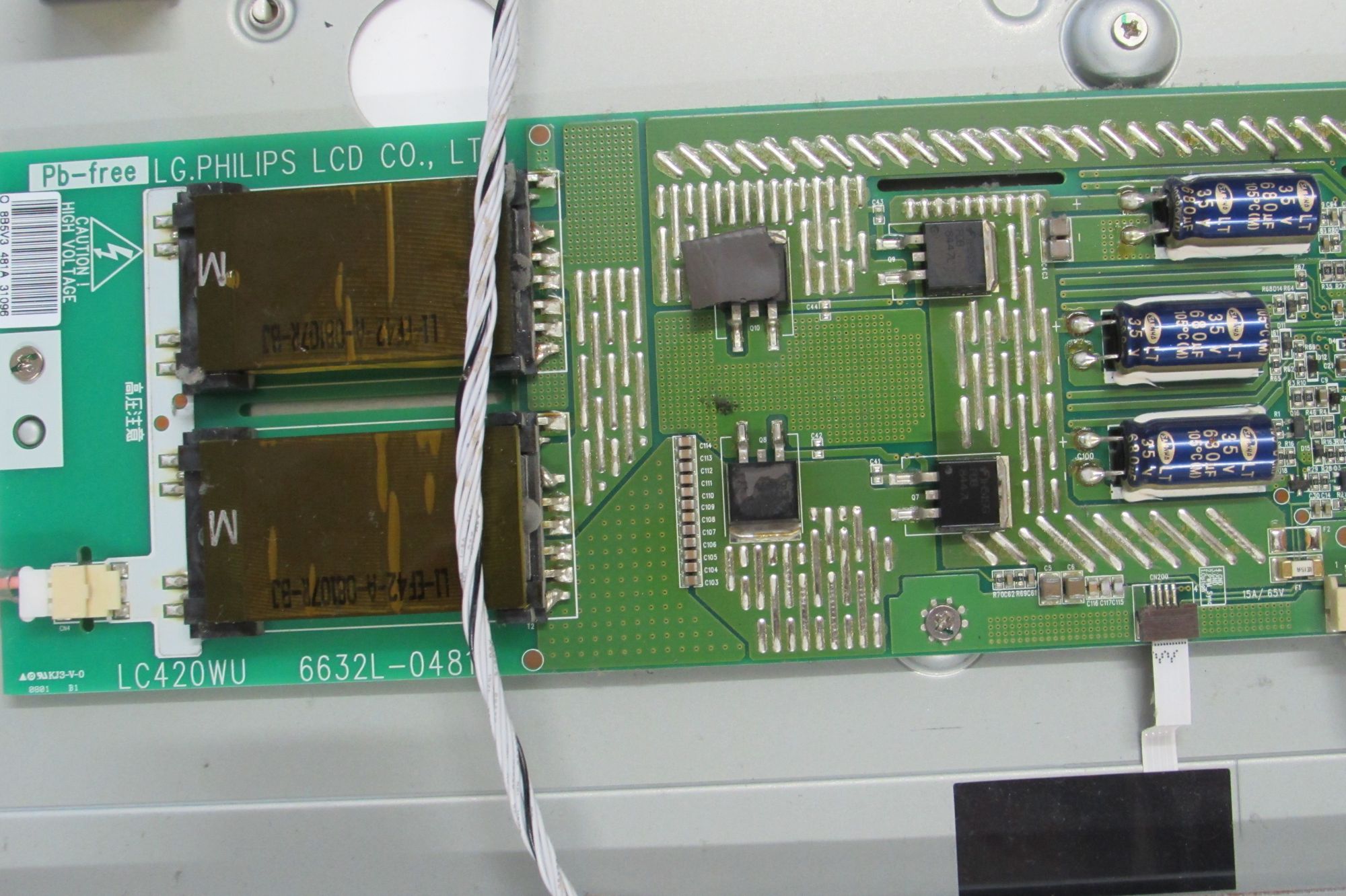

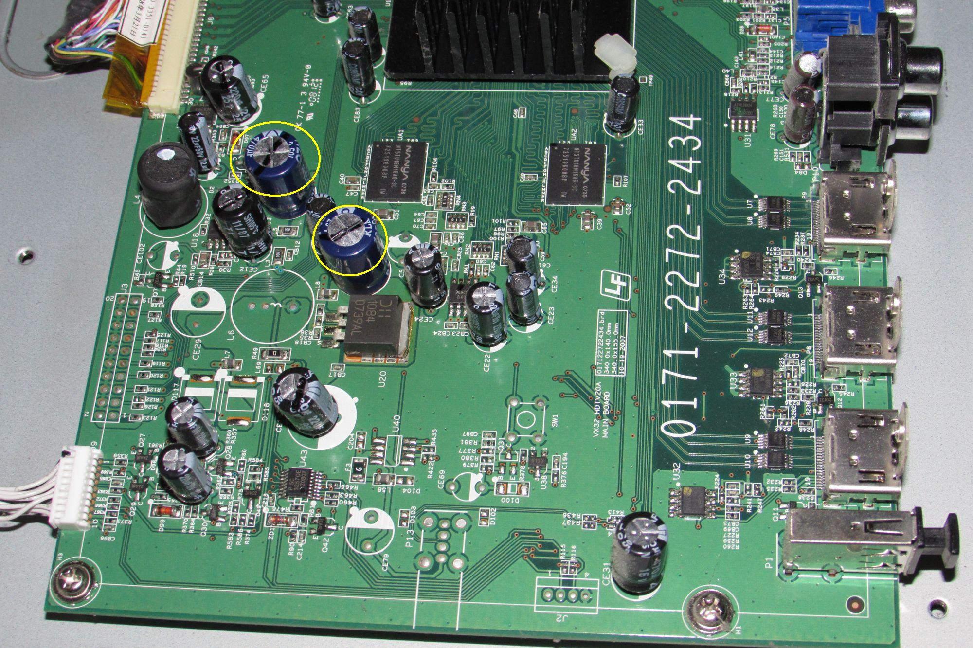

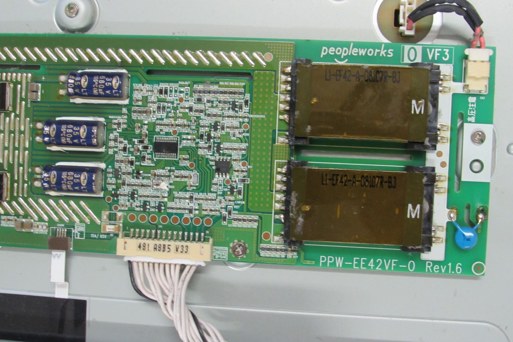

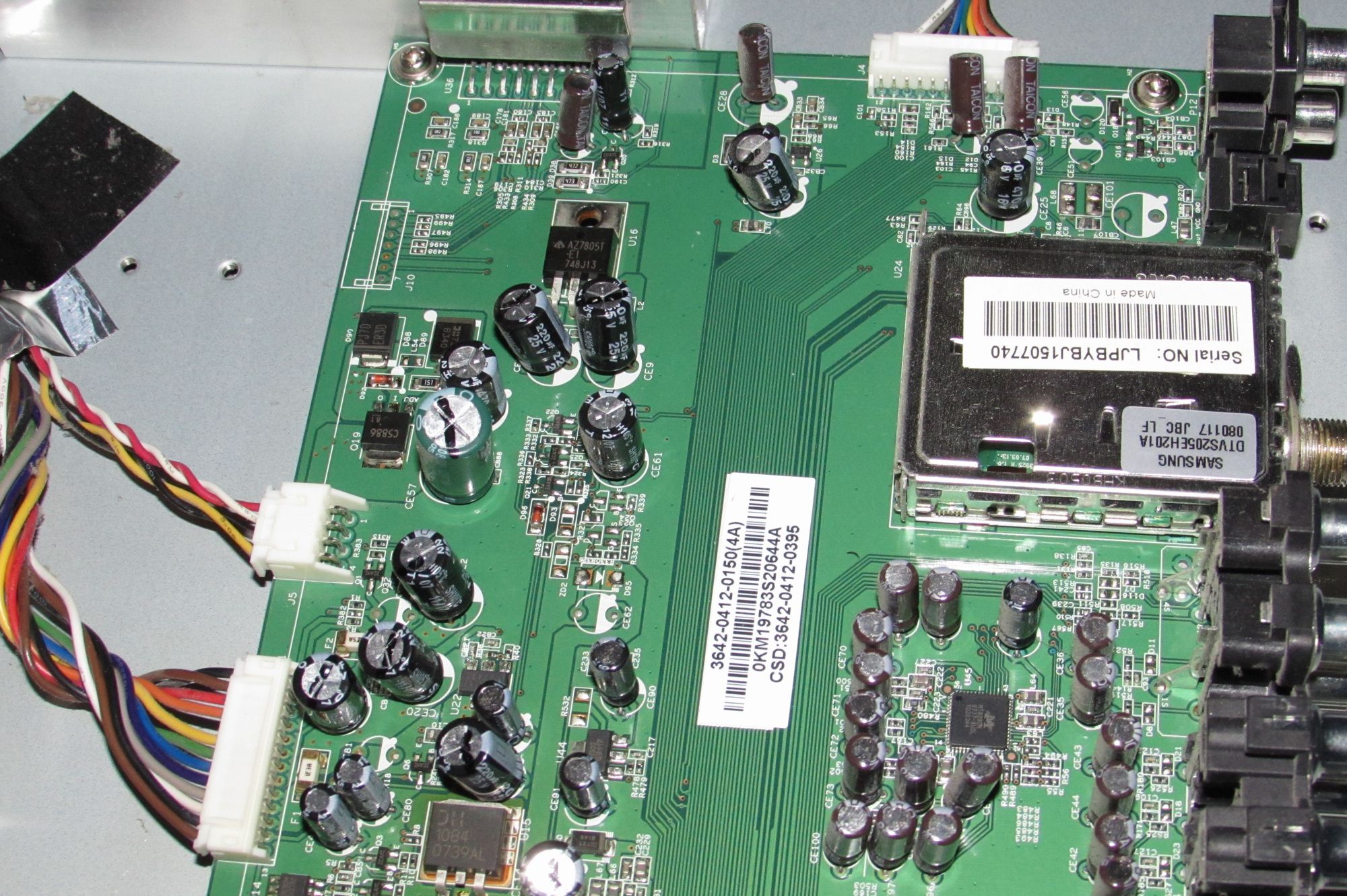

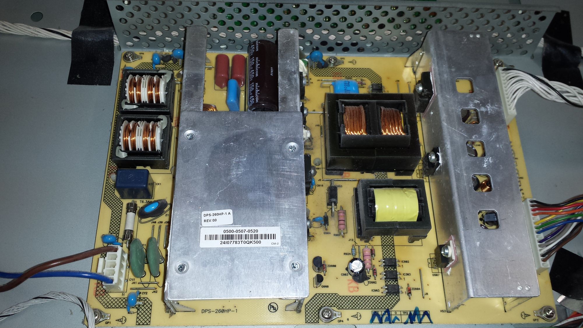

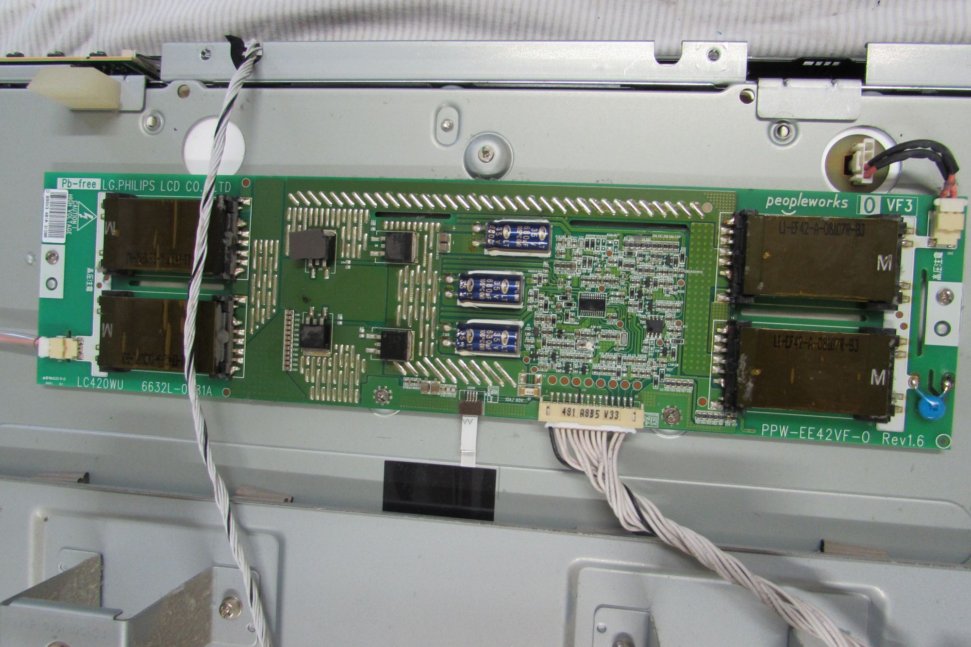

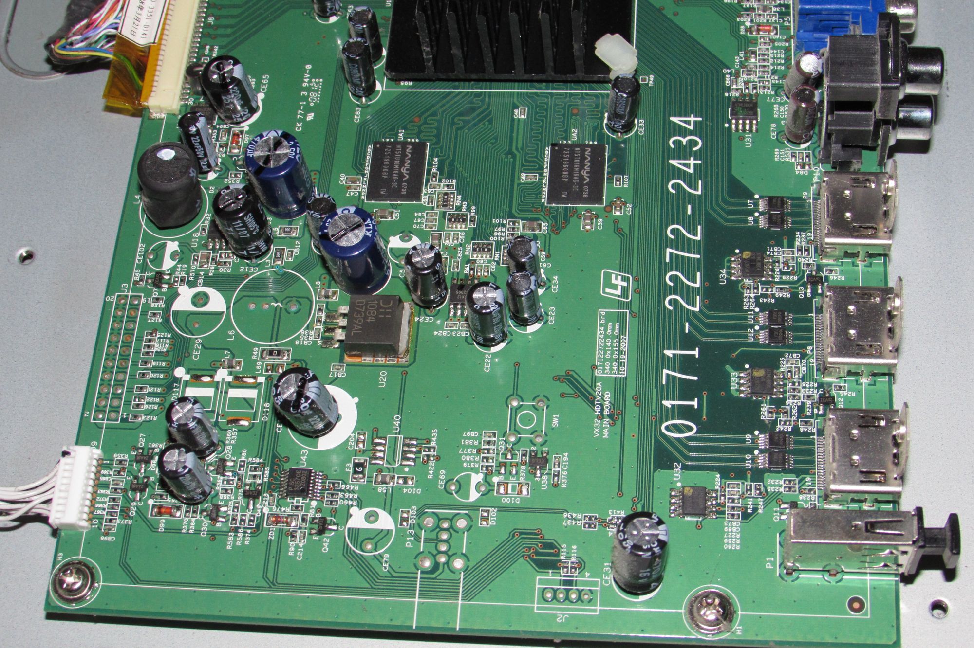

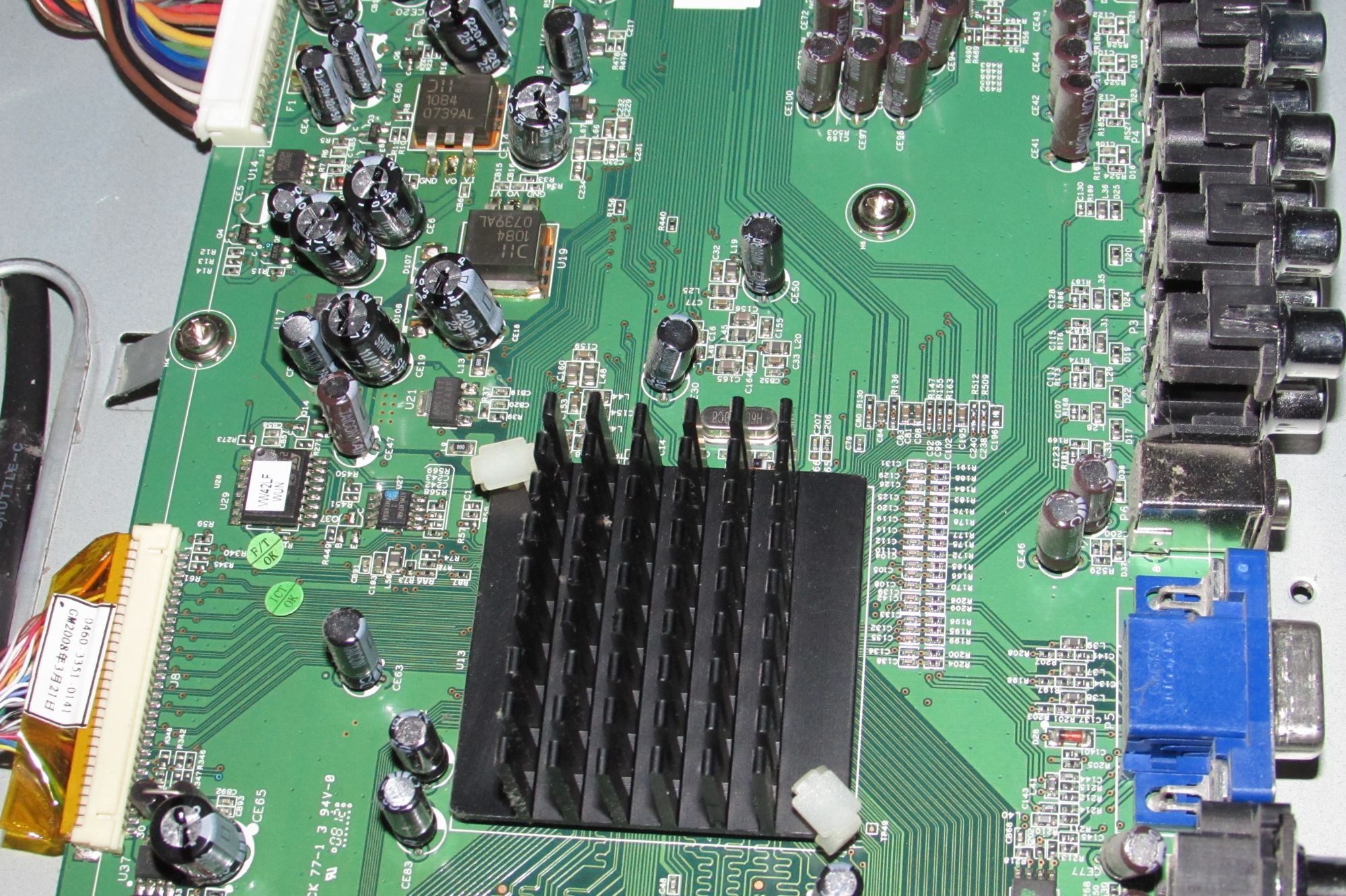

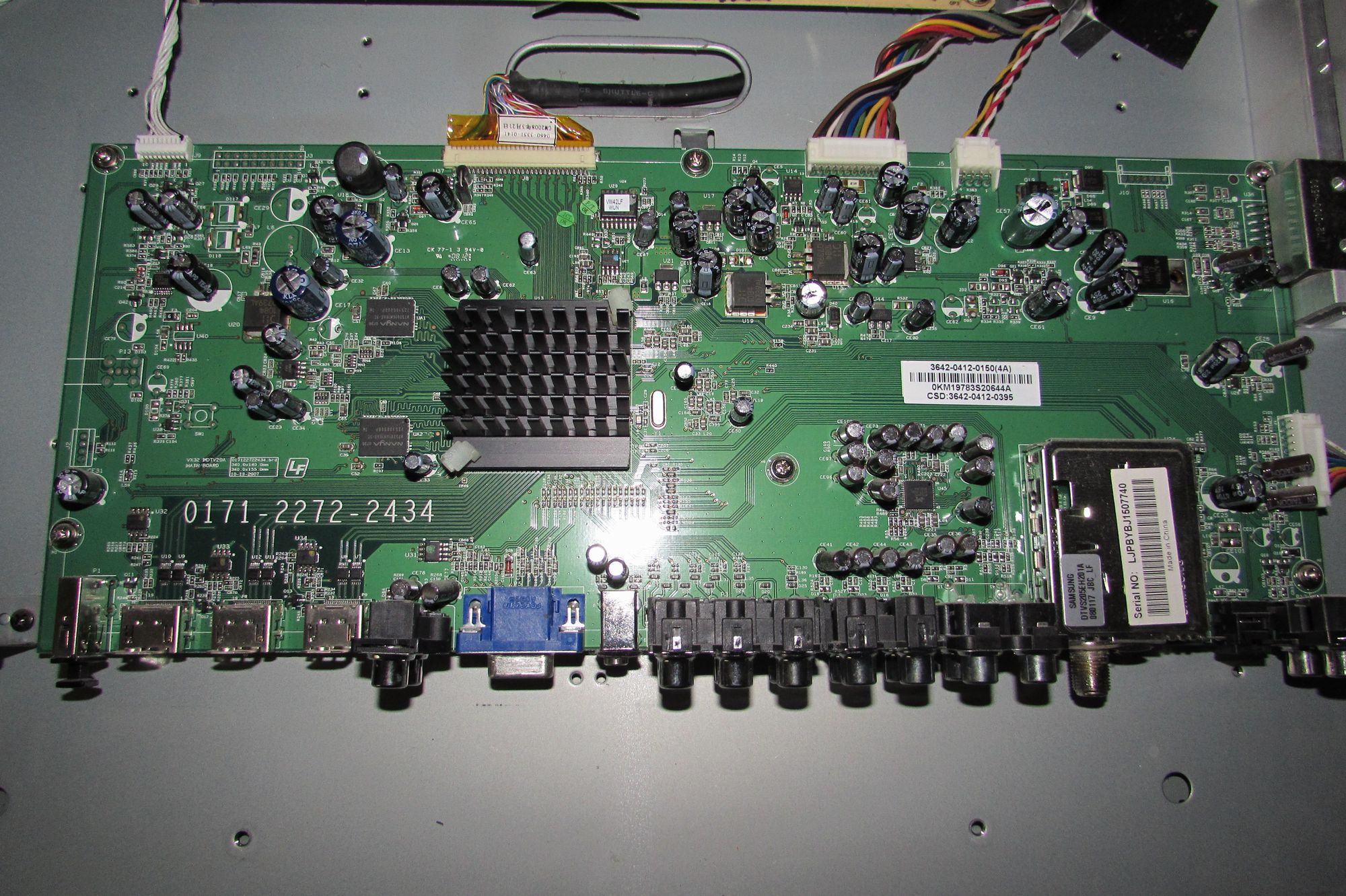

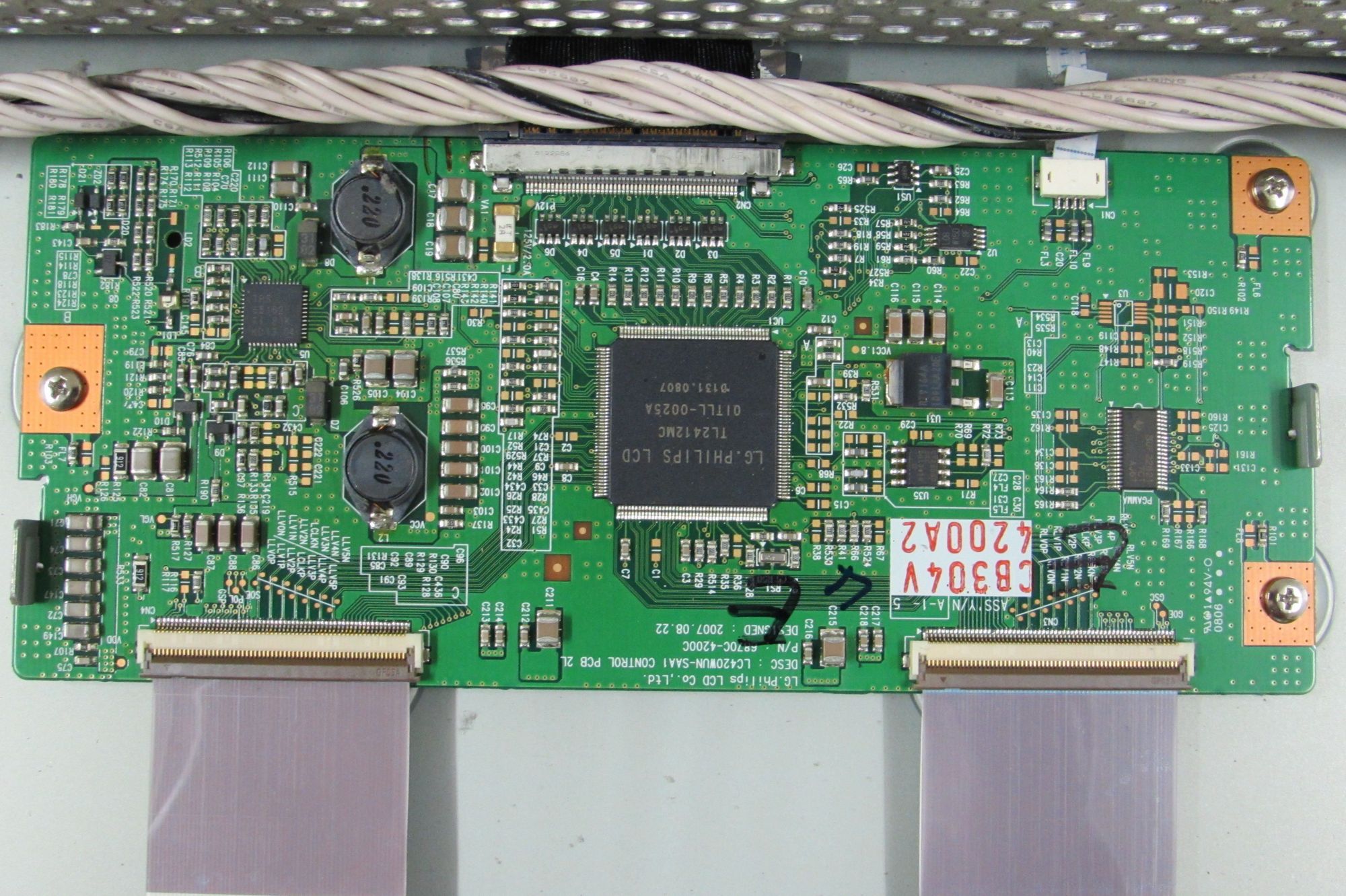

    I have attached pictures of the 4 boards.

                Try replacing CE13 & CE17, 470uf 25 volt on main board
                  Re: Vizio VW42L FHDTV10A will not turn on without unplugging and plugging TV back in
                  Good eyes! it looks like one of them has slightly bulging top.

                    Thank you R_J. I will replace those before I replace the EEPROM to see if that takes care of things. Wow, such a slight bulge on CE17 I never even noticed it. I tested both with my ohm meter and they did not respond. I will reply when I get them changed out.
                      I replaced both CE13 and CE17 caps with 470uf 35v caps from my local Radio Shack. Thank you for spotting the tiny bulge in the one cap and knowing that the problem could lie in the two that you directed me to, R_J.
                      The TV fired right up and seems to be working fine. I haven't hooked up a video source yet, but I can switch to all inputs with the remote and it shows up on screen.

                          Wouldn't be surprised if you have one or more bad caps on your powerboard still.

                              The power board and the main board are two different boards.
                              Change out all the caps on the main board? Do you have any idea how many there are on the main board?

                                BTW, I noticed that some of the those caps have black marking on the top. Did you do that or someone else worked on the set before you?
                                Did you try heating up the main board with hair dryer for a few minutes to see if the TV will come on normally?
                                Did you check the DC Voltage of the power supply outputs and the Voltages of the regulator ICs again when it is not working?

                                  Looks like about `15 or 16. This is where a meter that can check capacitance is handy, otherwise it's a guessing game as to their operability.

                                    The main board, which I have pictured below, has a total of approx. 72 caps. on it.
                                    The power board, in pictures two and three, has quite a few less than the main.

                                      budm, No, I didn't put the marks on there. I bought this TV brand new, so it must've been done at the factory.
                                      I heated the main board up and the TV turned on and stayed on without any vertical lines. The only thing is now there is no sound at all. The vertical lines and the sound are related I'm sure.
                                      I tested the output voltages and the regulators while nothing was working, except for the logo and the back light. Everything tested the same as stated in my findings from my original post except that it now has the 5.01v at pin B and 3.35v at pin A. I did notice that when I got the TV running the voltage at pin A varied quite a bit while a video was being played, 1.75v - 3.25v.

                                        ce23 ce50 dont look good from here .. if they turn out bad change all same values on that board .
