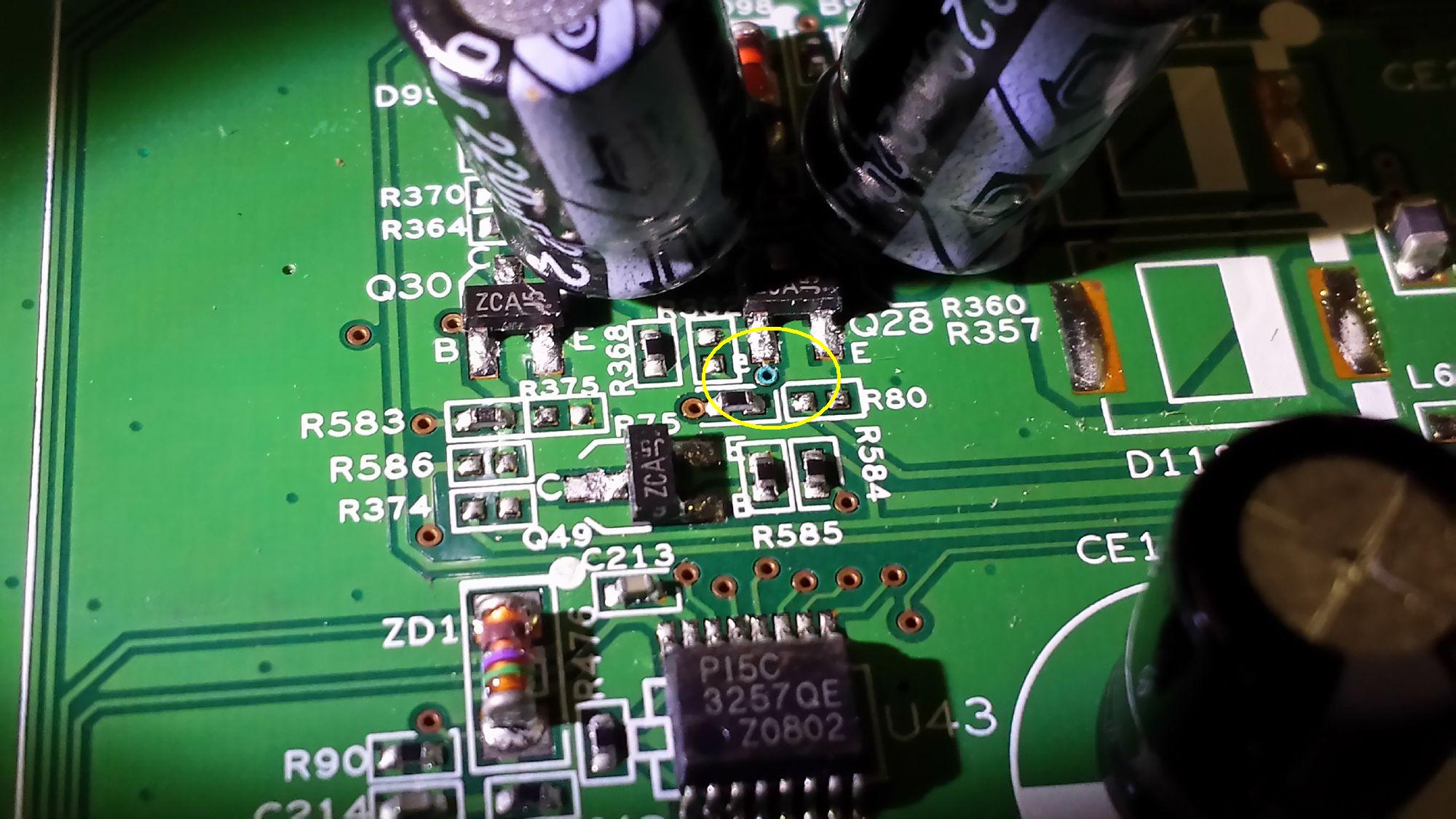

    A scope would be better, Try heating just one transistor at a time using the tip of your soldering iron, just place it on for a second or two is all that should be needed, then try it on the ic.
    Using a heat gun heats too wide an area to pinpoint the problem,
    It could even be a bad feedthru connecting the two sides of the board. Like this one... It looks corroded, green, it should be copper colored like the others. it may have corroded the connection to the other side of the board, but when heated the copper expands and makes connection.
      Thanks R_J. I found a total of 4 feedthru holes that were corroded. I cleaned them up as best as I could and they all tested good for continuity from one side to the other.

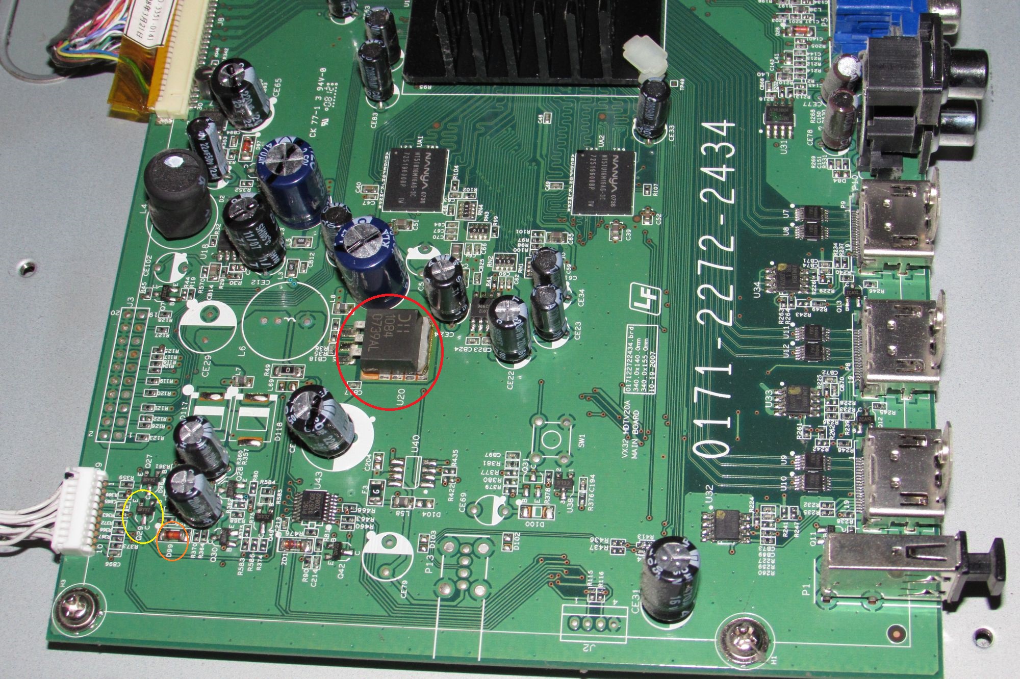

              Ok, I heated each transistor and the VGA chip. I even removed and tested the one transistor, Q29 circled in yellow on the picture, and the diode D99 circled in orange. I left the transistor out of the circuit and was able to get the TV to operate after heating the whole corner area again. The only thing that leaving that transistor out did was prevented the logo light from turning white like you thought it would do, R_J. I even thought that maybe the solder joints were bad on the receiver for the manual control plug, so I reset the solder on those pins. Wow, my eyes hurt now.
              Finally, I decided to check the regulator voltages again on U29, circled in red. Everything was the same as it was before whether the TV was working properly or not. Pin 1=.54v, Pin 2 and the base=1.79v, and Pin 3=3.34v. I heated the regulator with a piece of keystock that I heated with a butane torch. I was able to turn the TV on and have it operate properly. I tried this several times letting it sit for an hour in between each try and it turned on every time. I had to make the regulator pretty hot to get the TV to turn on and stay on. Could this actually be the problem? Does this make any sense? Could it have anything to do with the thermal protection in the regulator?
              I'm having a problem figuring out a match for this regulator on digikey. If you think this could be the problem, could you help me pick the correct one to order?

                Did you ever replace CE16, it is on the input to that ldo, Not sure if digikey carries that ic, ap1084kla
                I guess the closest from digikey would be LT1084IT#PBF-ND although it is in a to220-3 and not a to263-3

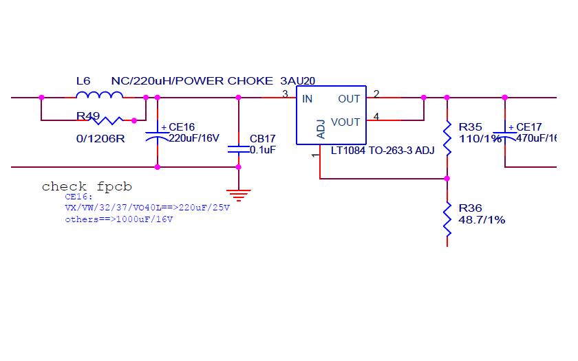

                                I checked the manual and found this. I would change CE16 to a 470uf see if that helps. The boards that use the 1000uf also have the coil and diodes which are not used on this board.
                                Where did you get the replacement cap?

                                  I got the capacitor at Radio Shack. 220uf 35v to replace the 220uf 25v.
                                  The Tv wouldn't tun on this morning without heating the CE16 220uf cap. It was a bit cooler in my garage this morning and I figured it wouldn't turn on because of that.
                                  So 470uf 25v?
