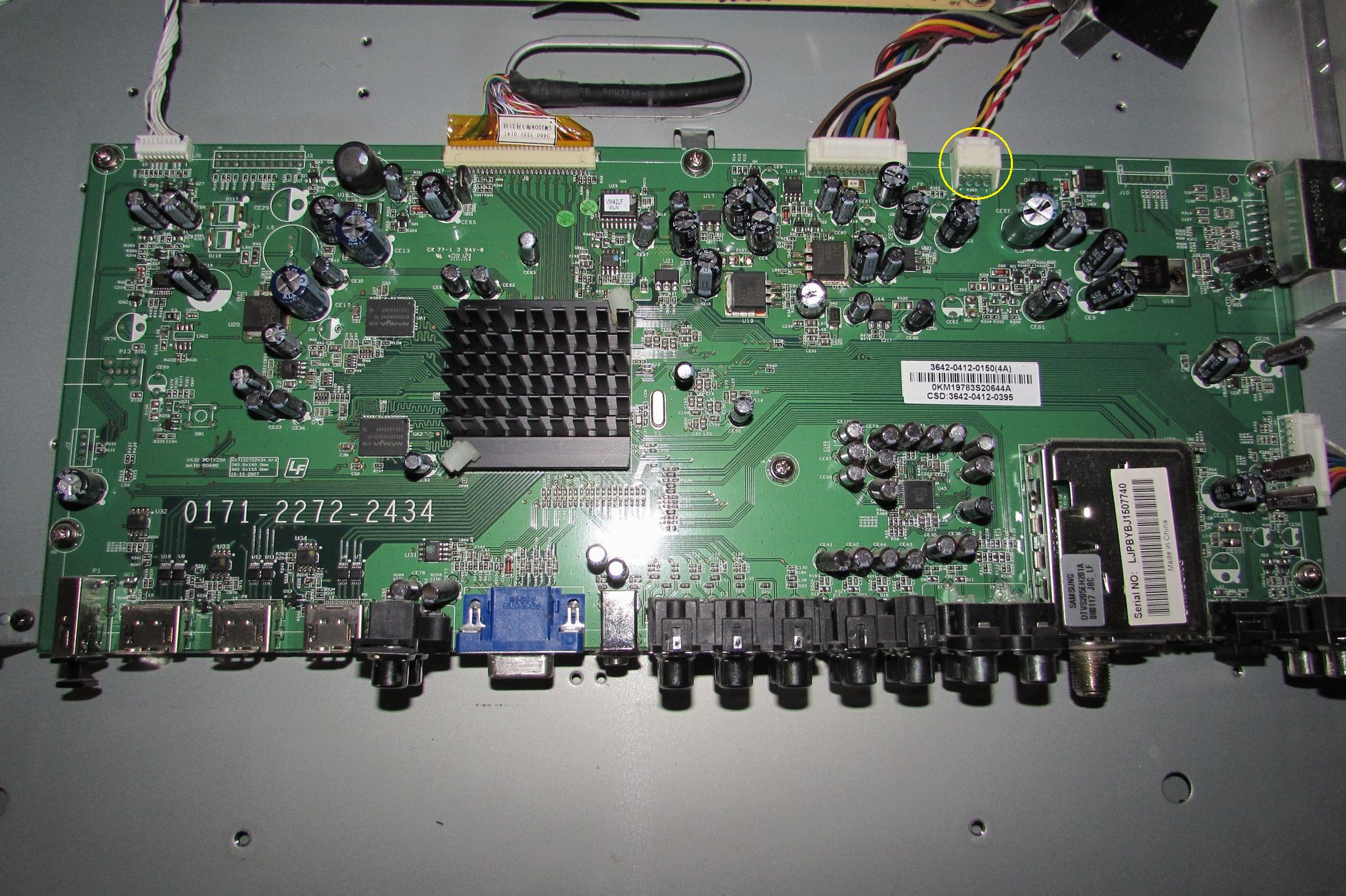

      ce23 ce50 dont look good from here .. if they turn out bad change all same values on that board .
      p.s where do the speakers plug in ? i am failing to see an audio chip .
      Thanks petehall347, yeah the pictures don't show those caps very clearly. They look fine and are not bloated at all in real time.
      I have attached a photo with the audio plug circled in yellow.

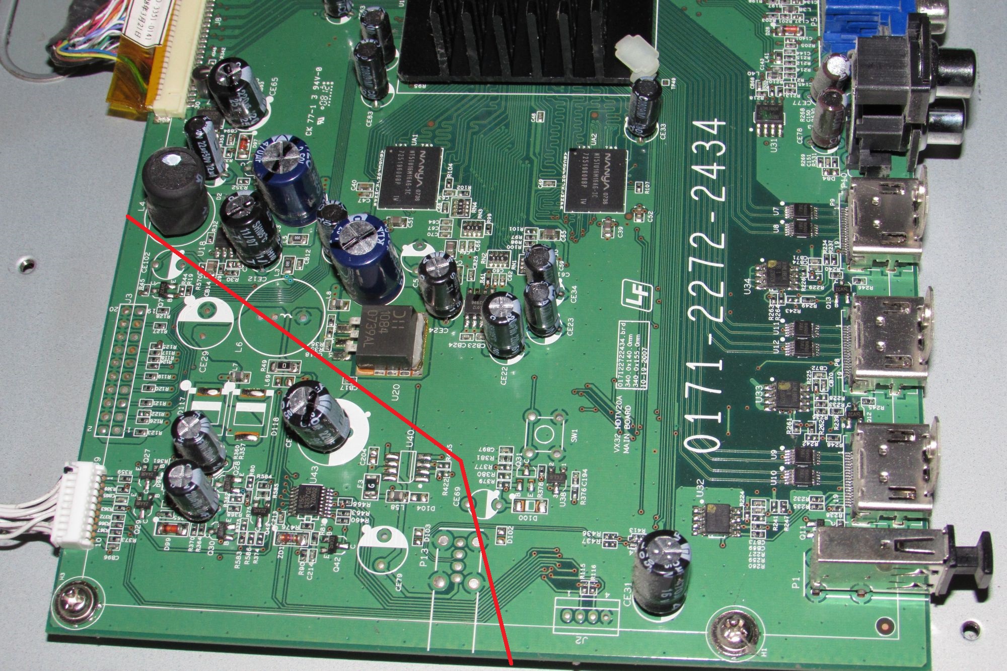

                                Ok budm. I didn't have much luck tracking down the area that needed to be heated yesterday. I heated a smaller area than the day before to start narrowing it down. The TV started up fine after the first heating, but I still wanted to narrow it down to a smaller area. I could not get the TV to malfunction again all day after letting it sit for hours at a time. It was a pretty warm day and I'm working in my garage without air conditioning, so I'm guessing that had something to do with it.
                                I went out first thing this morning while it was still cool out. Plugged the TV in and hit the power button. The logo turned white, the back light came on, but nothing else happened. The TV then shut off. I hit the power button again. Same thing, logo turned white, back light came on, only this time it did not shut off. It wouldn't shut off with the power button so I unplugged it to turn it off. I then placed a piece of cardboard along the line in the picture below, and lightly heated the corner of the board. I hit the power button and the TV came on normally, but shut off after like 15 seconds of being on. I hit the power button again and it powered on and stayed on this time.
                                As far as the pin "A" pin "B" thing goes, the only description or labels are on the wires which I am having a very hard time reading. I'm not real concerned with this right now. Thank you for your input on that issue.

                                  You have 3 lytic caps in that section, try replacing them.

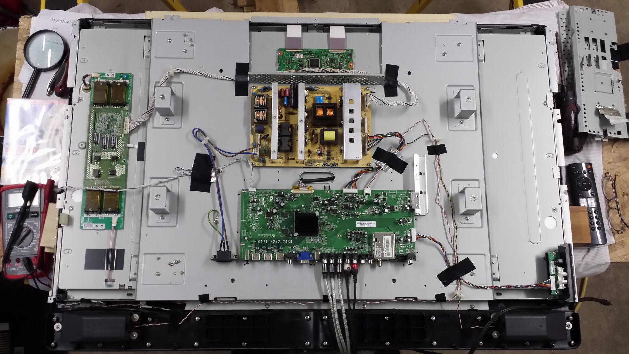

                                  BTW, can we see the pictures of the whole back side of the TV showing how all the boards are connected together? I cannot tell what that white connector go to what board.
                                    Ok budm, no problem. It goes to the manual control panel. I will work on replacing those caps. Thank you!

                                      Re: Vizio VW42L FHDTV10A will not turn on without unplugging and plugging TV back in
                                      BTW, for pin point heating of the lytics cap, sometime I use 25W iron on the top of the suspected cap to heat it up for about 15 ~ 25 seconds then plug in and see if the symptom will go away or not.
                                        Good idea. I was trying to think of a way to pinpoint it even better without ruining the cap in the process. Hair dryers are a good starting point but when it comes to really heating a tiny area....not so much. Thanks!
