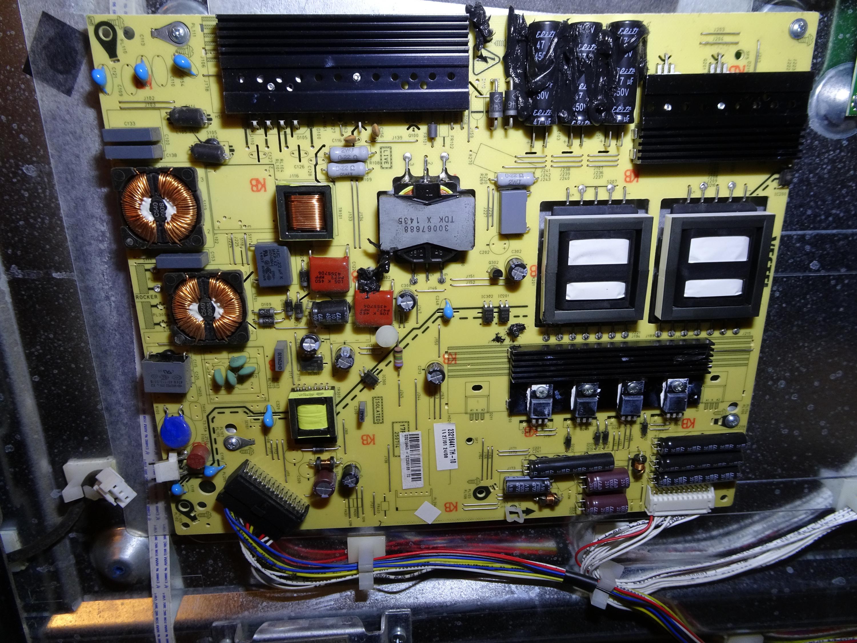

    Hi, Tv was on at the time and plugged into rooftop aerial. Lightning struck house next door. Other houses 200yds away have blown tv's (with no roof top aerial) and broadband routers OOS. The RCD tripped in the property, fuse in mains lead also blew. Aerial drop lead from the roof frazzled in various place with the conductors melted away.
    Got no standy light on the tv. Power board is vestel 17PW-03-9. The internal fuse T 3.15a 250v is open circuit. Can I change this for a cartridge fuse and see if power is restored? Have bridged fuse and checked across the 240v power input in diode mode on DMM and this is open circuit.
    Thanks in advance for any help

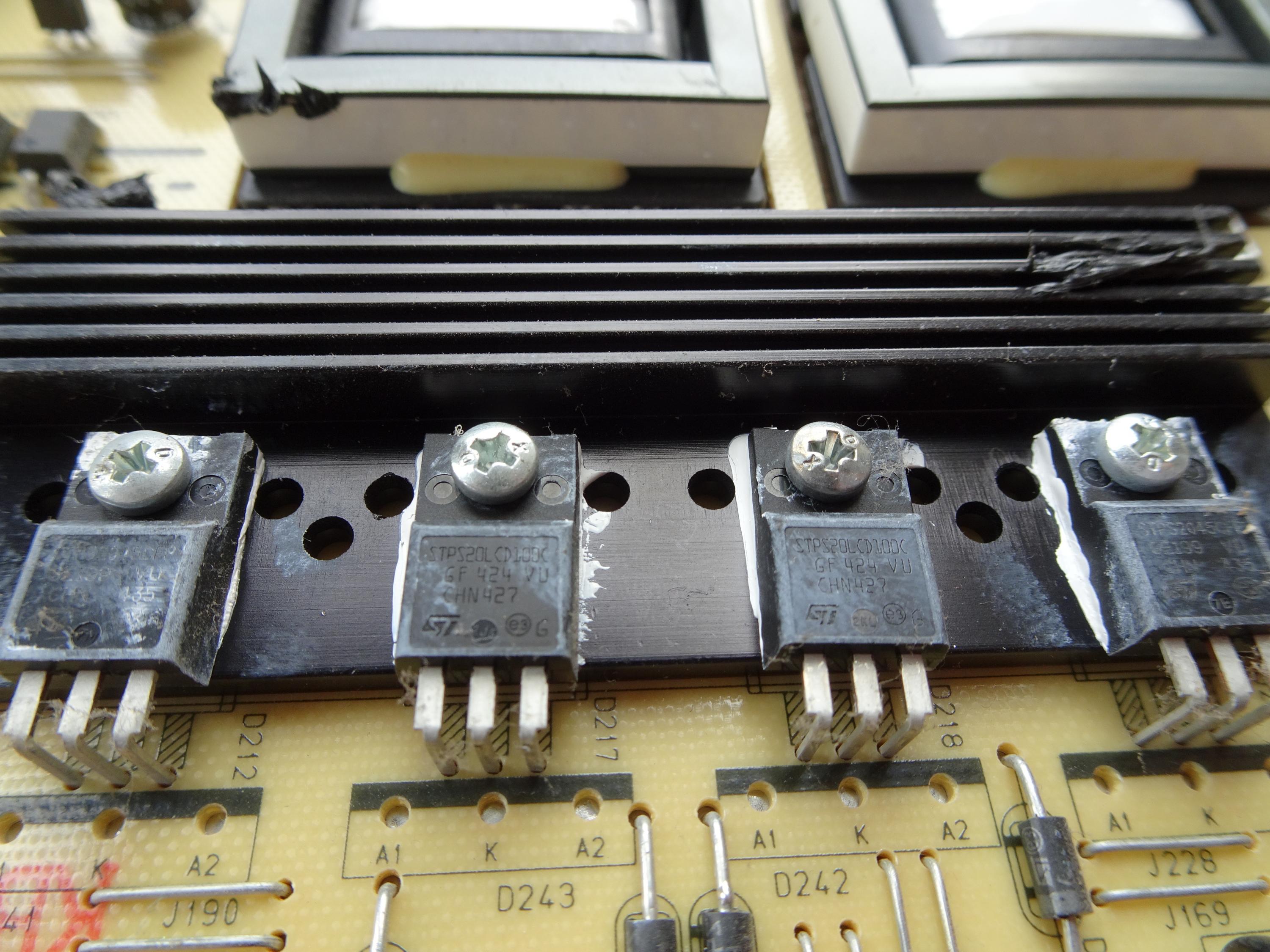

    When checking the quality of the uploaded file I noticed that the mosfet on the left I couldn't read the numbers on it

            What you are looking at are diodes in the secondary, they are dual diodes with a common center pin.

                You might get lucky, That blue R100 could be a mov that protected the supply and blew the fuse, Measure the resistance across it. It should measure close to open. If it measures shorted, you can remove it to test the power supply but replace it later for continued protection.
                Now looking straight above in the picture, under the heatsink is D105, check the resistance between the two outer legs. it should also be close to open and not shorted.

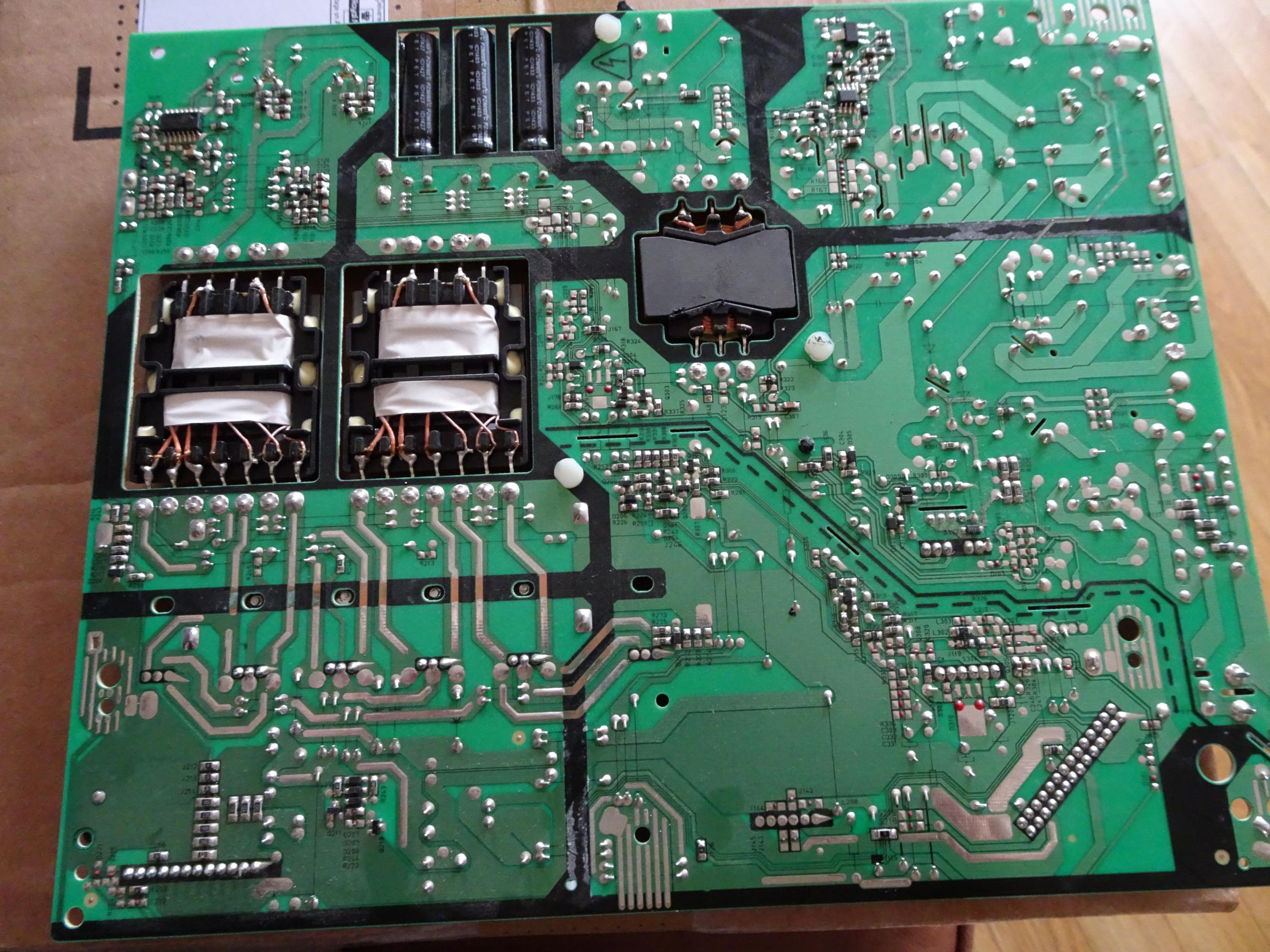

                                      The main filter cap, are actually 3 on this board, they are 47uf 450volt , labled c101, c102, c103, they are in parallel so measure across any one of them
                                      There is also one for the standby circuit, 10uf 450volts, (next to D123)
                                      If you don't read any short circuit across those capacitors, I would try a fuse and see what happens, if there is still a fault the fuse will open.
