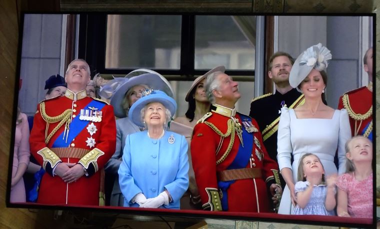

          It's alive :-)
          My local electronics store is closed (Maplins same store as what Tandy used to be in the USA). Looked up local TV repair guys, found a local one that was only a short walk and asked if he would sell me a fuse. Went round and picked it up for £2 and all working. Havent tried TV tuner but HDMI works, so attached my android streaming box and all good. Do get some flashing of the standby light when I switch it on (not sure if this is normal dont think it used to do that) maybe it is seeing a problem with the tv tuner anyone know the error sequence on these?
          Thanks to everyone here for the advice of checking the various parts so I was confident that the fuse I knew had gone was perhaps the only issue.

            Some tv's will flash the stby led after the power is pressed while it is initializing and waiting for backlights to come on, likely happened before and you did'nt notice.
            good to here its fixed.
