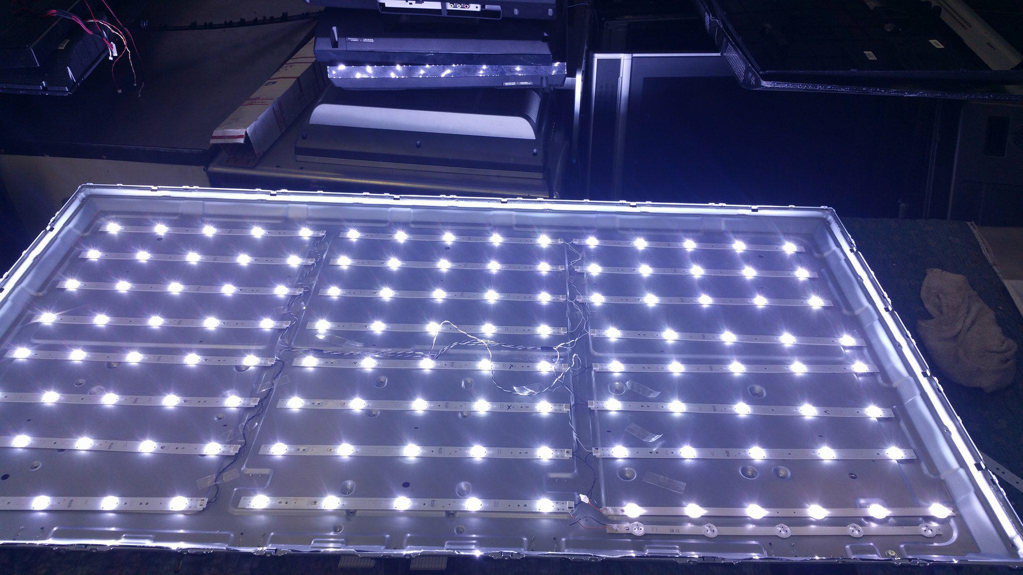

            OK, got in the shop about 0200 and prepped the table to break down a 65" LG to the bare LEDs...
            Wasn't fun, but I did get to use my handy dandy Harbor Freight Suction handles.. I had a friend pick me up a pair of the single suction ones. I had actually wanted the dual suction for less concentrated stress...
            The single ones worked like a champ.. Was able to lift off the panel with ease and no major warpage..
            So, that part of the surgery was a success..
            OK, so I discover that a set of 4 LED strips are not coming on... They are linked to the DRIVER board all on the same paired connection. So I am immediately thinking a bad wire pair.. Especially since I check each strip with my LED power source and they all work.. Or so I thought...
            So, after an hour of fiddling with the pair of wires, crimping here and testing connectivity there, I am stumped...
            I figure, why not put that strand on a different set of LEDs and see what's what. Well, the wire pair worked fine on a different set of LEDs... So, that tells me the wire pair is fine..
            So, I go back to thinking bad LED strip.. I start swapping out each LED strip (there are 4) to a different area of the array... First one I swap out, THAT set goes dark and the original set is fine.. Just to be sure, I test the other 3.. They are all good..
            So, I am left with the only logical conclusion that I have a single bad LED strip.. Test it with my LED PS and, sure nuff, it's bad... Only thing I can think of is my brain hadn't fully woke up...
            So, anyways, a replacement LED strip would be $60 and a week away... This 4K TV is obviously work another $60 outlay, but I don't want to wait a week.. Tear thru all my LED strips ( I have a ton of them) and find a similar one with similar LED positioning...
            Hook it into the array (had to do some jury rigging) and 'viola!!
            One each-type working LED Array!!

                Yea, and it's a sad story...
                https://www.badcaps.net/forum/showthread.php?t=70131
