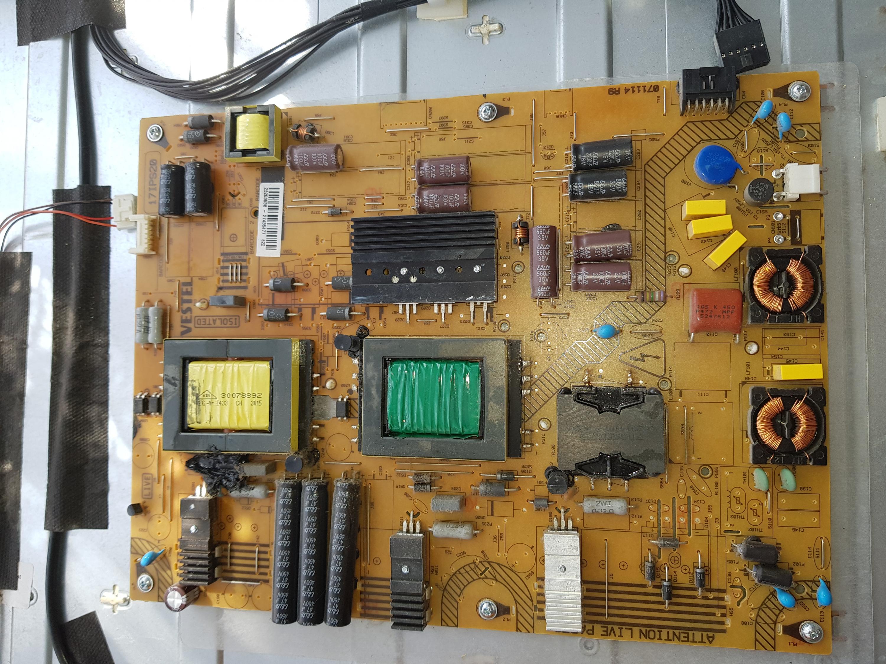

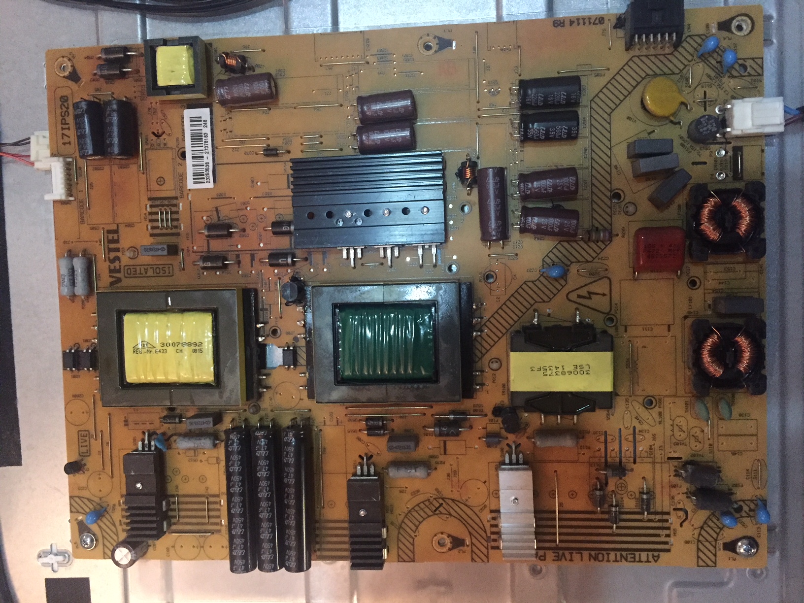

    Hi guys
    hav'nt been around for a little while, but just got this panny/vestal in.
    tv turns on and can see pic with torch, and it did have a brief led flash, but no longer,
    17IPS20 power board
    now longer flashes the LEDS on boot, checked volts, and LED voltage is steady at 79v, it did max at 180v once while testing, is it possible the the driver chip has give up ? how can i test it, all other voltages seem to be correct,
    Re: Panasonic TX-48CX400B low LED volts
    So if the TV is off, put the LED connector back in place, and then you attach the meter probes to the negtive leg and positive leg of either one of the two 56uF 160DC cap and then turn on the TV, you do not see the Voltage jumps up 10 180V any more?
    If you did have the LED connector in place when you get that reading of 180V, it is telling me that you have open circuit in the LED string some where.
    When the LED power supply does not see the load the output will go up to the max which will then trip the over Voltage shut down then all you get will be the feeding Voltage that feed the boost converter circuit, in this case, it is around 80VDC.
    It can also be that the BL-ON is not present to turn on the backlights driver circuit.
    So lets verify for sure if the boost converter is working or not.
    There are many threads about this power supply board but there are many version of this 17IPS20 PCB which can be stuffed in may ways to make a bunch of different PCBA's.
    That barcode is the number of the PCBA.
    Is it 23253638? or 23253538? I have a hard time reading all the numbers on that barcode.

        23253538 is the correct one

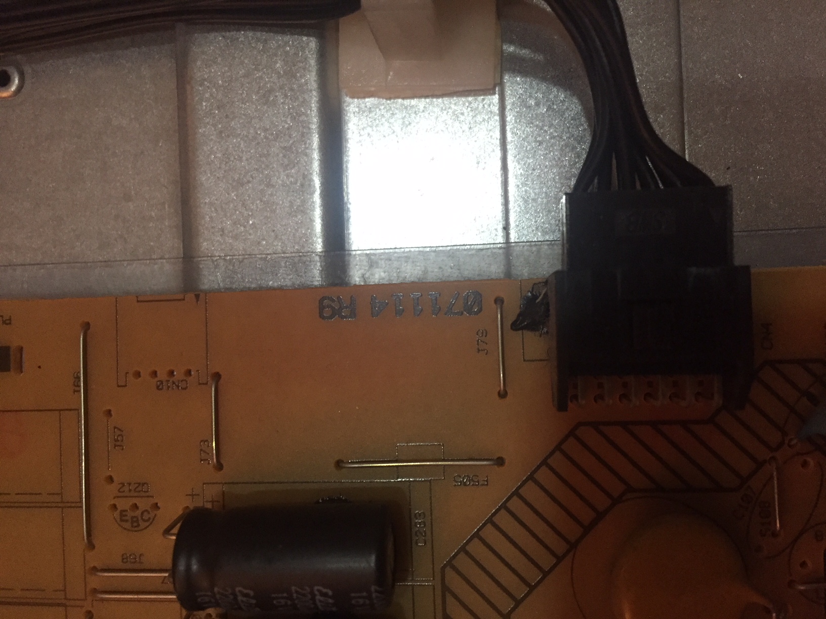

          checked what i think is the BL_ON off pin 5 and get 3.28v when i turn the set on, still only get 79v at LED plug, but im getting 390v on the 3 main caps, 47uf 450v
            checked what i think is the BL_ON/OFF on pin 5 power board to main board connector and get 3.28 volts on turn on, and holds steady,
            the 3 big caps rated 450v gives me 390v, so if i have the right pin, and the 3.28v is right, then the LED circuit is being told to turn on, but still only get 79v at LED plug, even when plug connected,
                  So far the PFC Voltage booster is working because you are getting 390VDC on the main filter caps which also means the PS-ON is present.
                  The key point right now is that we are not 100% sure if pin 5 of the connector is BL-ON/OFF or not.
                  Can you identify the PS-ON pin.
                  And If I remember correctly, some of these VESTEL boards use ACTIVE LOW for the control signals, but no matter what it uses, you should see the signal toggles from one state to another state when TV is toggle on and off.

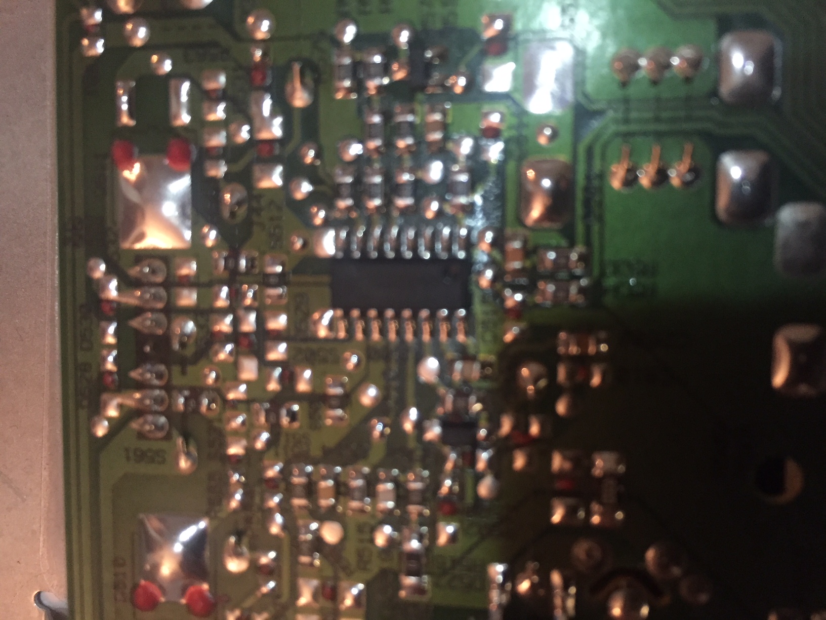

                                  Initially it had no backlight, I stripped the TV and checked all LED's in the screen illuminated as they should using an external PSU. Both 'groups' of LED's ran fine at around 90 VDC each.
                                  I eventually replaced the U500 (MP3394S) which did seem to cure the fault for a very short while, the backlight fired up and worked for a minute or so them again it went out. I spend a while doing cold checks based on a variation of info I found online but to no avail, I assumed there was some other fault elsewhere on the PSU that took out U500 so I gave up and ordered a replacement PSU.
                                  The replacement PSU arrived, I fitted it and sure enough, the same problem as when I first changed U500 on the original board, it fires up for a minute or so then the backlight dies.
                                  I went on to measure the voltages to the backlight, As the set if starting up (No backlight yet) I get around 80volts to each backlight 'group' this then rises to around 120volts as the backlight fires up. After the backlight dies, again it drops to 80volts.
                                  What I've noticed, while keeping U500 cool with a stream of cool air the backlight stays on, however after doing various tests and measurments eventually without cooling U500 failed again, I was back to no backlight at all. I changed back to the original PSU with the new U500 (MP3394S) and again, the backlight would come on but after a short while (U500 heating up) the backlight would go off again.
                                  Now, I measured the current to each group of LED's in the backlight, at 90volts (Using an external supply) one grouup pulls around 80mA and the other group around 150mA. Raising the voltage up to 120 volts as to match the TV's internal supply both groups pull in excess of 300ma. This I suspect is why the MP3394S is failing? They are rated at 200mA as far as I can see.
                                  Does anyone have any idea where I should look next as this is taking more time and U500's than I can afford to throw at it.
