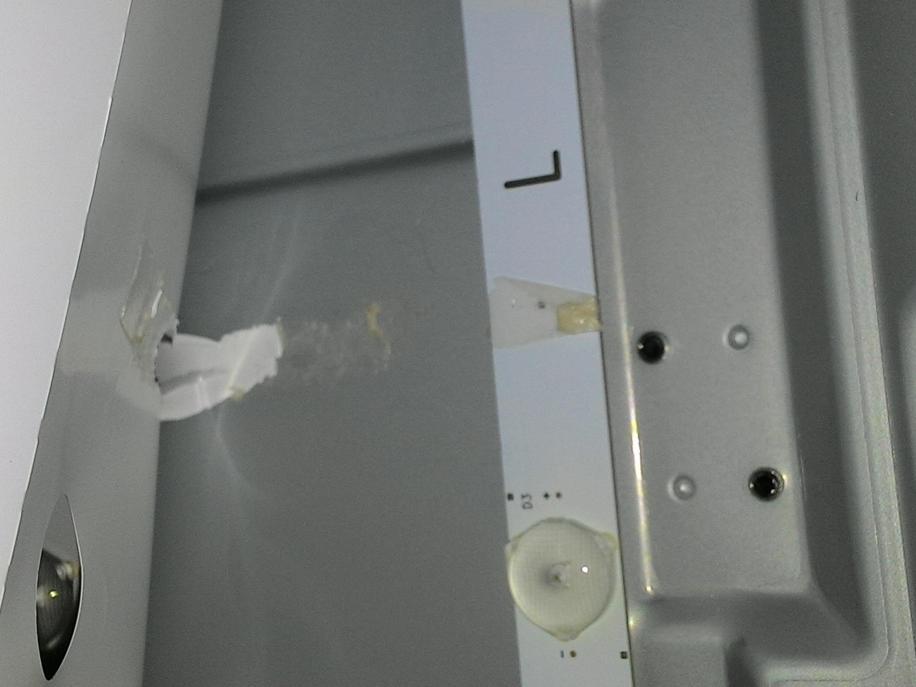

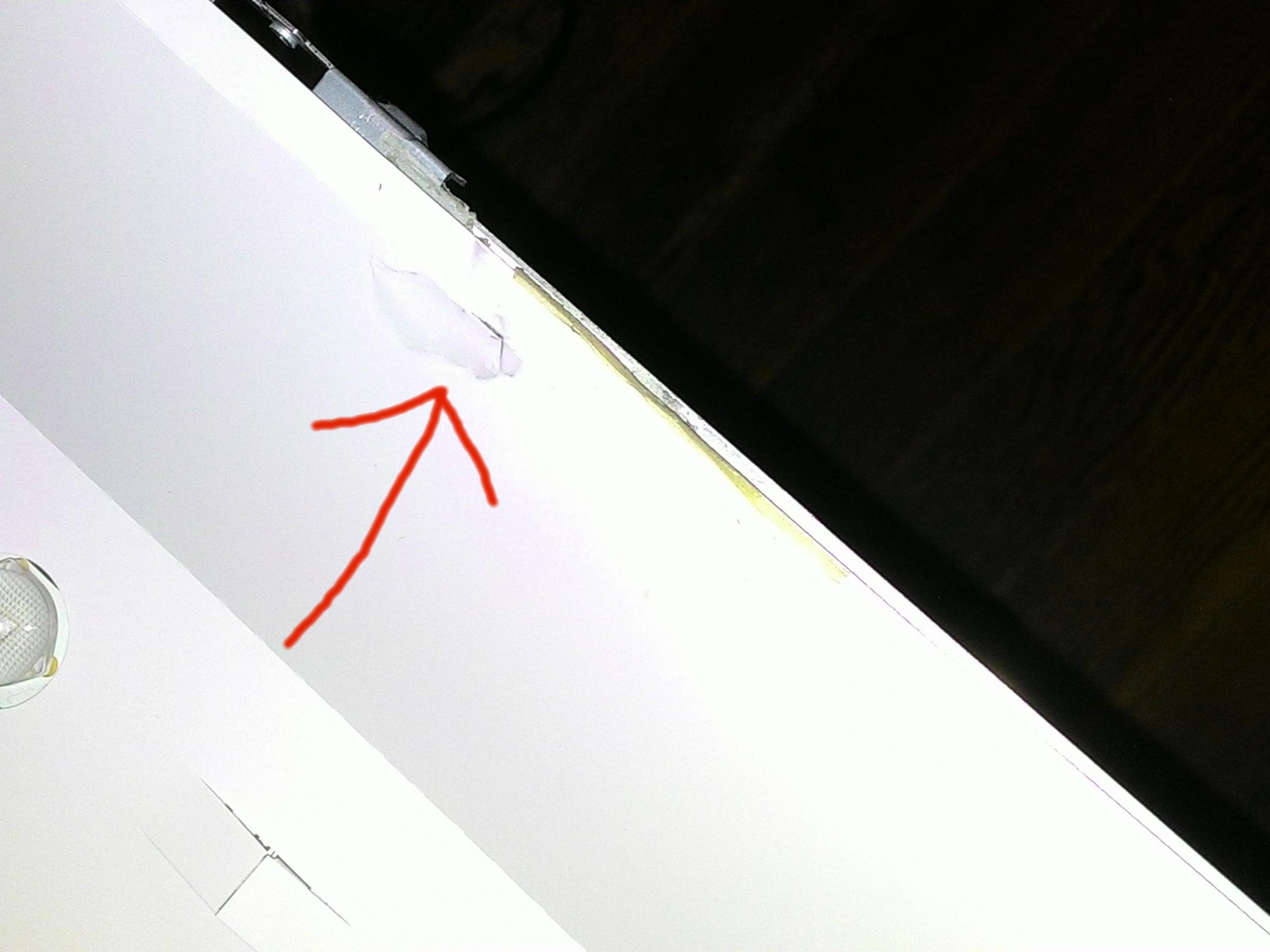

            The factory that made this TV must have been overstocked on glue because almost everything had glue on it. The bezel was screwed and glued, the LCD screen itself was glued to the chassis in 4 places. I used a guitar pick and got it free without damage so far..knock on wood.
            I am now stuck on the white paper backing that covers the strips. I removed the clips, but it is also glued to the metal frame in various spots around the outer edges. I stopped for the night in fear of ripping it. Any ideas on how I can remove it without damaging it? If I do tear it is it game over or can it be taped or otherwise repaired?

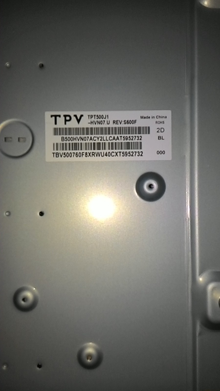

            shopjimmy lists 3 compatible part numbers for the LED strips 500TT65/500TT66, 500TT61/500TT62, or 500TT25/500TT26 and they are ruffly $75 shipped for a set of 12. (I've googled/ebay'd the cheapest from all three part numbers)
            In the grand scheme of things that isn't that much to invest in a 50" TV, but at the same time it seems to be a costly gamble especially since i am a newb and there is significant risk of disaster on reassembly.
            Are there any cheaper options or should I just man up and pay the $75?

                Using a single edge razor blade as a scraper I have still managed to damage the white paper backing. Is it game over or can this be repaired?
                If repair is not an option does anyone sell replacements?
                Not only is the paper backing glued in various spots along the outer edge it is also glued at numerous spots on the bottom.
                It's not the easy gummy glues that I have normally found used in electronics, but tough hard dried glue..A real pain it the butt.

                  Re: Sharp LC-50LB370U Where to buy LED Strips?
                  Tears in backing will not hurt anything

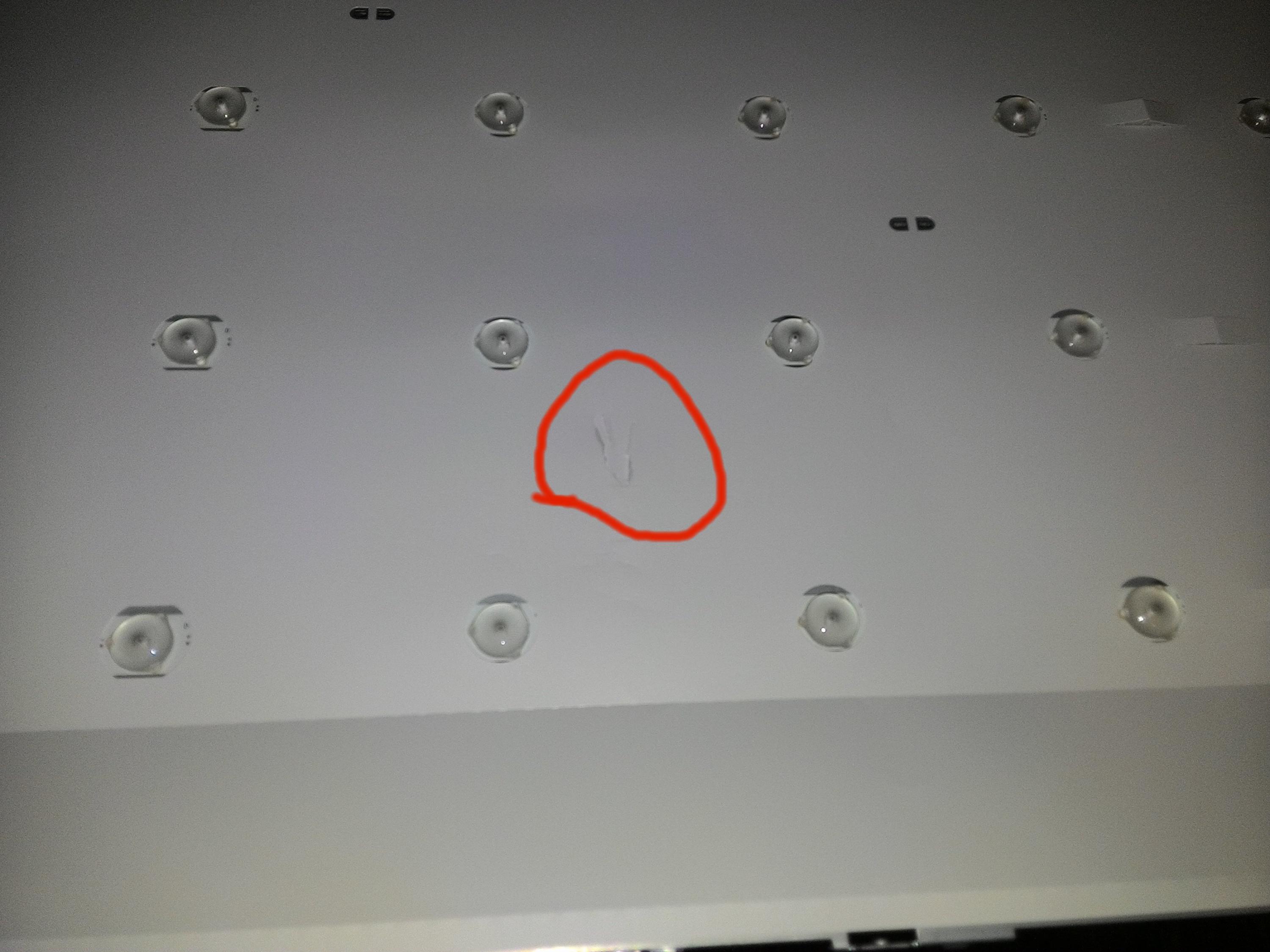

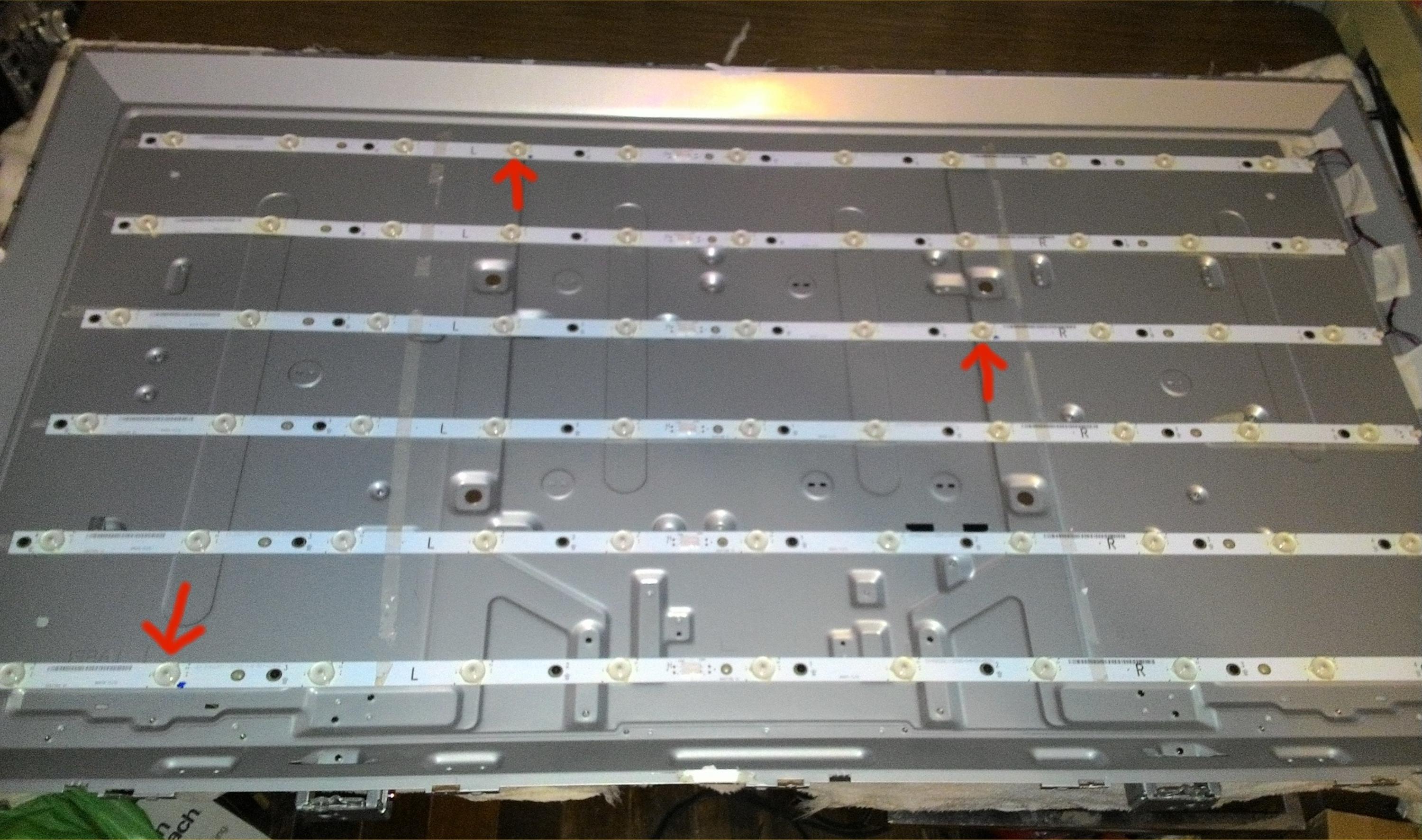

                    I made a little further progress, I'm not sure if I'm doing this right or not, but the strips have + and - spots next to each LED and with my DMM set to diode mode I tested each LED and all but 3 would light up.
                    I have a cheap harbor freight heat gun and have seen a youtube video of a guy using a similar one to desolder a LED, but he knows what he's doing.
                    Would I be wise to just go ahead and replace all the strips with new ones or should I take a gamble and try to replace only the 3 bad ones?
                    It would be nice if I could find individual strips for a reasonable price, but I haven't had any luck finding any on ebay.
                    If you think I should try replacing the 3 bad LEDs which ones would I need?

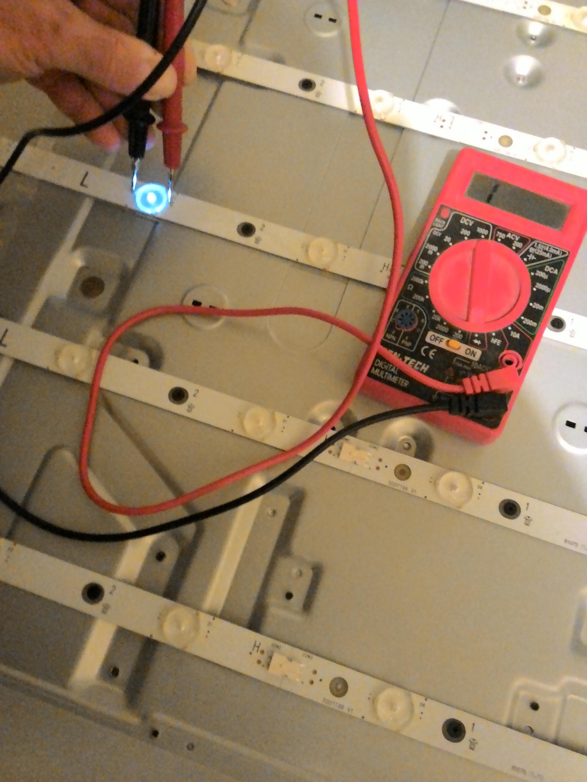

                          I ended up ordering these https://www.ebay.com/itm/50pcs-3V-SM...53.m2749.l2649.
                          There was a total of 4 bad LEDs, I replaced them using the stacking method, plugged in the TV and turned it on and nothing..not even a flash.
                          I then tested each individual LED w/ my DMM in diode mode and they all will light up.

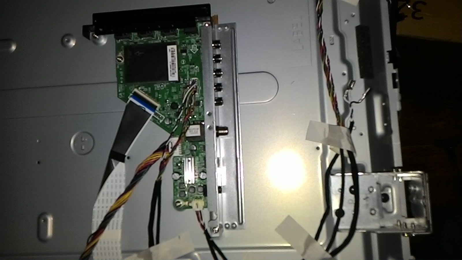

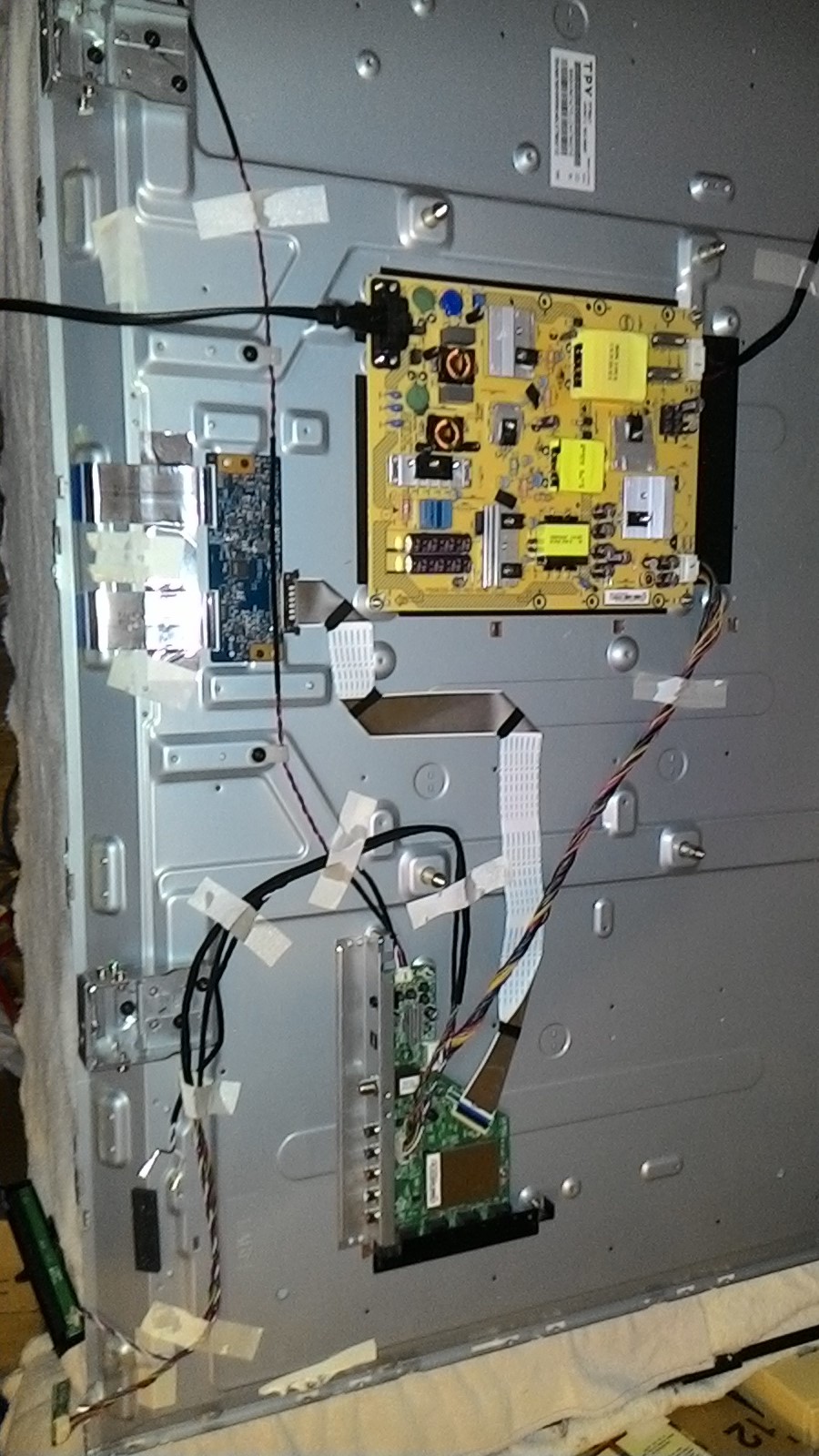

                          Next I flipped the TV over to test voltages.
                          Power connector going from top to bottom.
                          15.v = 0v (standby and power on)
                          12v = 11.8v
                          12v = 11.8v
                          12V_A 11.8v
                          GND
                          GND
                          PS_On = .12v standby and 3.7v power on
                          1. DIM = 0 standby and 3.2v power on
                          LED Connector.
                          +VLED2 = 65.4v standby. power on and it spikes to 96.4v then settles back down to 65.4v
                          +VLED1 = Same as above.

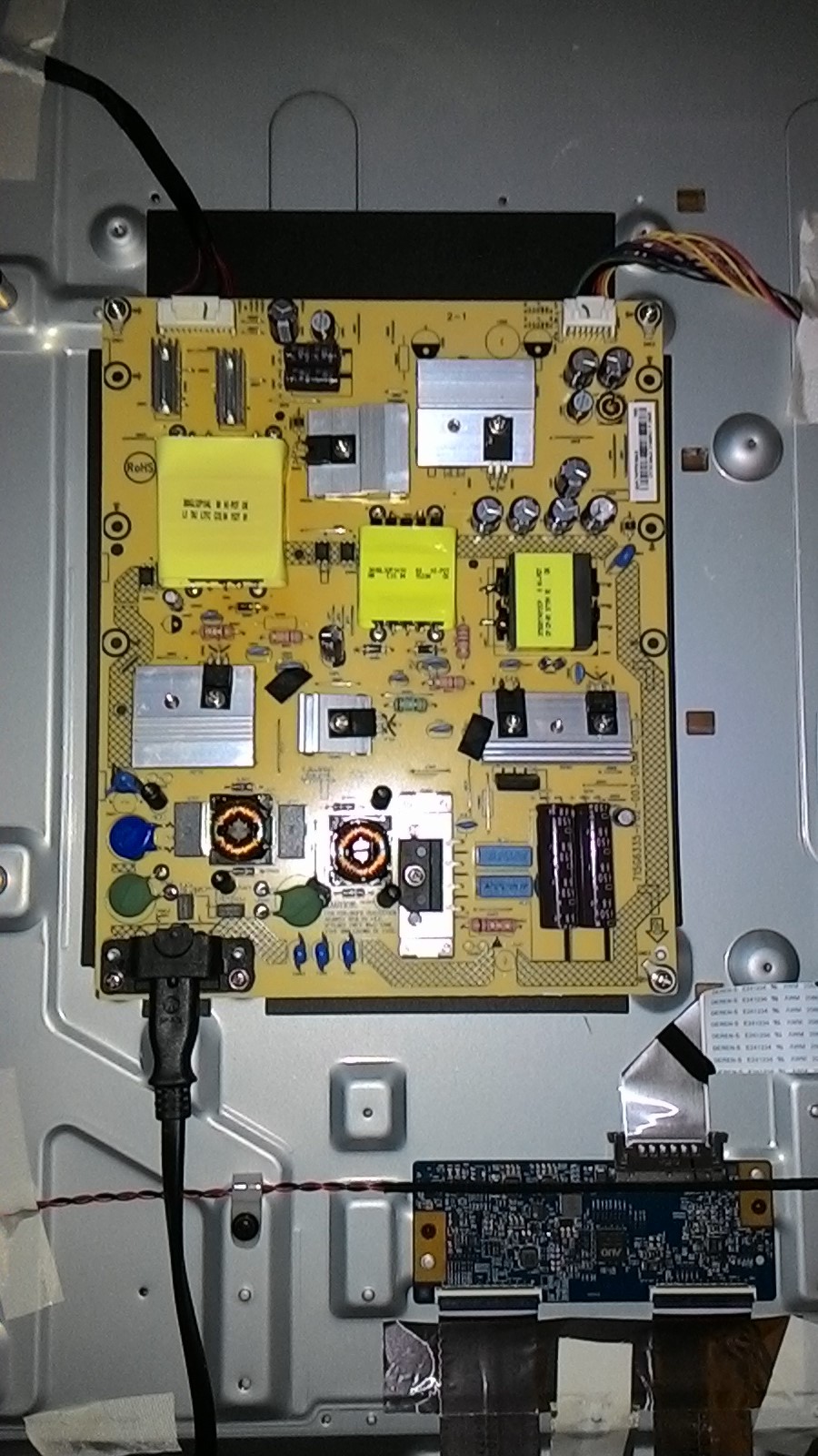

                          When plugged in and powered off I get a red standby light. When I press the power button the light blinks red 7 times and then turns blue.

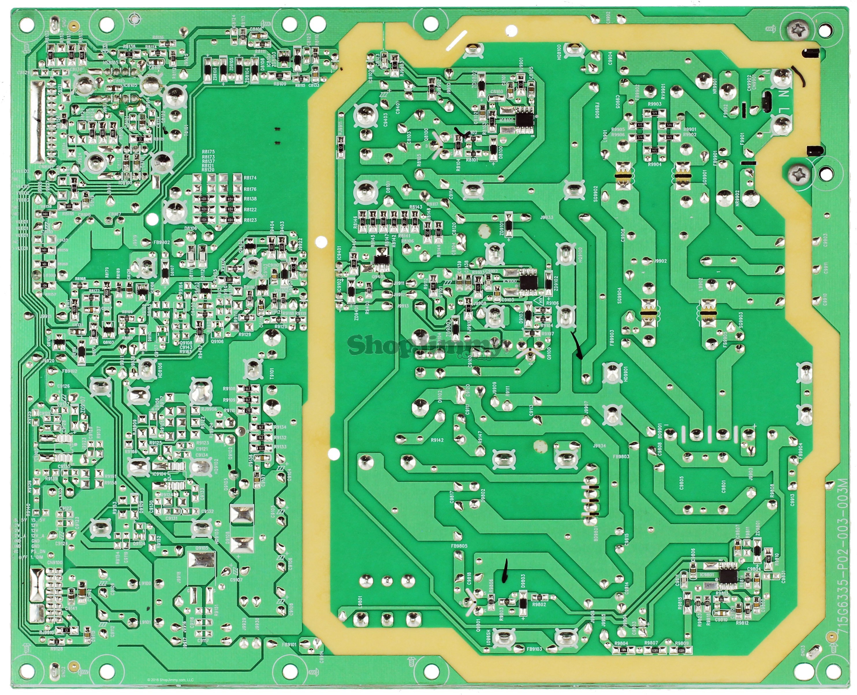

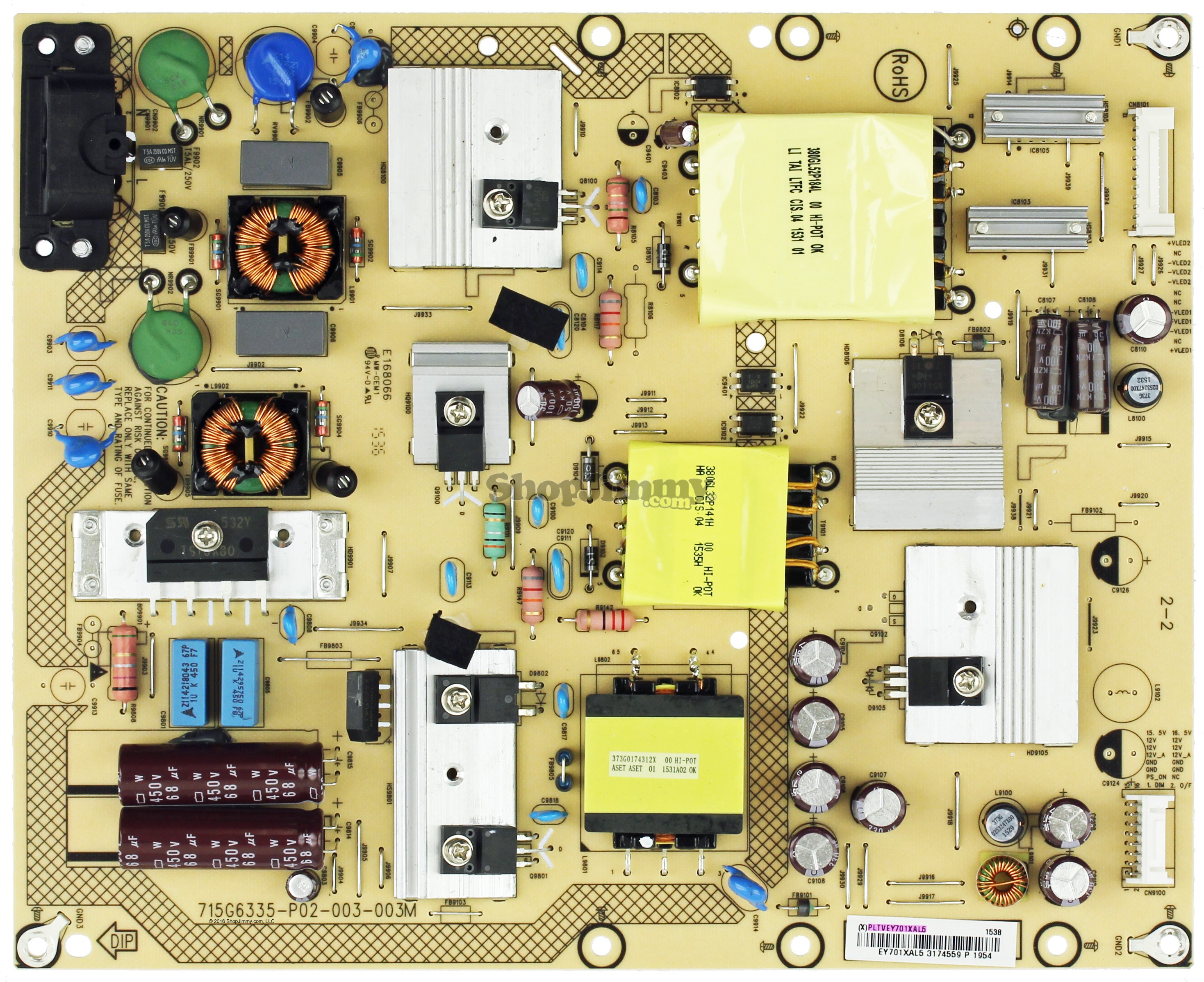

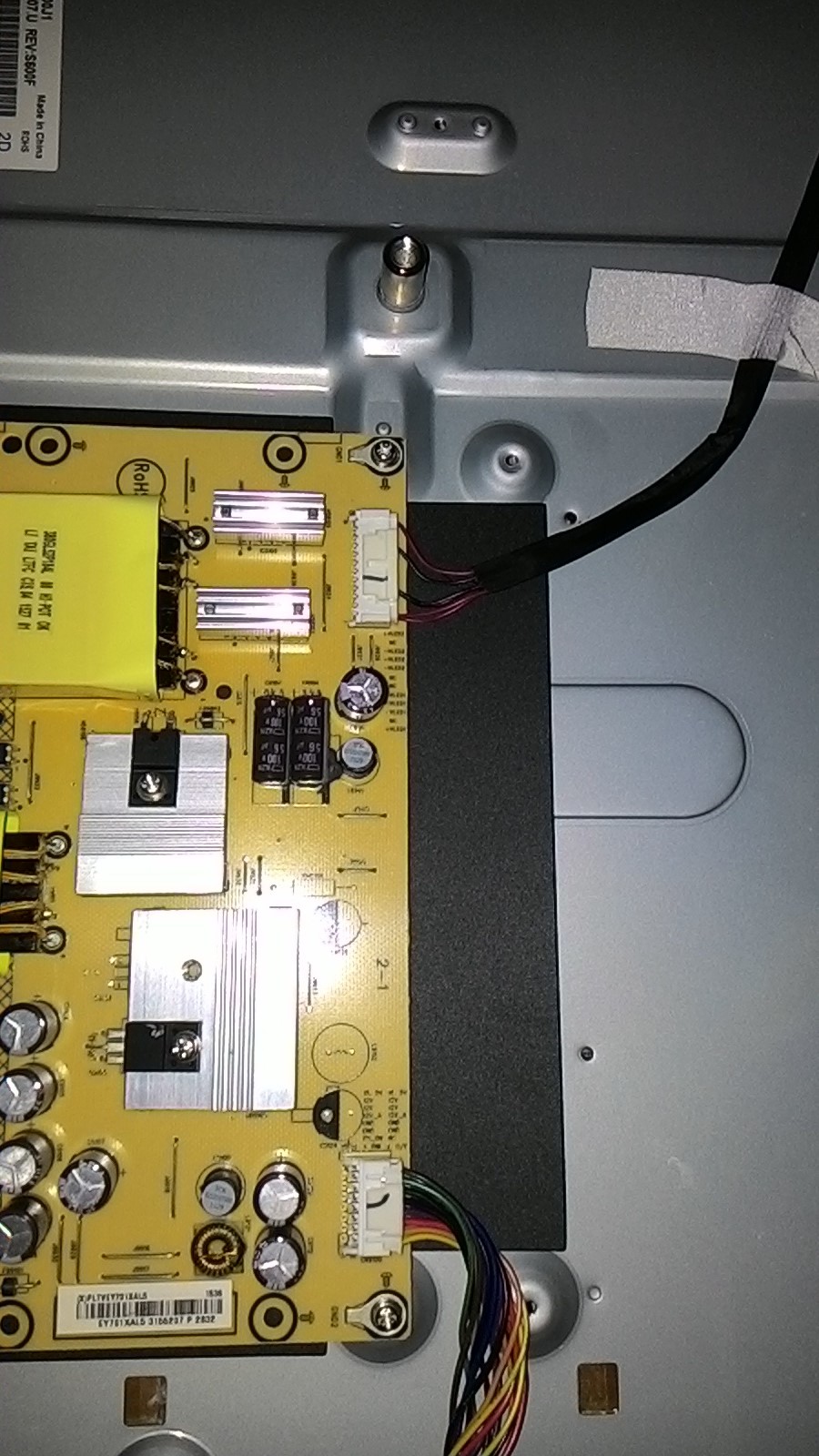

                          The first pic is of the power board borrowed from shopjimmy. The rest are from my TV.
                          Where do I go from here?
                            That still looks as though you have a led(s) / led chain connection problem.

                              That's what I'm thinking too, but I don't know how to find the problem.
                              I've checked and double checked each LED with my DMM in diode mode and they all light individually. I wish I had a LED tester where I could test a whole strip at a time.
                              Even though my replacement LED cutoffs are 3v is it possible that some other spec in them isn't the same as the originals and is throwing things off?
                              Another question. The top pin on the power connector on the PSU board is labeled 15.5v 16.5v but shows no voltage either in standby or when powered on. What is this pin for and shouldn't it show voltage?
                                The 15.5V circuit is not stuffed in your board.
                                Leave the Black probe on the chassis, red probe on one of the two black wire of the LED connector then turn the TV on while watching the meter to see if you see the Voltage jumps up for seconds or not, the turn off the TV and do the same on the other black wire of the LED connector, report the reading.
                                Those two black wires are the Cathode return foe each set of the LED strips, you have two LED driver control circuits.
                                +VLED1 (pin 1 of the LED connector) and +VLED2 (pin 12 of the connector) are tied together and fed by the Voltage booster circuit to feed the Anode of the LED strings.
                                Sharp PLTVEY701XAL5 Power Supply / LED Board for LC-50LB370U
                                http://www.shopjimmy.com/sharp-pltve...-50lb370u.htm#
                                Pictures provided by shopjimmy.
                                    Looking at the circuit boards there are two led driver IC's.
                                    IC8103 which drive one led string and IC8105 which drives the second set of led strings.
                                    Led string 2 (VLED2) is connected between Pin 12 (+VLED2) and Pin 10+9+8 (-VLED2)
                                    Led string 1 (VLED1) is connected to Pin 1 (+VLED1) and Pin 3+4+5 (-VLED1)
                                    Pins 2, 6, 7 and 11 are No Connection.
