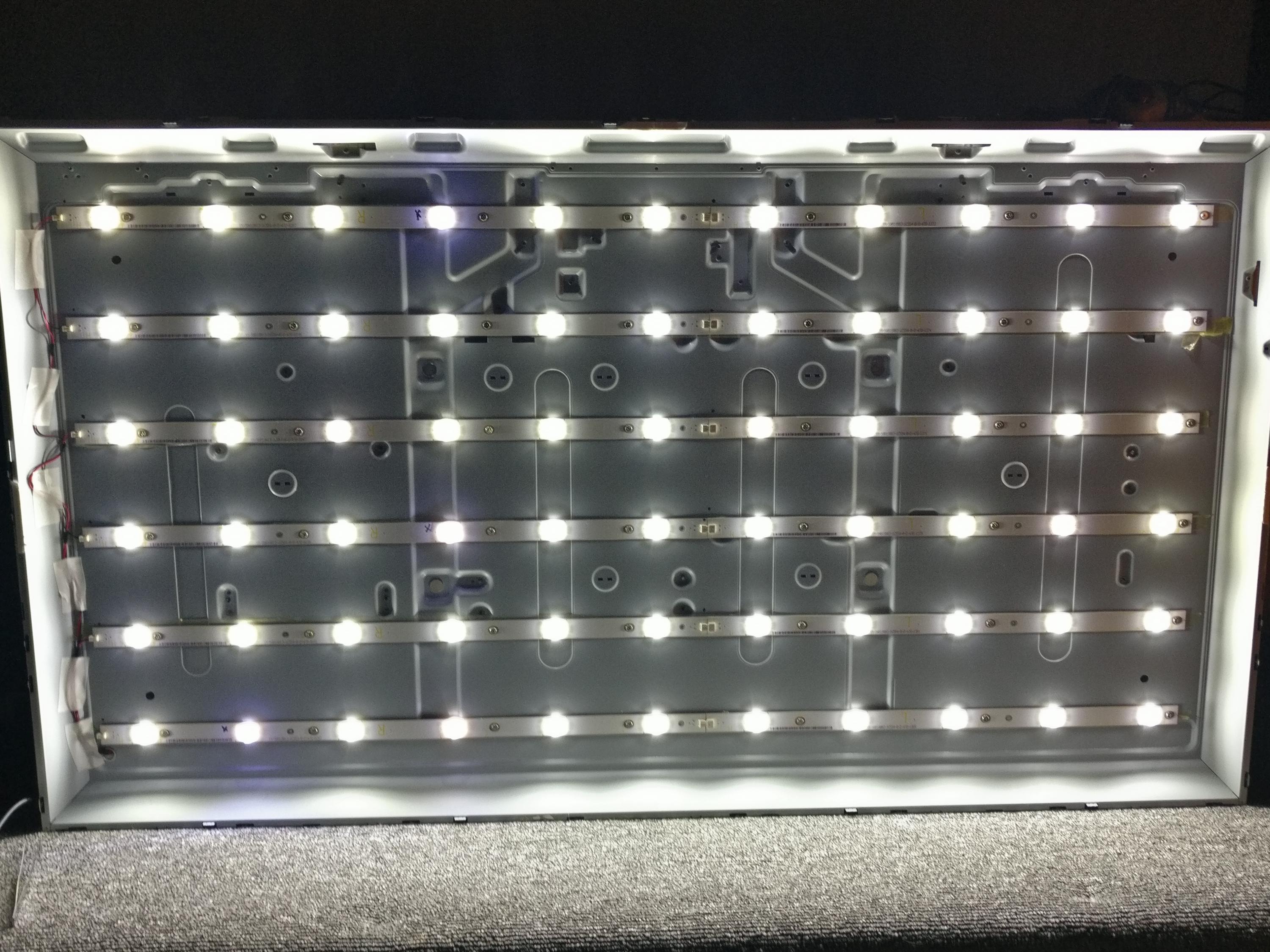

            In your previous pic you can clearly see many of the individual leds on four of the strips.
            There is not a one lit of the middle two strips.
            Do the flashlight test and see if there is indeed a picture and your backlights have not burned out again.

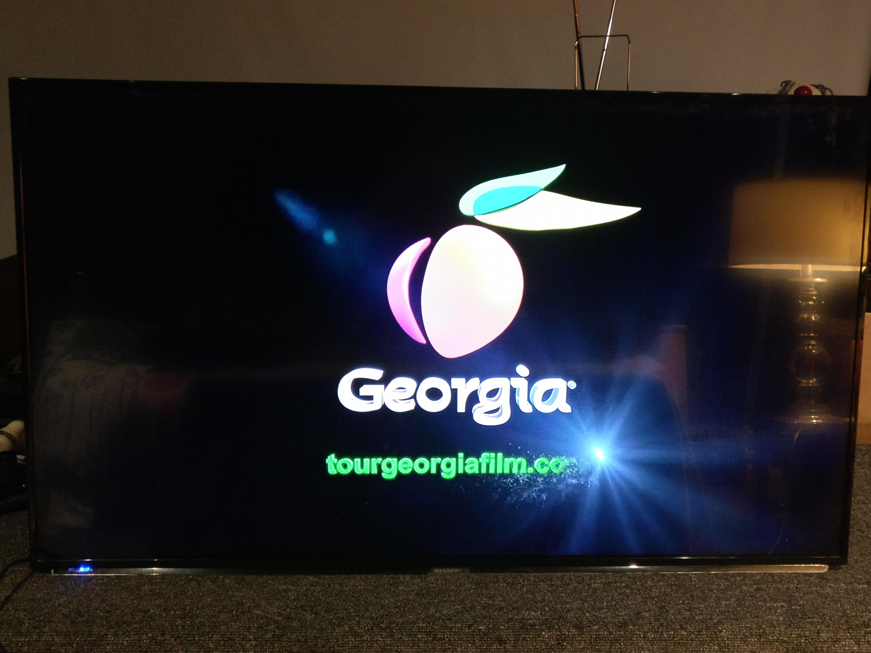

              • Gorrillasnot
                • Dec 2013
                • 316
                #67
                Re: Sharp LC-50LB370U Where to buy LED Strips?
                You was right. The TV had another LED that went out killing the middle 2 strips.
                I replaced the LED and all the strips were back to working.
                Everything went fine until I was putting on the front bezel that holds the panel down. I was trying to get the left corner on and it was being stubborn.
                When it finally let go and went on it cracked the LCD in the corner. ugh!
                I think the LCD must of not been flush with its mounting surface.
                Would that kill the whole panel though? if so that's a shame because it could've still been used as a garage/basement/kids TV.
                Oh well if it's game over I have some spare parts and it was fun to tinker.
                thanks

                  #68
                  Odd, I would expect to see some evidence on screen even if it were broken. Double check your connections. If everything looks good try running with only one panel ribbon connected one side at a time to verify broken panel.
                  The reassembly is tricky with all the slot and groove trim pieces. I found out one of my sheets had slid down out of place. It's adjusted now will have a go tonight at getting these pieces in place and the bezel on for a test.
