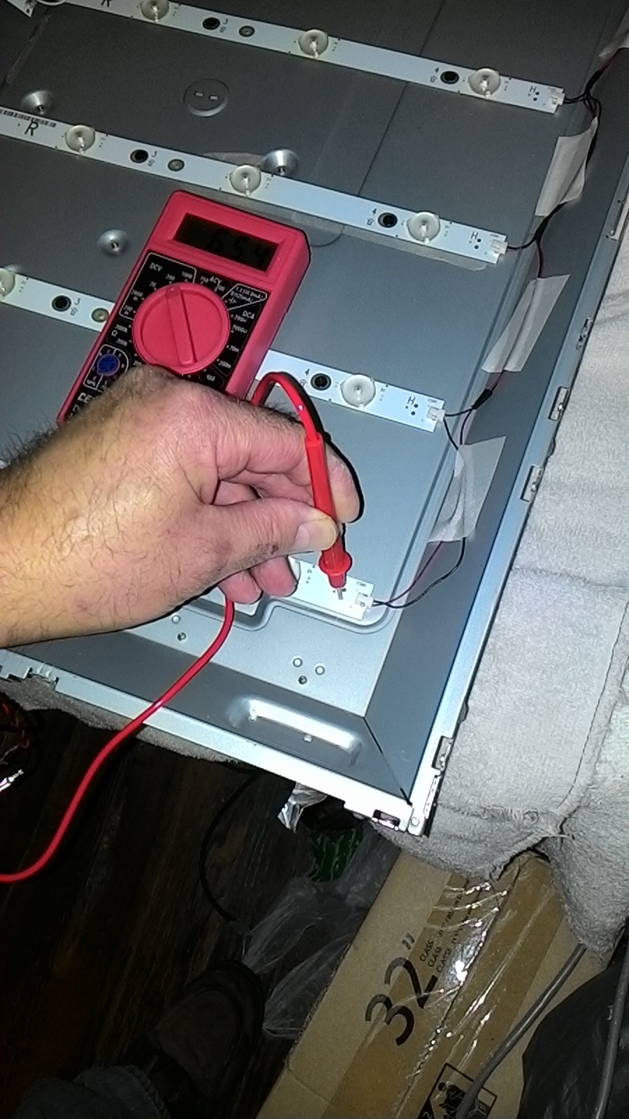

    Originally posted by budm
    Leave the Black probe on the chassis, red probe on one of the two black wire of the LED connector then turn the TV on while watching the meter to see if you see the Voltage jumps up for seconds or not, the turn off the TV and do the same on the other black wire of the LED connector, report the reading.
    Measuring at the black wires I get 0v in standby and when powering on.
    thanks
      Re: Sharp LC-50LB370U Where to buy LED Strips?
      OK, so now we know for sure there is no current return on the two black wires.
      You will have to make sure next that the feeding +Voltage actual gets right to the termilal of the LED strip next.
      See this thread to see why, speciall on post #18:
      https://www.badcaps.net/forum/showthread.php?t=66893
        With the TV plugged in and powered on testing at the + at the head end of each strip I get the following voltage (from the top strip down)
        1. 38.6v and causes the strip below it (strip 2) to dimly light all 11 LEDs.
        2. 65.4v
        3. 38.6v and causes strip 4 to dimly light up.
        4. 64.4v
        5. 0v there's a problem here somewhere, but not sure what..each bulb lights individually when checked with DMM in diode mode.
        6. 65.4v
        I think I'm getting closer..whatever is causing strip 5 to have 0v is probably the main problem?
        thanks

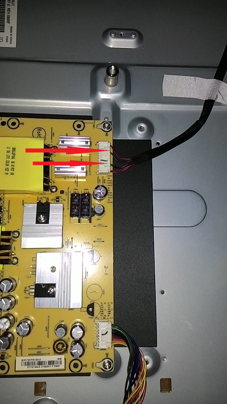

          One thing is not so clear as how all 6 strips are wired up.
          It has FIVE wires from the the strips, THREE red wires are all connected to the V+ but only TWO returns wires, I expect FOUR wires for two set of LED strips.
          Is there any way you can tell me how all six strips are wired?
            There is 3 black and 3 red wires coming in to the front of the panel (where the LED strips are) and from the top strip down they are.
            1. black black
            2. black red
            3. black black
            4. black red
            5. black black
            6. black red
            is that what u mean or do I need to trace them to the power board?
            thanks
              Not really, each strip has two wires but some how it ends up with just 5 wires at the LED connector.

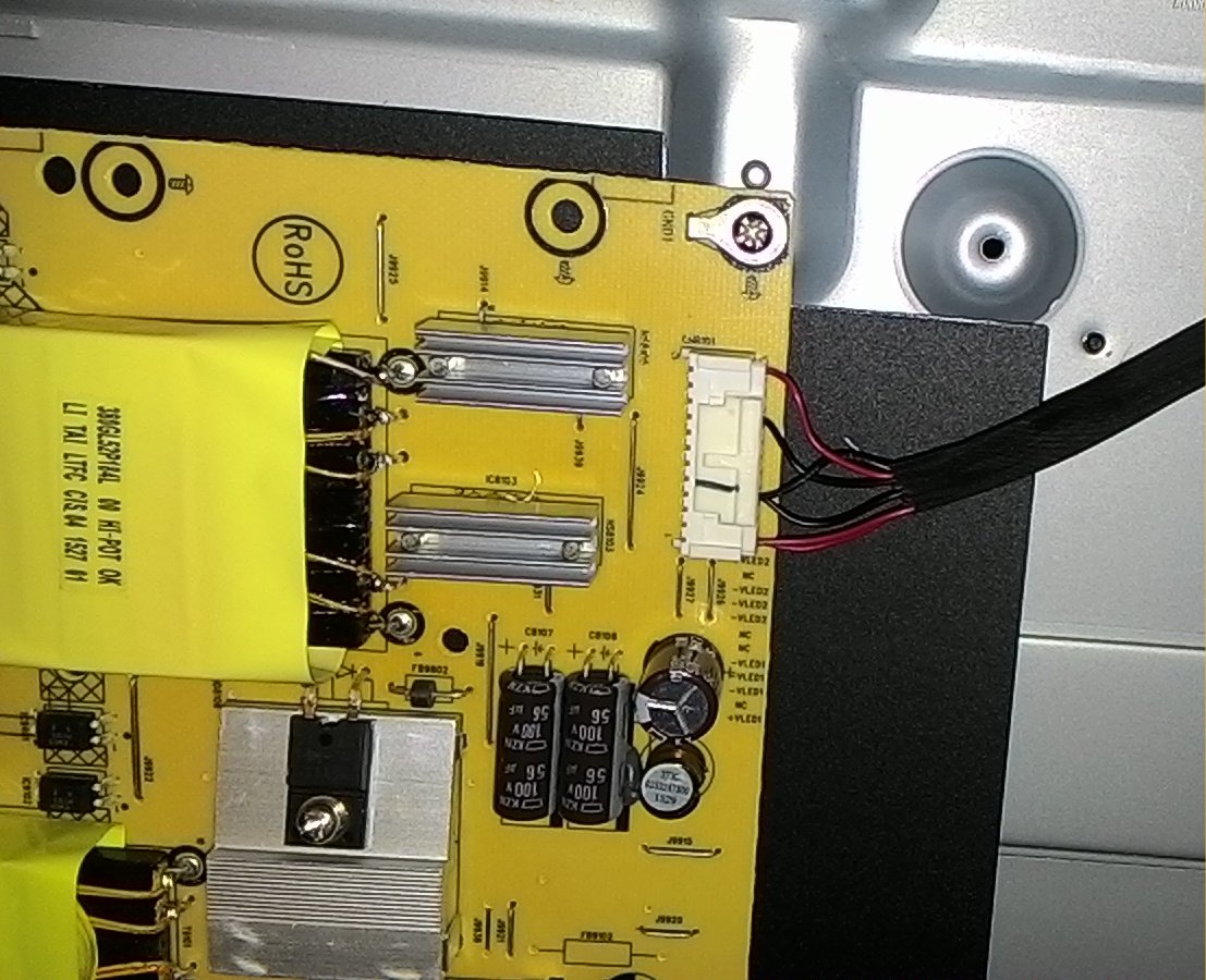

                    #29
                    There are 6 wires at the LED connector coming from the PSU.
                    It looked like 5 in my other pics..sorry about that.
                    thanks
                      #30
                      thanks
                      OK, that is more like it.
                      So it looks like one LED drive has two set of LED STRINGS connected in parallel, then another driver has only one set of LED string.
                            I dont get any voltage at the connector..both wires going to #5 are black if that matters?
                            The resistance from positive pin on LED strip #5 to where the 2 black wires are connected on PSU +VLED1 my DMM shows 1. Ground on #5 to +VLED1 is 0 (might of been the other way around).

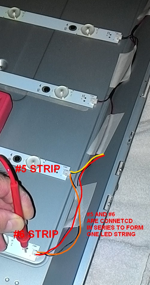

                                  #36
                                  OK, if you look at the attached picture, you can see that trip #5 is connected in series with strip #6 to form one LED string.
                                  Please look at how strip 1~ 4 are connected.
                                  Is strip #1 connected in series with #2?
                                  Is strip # 3 connected in series with #4?
                                  If you can take pictures, that will help.
                                  Once I know how they are connected then I can tell you how to test each string one at a time.

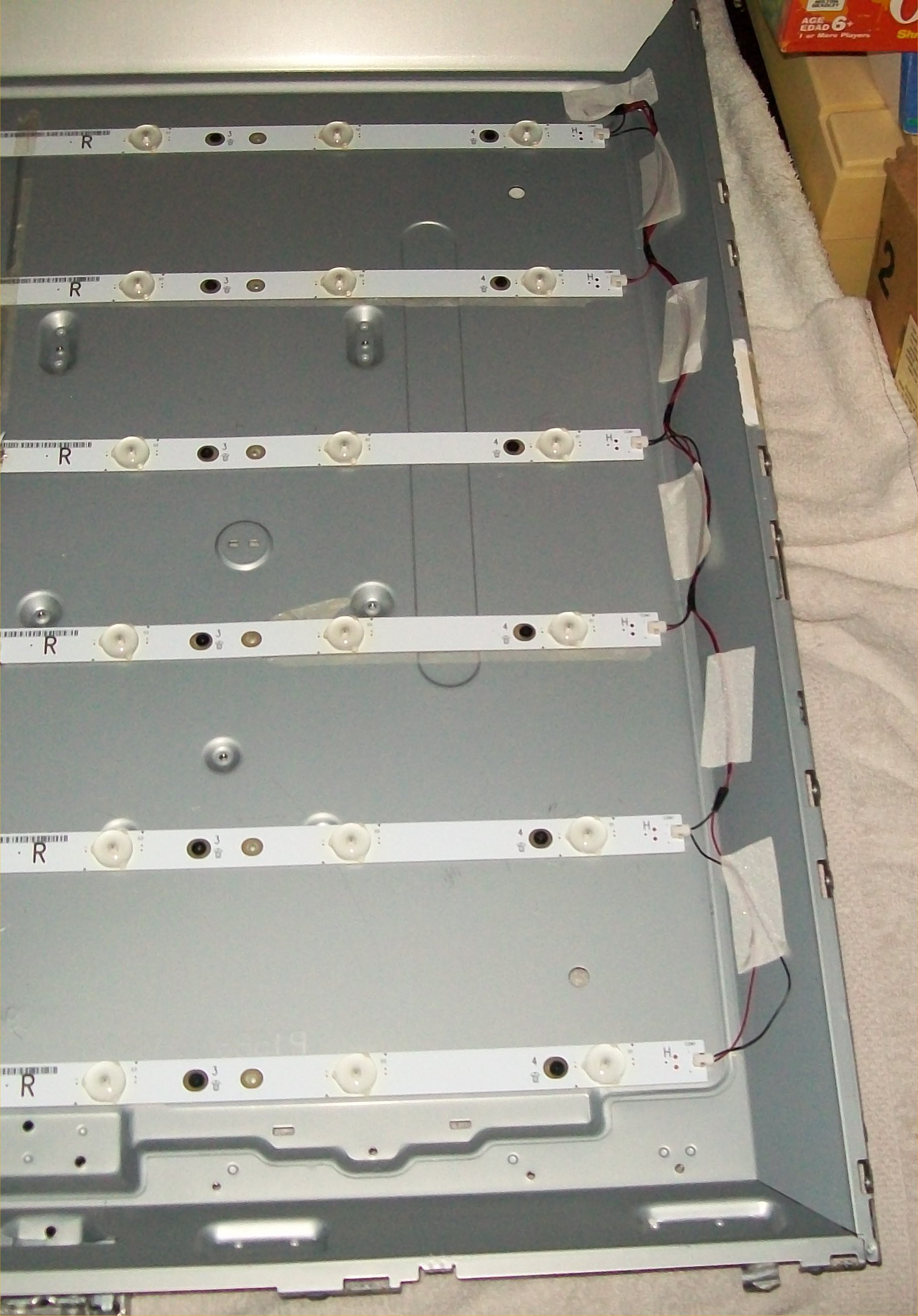

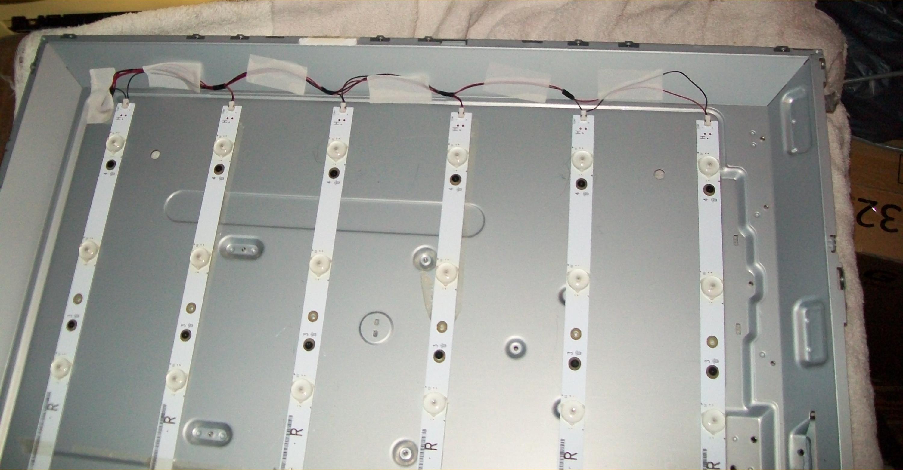

                                        #39
                                        budm: Here is some pics of how the wires connect to the strips.
                                        Looking forward to learning how to test the strings.
                                        thanks
                                          #40
                                          The #5 and #6 are easy to see how they are wired up together, but the other 4 strips are hard to tell due to the taps are holding the bundle of wires together, not like the #5 and #5.
                                          You will have to remove the tapes and un-bundle the wires.
