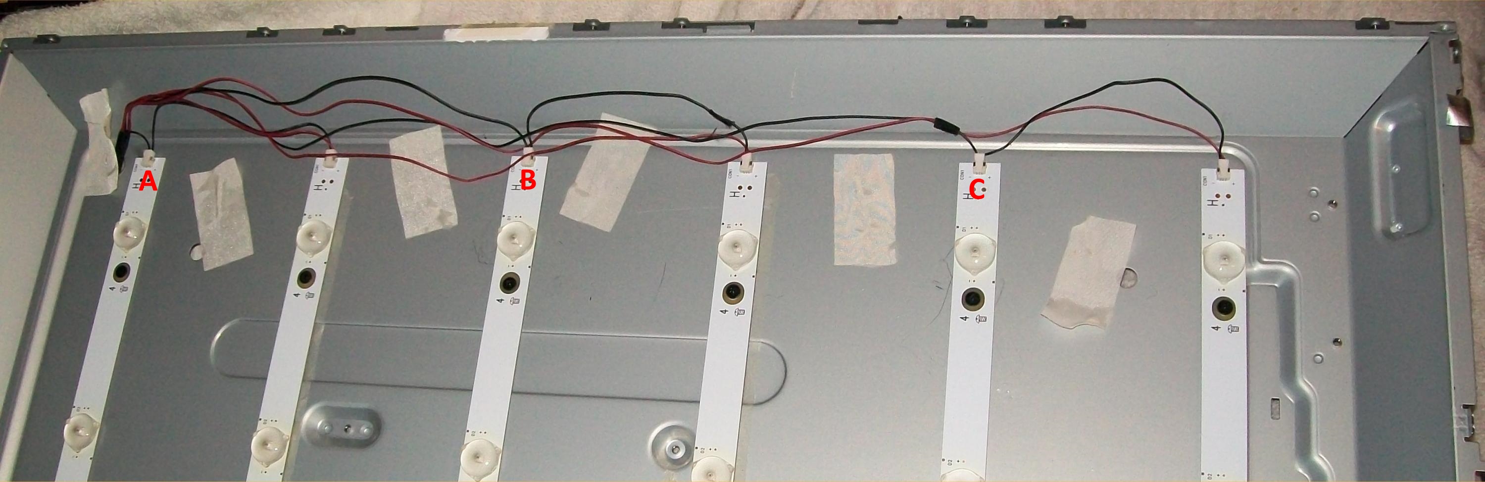

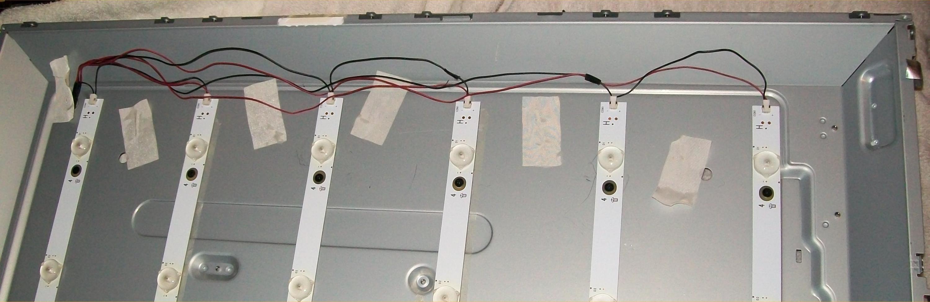

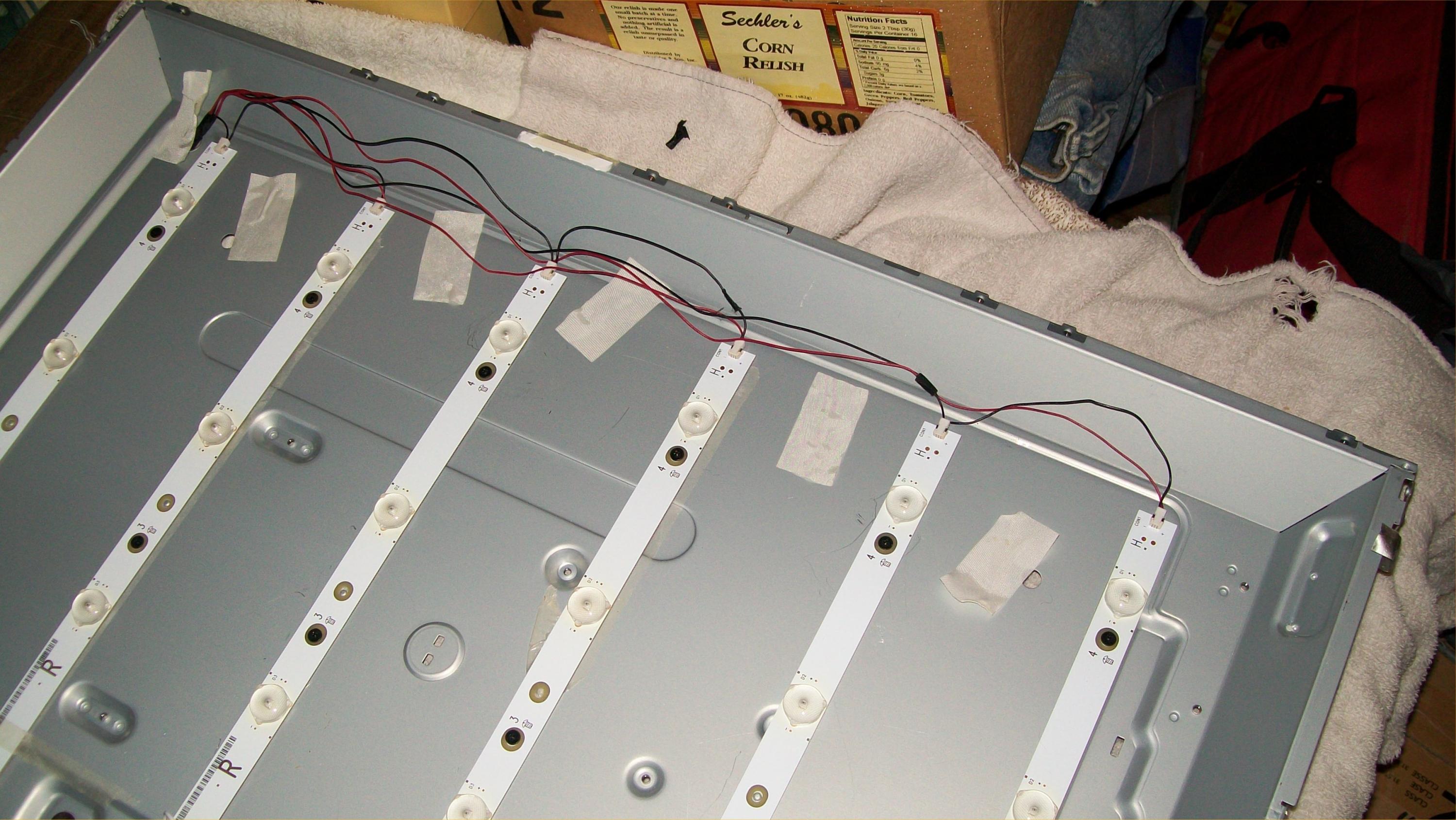

    Here are some pics with the tape removed from the wiring.
    thanks
      #42
      Re: Sharp LC-50LB370U Where to buy LED Strips?
      OK, I mark connectors 'A', 'B', and 'C' for you to test, we will test the LED string one at a time to see what you get.
      1) Leave connector 'A' in place only then power up the TV and then turn on the TV to see if you can see the BACKLIGHTS set 'A' will come on for seconds or not.
      2) Leave connector 'B' in place only then power up the TV and then turn on the TV to see if you can see the BACKLIGHTS set 'B' will come on for seconds or not.
      3) Leave connector 'C' in place only then power up the TV and then turn on the TV to see if you can see the BACKLIGHTS set 'C' will come on for seconds or not.

          I mark the location of the three connectors: one at location 'A', another one at location 'B', and last one at location 'C'. We are dealing with just 3 connectors only at 3 locations, the rest of the connectors that I did not mark the location will stay in place.
          So on the first test you leave the connector on location 'A' in place, remove the connector on location 'B' and at location 'C' then turn on the TV and see what happen.
          Second test will have connector at location 'B' back in place and remove the connector on location 'A', 'C' is already not in place, then turn on the TV and see what happen..
          Third test you will have connector at location 'C' back in place and remove connector on location 'B', 'A' is not already in place, then turn on the TV and see what happen..
          Basically we are testing each LED string (each string contains 2 strips of LED connected in series) one at a time to see which one will not come on for seconds when you turn on the TV.

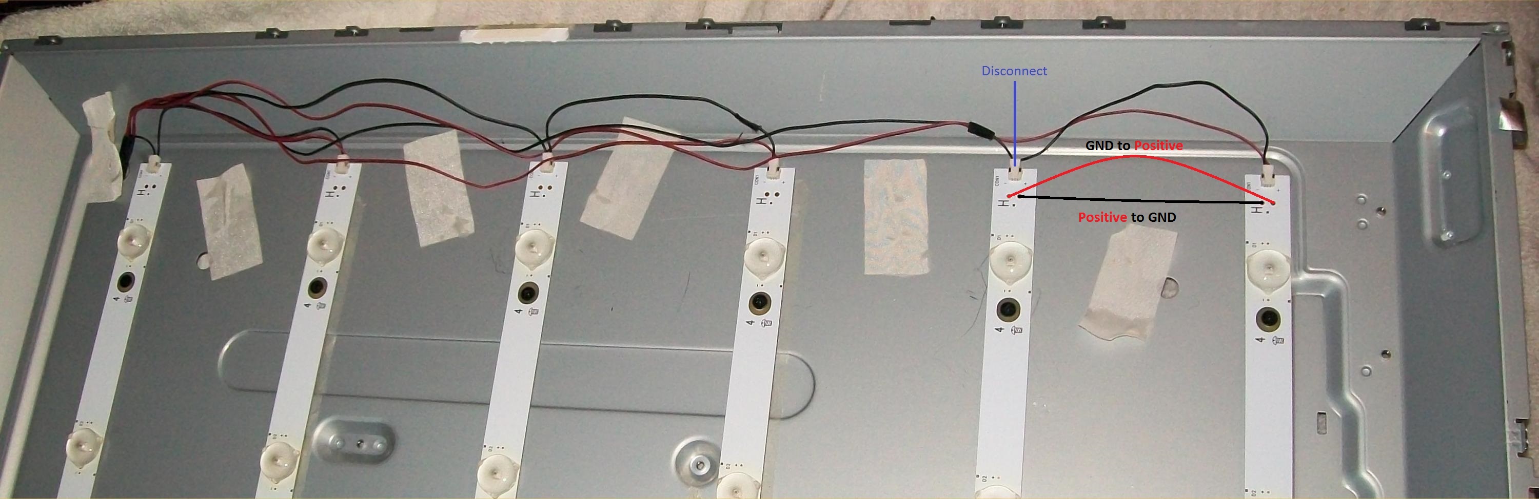

                            anyways how is the end of the LED grounded (the end of the strip)?
                            I think that could be my problem..Strip #6 had a bad LED on the very end and I tried to remove it with my heat gun and I did remove it but it was bridged and I didn't have any solder wick so I cut the strip off where the last LED is and soldered a replacement piece in place..I will show a pic when I get a chance.
                            Anyways I went from chassis ground to the - of the very end LED on 6 and powered on the TV..Strip 6 lit up but none of the others did..
                            thanks

                              You cut off the return wire by cutting the strip. The last led has a track leading back to the socket so it can go on to power the next strip.
                              At least that's what I think you're saying though it still doesn't account for why the other strips aren't lighting up.
                              How exactly did you wire the last led maybe you damaged your power supply ?

                                Run a temporary wire from the last led (-) to the black wire at the connector and remove the resistor. The bottom two strips should light up at least temporarily if the power supply is good.

                                    You have to follow the #52, that test will light up just string of the LED, the test will tell me if you have open circuit in that LED string or not, no need to cut or disconnected any connector.
                                    The LED returns go through the two IC's to GND on the board, So with the resistor in place we are letting the return current flowing through the resistor to GND.

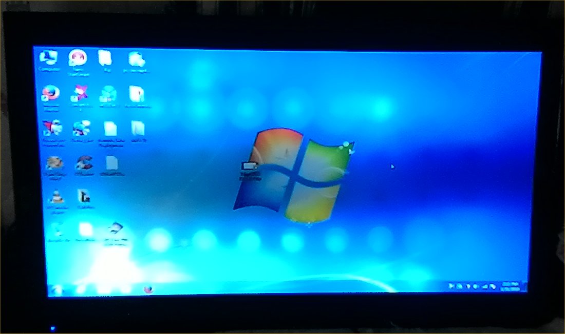

                                      Took me a while , but I finally got the TV working.
                                      mmartell: I used your suggestion and ran a ground wire from the last LED to the negative of the connector at the other end of the string and BINGO she worked.
                                      I also want to thank budm..you knowledge is invaluable.
                                      Thanks also to Reeceyburger..I used your stacking video on youtube as a guide.
                                      thanks to everyone else who has given help/advice.
                                      I still have a problem though. I think I mixed up the diffuser sheets..I should have taped them together in the corners with masking tape, but I didnt and they slipped apart when I was moving them.
                                      Anyway I now have white circles in the video (see attached pic)..If I recall there was 1 thick frosted white sheet 1 or 2 thin frosted white sheets and 1 or 2 thin clear sheets..Anybody know the proper order for diffuser sheets from the bare chassis to just before the LCD screen?
