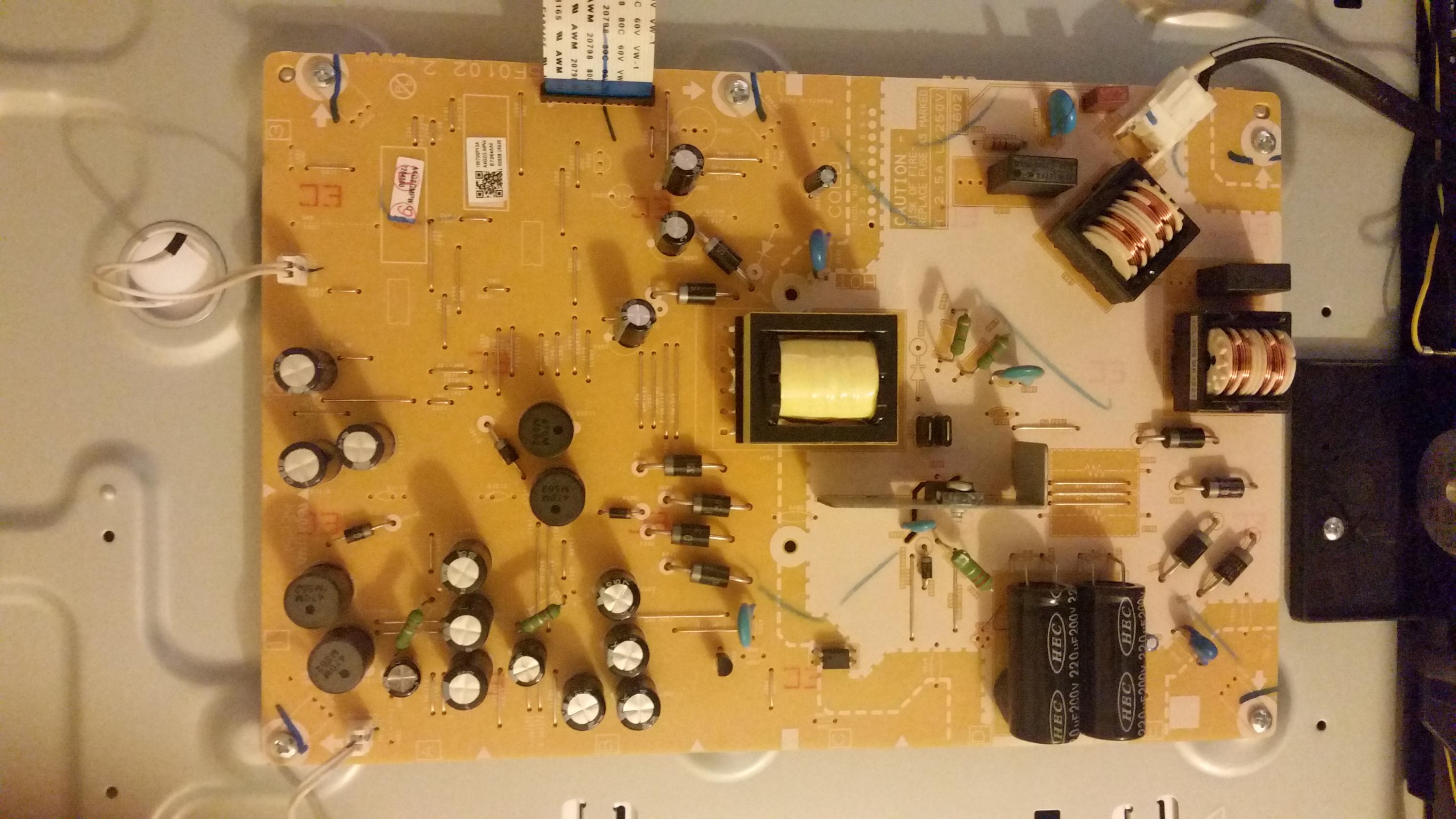

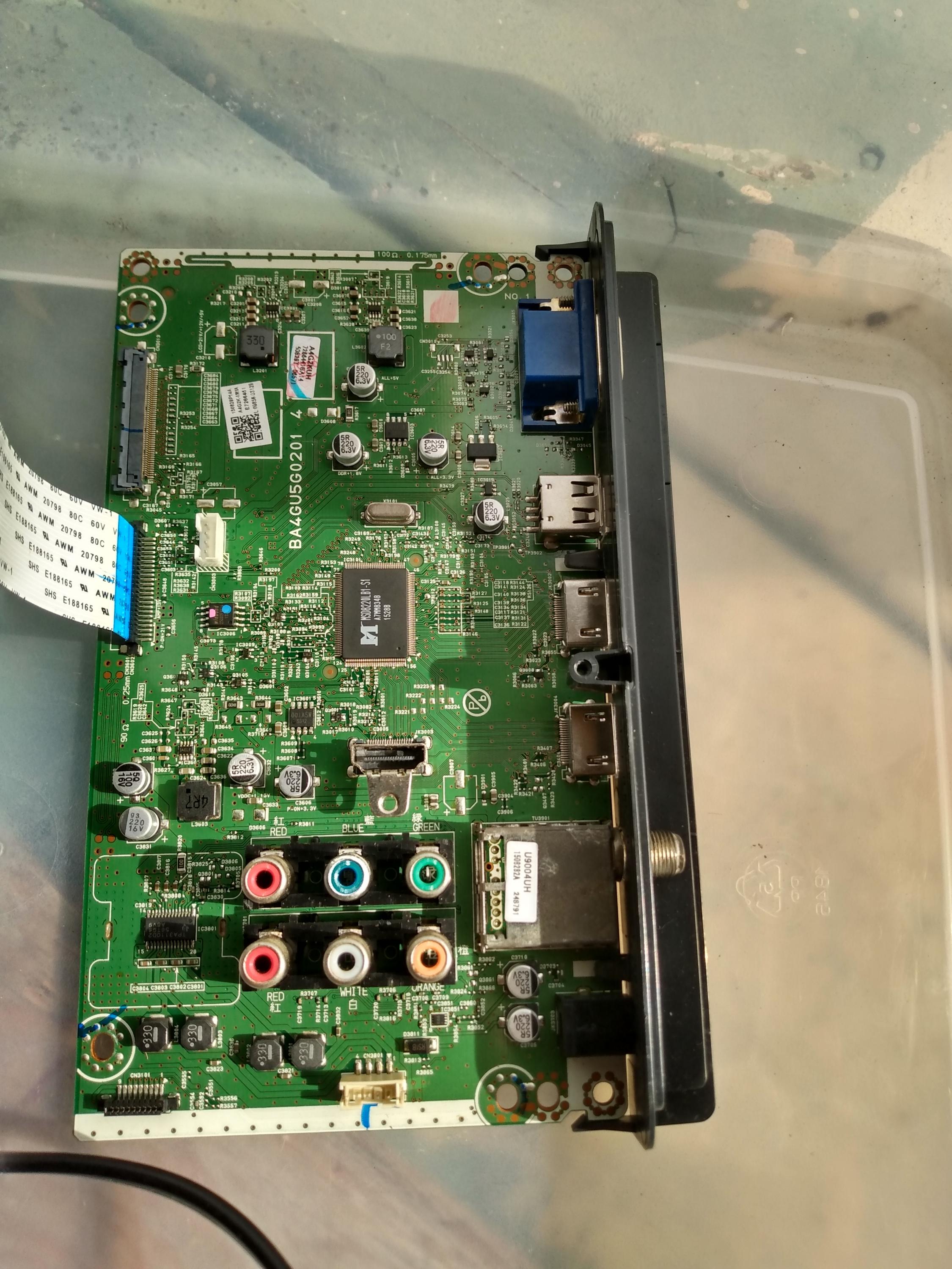

    Hello. I have an emerson model lf402em6f and it has no standby led and it won't power on. Is it possible that it's the EEPROM because I repaired a set that was plugged in the same (possibly bad) outlet and it needed an EEPROM chip. Also with this set, I don't see a legend or test points to test the boards to see which isn't working properly. Should I just assume it's the power supply since there is no standby led or does anyone have any experience troubleshooting this set, because it isn't like the sets I'm used to repairing. I've included pics of the board layout and closeups of the boards and connections. Any help would be greatly appreciated. Thanks.

    start with checking the STBY voltage on the PSU. If you don't get that, the main board will not turn on.
    EDIT: A bad EEprom will not cause the LED to be off. So either there is no STBY voltage on the PSU or the main IC on the main board is bad.

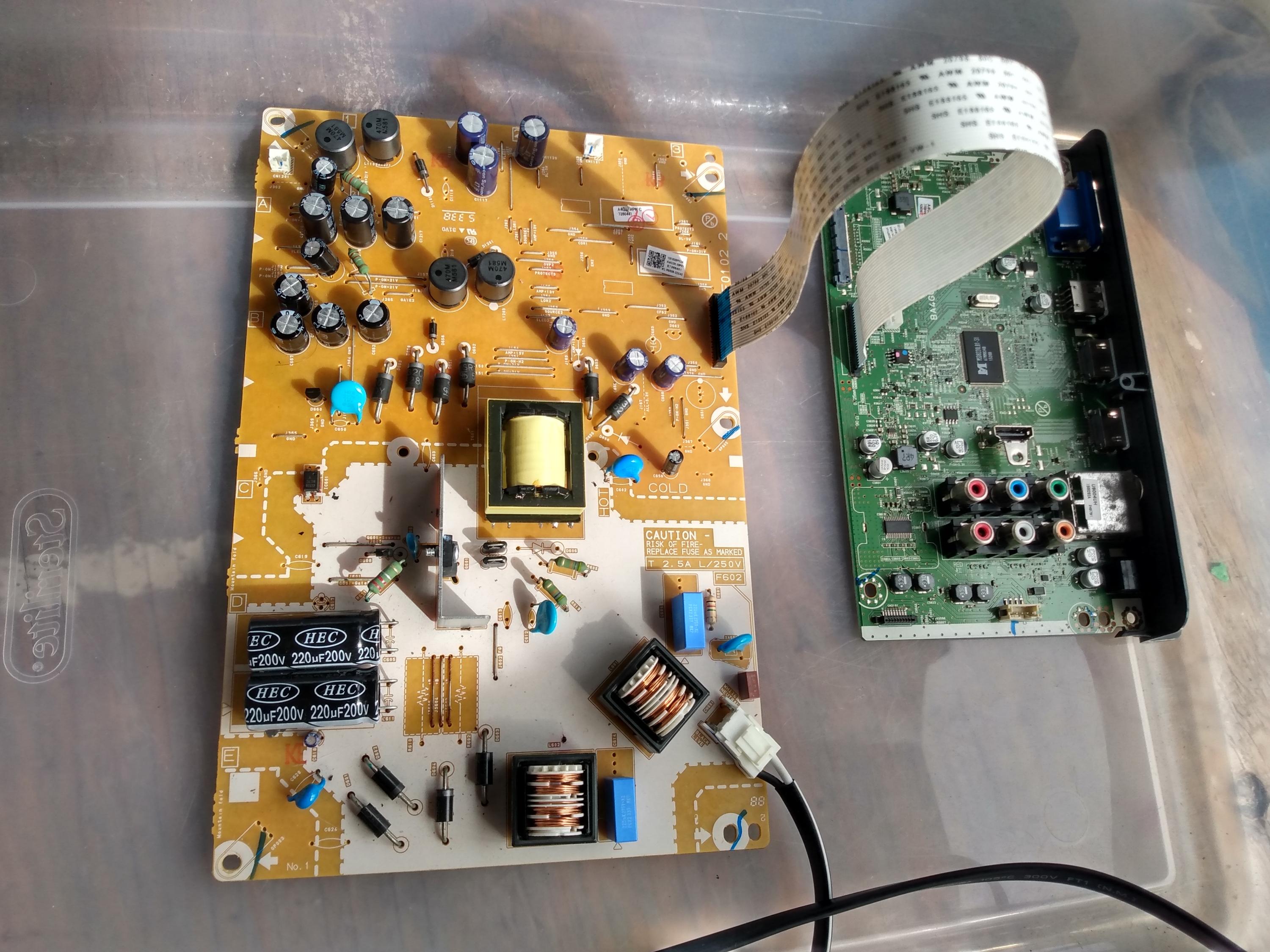

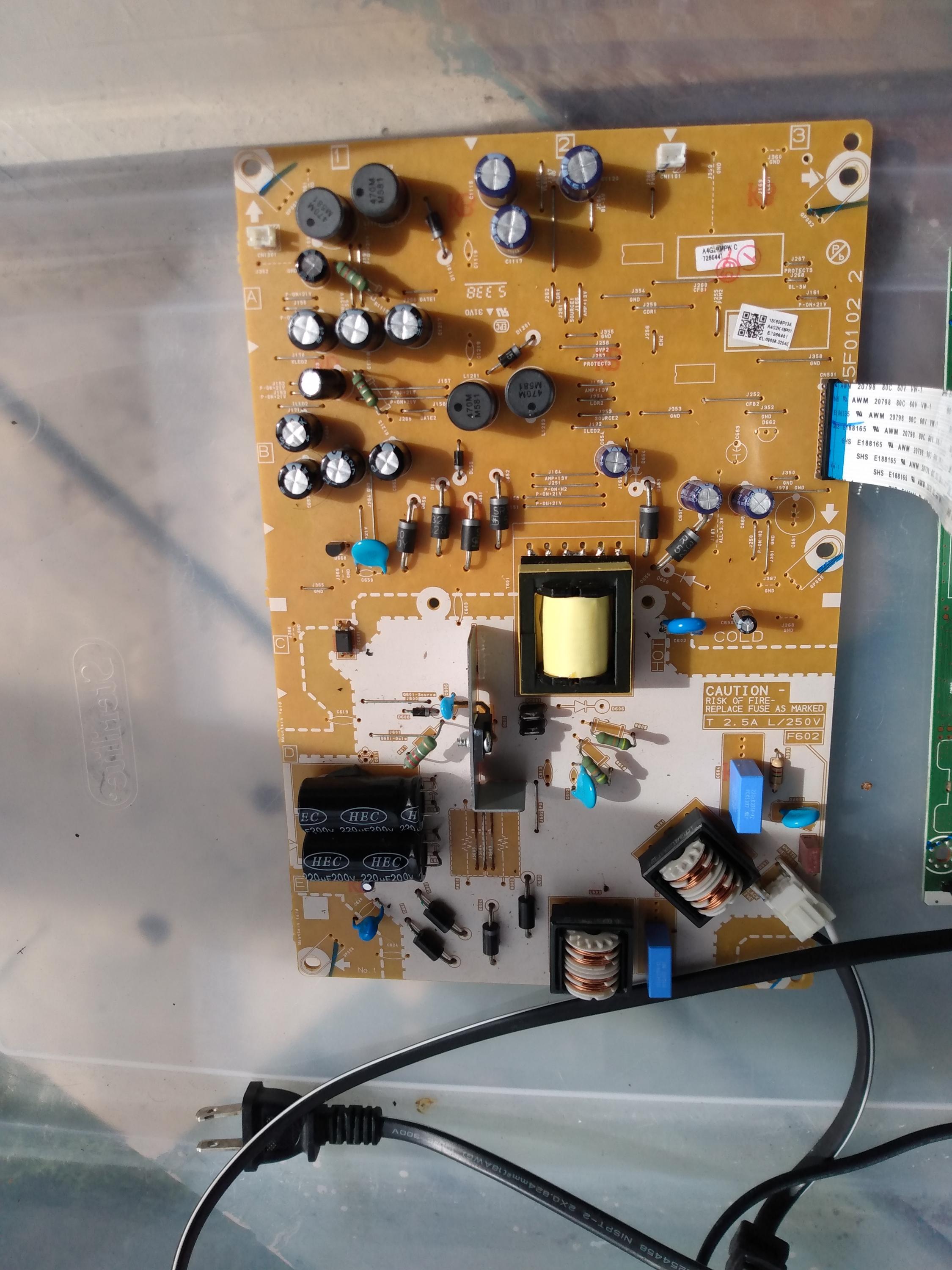

                i recently came across one of these Emerson LF402EM6F and am also puzzled by it. strange labels...connector that is hard to probe so you have to probe the jumper wires where the labels are.
                the symptoms i have are this:
                when connected up normally, you can hear a whine coming from the PSU.
                no standby light comes on.
                no response to power button or remote.
                when power supply is alone it is quiet.
                i want to make a positive diagnosis whether it is main board or power supply.
                leaning towards power supply.
                markings on board are strange compared with other brands.
                the label P-ON+21V seems like it might be a typo and should say
                P-ON+12V
                but who knows?
                no clue how to "trick the PSU" to turn on without the mainboard.
                usually we connect 5v standby to PSON thru a 1k resistor.
                but there is no 5v standby that i can find.
                there is a label marked
                ALL+3.3v which may mean "always on 3.3v" which could be the standby
                but it reads -8.02v when mb is disconnected. i can only find that label on the board in one place
                and it appears to be connected to what would be a jumper wire but there is no jumper wire there.
                this voltage rises to -0.29v when mb is connected.
                there is another rail labeled AMP+13V which...again no idea what it is... reads 8.2v alone and 0.95v when mb is connected.
                voltages:
                label: alone / with MB
                ALL+3.3v= -8.02v -> -0.29v
                P-ON H2= 0 -> 0.04v
                AMP+13V= 8.20v -> 0.95v
                Protect3= -0.07-> 0.02v
                OVP2= 4.56v-> 4.44v
                BL_SW= 0 -> 0.03v
                VLED1= 12.45V-> 12.19V
                VLED2= 12.45V-> 12.19V
                LDR2= 0 -> 0
                SOURCE2= 0 -> 0
                ILED2= 0 -> 0
                CDR1= 0 -> 0
                PWM1= 0 -> 0.03v
                P-ON+21V= 12.69V -> 12.14V
                PFC(big caps)= 167v -> 154v
                PFC seems low. not getting boosted. not fully turning on.
                seems like P-ON H2 might be the switch to turn the PSU on...should i just inject 5v to it?
                and while im at it, to BL_SW as well?
                any ideas?

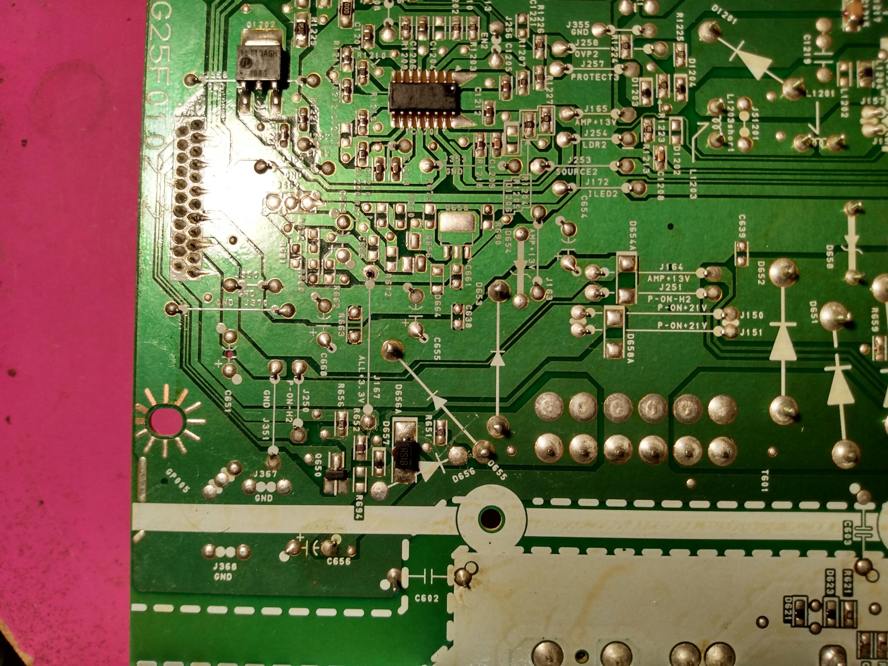

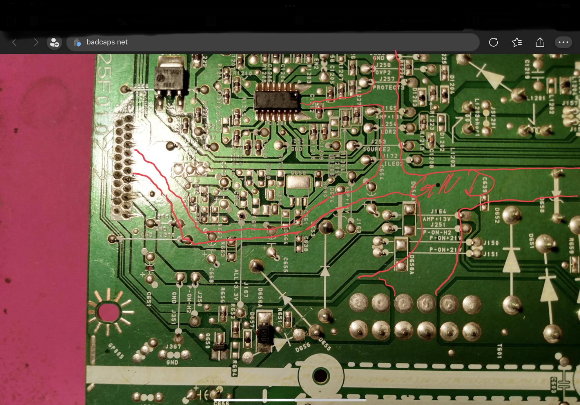

                                i rechecked it and for sure its -8.something volts when just by itself. i am using cold side ground. one of the many jumper wires that say ground, and also i used the area around the screw just to be sure and same reading. i traced it to pin 8 on the connector that goes to the mainboard. well pin 8 depending on which side you count from. there is no indication. anyway i dont see a short on that pin to ground when i test mainboard by itself. i see 560 ohms or so. is that about right?
                                i will try tracing that 3.3v rail backwards...will post a picture with drawing on it or something.
                                Don't fear the repair...
                                • triplefour
                                  • May 2014
                                  • 1747
                                  Re: Emerson LF402EM6F NO STANDBY, DEAD SET!!! HOW DO YOU TEST FOR VOLTAGES!!!

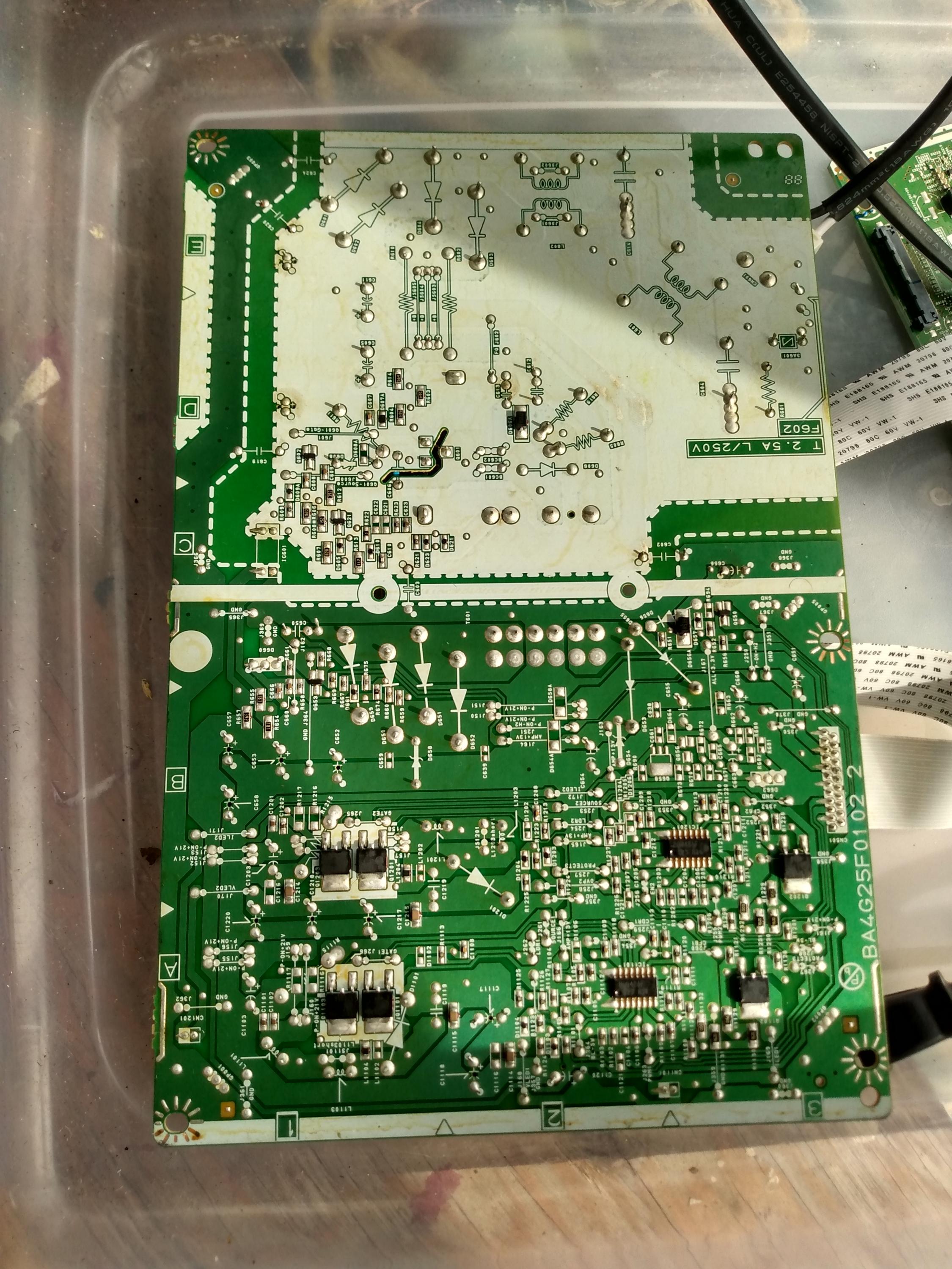

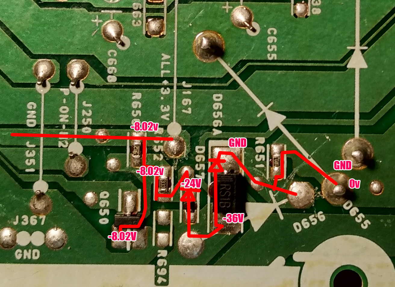

                                  the "ALL+3.3V" line goes from the connector (pin 8 i say)
                                  to this point where there could have been a jumper. but the jumper is missing. and there are missing components all around
                                  where the jumper would have led to. so it doesnt come from there. or go to there...
                                  the only thing it can come from then is thru the smd resistor marked 912 which is 9100 ohms. it reads fine.
                                  next resistor it goes thru is labeled 333 which is 33000 ohms and that also reads ok
                                  i have attatched a picture that shows tracing and voltages observed. this is of course with psu by itself.
                                  not sure what to make of it.
                                  all the pins on that side of transformer are shorted to ground. that cant be right can it? then where is any of the voltage coming from?

                                  • diif
                                    • Feb 2014
                                    • 6978
                                    • England

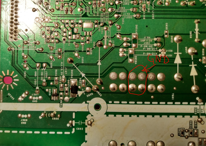

                                    Are you using the ground marked on the PCB ? you have marked two GND points but i don't think they are correct.
                                    • lotas
                                      • Jan 2016
                                      • 4905
                                      • Russia
                                      That's where GND, (-).
                                      • CapLeaker
                                        Leaking Member
                                        • Dec 2014
                                        • 8352
                                        Wrong GND. Try this. Didn’t see lotas post, but it’s the same thing.
