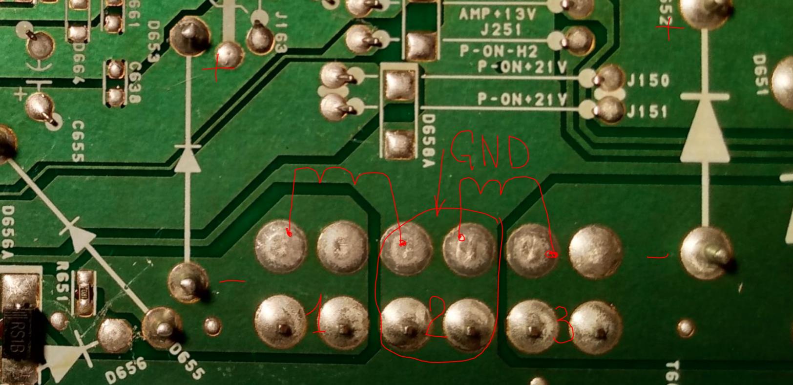

    ok well what im saying is all those other pins of the transformer are shorted to ground then. and im guessing they shouldnt be!
    i am using as ground reference the ground screw, and the jumpers that say ground. im not sure how i could be getting that wrong.

      If the middle point (2) is connected to GND, then pins 1 and 3 will show on the multimeter that they are also on GND, as it is not clear here.

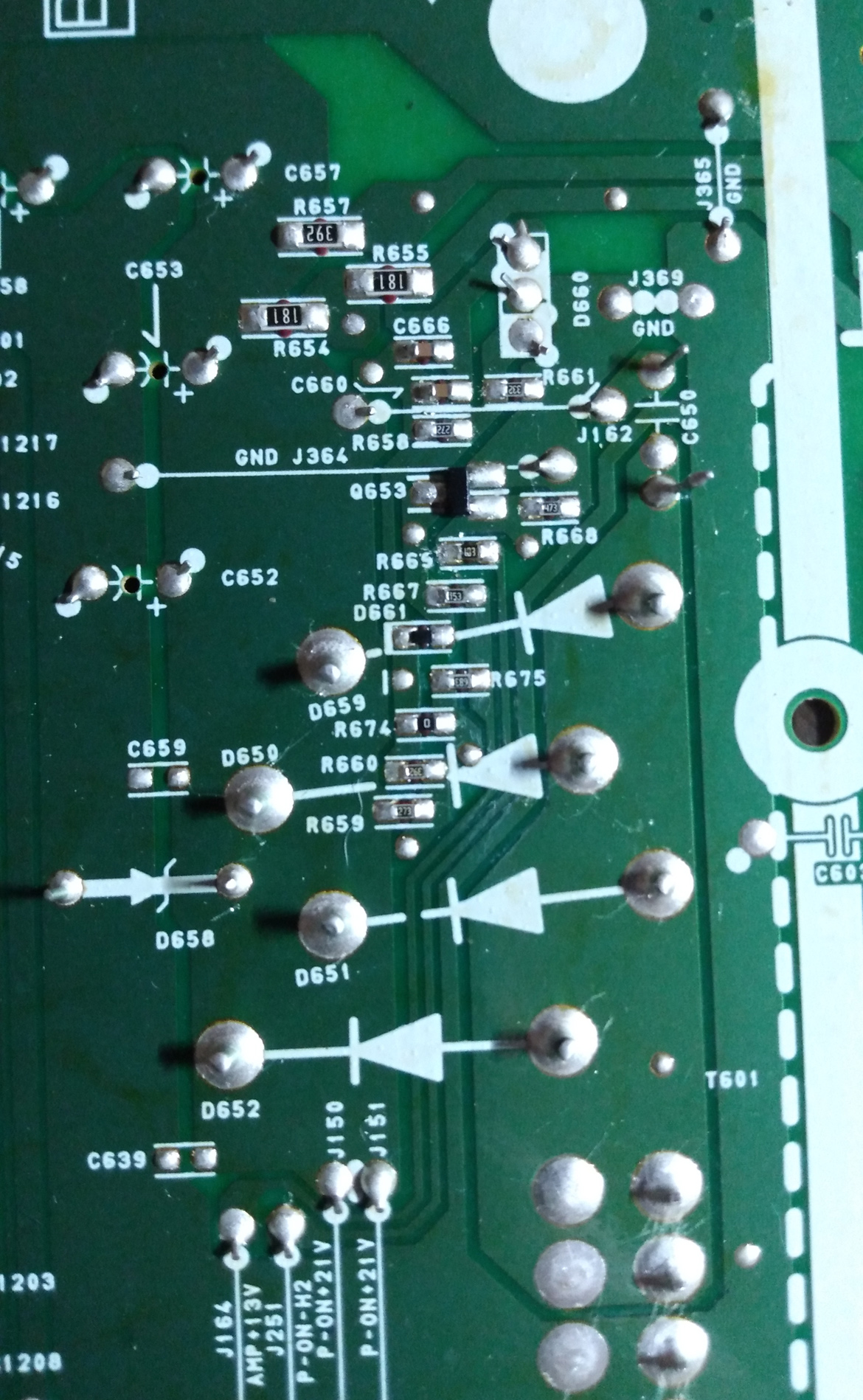

        You are measuring the DC resistance of the transformer winding, This is normal. According to your voltages that you measured (post#8), the power supply is working and is in standby that is why the voltages are low, this is an always on power supply. and it does not have a PFC circuit, or a 3.3volt circuit.
        Check the value of the resistor R669? (post its value) this is the series resistor in the P-ON-H2 line.
        Depending on what R669's value is, you should be able to trick the power supply on by using about a 5k resistor between Either the P-On-21 or AMP+13v and the P-ON-H2 line. The P-ON-H2 is the power on line.
        When you connect the main board you say the voltages drop to near 0 volts, I suspect you have a short on the main board, likely one of the regulator ic's (ic3201,ic3604) killing the +21v or the audio amp ic. killing the AMP+13V
        Disconnect the lvds cable CN3013 going to the panel in case the panel has a short and is killing the voltage

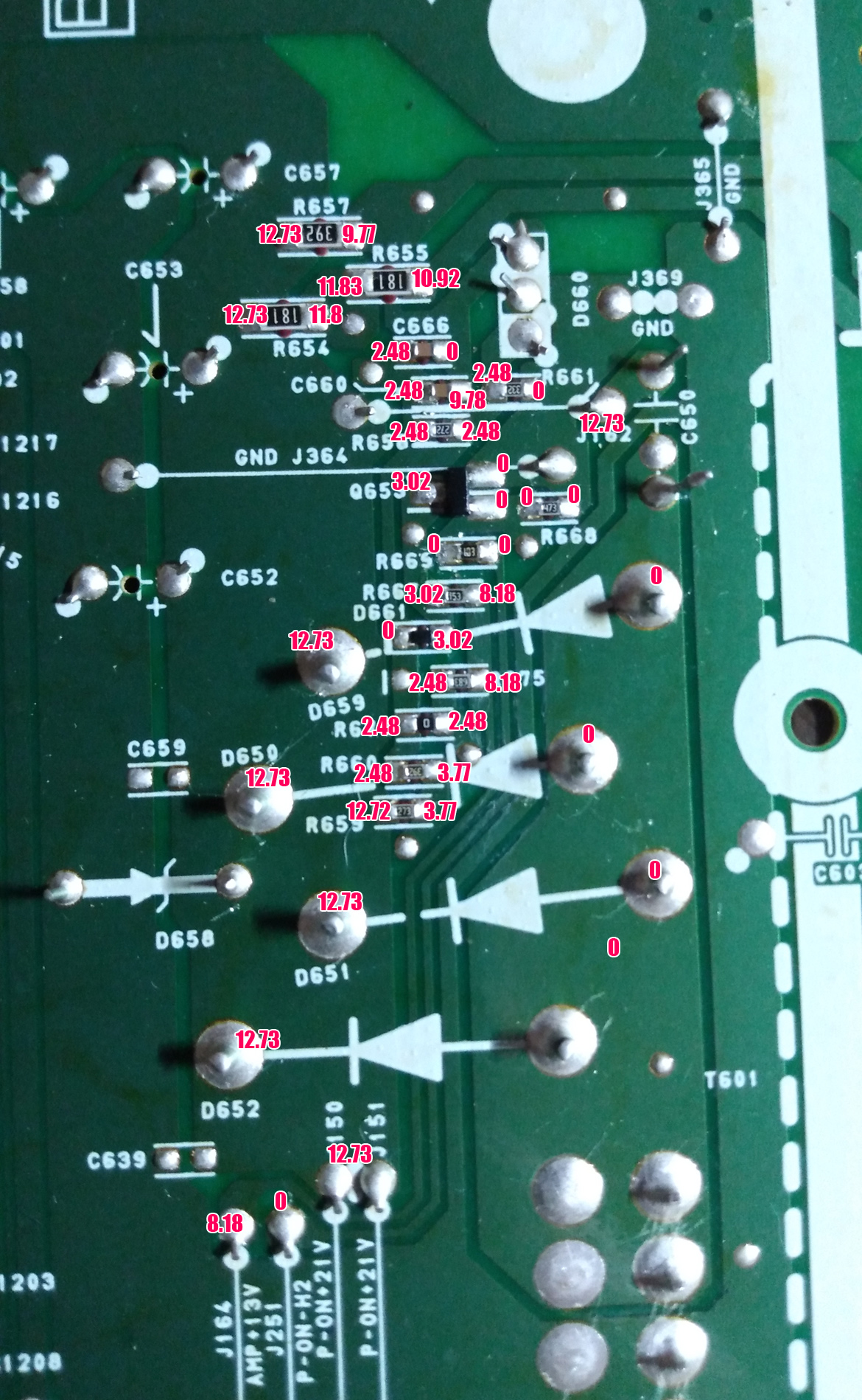

            here are the voltages in that area. i didnt see a R669 but maybe its the R665 that looks like it. that one is in series with P-ON-H2
            r665 by the label 103 is a 10k resistor and measures about 9.8k
            these measurements were taken with power supply only.
            in the other case with the mainboard connected i have only the power supply and mainboard connected in that equation. tcon was not part of it.

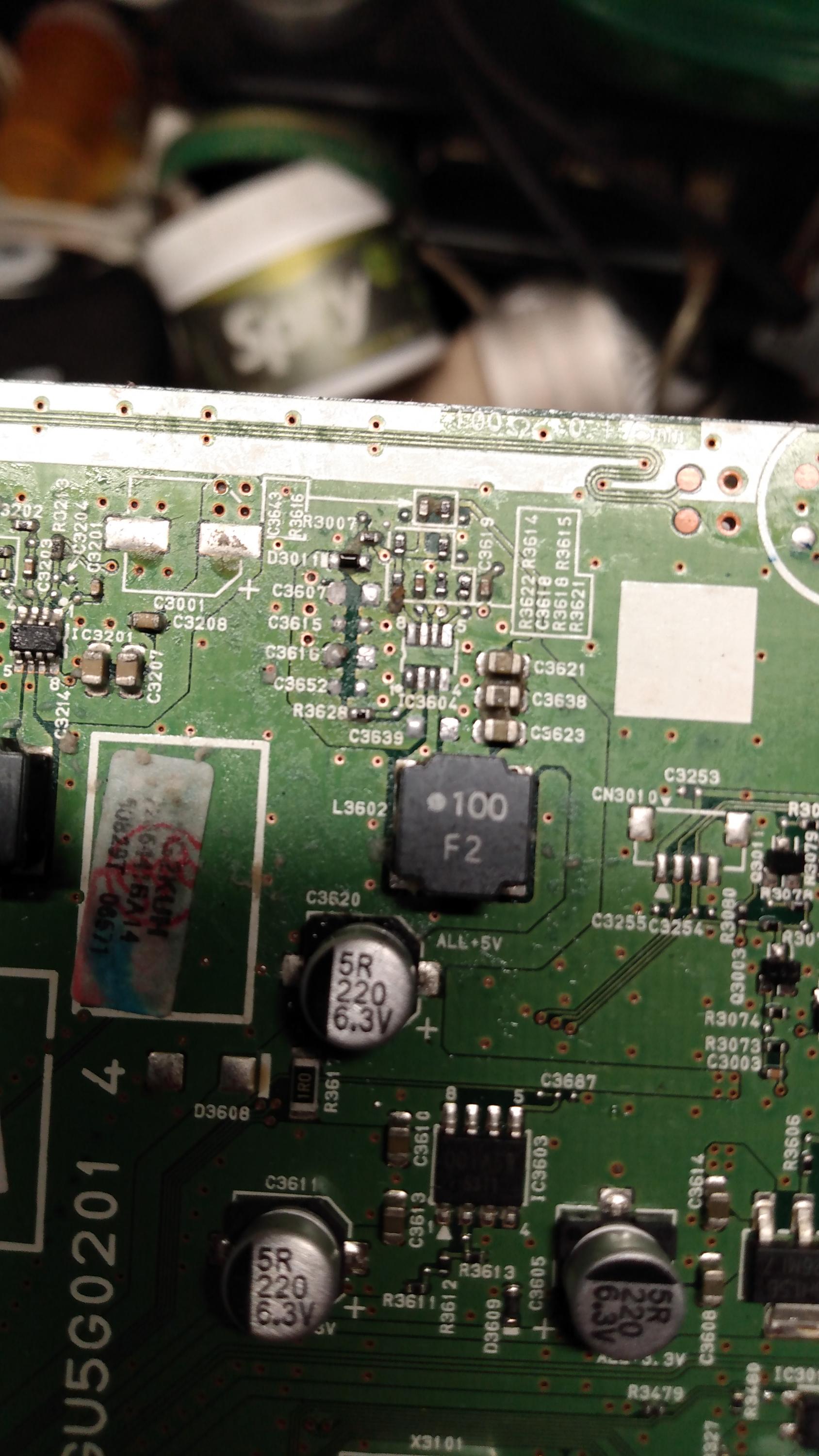

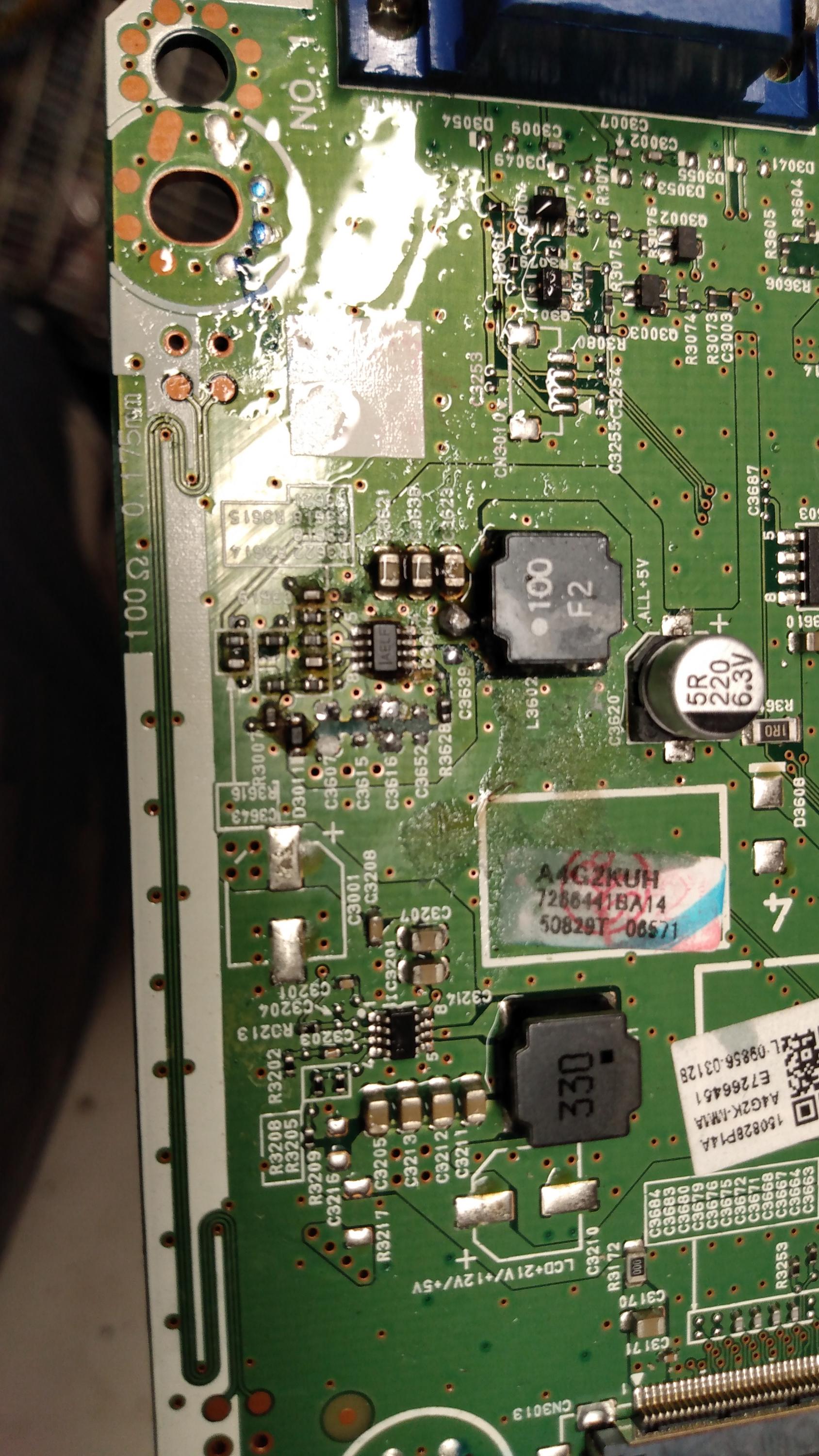

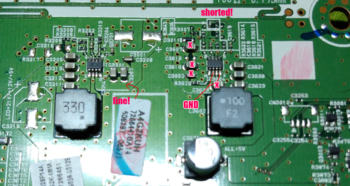

              so i went looking around those IC's you said to and i noticed one of them had a bunch of shorted caps (appearing shorted anyway) around it.
              IC3604 also has 2 pins that are on ground. that may be normal or it may be one of them is shorted?
              seems this would definitely be a problem. still need to verify if the PSU doesnt also have a problem tho!
              Oh also I noticed that the amp 13v pins on the main board connector are shorted to ground so yes definitely have main board problem.

                I would remove a cap and recheck it and other 2 for short, if short is still present after removing all 3 caps, the IC is probably bad and causing the short.

                  IC3201 is a MP1472, I think IC3604 is a RT8293AL, if that is the case the shorted caps are on the ic's VIN, this service manual might be close enough

                      ok so i started removing caps. none of them removed the short. actually its not a dead short from amp+13v to ground, it reads 1.6ohm on my meter which i guess is about 1.2ohm given the resistance of the leads. but anyway that is low enough to make the meter beep in diode/continuity mode so thats why i thought initially the caps are shorted.
                      anyway i removed all the caps and then eventually the IC as well and i still have that 1.6ohm resistance from amp+13v to ground.
                      i cant see any other components it goes to but then again...vias....could take things places...
                      could be an internal short inside the board?

                                  OK I connected the the P-ON-H2 line to the P-ON-+21v and the voltages come up as expected. I get the 22 volts and the 13 volts stable. But I am only getting around 23 volts at the Led connectors and testing with my LED tester I see that the strings take around 45 volts to light up. Is there some other thing I need to switch on on the power supply to give full current to the back lights? I don't see a backlight enable pin or anything like that so I'm kind of lost again.
