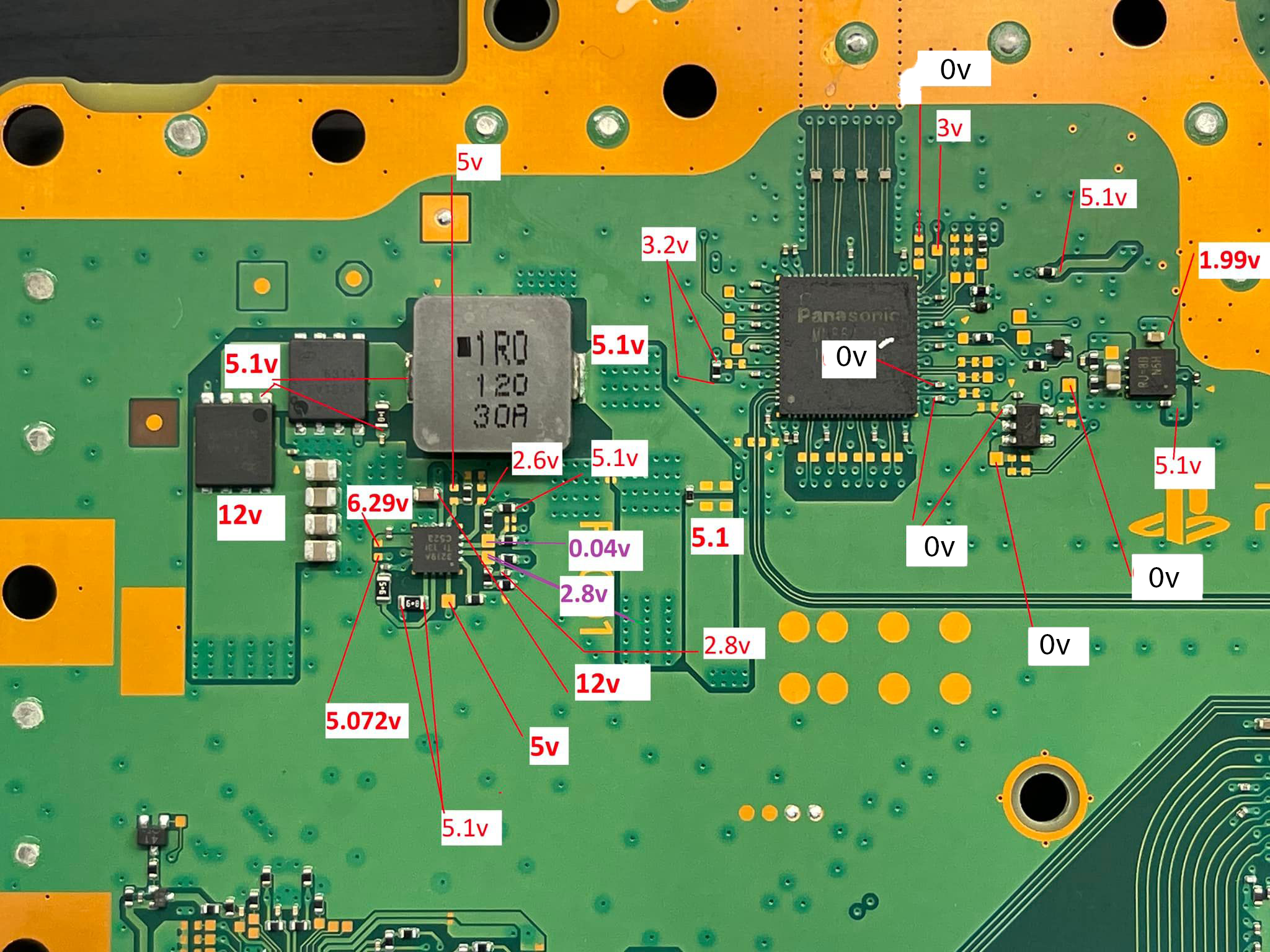

    Ps5 with bad standby voltages
    I have a few standby voltages that are 0, as seen in the picture. Is the Panasonic chip broken? In the picture I have all my voltages.
