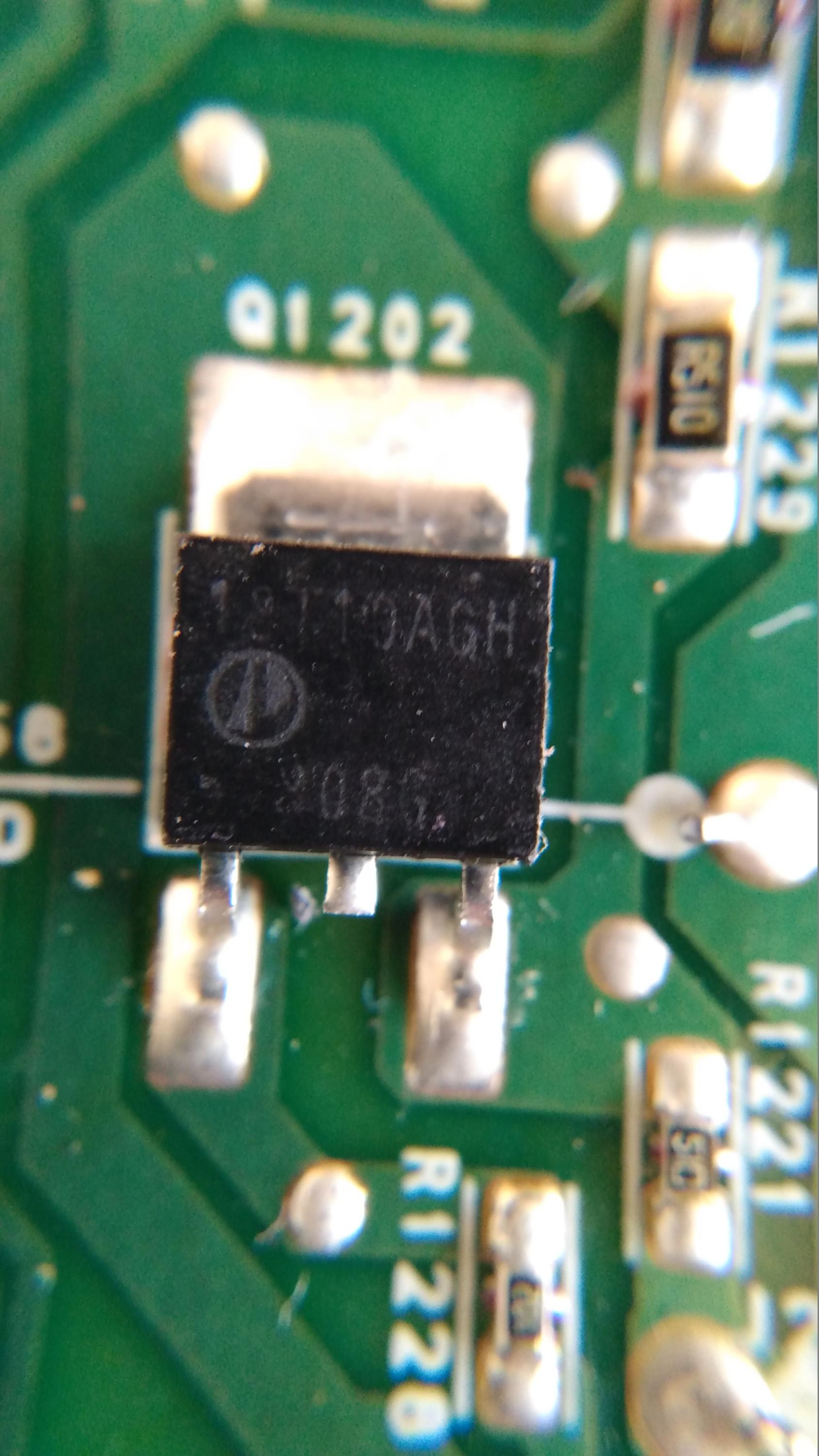

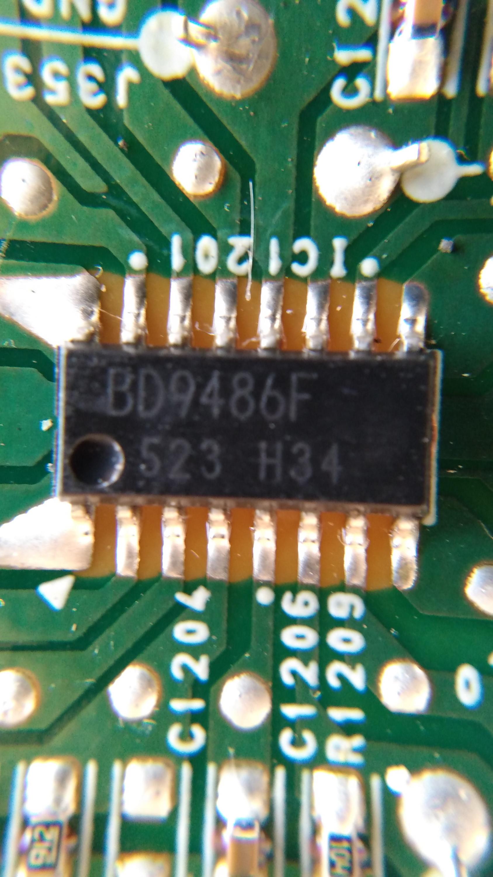

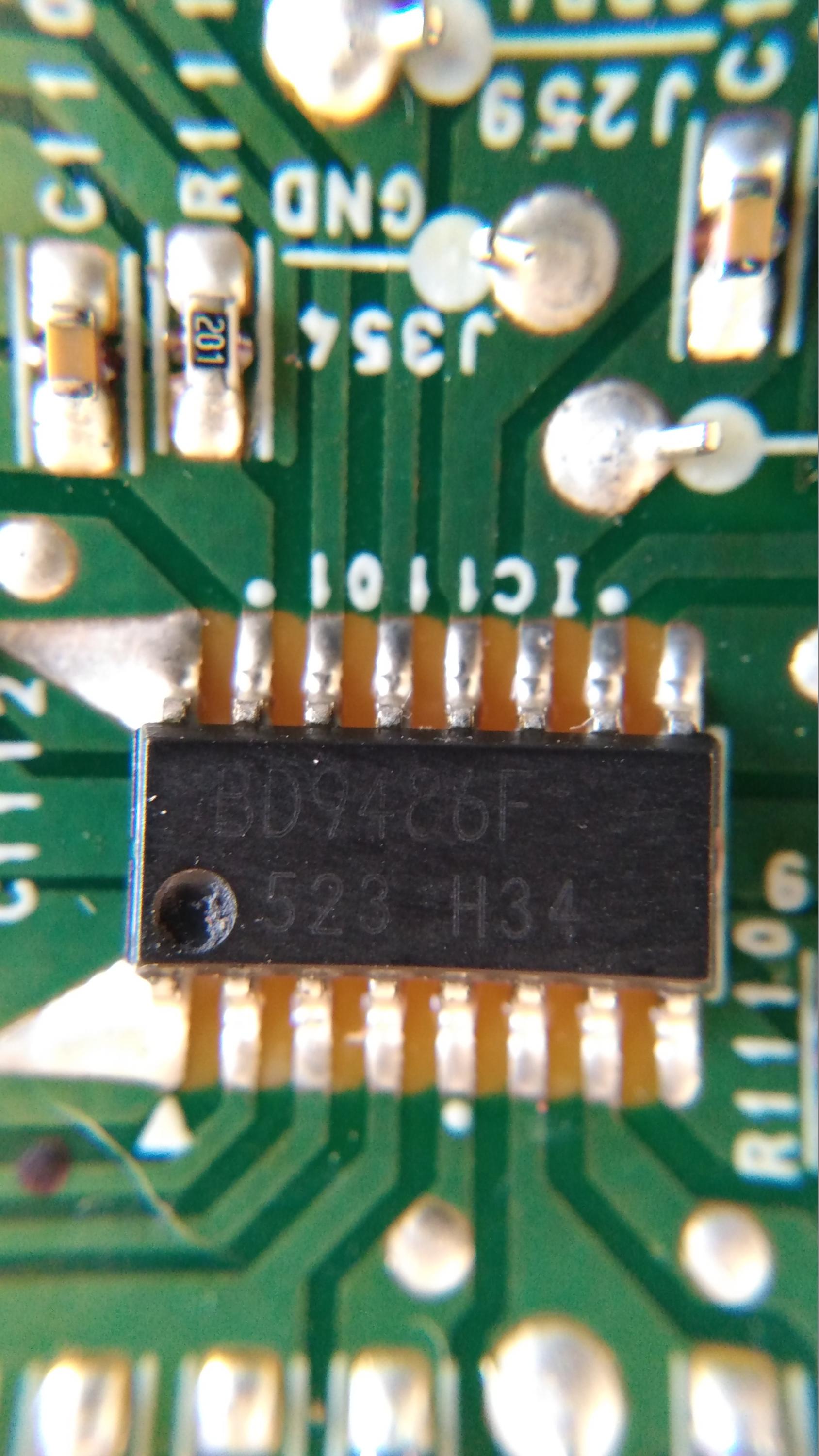

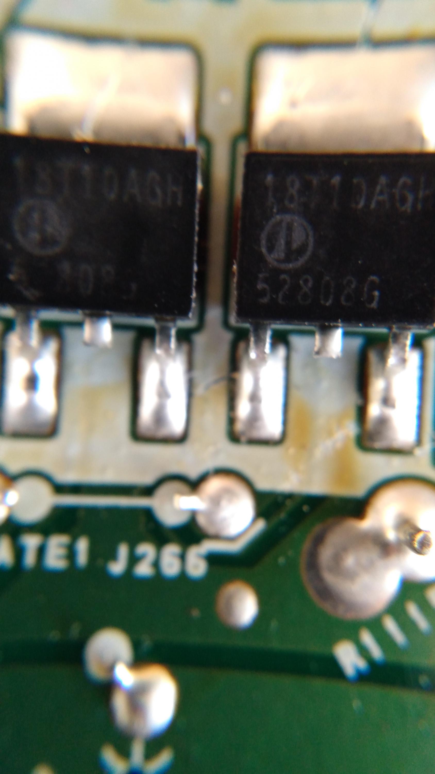

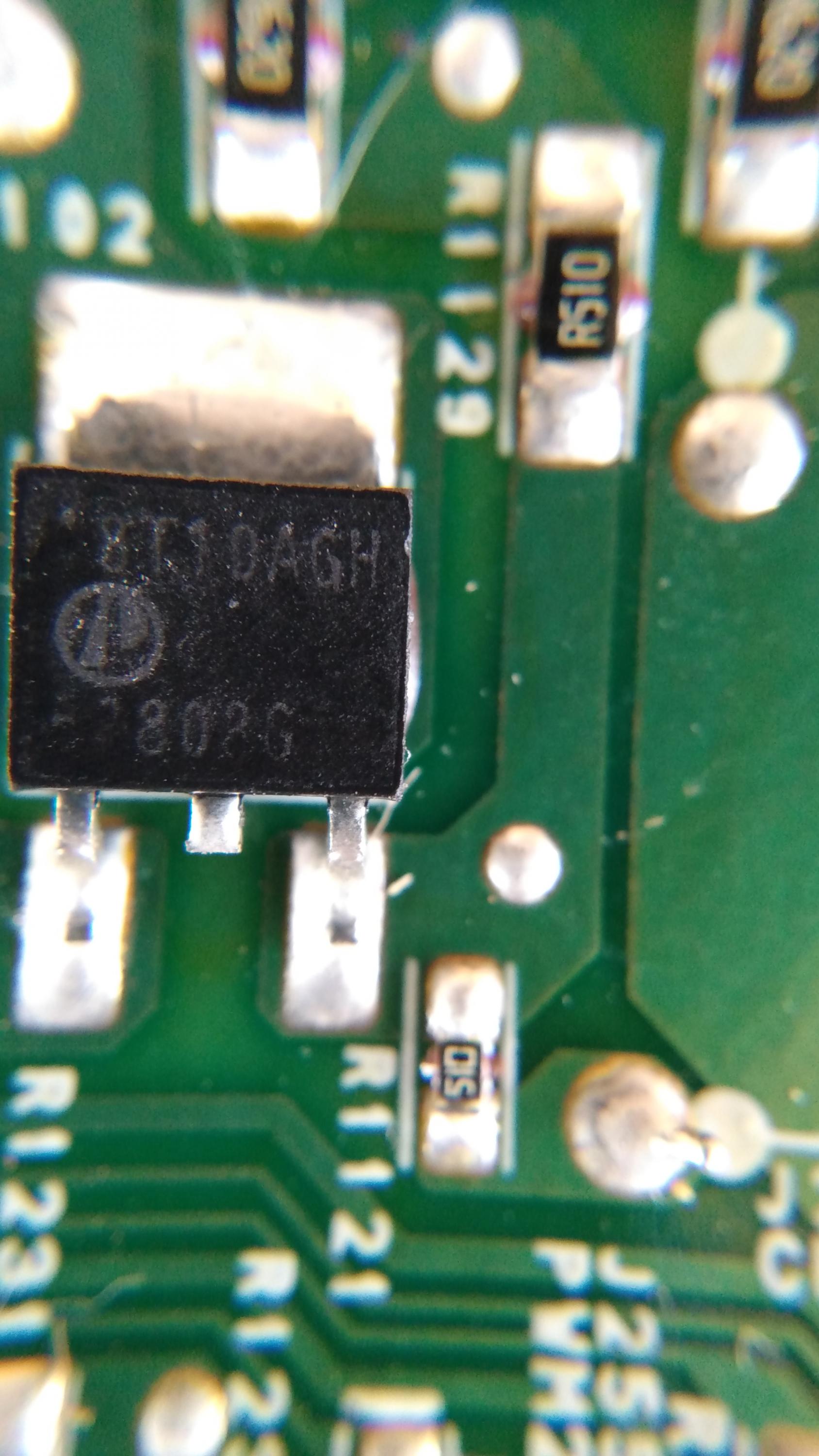

        they use two the of the same IC and 6 of the same mosfet
        vled1 and 2 i get 22v, on iled 1 and 2 i get 0v.
        this doesnt change whether or not i have the 3.5v on BL_SW
        IC1201
        BD9486F
        523 H34
        IC1101
        BD9486F
        523 H34
        Q1202 AND OTHERS
        18T10AGH
        52808G

          Datasheet says pin 2 is the STB pin which turns the ic on or off. It says voltage there can be max 20v. I tried 5.25v and still no change. Kinda not sure of myself here to go higher ...

              i probed the pins on those 2 ics and have readings here. seems we have VCC and STB but not much else going on....
              i cant see in the datasheet where it says what STB should actually be other than it cant be over 20...
              1 REG50 ----> 4.9v
              2 STB ----> 5.5v (im injecting this)
              3 OVP ----> 0.7v
              4 UVLO ----> 3.6v
              5 SS ----> 0
              6 PWM ----> 0
              7 CP ----> 0
              8 ADIM ----> 0
              9 RT ---->1.9v
              10 FB ---->0
              11 ISENSE -->0
              12 GND ---->0
              13 DIMOUT -->0
              14 GATE ---->0
              15 CS ---->0
              16 VCC ---->12.2
