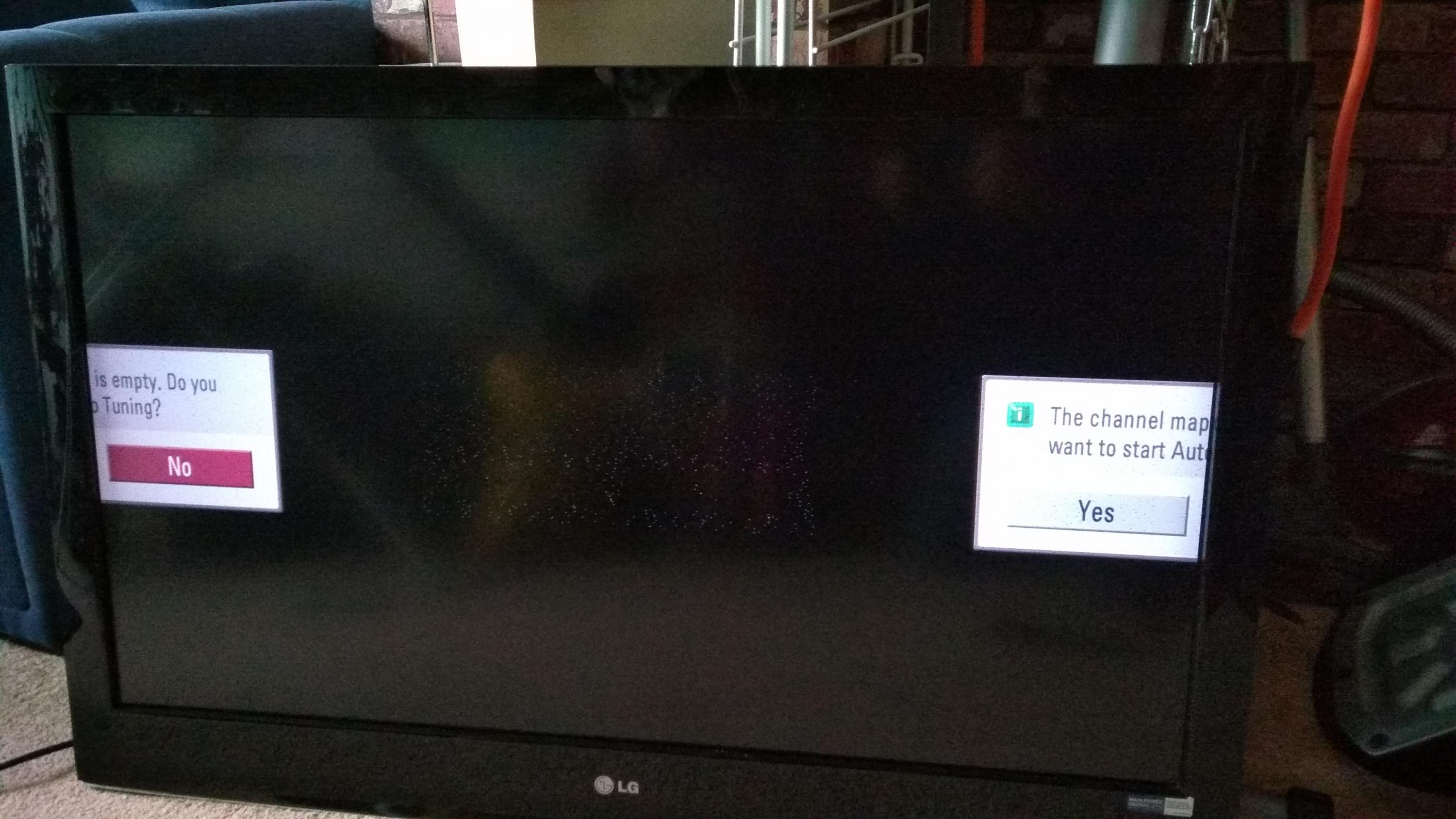

    Hi guys. I have got a bad picture on my LG 42LH3000.
    Was no picture at all. Just replaced t-con board and have this issue with the picture. Is that means bad t-con board or something else?
    I added pics here bought of t-con boards. One was with no picture at all and another (replacement board) with a bad picture.
    Thanks to all in advance for any help.

    The two boards certainly look identical. Did you check the fuse F100 on the no picture tcon?

      Yes, I did it. The fuse is OK.

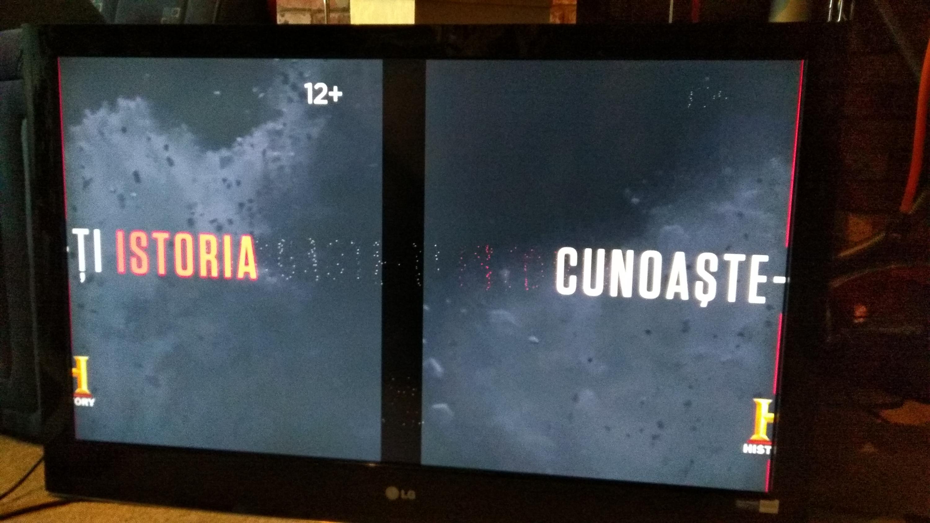

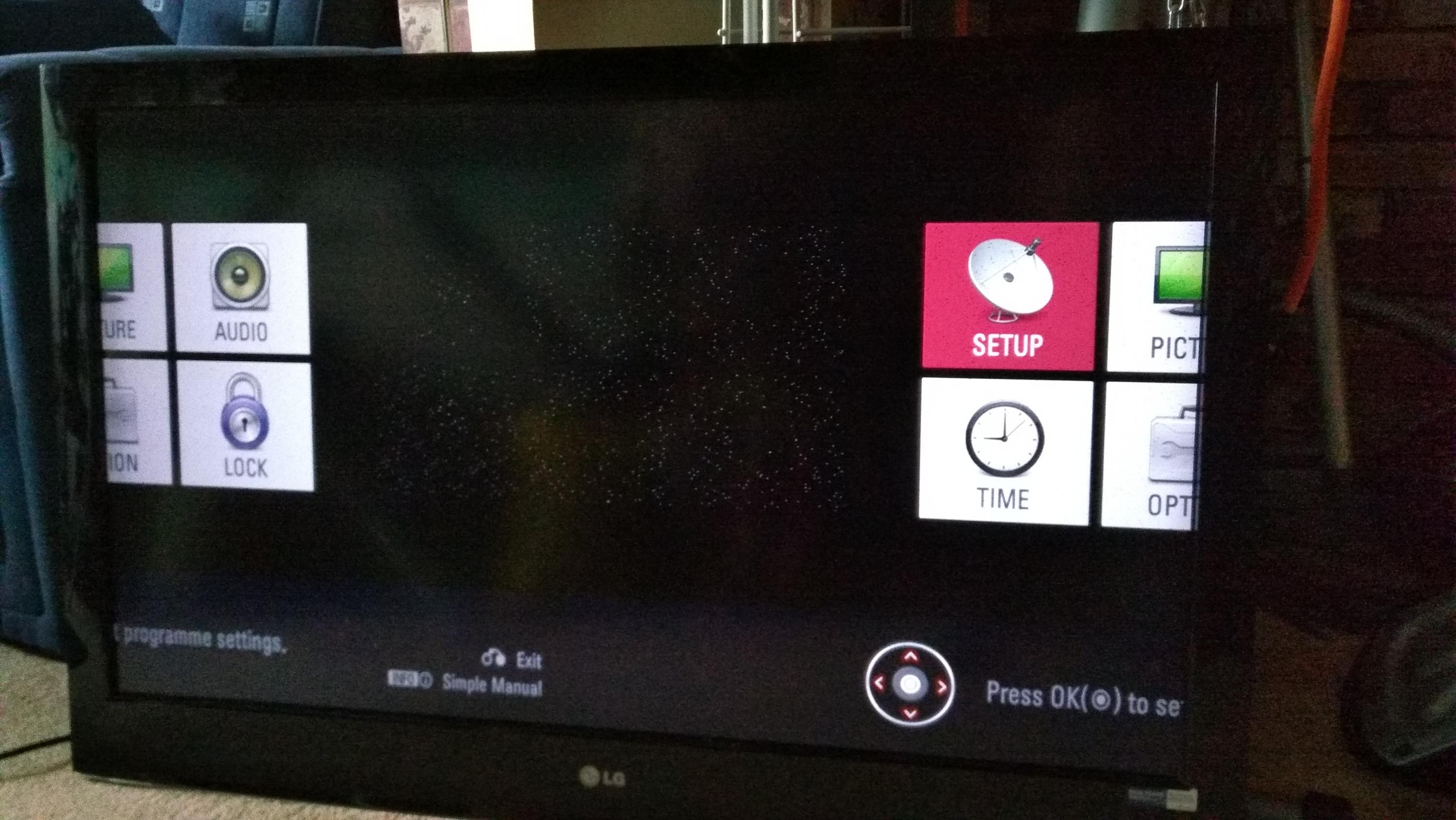

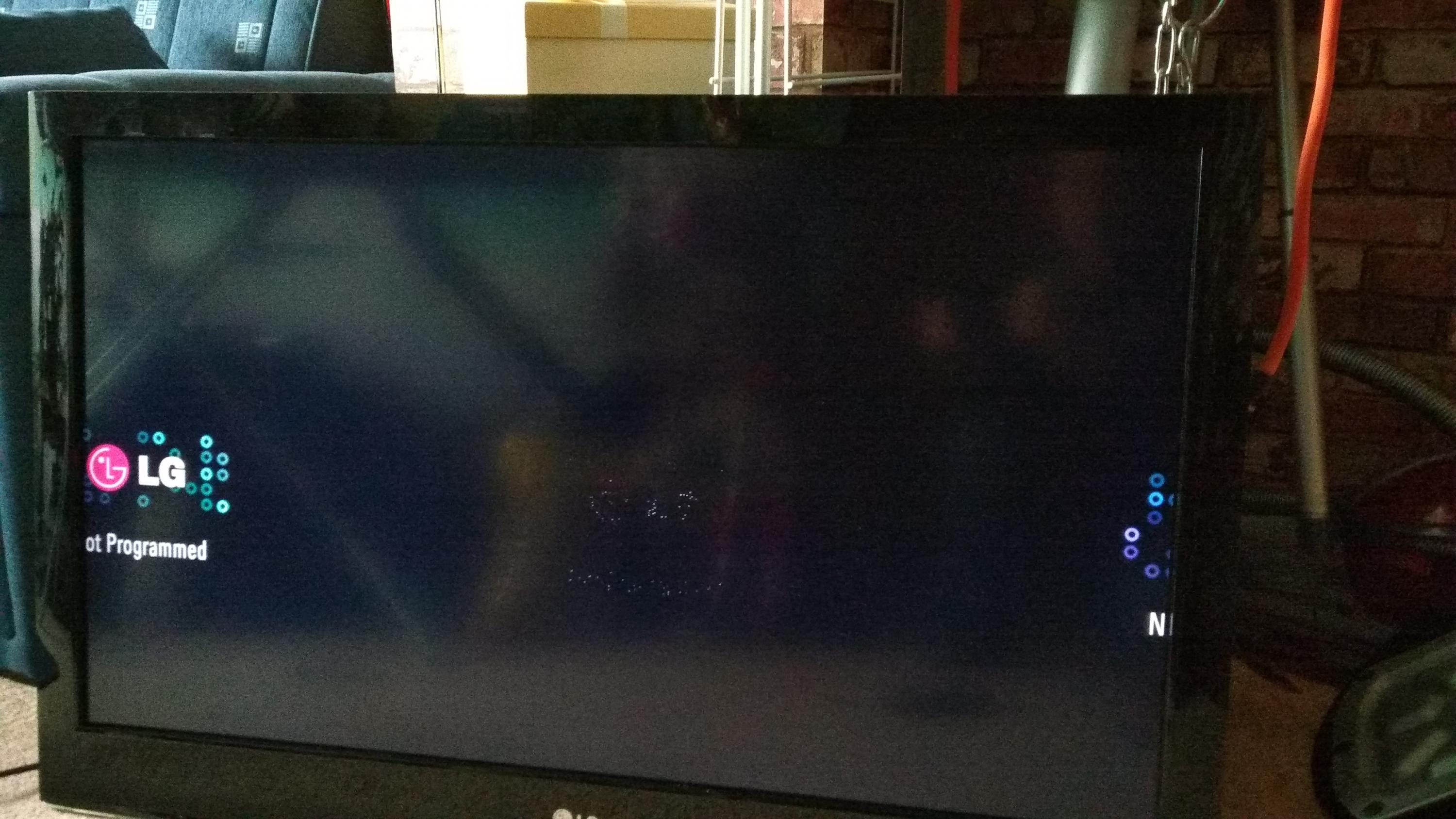

                        All checked and cleaned one more time. The picture still split into two parts (the sound works well)
                        Any ideas, please?

                          Re: LG 42LH3000 Bad picture after T-con replacement
                          https://www.badcaps.net/forum/attach...0&d=1507893637
                          Both PCBA use the blank board.
                          Your original board is RUNTK 9YA47
                          The replacement board is RUNTK 9YD01
                          The barcode sticker on the bottom left of the board is not the same. You may want to scan that and see what it shows and do more research about the boards. It looks to me that replacement board is not compatible.
