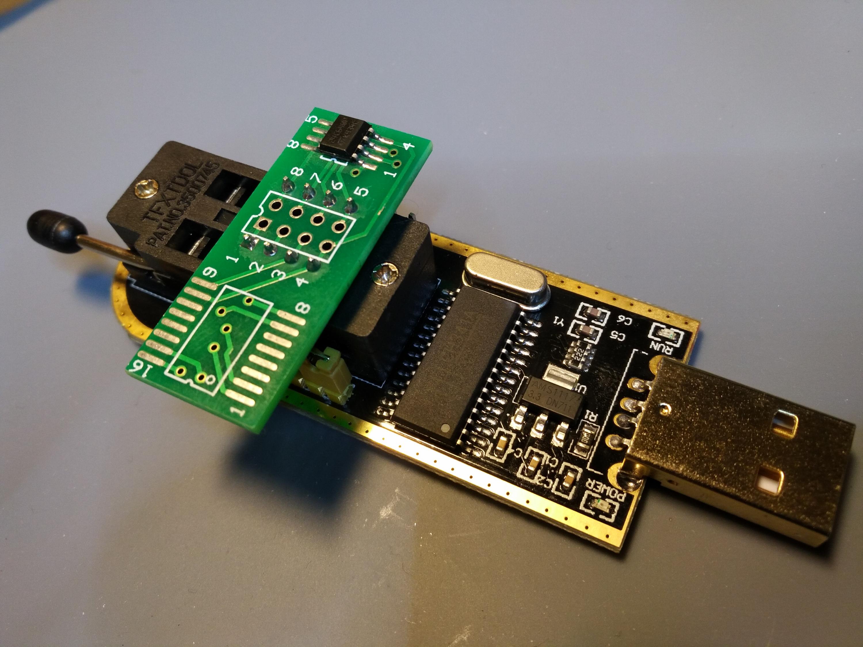

      I'm sure you can whetehr that fixes it or not? If you want to return the board I would not , best thing I've purchased and very cheap, eeprom read / writer.
      perfect for this situation, copy contents of both and save, transfer the data from the donor. No physical removal of the chip.

        Thank you for your opinion. Unfortunately, this useful item is not in my toolbox... Can you give any link to buy this tool, please?

          http://www.ebay.co.uk/itm/24-25-seri...kAAOSwHoFXsz~r
          there are cheaper online heres ive included the software i use on mine

            Thank you very much for your help. Could be this one the same? I chose this because of free shipping to the Ireland: http://www.ebay.ie/itm/CH341A-24-25-...MAAOSwGIBZsQNj

              yes that should work fine theres some good videos on you tube on how too use this programmer as you need too move one jumper on it usually

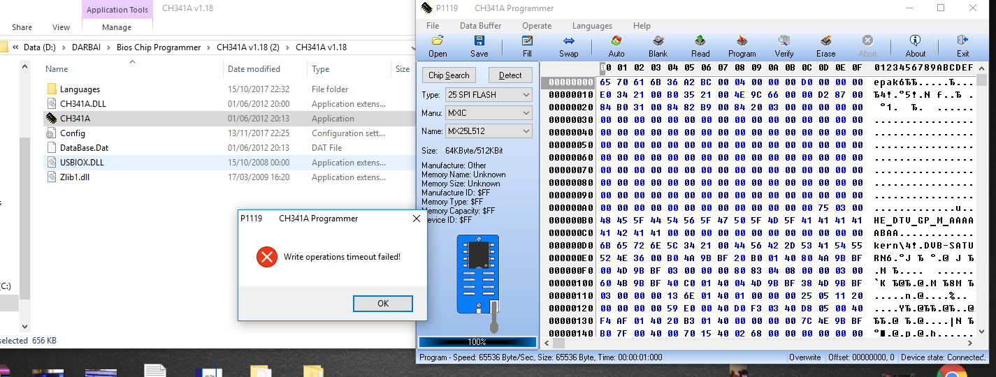

                  Finally, the programmer has arrived. But have the problem with writing...
                  Any help, please?

                      Maybe I do something wrong? The programmer can read, save, erase but when need to program, it shows this error

                        maybe the file your trying to write is too large?

                              Can be... I have downloaded the firmware for this tv from official LG site. But it is not a BIN file... Where can I get original file?

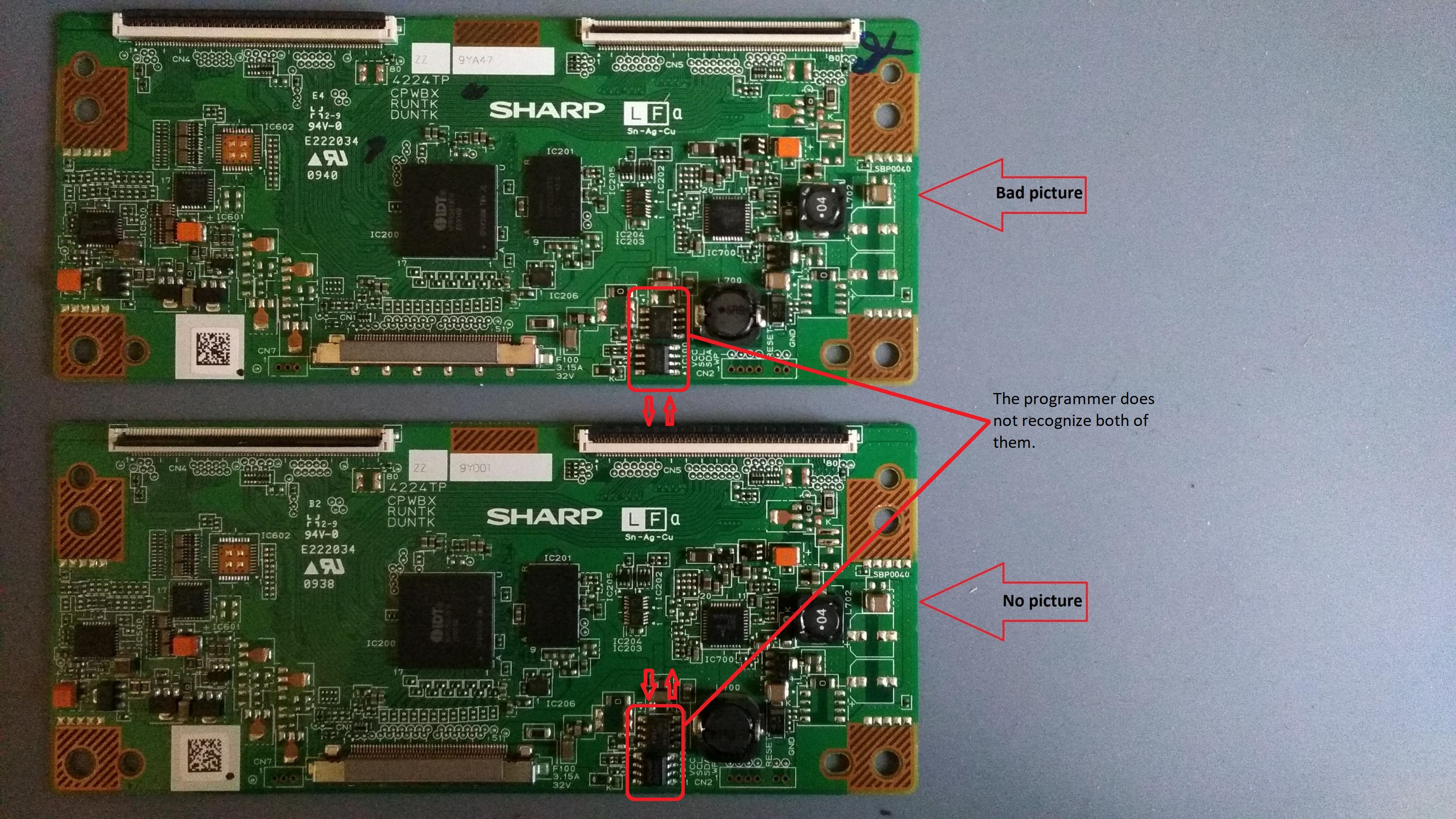

                                I tried all possible changes on those chips (highlighted the picture) and have no changes. I tried replacing all them with places-no changes. Finally, I tried to reprogram them all but did find that they are not recognizing by the programmer at all. Can be that I am working in wrong place?
                                PS.: The programmer I have, works fine with computer bios chips (recognizing, read, program, verify)
                                Can anyone help me, please?

                                  reprogramming will never bring to you any result. while your version not matched LCD. you should find T-CON with 9YD01. no more or less.
