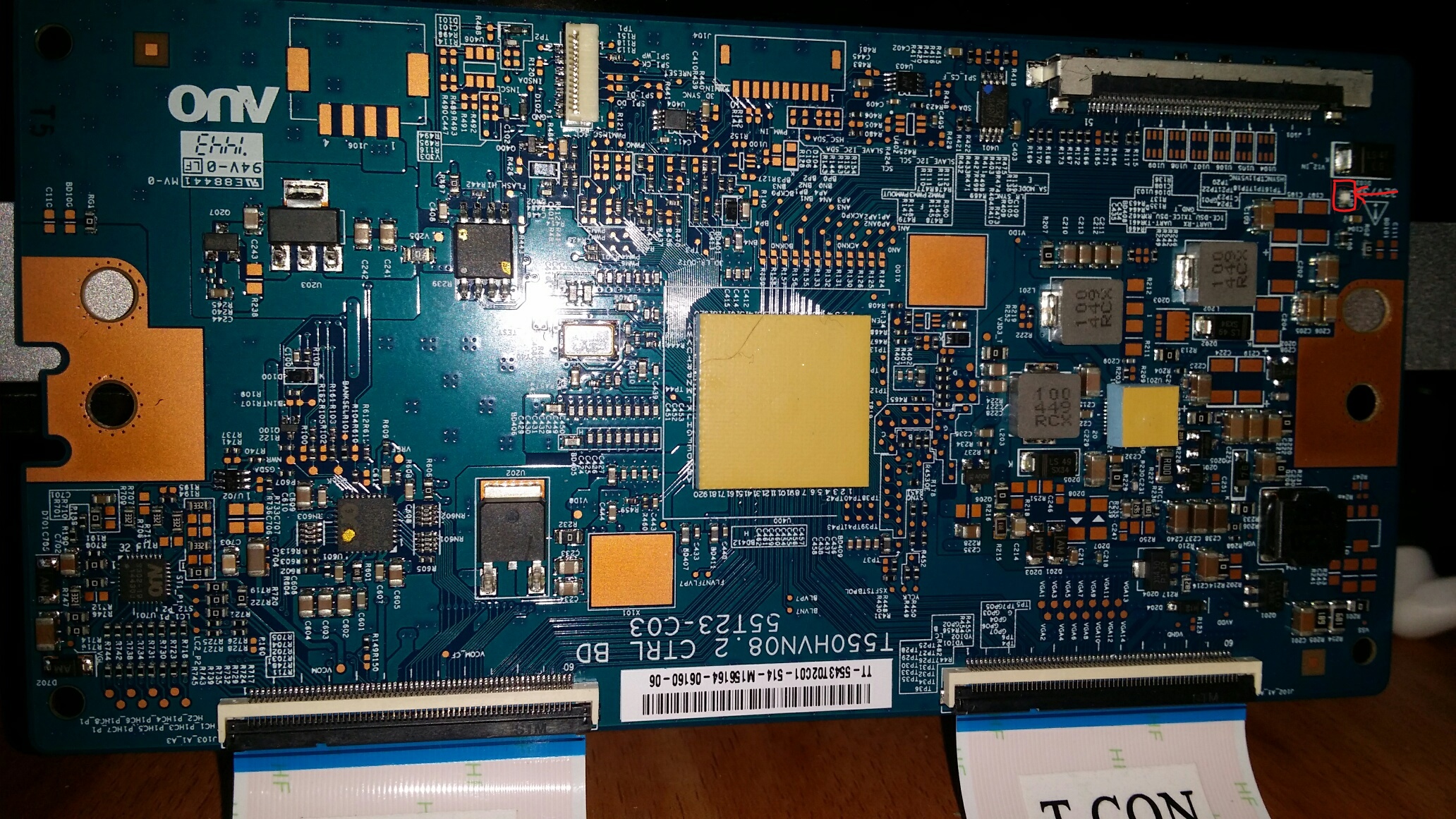

                Re: Sony KDL-43W807C
                Hi Dick
                I do not have a scope available as mine is a really old scope.
                But I have been trying two separate T-con boards and also the TV was working ok before I changed it to see if that was causing the original fault of lines across the top of the picture as you can see in my last post for this TV .
                I have also switched the mother boards still no joy.

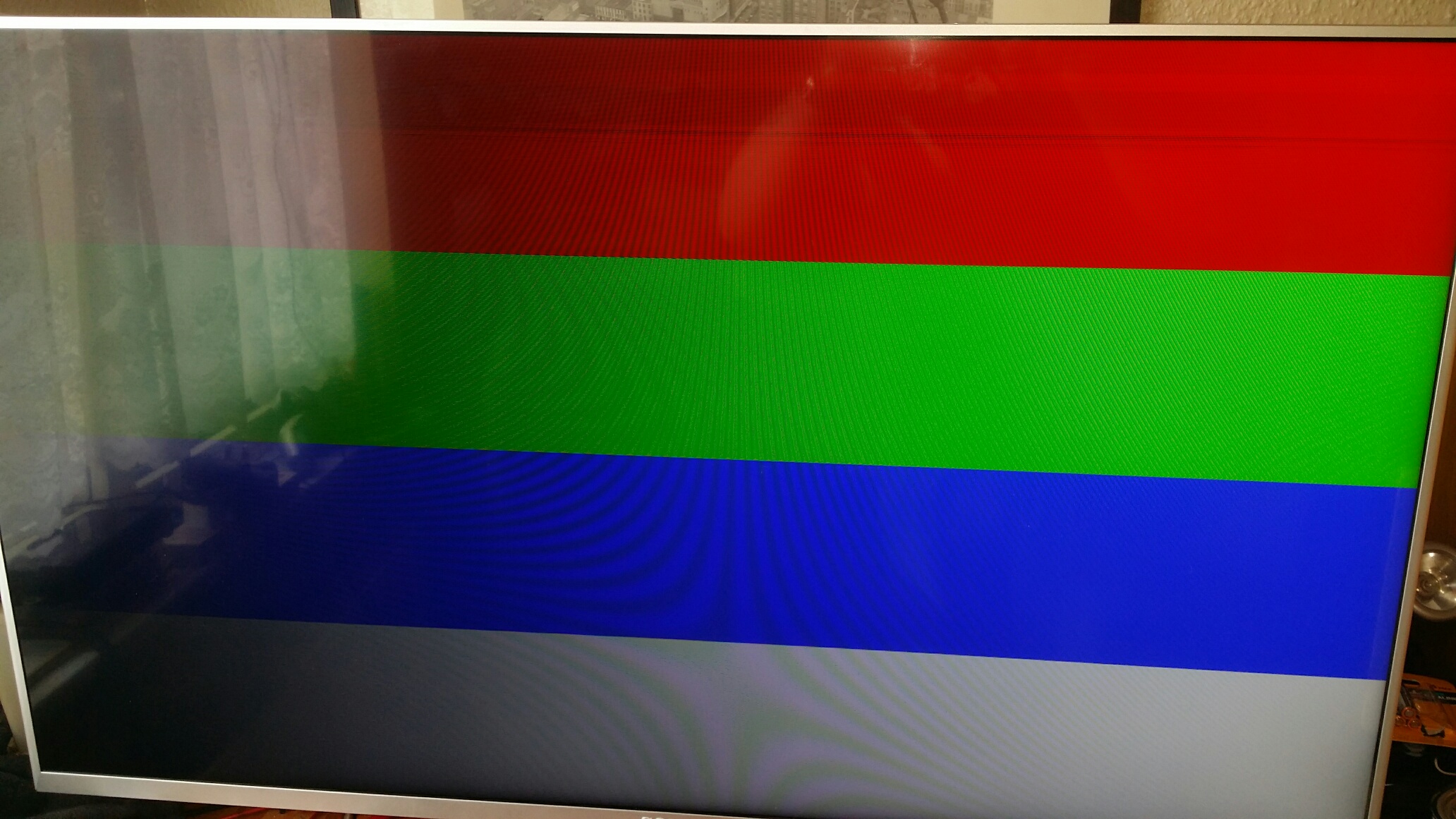

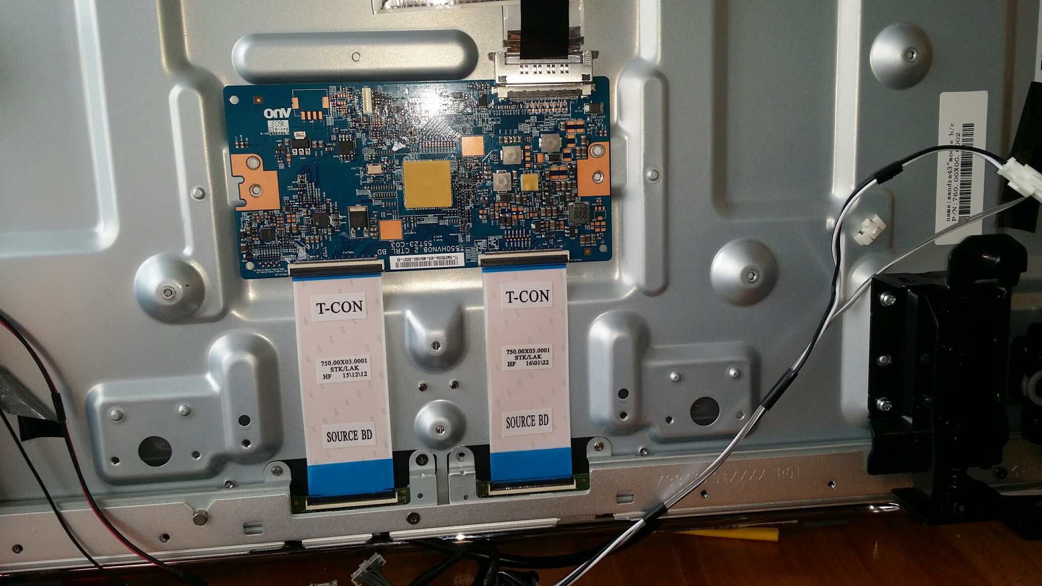

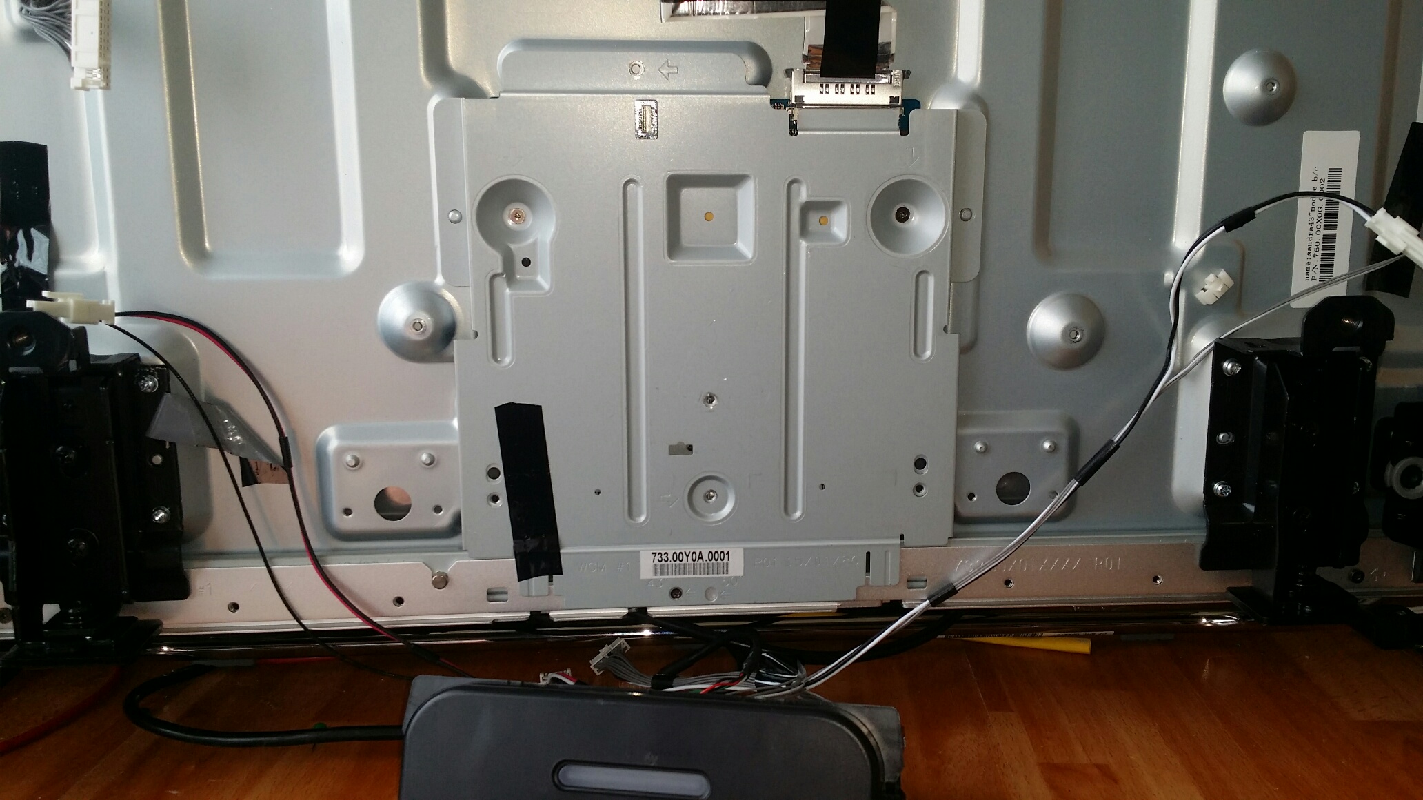

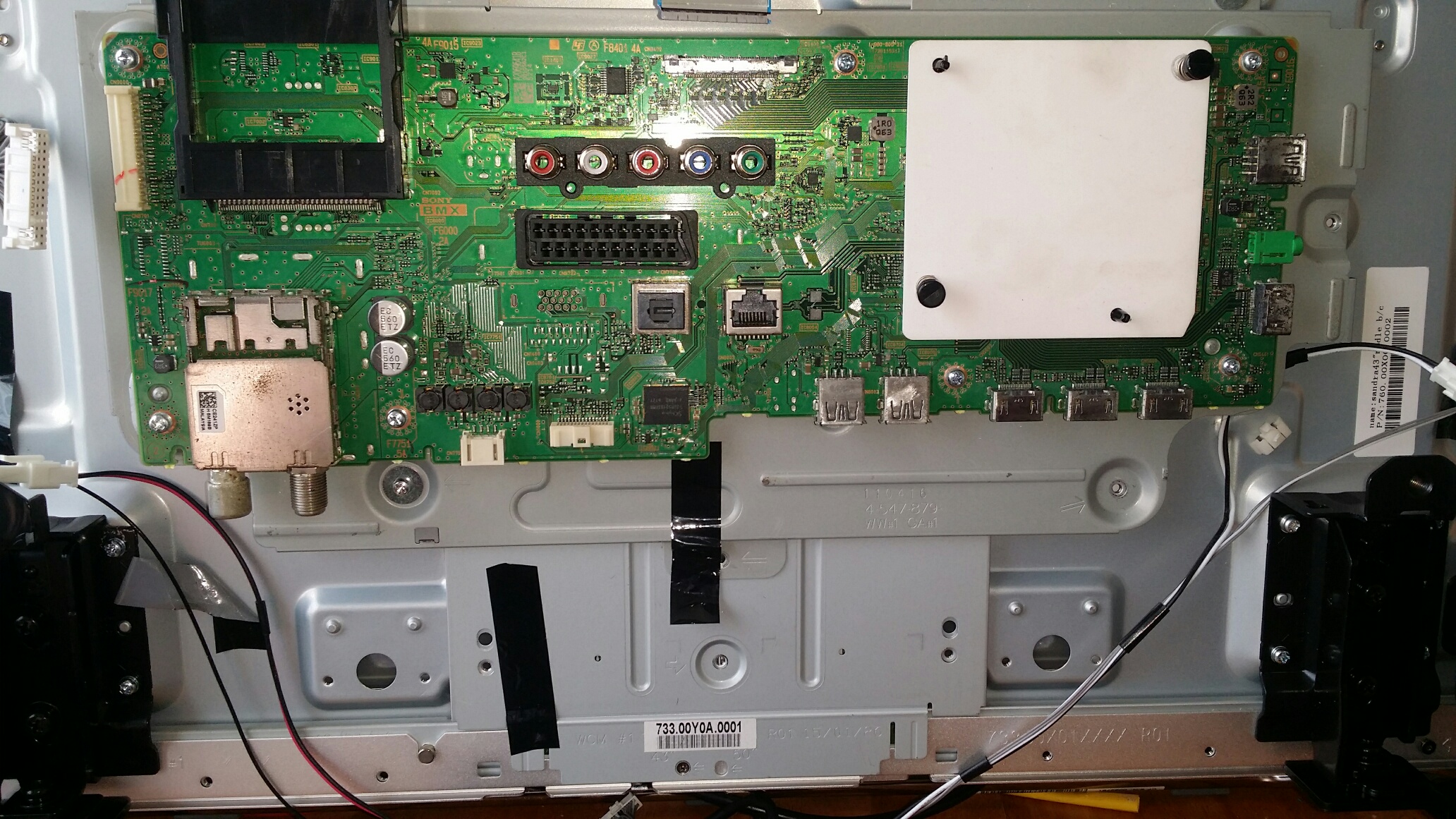

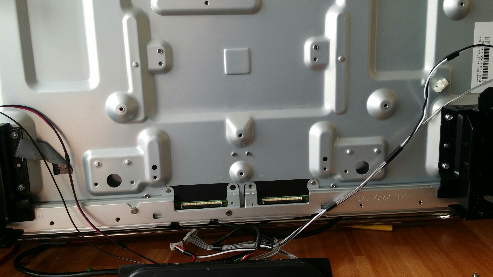

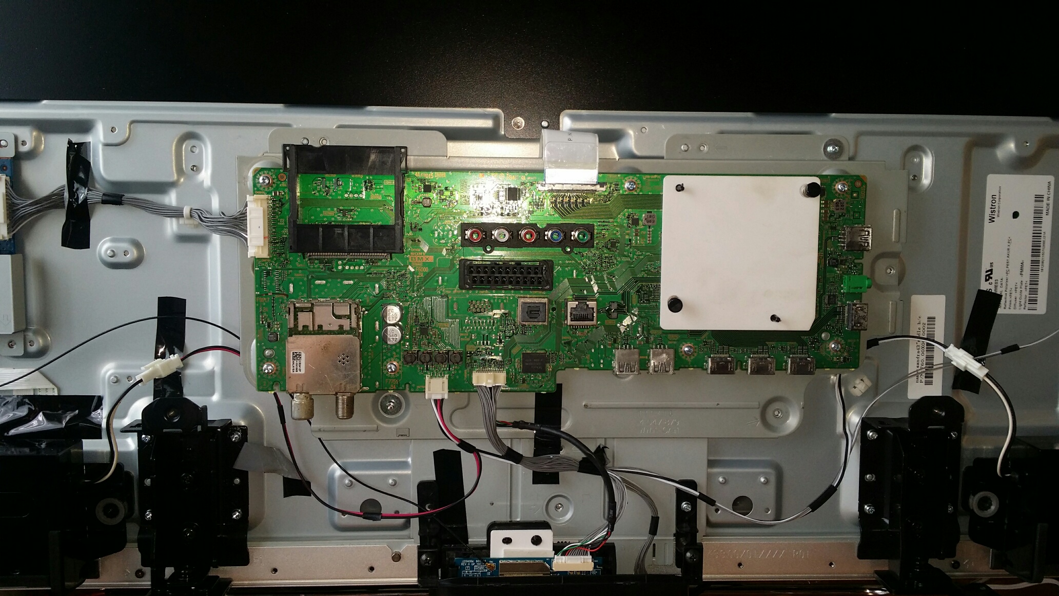

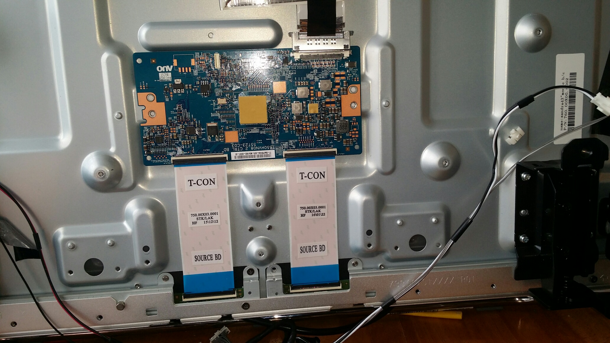

                    I have took some pictures showing from disassembled to fully assembled and what is displayed on screen.
                    Would you kindly look to see that I am putting all connections in correctly?
                    I have also took picture of spar t-con board and highlighted what I think is f100.
                    When the TV is displaying these displays you can hear sound from the channel TV is on.
                    Am I missing something here am I not connecting right.
                      I have also changed the p/s board ?

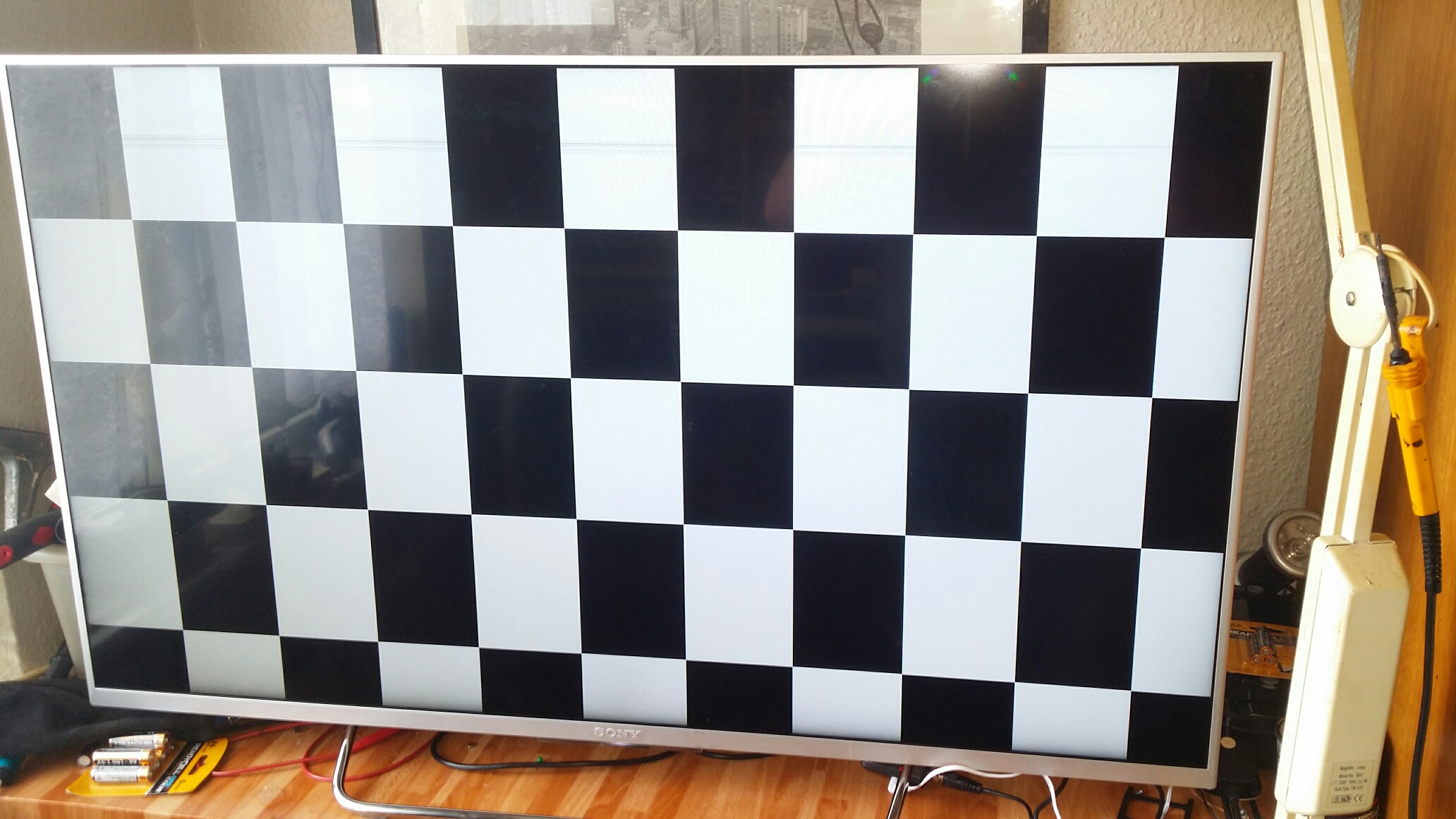

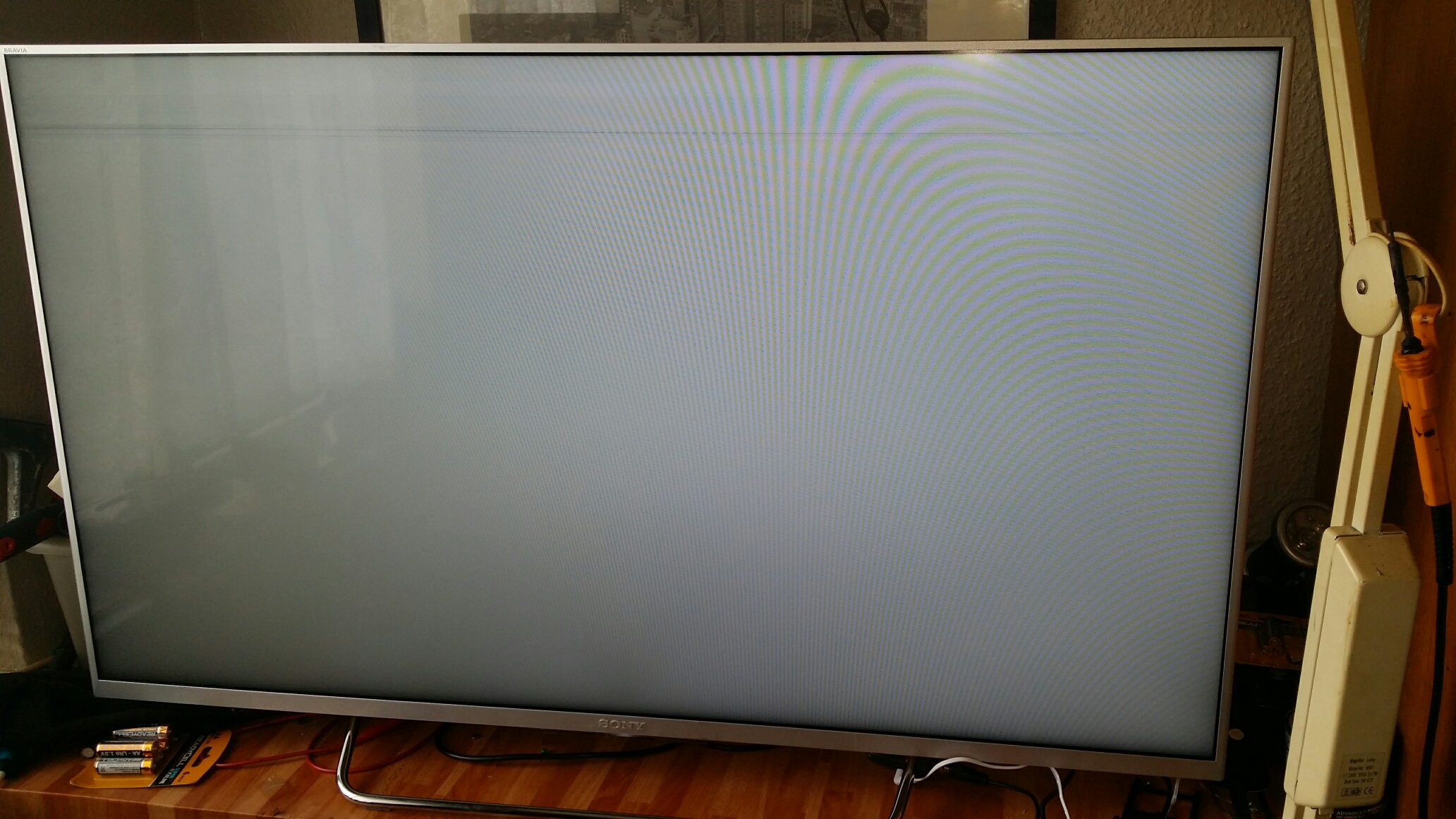

                        It rotates through these pictures while TV is on starting with the black/white then white then the colour bar picture ?
                        • ronhayes
                          TV Engineer
                          • Mar 2014
                          • 458
                          This looks more like the TV is coming on in a test mode and not in tuner mode can any one tell me if they know ìf this is the case ?
                          And if this is how do I get it to come on in tuner mode any help would be much appreciated.
                                Someone posted a few days ago had test pattern come up because he had t-con or ribbon cable backwards
                                  I have checked and double checked and they are the right way.
                                  AS you can see in the pictures the one from t-con to main can only go one way and the ones from lcd to t-con are clearly marked ?
