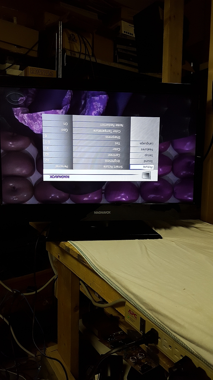

    Another trash bin rescue I've had around for a while. Repaired the power supply same as some others on here already posted. Had success however,
    The picture is washed out color and upside down. I don't have the remote and since this is a cheap piece of crap when new I don't want to buy one. I think a main board may solve this and one is online for 19.99 including shipping.
    Any thoughts on this, I am planning on fixing and giving it to my step daughter since hers is shot.
    I guess i mean is it worth it? Power supply was repaired with superior to factory parts and all voltages check stable and on the money.

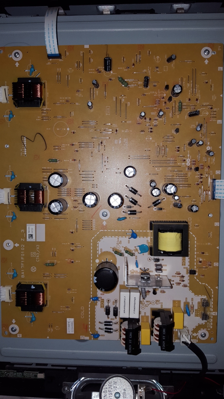

    PS SUB NOTE:
    I also had a failed .18 2W resistor in the primary section just behind the blown transistor. Mine was reading NC when out of circuit. I replaced with a donor board .18 3W same value (bro, Grey, silver, gold)
    I had a shorted zener diode on the output side of the transformer and I didn't catch it first go around so i think i may have damaged the main board in this process. then again I got it from the trash of an appliance shop and it had been worked on poorly....

    always post pics, ALWAYS.
    you might get lucky and be able to rotate the screen in the menu, or service menu. if not the main is cheap from what you said and an easy fix. possible eeprom swap or main board swap if not able to change in the menu.
    it is also possible that the washed out situation is a separate issue with the t-con.

      Sounds like someone been in the service menu and have settings messed up

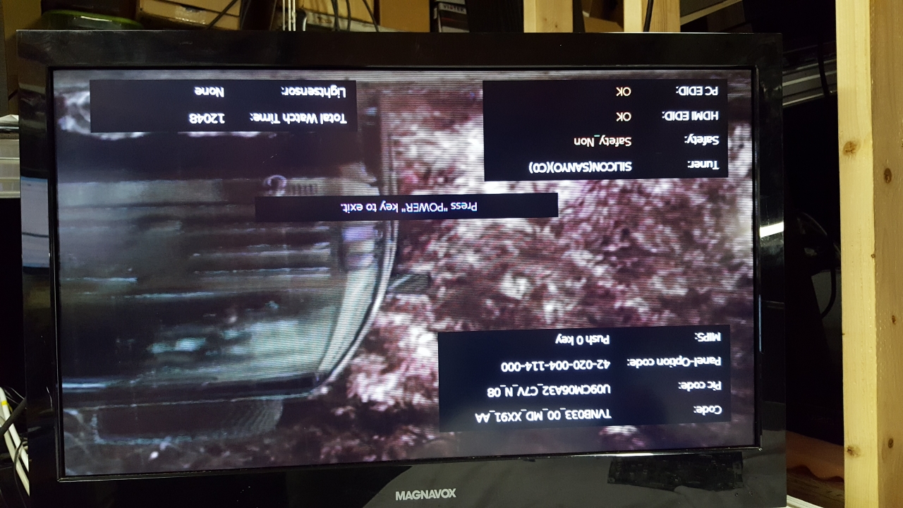

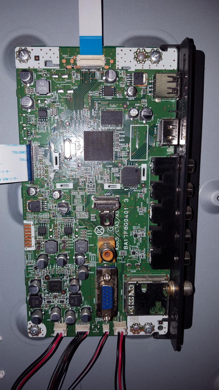

                    OK time for me to get schooled.... I put in the replacement main board and it has EXACTLY the same problem. I know this set was worked on by another place before I got it. I ran into the guy who gave it to me and he confirmed that and the guy was not experienced at all and was using Utube on his cell phone when trying to do it. Neither here nor there.. could he have hooked up the t-con board wrong or some other board for the screen... the replacement m board was used but whats the odds of it doing the exact same thing.
                    Any way I will pop the back and take some board photos.
                    • Doc38343
                      • Apr 2015
                      • 402
                      Re: Funai/Magnavox 32MF301B/F7 Picture color washed out and flipped upside down

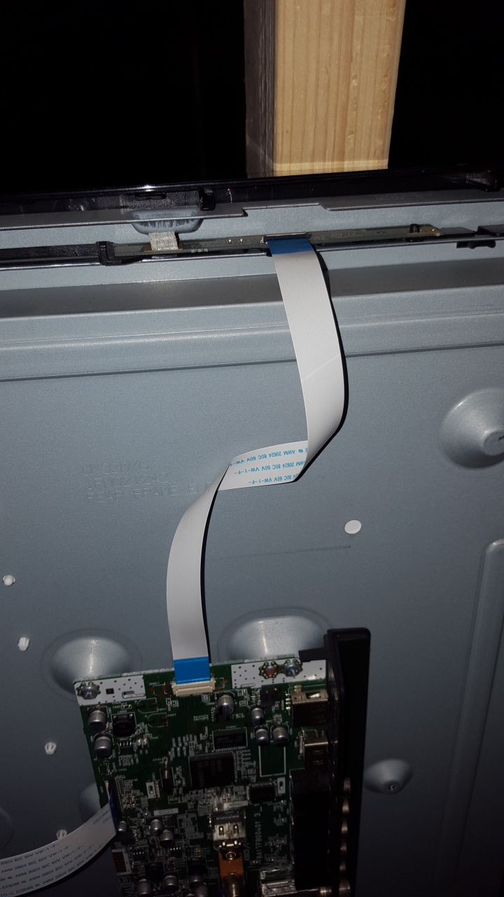

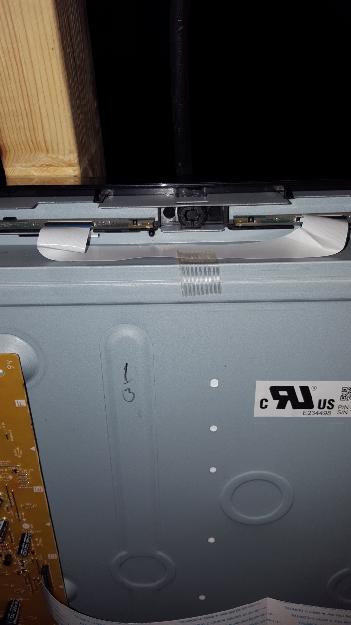

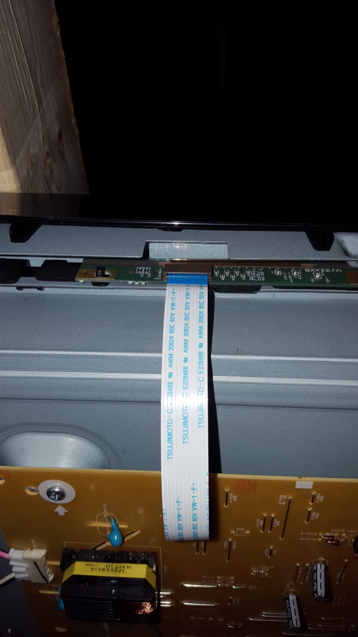

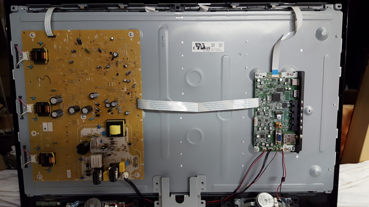

                      OK I do not see a t-con board on this set. It looks like the main board does it all. After careful examination I can see that the two boards at top for the screen have not been moved or tampered with. This is getting interesting and leads me to two more questions.
                      1. Could I have missed something on the power supply to do this?
                      (nothing on this one is marked and they used that cheap crap ribbon cable/connector.)
                      2. Do I just need to order a remote from some where for it?
                      3. Perhaps drill a hole thru one side, tie a rope on it and drag it behind my truck for a couple of days?
                      Took some pics for you guys...

                        OK I discovered a remote is more money than i am willing to spend. I got a Galaxy S6 so there is a remote app for this model and i can get into the service menu.. now what??
                        I dont see any thing relating to this just some codes and such.
                        Can anyone tell me the magic key punches??
                        I got it to run thru the test colors accidentally and finally got it back out to the service start screen.

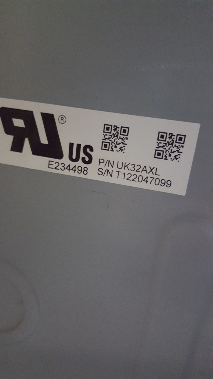

                                  There several different main board versions for this model# make sure you have the correct main board you can identify this by matching the 1st 3 characters of the serial#
                                  (Example DS7= A1AFCMMA-001 (MAIN).... ME4= A17FAMMA-001-DM (MAIN)
                                  Also if you do have the service manual,look for the "SCALER" setting you might try that adjustment,this changes the rotation of the picture

                                    Here's a couple more pics for you guys. Just got here so i haven't had time to do any testing yet.

                                      My guess is that you've got another brand of main board in it and you've now purchased a replacement based off of the incorrect numbers off of the original. What are the numbers on the white sticker on that main board? There are Emerson, Funai, Sylvania, Magnavox, and possible other versions of this TV. Some can have the panel oriented 'upside down'. Others don't.
                                      • aaronwt6
                                        • Apr 2013
                                        • 855
                                        • US
                                        I looked at your pictures and don't see a sticker on the main board. It may possibly be on the back. Please check and let me know. I have a bunch of mains for different versions of this set and would be happy to help you out on it.
