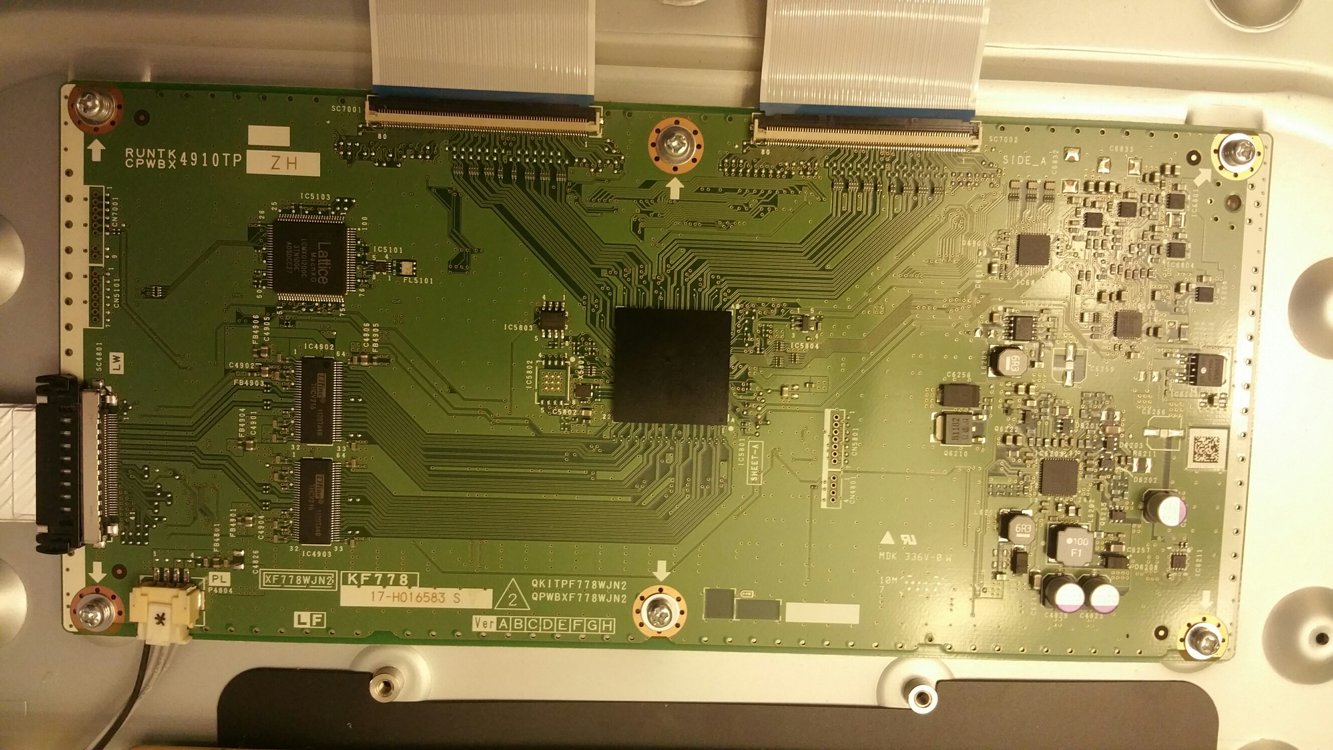

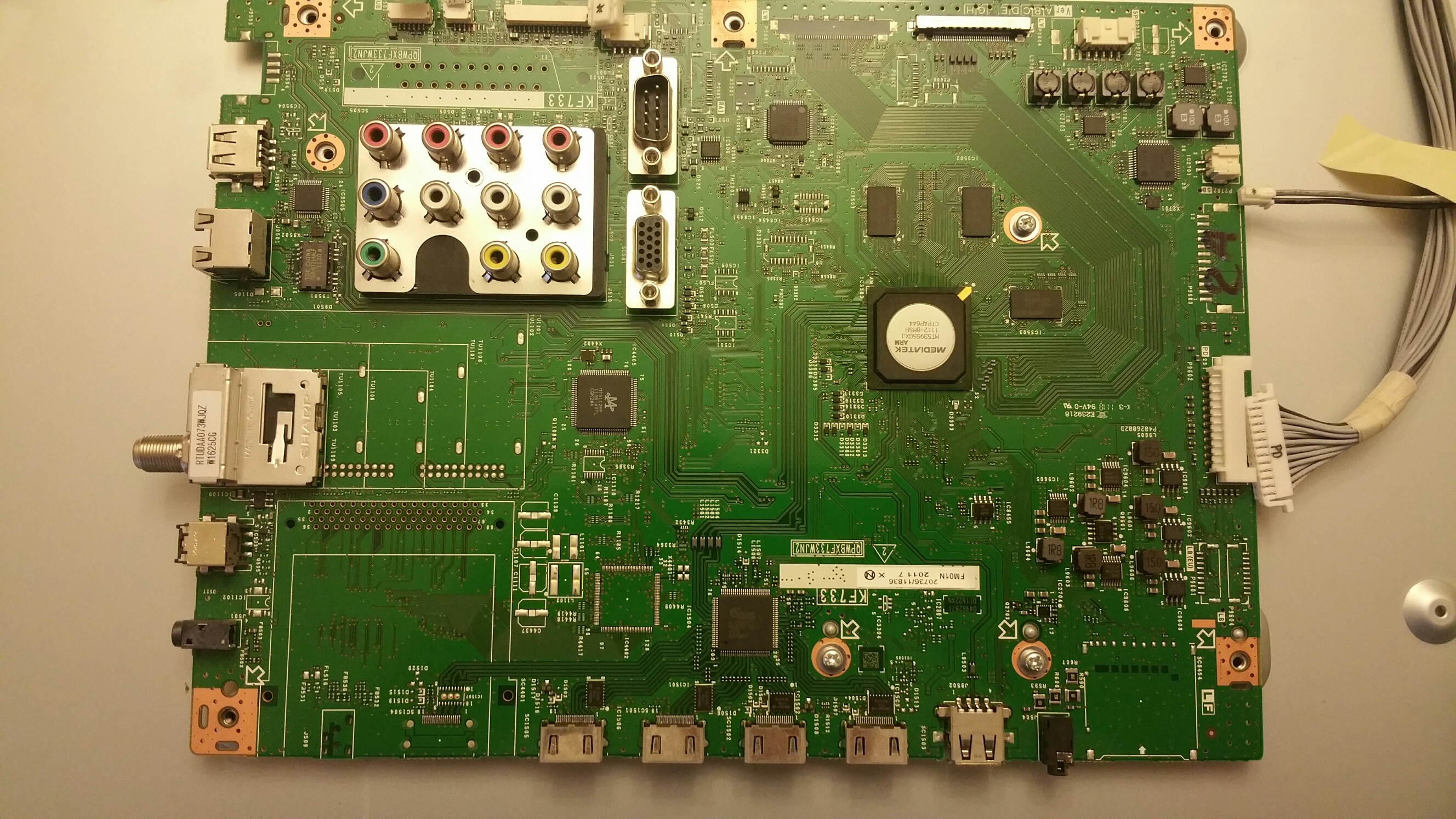

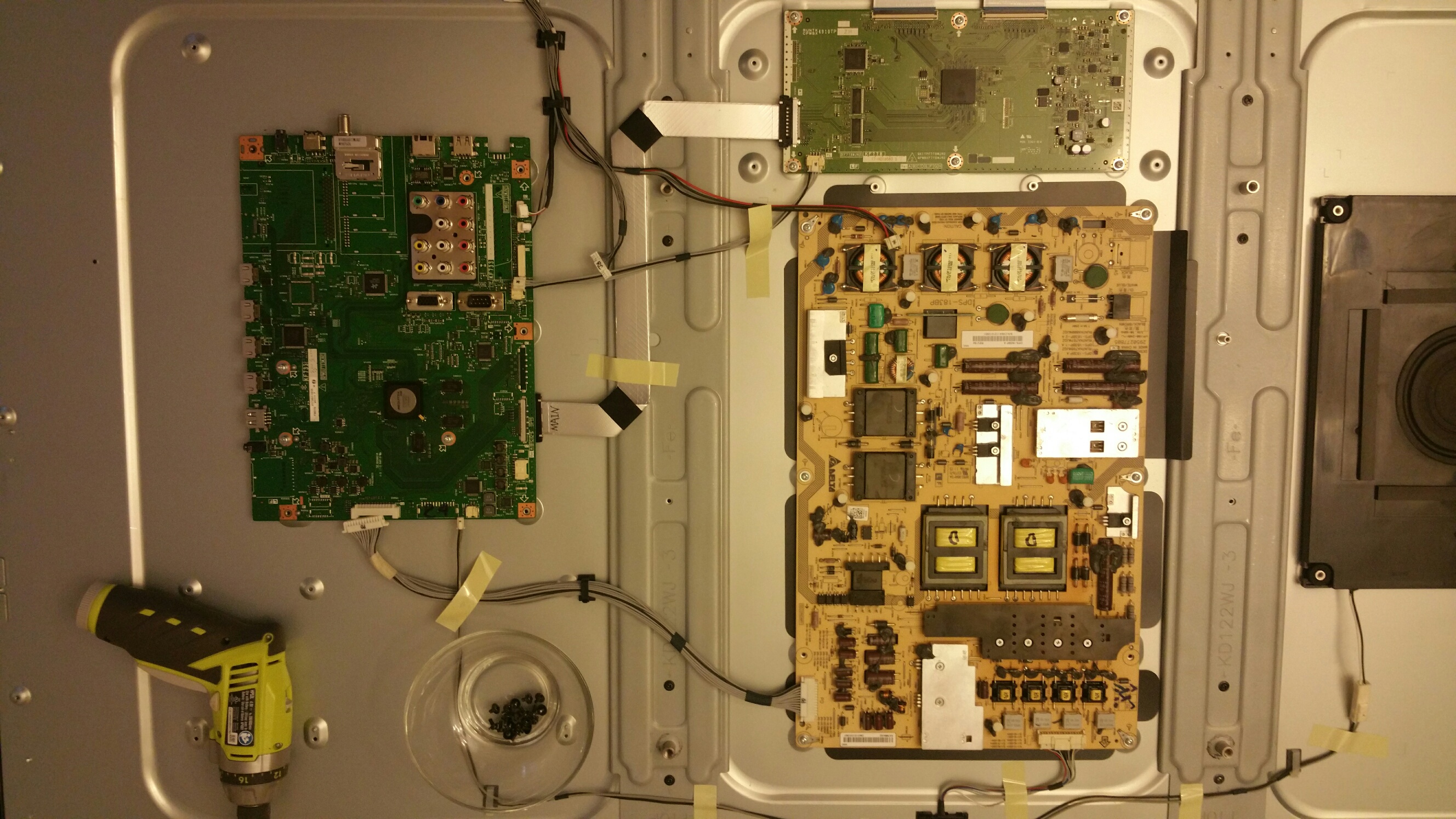

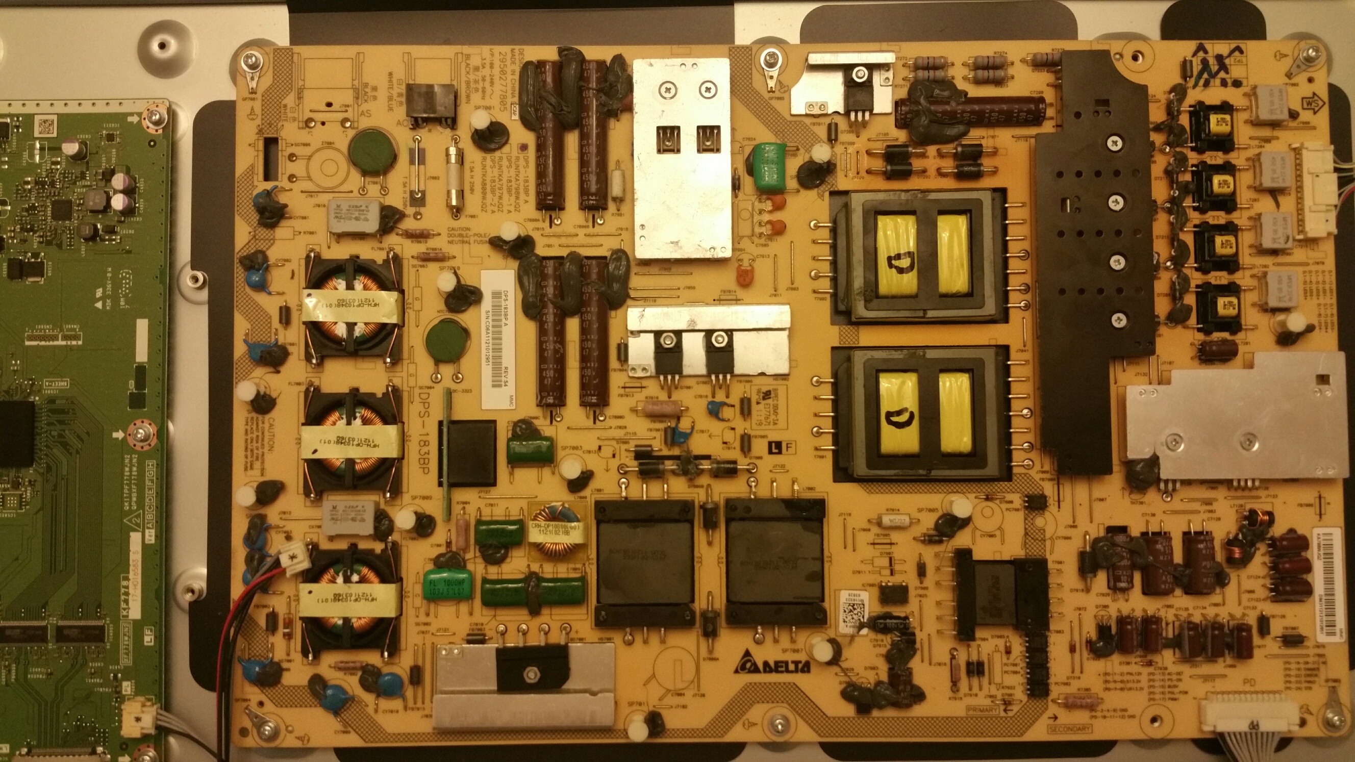

    Re: Sharp LC-60LE832U
    Here are the boards.
