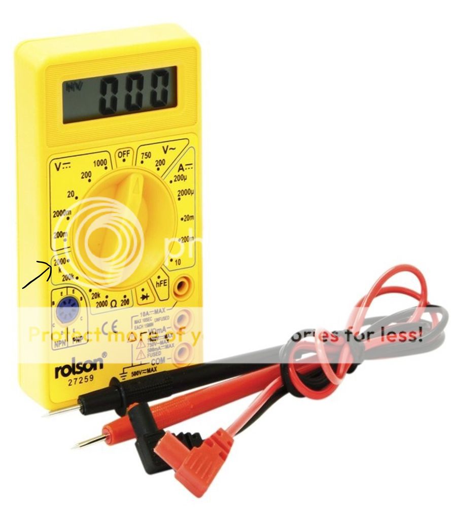

                    I am curious about your '0' reading on your meter 200-Ohm scale. What do you see on your meter when you short the meter probes together? What does the meter show when the two probes are not shorted together?
                    BTW, you did the test without the cable between the T-CON and the LCD panel not in place, right?

                      Hi Budm!
                      I actually Re-run the test on the 200k setting and got much better results. I was doing it with 1 probe at each end of the SMD.
                      Had no power connected but sadly did not remove the T-Con ribbons. Guessing I made another noob move there?
                      When I put both probes together they display 0 although when i was doing the test they was giving a little result which i can't remember now so I guess I made another mistake there? Lol
                      Many thanks!

                                  When you look for bad parts with shorts or with very low resistance, you will want to use 200 Ohms scale that will show better resolution in Ohm Range. So you need to do the test again on those caps.
                                  2M scale will not show you what the low Ohm resistance resolution, for example: If you check 1000 Ohm resistors on that 2000K (2 MILLION) Ohm scale, it will show as if that 1000 Ohms resistor has 0 Ohms!

                                      you are measuring across each capacitor.
                                      your meter should show what it does when is cant measure a resistance that high.
                                      check a high value resistor first, so you know what your meter should be telling you in this case. (OL, 1 etc).
                                      put your leads together and note the reading, probably just a few ohms.
                                      that is what you are looking for in this case, a shorted cap. or readable on this scale of measurement.
