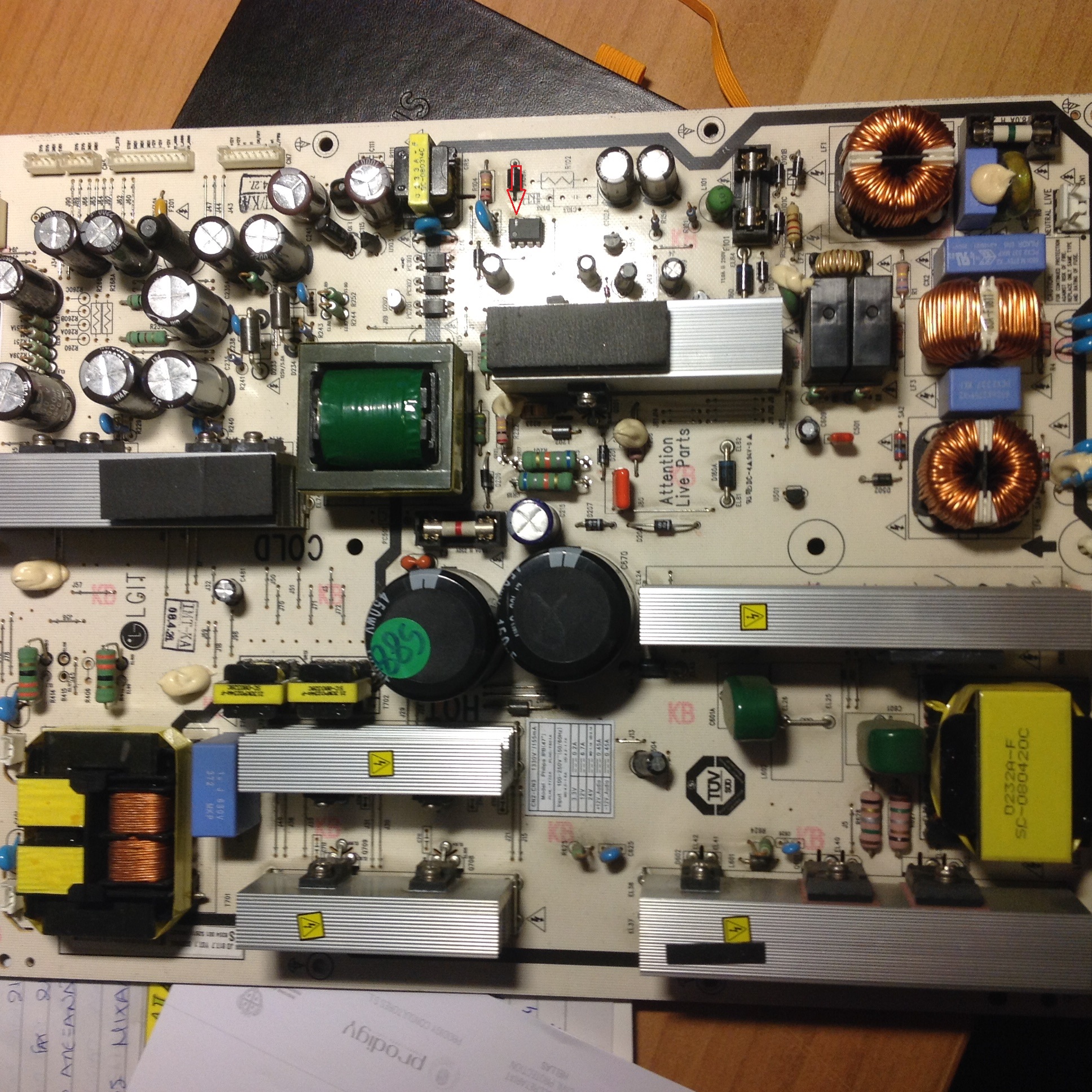

    Hi there to all!!
    New to forum, first post but watching it several months silenlty.
    I need your advice:
    Philips 47PFL7403D/10
    power supplyQ PLHC-T801A (UD)
    No response while connected to wall plug.
    I figured out that R5 is burnt. I have changed it with a new one and now when plugged in a relay is clicking all the time.
    No led blinking.
    After a minute the R5 is broke down again and everything dead.
    All caps esr measured and they are very good.
    Any advice for this issues?
    Is it truly the problem from the PSU or maybe the mainboard?
    Thanks a lot

    Re: Philips 47PFL7403D/10
    You need to change u101. It is a 7 leg ic chip that is through hole soldered in.
    Put a new 120 ohm resistor in r5 and put the correct fuse back in around that r5. Also, check the solder connections under the power board, the ones under the transformers tend to burn and start on fire. Touch up all the through hole componnets with fresh solder.
        Post some pics of the power board. Take one of u101, you may see a hole in the side of it, or a blown off leg.
            What is the mark on top of the 8 pin IC. Picture too small to read component names.
                Oh man!!
                You are tottaly right!
                After the replacement U101 is broke down again. The spot show that ic is fried.
                              What is the part # of U101
                                  U101 is FSQ510. Lots of them on ebay.
                                    So it looks like output of U101 bad. What is causing failure? Transformer shorted?

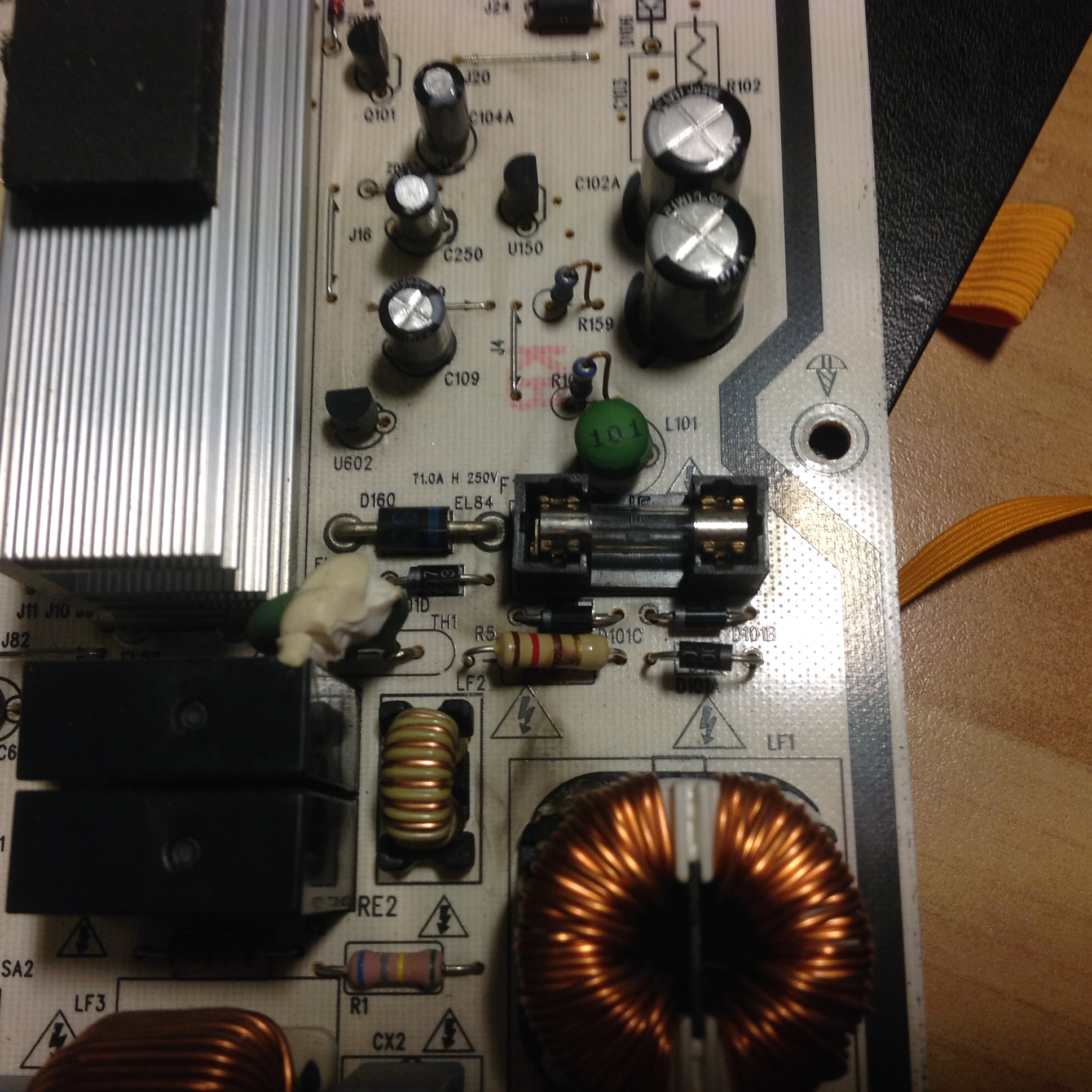

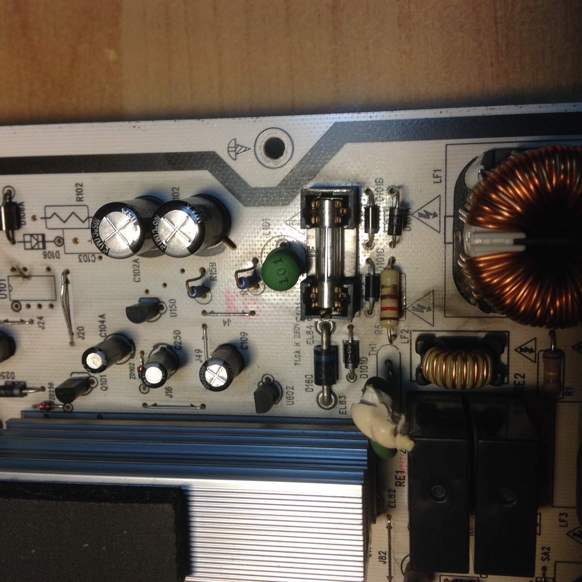

                                    • vazaki
                                      • Jan 2017
                                      • 21
                                      • Greece
                                      Here are the photos!
                                      The parts that have been replaced:
                                      > R5
                                      > D101A
                                      > D101B
                                      > D101C
                                      > D101D
                                      > PC101, 102, 201
                                      Also I need your help about T2D 83 diode. I measure it with the classic way but it seems open. Is it a special type of diode?
                                        R5 does not look good. Best that you check its resistance.
